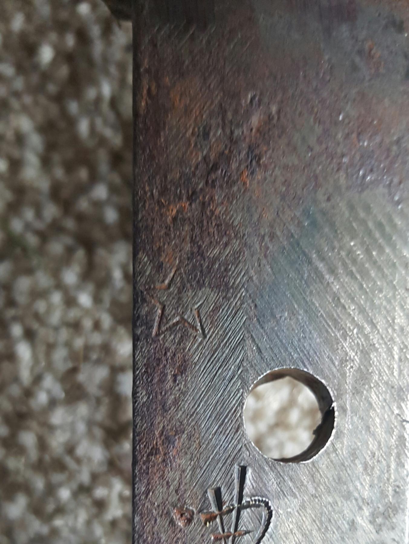

Here's what I've got so far, the mei (i hope!) is Noshu ju Kanenobu & was made in showa period march 1944.
The blade is shinto style and tachi in length at a little over 27".

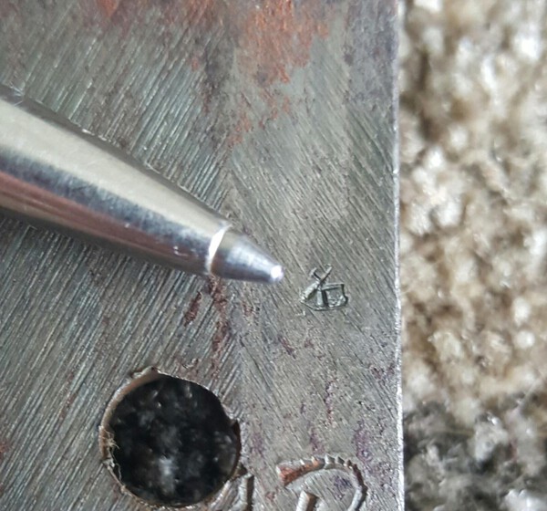

The nakago is star & arsenal stamped + 'ho' stamped on mune. Slight gunome hamon, bit rough, but still sharp as 70 odd yrs on, since sharpened!. In shin-gunto type-3 military mount.

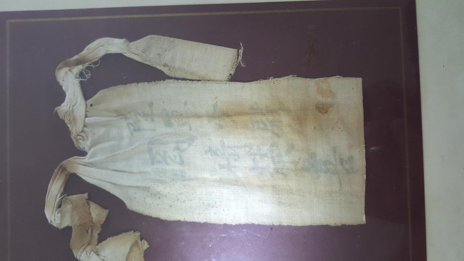

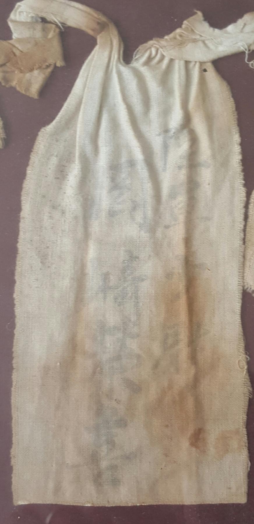

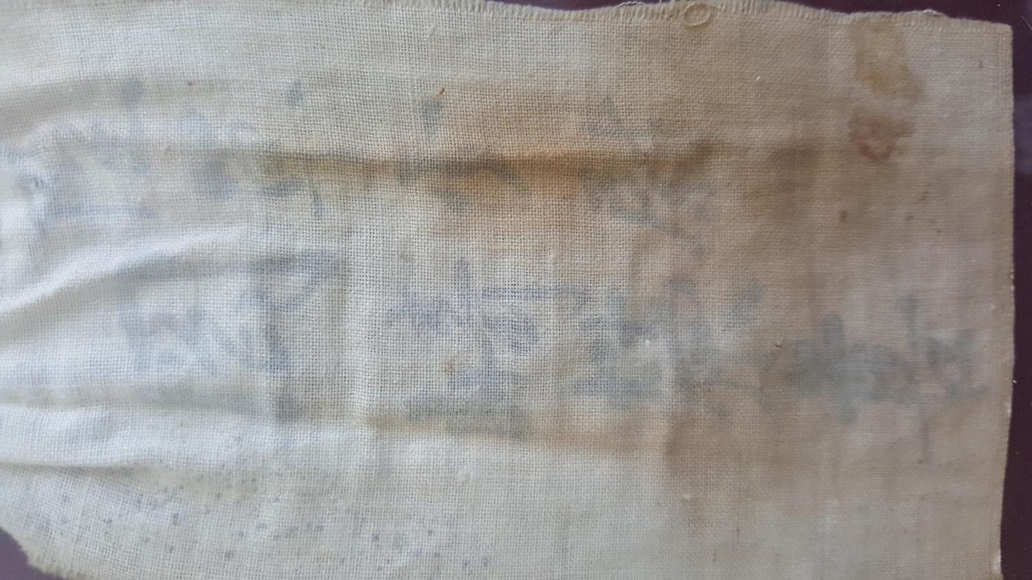

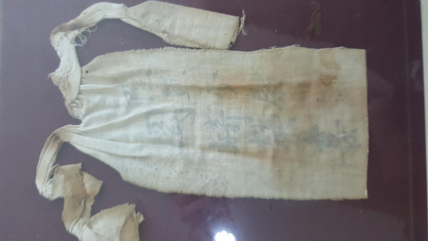

It came with a tag, since learnt possible surrender tag(thought name tag)..
That's where I'm part stuck..
So far I've got, Rikugun shoi, army sec.sub lieutenant, Okazaki eiiki? eiichi? aichi? Thats all I got.
Anyone that would be able to translate it & check the mei+date & be able to tell a little more info. on sword 2 cross reference mine(so i can tell my dad it's not the cr*p sword like he thinks).

Looks like you've already got all we can give you. Your translation of the name tag looks right to me
陸軍少尉  Rikugun Shōi
岡崎榮喜      Okazaki Hideki (could be other possible readings)
Kanenobu also looks right, but I think the date is Shōwa 18 (1943).
The shot you posted is too far away to tell much about the sword.
You might find other WW2-era Kanenobu signatures on the web if you search around for them.

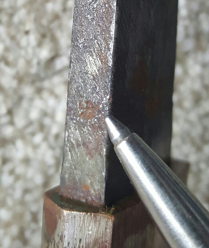

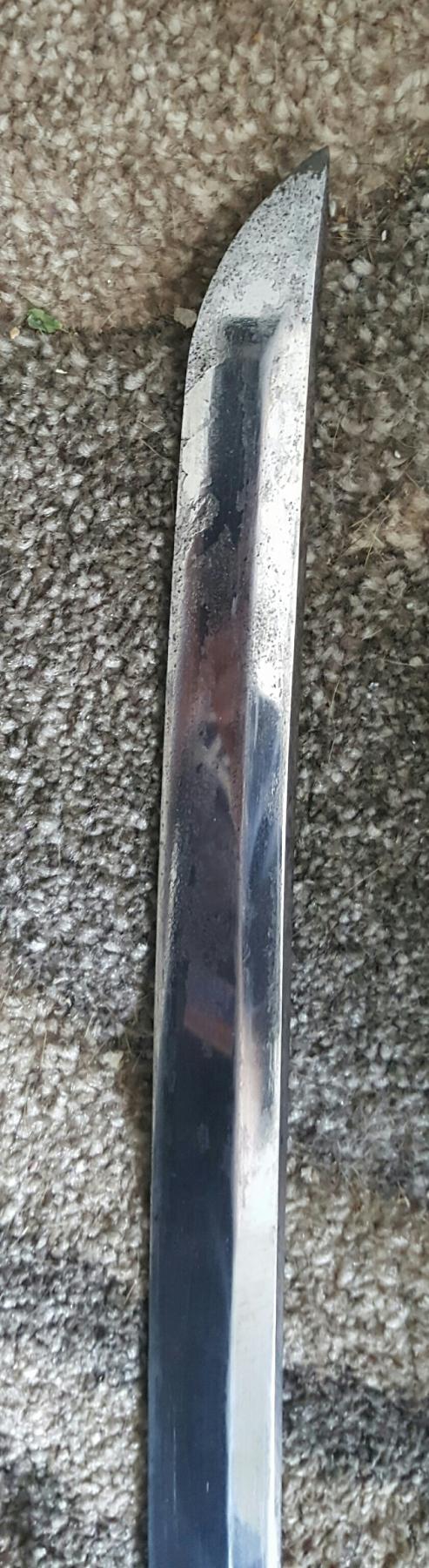

Mark L post-3829-0-73189700-1474885474_thumb.jpgpost-3829-0-82924200-1474885448_thumb.jpgpost-3829-0-83686400-1474885412_thumb.jpgpost-3829-0-08030600-1474885513_thumb.jpgpost-3829-0-13237600-1474885563_thumb.jpg

For me the corrosion around the mono uchi area looks too deep to polish out satisfactorily but that's not an expert view.

Pitting was there when dad got it, knew some wouldn't come out, more sort of want to bring it back to life?

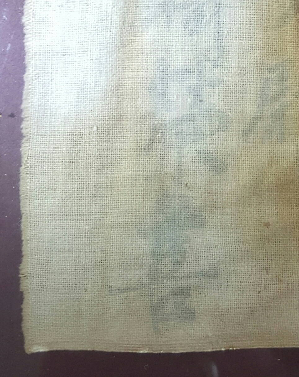

With the interpretation of tag, Hideki ,
Dunno looks a little weird in that bit too???? but I'm an aussie what would i know..
Does anybody else think or can see something in the tag maybe? Jump in, just gives me something to search. It be good to name/trace original owner(sorry won't be getting back) so I can pass it on to my kids!!

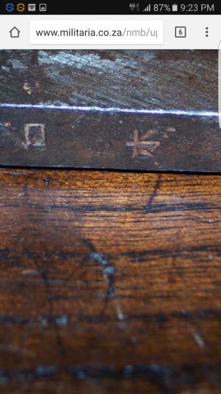

Can't see it in the pics, but if it does have the star stamp, then it's definitely Gendaito and worth looking after. At 27", it is also unlikely to be mass produced anyways. I think you have a decent sword there. Read the info in the FAQ about polishing and value etc, to decide how you would like to proceed. But you did far better than your dad's mate :)

I spose I did translate the 'Ho' stamp from your forums, the day before I signed..
So thanks again.
post-3829-0-28794200-1474933771_thumb.jpgpost-3829-0-27178200-1474933719_thumb.jpgpost-3829-0-01604200-1474933855_thumb.jpg
This is the one i found through you guys just recently. post-3829-0-30607200-1474933926_thumb.png

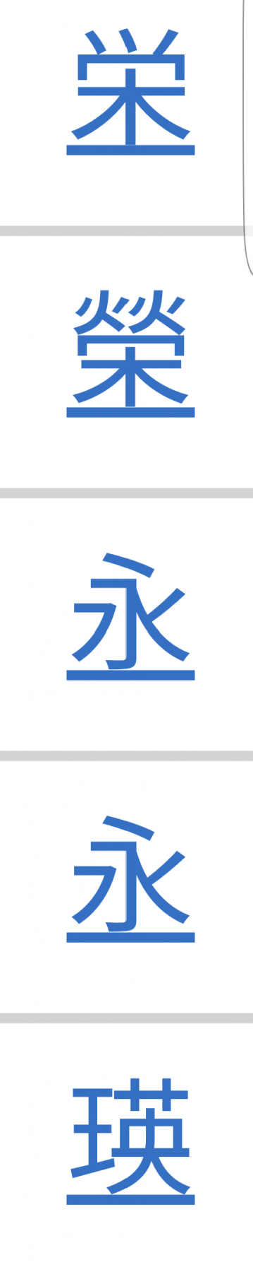

I don't understand what you are looking for. I already gave you the kanji.
It was simplified after the war to 栄. Normally it is read as Ei, but there are a ton of alternate readings possible (including Hide).
https://mnamae.jp/c/6804.html
英 is a completely different kanji, and it is different from the one written on the tag in your photo.
