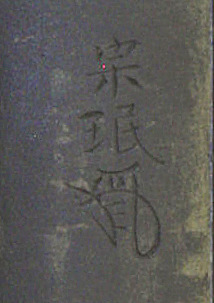

This is a kozuka that is housed in the V&A repository in London. Catalogue number: M.1259-1931
In March of this year it was part of a fairly large materials analysis survey I carried out as part of my on-going research into the history of these curious Japanese alloys.
This is in fact the first documented and positively identified example of Kuro-shibuichi, black-shibuichi. You saw it here first. :thumbsup:
There are a few recipes given in early 20th century texts for making this alloy. These compositions are what subsequently appear in modern Japanese publications.
The problem I've had is that I've not yet been able to find any Edo period examples that match these particular compositions, which are given as ratios of shakudo and shibuichi.
This piece, with a mei purporting to be that of Yokoya Sōmin, has a composition that very closely matches a composition given by the Imperial artist Unno Bisei II ( 1864-1919. and from Mito)
He advises shakudo in 10 parts and silver in 3 to 4 parts. There's obviously room for some variation here as the shakudo alloy's gold content is not specified but a narrow range of possible compositions can be estimated quite easily based on typical shakudo alloys of the period.
and the mei. Apologies for the poor images, it was a long day.
Anyway, this is just a little something I was working on this morning and thought might be of interest to board members. Any thoughts on the mei would be welcome.
kind regards to all
Ford

Dear Ford,
Sounds like exciting research - I'm so pleased that you are doing it.  FWIW (and you know far better than I) but I don't believe that this is Somin's signature or work.

Cheers George, yes , the mei is somewhat dodgy but I thought it'd be a fun exercise for some :-)  The work on the front is more reminiscent of Joi and is actually rather good in hand.
