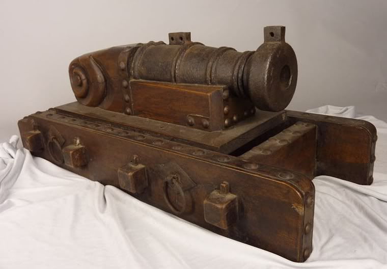

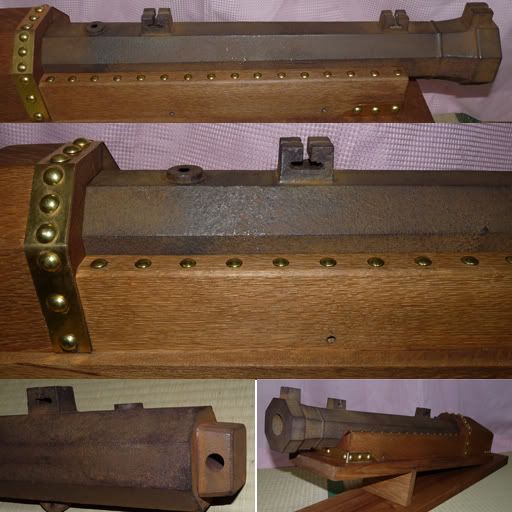

estcrh Posted February 4, 2012 Report Posted February 4, 2012 While we are on the subject, any thoughts on this?
Bugyotsuji Posted February 4, 2012 Author Report Posted February 4, 2012 My immediate thought is that the barrel is not Japanese, but you are going to tell me why I am wrong!!! :lol:
cabowen Posted February 4, 2012 Report Posted February 4, 2012 I have seen several of these tiny cannon and always wondered about them myself....Always wanted one but never came across the right one at the right time...I have seen less and less of them as time went on....
Bugyotsuji Posted February 4, 2012 Author Report Posted February 4, 2012 They used to be a must item for any rich collector. Part of the problem is there are a lot of fakes now. Even the gun carriages can be made up and aged quite easily. I watched one being made last year. People have begun to mistrust even the real ones... Eric's carriage looks good in the photo, but hard to say. The barrel has a rough and rugged outline that says Chinese, Korean or SE Asia to me. PS Can you give us an indication of size, Eric?

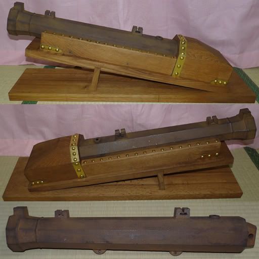

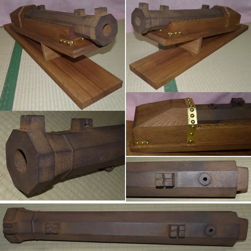

estcrh Posted February 4, 2012 Report Posted February 4, 2012 Bugyotsuji said: My immediate thought is that the barrel is not Japanese, but you are going to tell me why I am wrong!!! :lol:I dont have a clue, I thought you would know! Now what? Here is the description. 013001 台付おどし大砲 江戸後期 商品説明 とても良い仕事で重量感があります。 実に立派な迫力のある大砲で、さぞ当時は恐ろしかったものでしょう。 芯が詰まっているのでお城の威し鉄砲として置いてあったものでしょう。 詰まっているので登録書はいりません。安心してください。 置物としてみてください。 長さ 79cm 幅 29.5cm
Bugyotsuji Posted February 4, 2012 Author Report Posted February 4, 2012 He has got some of his facts wrong, so a large pinch of salt is in order. Thanks Eric. The barrel is blocked off, so the seller suggests it was for positioning on a castle wall and scaring people away, and how about using it as an interesting decoration? Like Chris, I would like to own a little cannon one day. This one is a good example of what is available, but I personally would pass on it, as with many so far. I will know when the time comes! Surely someone will love it and give it a proper home!

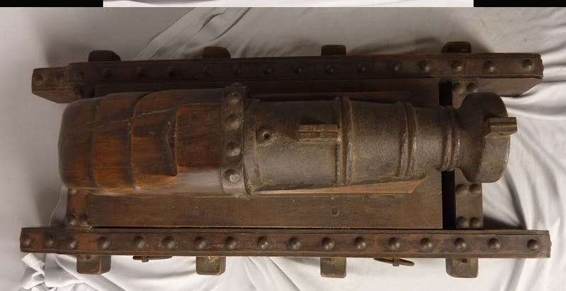

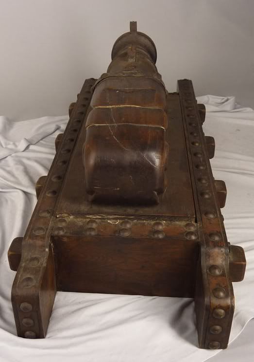

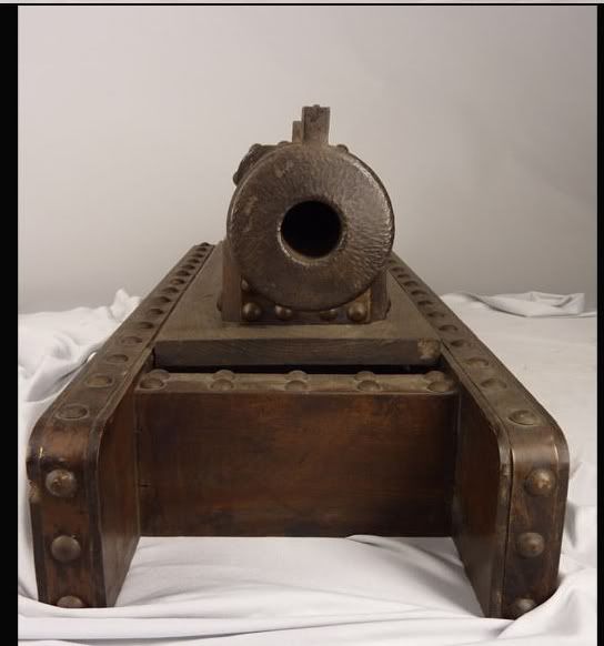

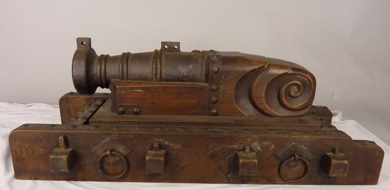

estcrh Posted February 4, 2012 Report Posted February 4, 2012 One more picture, and some images of another that looks like it might be real, but with an obvious newly made carriage.
Bugyotsuji Posted February 4, 2012 Author Report Posted February 4, 2012 I suspect the whole thing is modern. You'd need to put your finger down the barrel to make sure it has not been made recently of cast iron. Many of these are fakes and would blow up if you tried to use them. If you are seriously interested I will ask someone to look at them tomorrow for you.
John A Stuart Posted February 4, 2012 Report Posted February 4, 2012 Actually to me the first small cannon looks more in line with what I would expect than the last one. The first looks like it is seperate pieces joined by tapered breech plugs and should be low carbon iron (wrought). Any that are cast iron are fakes. Not sure when casting steel was introduced into Japan, however it was quite late. John

estcrh Posted February 4, 2012 Report Posted February 4, 2012 Bugyotsuji said: I suspect the whole thing is modern. You'd need to put your finger down the barrel to make sure it has not been made recently of cast iron. Many of these are fakes and would blow up if you tried to use them. If you are seriously interested I will ask someone to look at them tomorrow for you. Thanks Piers, Im not looking to buy one, am just trying to pick up some information on what is and is not real and how to spot the difference. There is not enough information in English and not many pictures of guaranteed genuine ones to learn much. I believe there is more information about these types of firearms on this forum than any were else in the world.
cabowen Posted February 4, 2012 Report Posted February 4, 2012 I have heard the same thing-most of these small cannon are fake. There are a few nice ones on display at the yasukuni jinja.... Now that I think about it, I did have a chance to buy a really nice one once that I stumbled across at a little antique shop while sightseeing between Takayama and Matsumoto. Unfortunately I didn't feel like dragging the thing along with me the second half of the trip. I should have bought it and shipped it home but the thought didn't occur to me at the time....
watsonmil Posted February 4, 2012 Report Posted February 4, 2012 Dear Eric, Although I am not 100 % convinced, ... I am going to stick my neck out and say that the first cannon you posted may well be genuine. Whether it is Japanese or Korean I do not know, ... but I lean strongly towards Japanese. The sights are a little strange, .. but what is not strange about Japanese guns ?? I base my conclusions on the overall appearance, and very convincing patina of the wood and metal fittings. Notice the slightly rounded ( worn ) and discoloured morticed pegs, ... also what appear to be age cracks in the wood, ... the small chip out of the one end side of the carriage ( your last photograph of this gun ). Next the colouration ( and differences in colouration of the metal bands running over the top and down the up-right wooden mount. This subtle difference in PATINA is very difficult to fake convincingly. Again the subtle differences in the patina of the wood is most convincing. Notice also one of the round top nails is dinted and again the subtle differences in patina are most convincing inside the dent. I personally can find NO outstanding feature that screams FAKE. This might change dramatically if examined in person however. If this is a fake it is very well done. As for the second set of photographs ( 2nd cannon with the modern carriage ), ... the sharpness of the casting, and overall patina give it the appearance of a newly created piece. It is much easier to off handedly shout " fake " as in the case of your first cannon than to examine all parts with an eye to how woods and metal react to real age as compared to artificially aging an object. I would be interested in hearing critisisms of my findings from other members. ... Ron Watson
estcrh Posted February 5, 2012 Report Posted February 5, 2012 watsonmil said: As for the second set of photographs ( 2nd cannon with the modern carriage ), ... the sharpness of the casting, and overall patina give it the appearance of a newly created piece.Ron I think you are right on the second one, I took a good look and I can not see any wear which is unusual, the metal seems very smooth and unblemished, the edges are sharp, and you have way more experience than I do with this type of weapon.
Bugyotsuji Posted February 6, 2012 Author Report Posted February 6, 2012 To retrench a little on the first gun. I posted my opinion before you showed the picture of the muzzle shape Eric. That shot strengthened my feeling that it is a genuine old gun, but I am still not too happy to say it is Japanese. It does not have the feel of Japanese workmanship about it. The trolley/carriage on the other hand as I said above seems to have the right style and age. It pays to stay suspicious however. For these reasons I feel that Ron and I are still fairly close in opinion. We mustn't forget that quite a few 'Japanese' cannon were actually captured and used by the Japanese even though they originated abroad. (Such practice was world-wide.) I will print out the pics and gather some feedback opinion for you. The gun and the carriage could have been put together way back when, and thereafter placed on top of a castle battlement in Okinawa for example. As to the dealer, he says that it is blocked off so it will not need the usual Japanese mandatory paperwork. Cannon with no lock mechanism do not need paperwork in Japan anyway, so this just shows me that he does not know his oats. In this sense I am less inclined to trust his description.
John A Stuart Posted February 6, 2012 Report Posted February 6, 2012 Another thing I suspect is that the lugs on the top are just that, lifting lugs. I think these are made to position at gates to fire bagged shot (like canister) for anti-personnel use. Elevation would be minimal although you may get some by blocking and wedging. The lugs are so it may be carried (slung) minus the carriage to position and the carriage moved seperately. Point and fire and useless for seige bombardment. Whether they could be used shipboard and moved by crane, I doubt as well. John
estcrh Posted February 6, 2012 Report Posted February 6, 2012 Bugyotsuji said: I will print out the pics and gather some feedback opinion for you. Piers, let us know if you get any opinions, even if not Japanese its interesting if authentic.

watsonmil Posted February 8, 2012 Report Posted February 8, 2012 Dear Piers, Alcoholic beverages and scientific discussion rarely go together, .... With respect to the photo provided by Eric ( cannon # 1 ), .... let me quote a passage from a well respected author on Japanese Firearms speaking specifically on the campaigns in Korea : " What the Koreans did have was a rather inefficient form of light artillery, which they had learned about from the Chinese. This the Japanese gunners outshot with no trouble at all, meanwhile devastating the Korean archers. It was an ideal war. They took particular pleasure in capturing the little Korean cannon, and General Kato Kiyomasa sent them home by the dozen as souvenirs. They are just over two feet long and at infrequent intervals, fire a sort of large marble. " Sounds much like the barrel Eric pictures, although we shall never know. Dealing with the disappearance of pre-Edo firearms I previously stated that most ended up in Korea, and I back that up with yet a further .... later in the Korean campaign quote : " The Japanese were now heavily outnumbered, and beginning to face serious resistance. The idea of guns for the whole army began to look very attractive to some of the commanders. A couple of letters written home from Korea in the 1590's reveal their view rather clearly. One was written in 1592 by a provincial lord who had gone over with approximately 1500 archers, 1500 gunners, and 300 spearmen. He wanted to change the ratio. Please arrange to send us guns and ammunition. he wrote to his stewart. There is absolutely no need for spears. " The other letter written by a Japanese nobleman named Asano who was holding Yol-San Castle against a much larger force of Koreans and Chinese wrote his father to arrange for replacements. " Have them bring as many guns as possible, for no other equipment is needed, Give strict orders that all men, even the samurai carry guns . " So between Hideyoshi's confiscations, ... and the Korean campaign, ... I think the answer to the disappearance of pre-Edo firearms is adequately answered. I am sure the occasional worn out Tanegashima found it's way into the hands of Mining Tool makers, ... or Cabinet makers, .... but to account for the disappearance of literally thousands of pre-Edo firearms, I think the campaigns in Korea which are recorded in having used up thousands upon thousands of pre-Edo firearms far out-weighed the recycle attributes of the Japanese. The Japanese version of " Beating Swords into Plowshares ". Perhaps if more material were translated from knowledable European cronicallers and students into the Japanese language such silly round the beer ( excuse me Sake ) table dialogue would be recognized for what it is .... rubbish and relagated to the pot. ... Ron Watson

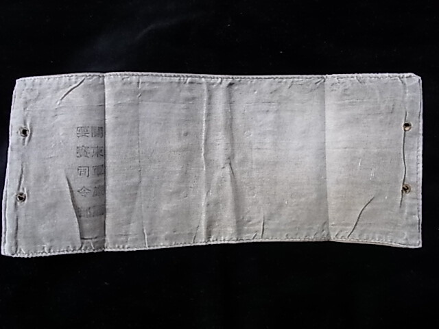

Bugyotsuji Posted February 14, 2012 Author Report Posted February 14, 2012 Maybe the forum should be renamed "The Mutual Admiration Site" :lol: Seriously though, it's always such an interesting place to be. Here are some shots of the armband. It was in a sealed cellophane packet and passed the age/materials check, so I only just opened it for the first time this morning. Not exactly what I thought when purchasing. Note to self: Check everything thoroughly before buying! Former Kanto Gun HQ building in Lushun http://ja.wikipedia.org/wiki/%E3%83%95% ... eibu01.JPG
