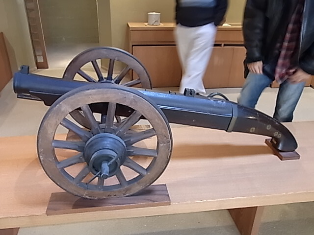

Bugyotsuji Posted February 3, 2012 Author Report Posted February 3, 2012 Ian, one thing that comes up is the heaviness of older guns. I have handled a few from around Keicho and for some reason they are staggeringly heavy for the relative narrowness of the caliber/bore. 20 monme guns should be easy to carry, but those older ones would definitely need two people or a gun carriage of some sort. In a time of repeated war perhaps earlier ones were built to withstand constant use without blowing up. Later refinements may have made greater bore for less weight possible.
watsonmil Posted February 3, 2012 Report Posted February 3, 2012 Dear Piers, I am at a loss to understand why you of all people would show a photograph of a VERY HEAVY GUN mounted on WHEELS. The gun obviously is not compatible to the carriage. There is nothing holding the gun to the carriage but for gravity. Next, ... elevation would be impossible, so the best one could hope for would be to shoot someone in the knees. Next, ... upon recoil the gun and carriage would become seperated by a considerable number of yards. I assume whomever thought up displaying this monster of a gun in this fashion is no longer working for the museum or collector but relagated to emptying trash cans, ... as it does nothing other than ridicule a very rare firearm. ... Ron Watson
Bugyotsuji Posted February 3, 2012 Author Report Posted February 3, 2012 Apologies, Ron. You are absolutely right. The photo was merely an example of what wheels on a gun could look like, and no more. I have several more taken from different angles, and a close-up of the Mei, but that one kind of hid the damned spot behind the spokes!!! :D Now I wish I had added that caveat! This particular example is not attached in any way, but this kind of set-up was definitely used. I can include photos of old prints if you like, in fact I will go and find some now. PS The guy was quickly decorating part of his new house as an artifact room and invited us round for a sneak preview. He himself has a fabulous collection of Menpo and Kawari-kabuto.
watsonmil Posted February 3, 2012 Report Posted February 3, 2012 Dear Piers, No need to hunt up the prints, ... I have a book showing Japanese CANNON mounted on wheels, .... but CANNONS not heavy hand operated guns. It must have taken a Hericulan Japanese man to have simply carried that monster let alone press the trigger ! My criticism was simply directed at the incorrectness of the mounting. Few of the NMB members have experience with any type of firearm little lone the complexities of the Japanese Tanegashima. We must be very careful in desiminating accurate information. Too many people take a picture as proof or as a true example of how things were used or put together. :D ... Ron Watson

watsonmil Posted February 3, 2012 Report Posted February 3, 2012 Dear Piers, I had not previously seen the book you took the pictures from, ... Perhaps it is I who overstepped the mark ( somewhat ) . The photograph never the less gives an incorrect impression. Perhaps if your collector friend tied a bunch of rope around the gun and carriage he would come closer to the ARTISTS impression of how these monster O-Zutsu were employed. I am yet to be convinced. ... Ron Watson

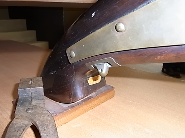

Bugyotsuji Posted February 3, 2012 Author Report Posted February 3, 2012 PS I am always amazed at how much detail you are able to pick up from a photograph, Ron. As a special treat, here is a close-up of the trigger, but how on earth did you know it would be hard to pull? The butt is so thick that the trigger is set markedly to the right side. (No good for lefties!)

watsonmil Posted February 3, 2012 Report Posted February 3, 2012 Dear Piers, I must reluctantly admit defeat in our latest Tanegashima debate, ... the off set trigger is more for touching off the gun from the side rather from the more normal position of being somewhat behind and holding up the gun. This one piece of evidence has me more inclined to believe in the wheeled carriage ( rope tie down ) version depicted in the old Gunnery Books. Note also the hole through the trigger ( possibly for the attachment of a firing laynard ). ! VERY WELL DONE Piers ! I have indeed learned much tonight thanks to you . ... Ron Watson
