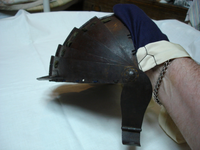

Bugyotsuji Posted May 24, 2009 Author Report Posted May 24, 2009 Two other recent additions are: 1. a folding iron half helmet of the kind favoured by the Shinsen-Gumi in the Bakumatsu period, which I have been assured by my collector friends is, of its type, quite a find. I have had the wife run up an Eboshi and I am now in the process of sewing them together. It has little folding iron sun visors left and right over the eyes, and swivelling iron ear covers with hooks at the bottom to secure a jaw shinobi-no-o. The Eboshi will tie at the back like a Hachi-maki. 2. A shikomi tanto containing a yari no ho, from the end of the Edo Period. And we went to Hiroshima today to take the Shodan Shiken. They allowed me to move up a level.

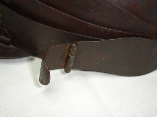

Bugyotsuji Posted May 26, 2009 Author Report Posted May 26, 2009 No 1 above, the chochin half kabuto... hmmm. It is completely restored (thanks to the missus for making the E-boshi) and wearable now, but what is in dispute is the use of the Fuki-kaeshi. When I swivelled them down to below my ears and tied a shinobi-no-o to them, a very knowledgable Japanese collector friend laughed. No, no, no, he said, those are fukikaeshi and should not be swivelled down. Again I demonstrated what I thought to be a very reasonable use for these 'fukikaeshi' look-alikes, and he hesitated, sucked his teeth and then added that it might after all be possible, as to his knowledge there is no detailed illustrated record out there. I am now thinking that they served as fukikaeshi decoration in the folded-up position, but in real battle they could have served to hold the kabuto on more firmly and stop it flying off under violent head movement.
IanB Posted May 26, 2009 Report Posted May 26, 2009 Piers, Your new helmet sounds like one in the Royal Armouries. It was really a hitae ate of, if I remember correctly, three main plates from the brow to the top of the head, each of which was divided vertically by a hinge. The front plate had two little hinged flaps that formed a divided mabezashi and the tiny fukigayeshi, again hinged, were attached to iron strips that pivoted on the same rivet that held the three main plates together. All the metalwork was russet. What is nice about the RA one is that it still has a kind of hood, of kikko, attached. This was in three parts, of pale green hemp with white thread sewing to outline the plates inside. There was a triangular panel centred on the top plate that reached down to the nape of the neck with two side pieces that hung down onto the shoulders and buttoned in front over the face leaving only the eyes exposed. The three kikko panels were laced together like the inside of a kote with thin silk cord. Where the kikko joined the plates, over the head from ear to ear, was attached a long fringe of yak hair that covered most of the kikko. A very nice item of a type I have never seen before, but sounding exactly like yours. I have a more simple one of three pivoting plates with rather large ear flaps like a Roman helmet. There is no hood, just a hemp tie that holds it on the head. I also have an odd mail hood, of the usual type that drapes over the shoulders and fastens over the face, but which has a vertical leather peak with a gilded kamon and a section of deer antler on each temple. Attached to the rear end of the antler bits is a stout hemp cord covered in lacquered leather that pulls down into the nape of the neck when wearing it - which seems to hold it on. Ian Bottomley

Bugyotsuji Posted May 26, 2009 Author Report Posted May 26, 2009 And here with the fukikaeshi swung down into ear protection plus extra strapping position?

IanB Posted May 26, 2009 Report Posted May 26, 2009 Piers, I think this B/W image is the only time the object has been published. It has certainly not been exhibited whilst it has been in Leeds. I had remembered the hood somewhat wrongly - it left more of the face exposed. Also, the arms carrying the hinged fukigayeshi cannot swing down because of the hair and hood. Ian
Bugyotsuji Posted May 27, 2009 Author Report Posted May 27, 2009 Fantastic, Ian, thank you so much for that. Sets of holes in the iron plates for which no obvious purpose springs to mind had me puzzled; it could just be that such an ensemble as you describe was there originally. Or perhaps it has been adapted...
