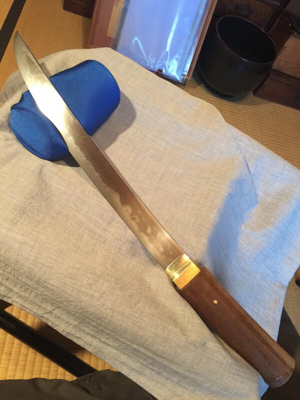

Bugyotsuji Posted September 22, 2016 Author Report Posted September 22, 2016 Just playing with the photo function here... Hmmm, they turn sideways. Quote
Bugyotsuji Posted October 6, 2016 Author Report Posted October 6, 2016 That seems to have worked, on my iPhone anyway. Method. Edit photo by turning 45 degrees x 4 and pushing "Done". Now it seems to have fixed itself in the correct alignment. Prayers to the higher power that it works on the PC too. Quote
Bugyotsuji Posted October 6, 2016 Author Report Posted October 6, 2016 Yup, works on my pc too, folks! Is this the easiest fix for iPhone photo-swing syndrome? Quote

Bugyotsuji Posted October 6, 2016 Author Report Posted October 6, 2016 Thanks Greg. Although it is 1 Shaku 1 Sun in length, the registration paper says Tanto. Sun-nobi Tanto, perhaps? My sword teacher said that it's a Wakizashi. Then I read somewhere that some of the Sue So-Shu smiths made Ko-wakizashi. There is also a problem for me with So-Shu (Sagami) Hirotsugu as there were apparently several generations. For eighty years, from about 1469 to 1550 there were one, two or even three smiths of this name working there, according to various sources. Could one person have been active for so long? Even Fujishiro is not clear. The offered signatures look sort of similar. I have not yet seen the returned blade or paperwork (don't want to give my cold to anyone) but if the suggestion is Eisho, 1504-1520, then I guess it has sort of been pinned down, and the experts in Tokyo must feel sure enough of their judgement to affix the NBTHK association seal to it. 2 Quote

Bugyotsuji Posted October 7, 2016 Author Report Posted October 7, 2016 Forgive the bloggy nature of these updates, but I just met my teacher and was able to clarify at least two points. Jean above mentioned he likes the Eisho Period. Apparently all five judges must have agreed on this, and their decision would have been based on the style of this blade, as if there was a well-defined Eisho fashion. The other thing was interesting. 'Tanto' on the paperwork is what it truly was back then and what it was designed for, a practical combination weapon to go with a Tachi. "Today's legal classification is based solely on length, though, which makes it a Wakizashi," he said, without batting an eyelid. He agreed that Sun-nobi Tanto would be an apt description. Quote

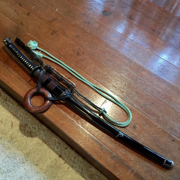

Bugyotsuji Posted October 8, 2016 Author Report Posted October 8, 2016 Here's the handachi that is going... Quote

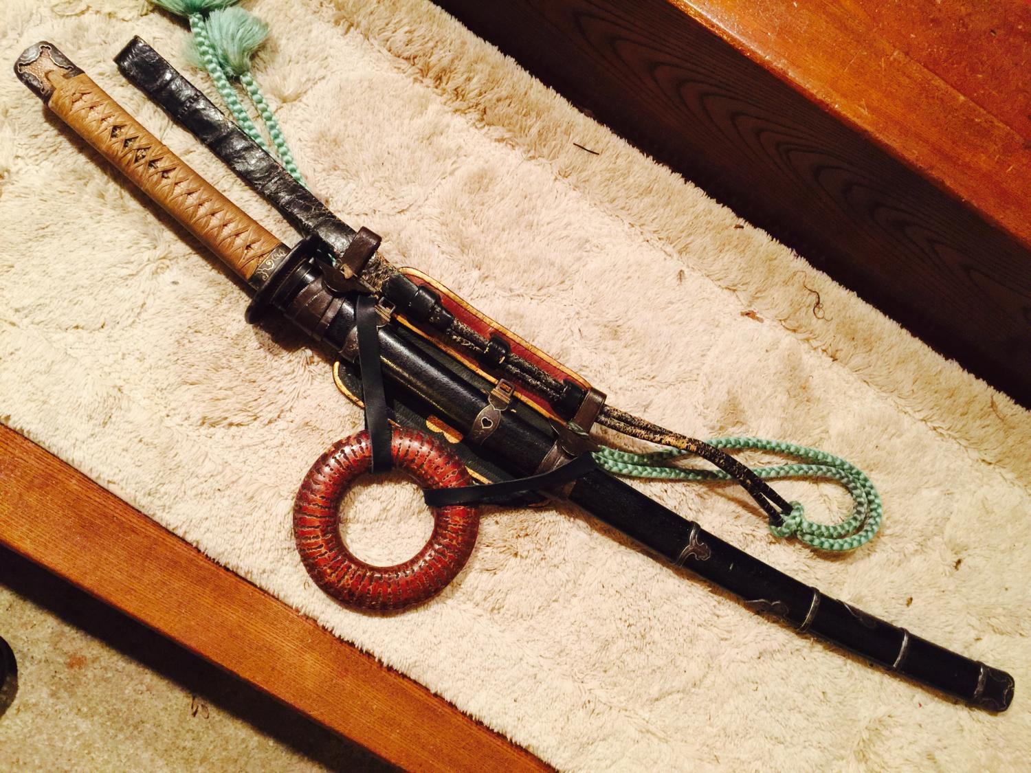

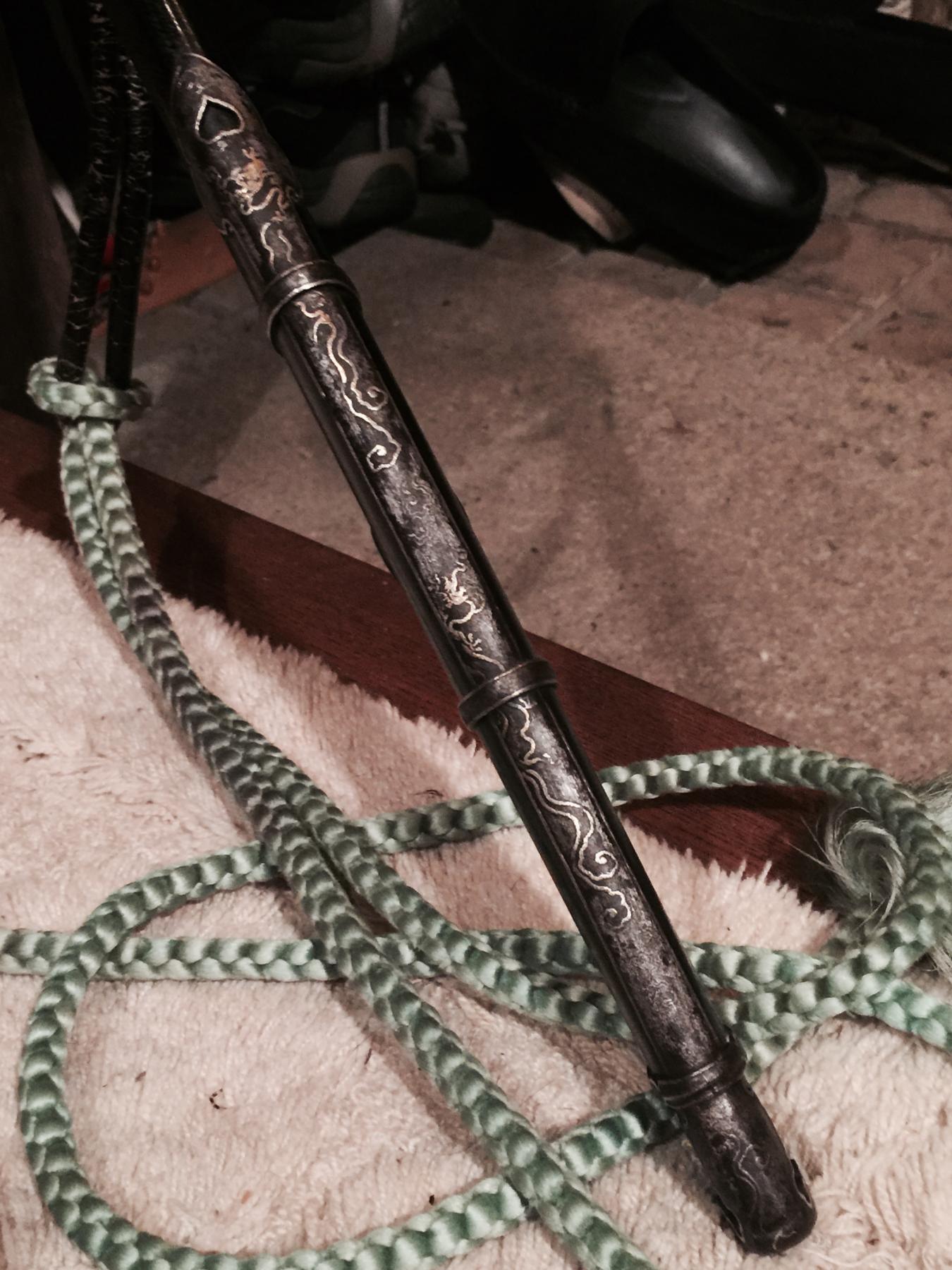

Bugyotsuji Posted October 8, 2016 Author Report Posted October 8, 2016 Then a *quick changeover of the koshi-ate and tsuru-maki onto the 'new' tachi arrival, ready for tomorrow's action... Tosogu is all dragons and clouds, zogan on what should be russet, but the menuki dragons are coiled around Ken. *'quick' means a bodge job as there's no time to do a proper sageo. Quote

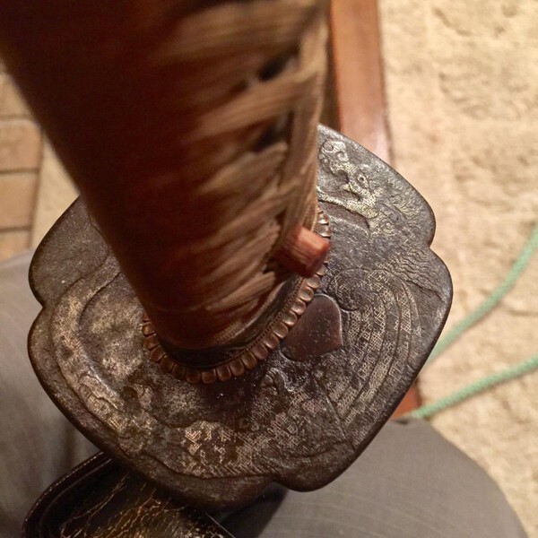

Bugyotsuji Posted October 8, 2016 Author Report Posted October 8, 2016 The tsuba, and a section of the naga-kojiri which has two dragons on the long edge and one on the shorter edge. Quote
