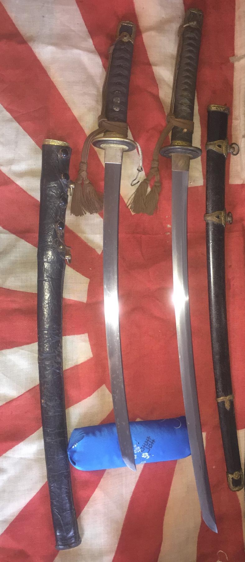

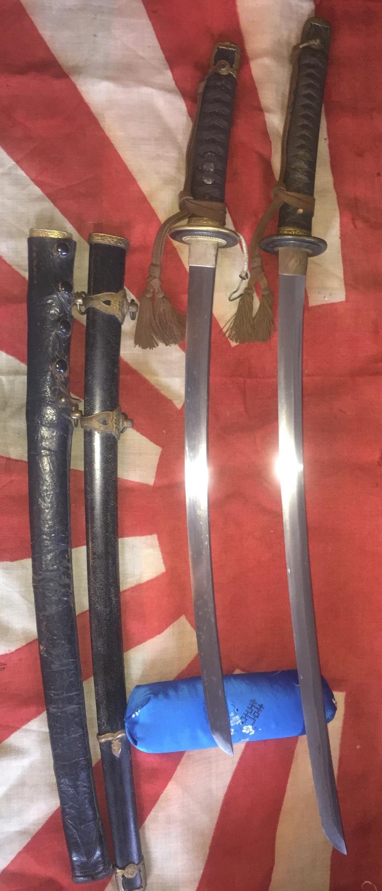

Geraint Posted September 20, 2016 Report Posted September 20, 2016 Dear Dave, I have just checked the two examples that I have that fir your criteria, both are wakizashi in full gunto mounts, one Kaigunto and one Shingunto. Both are absolutely as mounted, no swapping bits, all matching numbers. Both koshirae are a little smaller than my normal Shingunto but in both cases the blades are shorter than the koshirae would suggest. (Pictures attached.) I have no definitive answer but I have always assumed that length was dictated by the stature of the officer. I have been given to understand that the correct length for a katana is such that when at arms length the tip should clear the floor when the hand is grasping next to the tsuba, if this is the case then it would be logical that shorter officers would have shorter swords. All the best 1 Quote

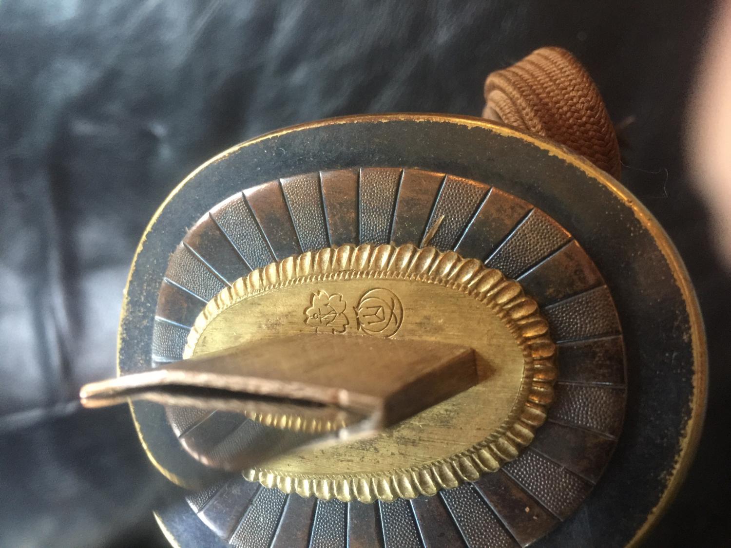

IJASWORDS Posted October 23, 2016 Report Posted October 23, 2016 Hi, by the way great photo of stamps on SEPPA Kai Gunto of Scandinavia. Got a Lt General sword (see pictures), with provenance. It has a 22 inch blade in a 28 inch SAYA. The blade is old UJIFUSA OWARI, and sticking a probe down the SAYA shows it was made for this blade. My only comment is that it is a treasured family blade, and mounting it in a SAYA to suit the length would look silly on an officer (too short). Sword length (certainly SAYA length) may well have been a status symbol amongst officers. All this said, I also have a number of 21-22 inch blades in short SAYA to suit. So is it regulation or vanity? Neil. 1 Quote
