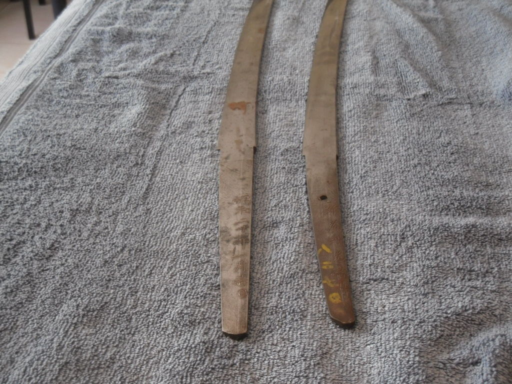

Sporkkaji Posted September 8, 2016 Report Posted September 8, 2016 I haven't been bitten by the Ebay bug for a long time now but I came across this listing for two bare out of polish blades found by the seller in a storage auction and I decided to grab them ($530 shipped). One of them looks to be a run of the mill gunto with a chippy mei and Seki stamp, but it's the other one that caught my eye as it's clearly never been mounted. I'm hoping someone here can shed some light on how unique it might be to find a blade with no mekugi ana? I'm guessing it probably wouldn't have been signed if there was a defect of some sort and the war may have ended before it was completed? Any translation/date assistance or other relevant information would be greatly appreciated, thanks! 1 Quote

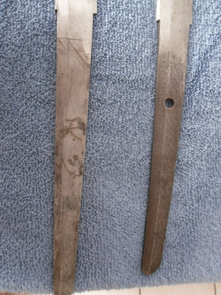

ROKUJURO Posted September 8, 2016 Report Posted September 8, 2016 C. Lewis (what is your first name please?),the SEKI blade is signed KANE XX.The other one seems to read TENSHIN (may be read differently) in TACHI MEI. The date is SHOWA 22. I cannot say if this one is a genuine Japanese blade. Quote

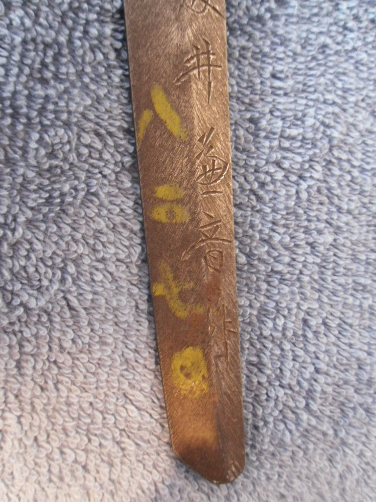

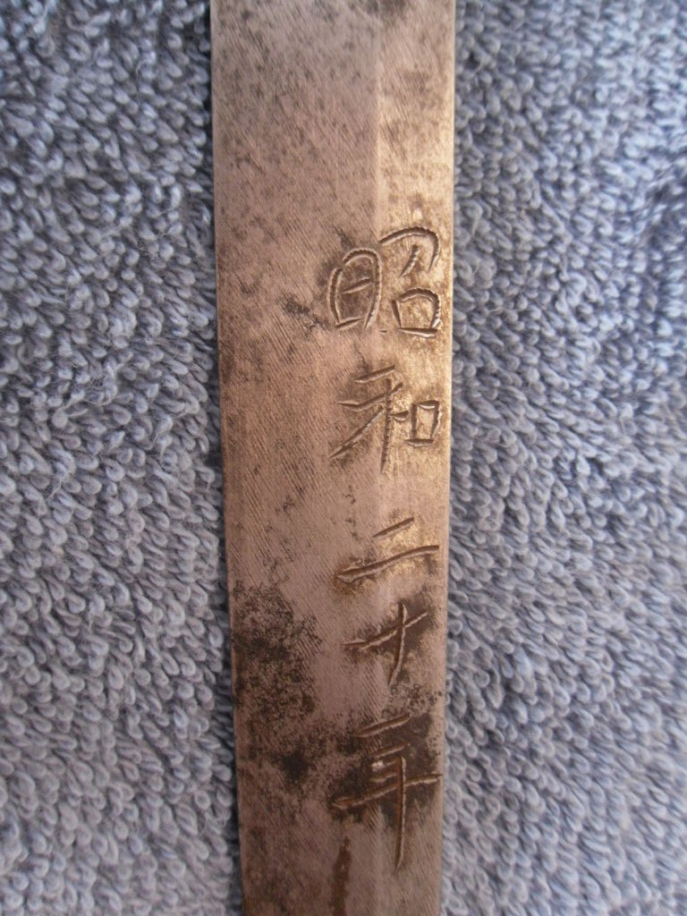

SteveM Posted September 8, 2016 Report Posted September 8, 2016 The seki blade is 囗藤井兼音作 (?) Fujii Kaneoto Saku The date on the Tenshin blade could also be Showa 20. I think what looks like a 二 is actually part of 年. Like Jean, I have some doubts about the blade, or at least the signature. Quote
george trotter Posted September 8, 2016 Report Posted September 8, 2016 Tenshin looks right. Date is Showa 2 10 nen 1 gatsu lucky day...so Jan. 1945. Mei looks well cut. Don't know who made it but "no-mekugi-ana" blades have been seen before. I would not dismiss it so quickly...may have some merit and be an interesting blade. Just my opinion, Regards, Quote
Sporkkaji Posted September 8, 2016 Author Report Posted September 8, 2016 C. Lewis (what is your first name please?) Hi, first name is Cory. Thanks to everyone for the info so far. I don't have them in hand yet so all I have are the photos from the listing. Here's one more if it might help. Quote
Stephen Posted September 8, 2016 Report Posted September 8, 2016 often shrine swords have no ana, heed GT's words not too dismiss Quote
