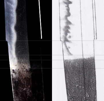

According to Mr. Tanobe a refinished nakago on an old sword means that the o-suriage had been done in the Koto period. This nakago jiri being kiri on the linked sword leaves me thinking that perhaps it was shortened later. Below is another Bizen Kamakura naginata naoshi nakago with a refinished nakago jri.

I'll insert my two bits (8 bits, byte?)
1. Nagamaki is a koshirae classification, not a blade classification. This is stated by Sato Kanzan and as well it is backed up by NBTHK papering practice. You have a similar thing with tachi, people want to call an old blade a tachi even if it is suriage mumei and it is no longer a tachi once it is made suriage mumei. But, if you put it into tachi koshirae now you have a tachi again. If you have enough nakago left that it is super close to original, you can call it a tachi, or if it retains its mei. But tachi refers to the style of wearing it, and the condition of the blade makes implications to how it's supposed to be worn. So, this is not a nagamaki. Similarly too daisho is a koshirae classification, the blades by themselves will not be considered daisho-token without the koshirae unless it's absolutely certain they were made as a matched pair, but if you match any old swords with proper koshirae you have a daisho. By themselves they are very, very rare (daisho token) and the NBTHK only designated 26 as Juyo and one as Tokubetsu Juyo (free beer for an evening at DTI to the first person to guess who made it).
2. The blade then that goes in a nagamaki is a naginata. The blade is not a nagamaki. Since there seems to be a remarkable difference in the shape of the blade that has gone into each, it becomes a confusing topic because we want to give it a special name. For a topic that has a couple thousand terms for micro-observations it's surprising that this is something that is glossed over. But in the end neither naginata nor nagamaki, especially ubu ones, are all that common in what has been left to us. One thing to bear in mind though is that there are old Kamakura period blades that are difficult to classify as being intended for one use or another. When we see something like the one here with a yokote the gut instinct is nagamaki and you see something like the Tadayoshi naginata on my site and it's clearly naginata.... but this is Edo period stuff and doesn't cover the whole history of naginata. A lot of which was lost. So in their refusal to make a clean distinction other than by pointing at what is very obvious (koshirae) there may be some wisdom, because those old examples that do exist but that we rarely see, are a classification issue. The Kunimune on my site is ubu in the kissaki and suriage in the nakago. it's not 100% clear what that blade would have been set up to be used as. It could have been in nagamaki koshirae (there are similar ubu blades that are Jubi and in nagamaki koshirae) so it would have been a nagamaki. If we want to look at the "sword like" upper and use that, we could say it has no yokote so it's not a nagamaki, but that then is backwards from the classification ("long wrapped handle") and what it means. So, my feeling is just that in the end you had polearms and you could mount them how you wanted to use it and probably there was some utility in making a blade that you could mount longer or shorter. Then your product can sell to two different customers with two different needs. From the swordsmiths' perspective then... it makes no sense to  *always* have a clear cut boundary between one or the other. And it seems that differentiation is something that may start in the Nanbokucho period. Modern naginata fighting also seems to be set up more as we would imagine nagamaki fighting, which further blurs any rationale between separating them based on whether the upper is "sword like" or not. If you put a sword like thing on a super long pole for keeping cavalry at bay it's going to be used for a purpose that is different from a flared head on a long tsuka meant for hand to hand combat. What the user prefers is probably what the user prefers rather than you must have one vs. the other if you're going to do this.
3. The NBTHK never used "Nagamaki" on any Juyo blade. They have on koshirae. Three times. The commonality in these is that the tsuka is shorter length than the nagasa of the blade. However this has happened on koshirae classified as naginata koshirae. More would pass if they existed probably. There are a lot more Edo naginata koshirae than nagamaki koshirae from all periods. Does this tell us something? Probably. Maybe. Another side note is that the oldest nagamaki style koshirae have no wrap. Nor do many old tachi koshirae. No same, no wrap. So it tells us something, that nagamaki is a term that comes about long *after* the invention of this type of polearm mounting. This is another strike against using the term to describe the blades.
My opinion: consider nagamaki to be a style of koshirae and if anything, informally, consider the blades a proper subset of naginata.
4. Naginata Naoshi: Jacques is kind of right in my opinion but he's technically wrong (the worst kind of wrong). Naginata-naoshi does not mean the tip has been modified. If you take a naginata and make it suriage, it would seem to logically follow that what you have is a "suriage naginata" but that would still be a polearm. If you cut 10cm off of a 60cm nakago, what do you have? Suriage naginata. Still goes in a pole. If it has been converted to katana use, now you have a naginata-naoshi katana. The term is not complete without the thing it's been converted to. In this case the papers say naginata-naoshi wakizashi. If it were longer it would be a naginata-naoshi katana. These classifications remember are based on intended use of the blade as it is. Like tachi becoming katana if you have nothing left on it that indicates it was to be used, now, as a katana. This is a naginata converted to wakzashi use: naginata-naoshi wakizashi.  This says nothing about the boshi whatsoever. It may be original, or not. Similarly a katana is a katana regardless of modifications to the kissaki. All we care about is that the boshi is not interrupted.
5. The NBTHK where they have been lax is in documenting the naginata-naoshi-ness of a blade, not the nagamaki/naginata divide. On that they have been clear, though I can't speak for lesser papers. Just 13,000 Juyo papers. The laxness then is in that a blade will be sometimes described as a katana and it is a naginata-naoshi katana. The intent is not clear: changes in attribution style over the years, or uncertainty that it was made like this or not. I think personally having looked at this stuff time and again is that it is just changing attribution style over the years. Mid 70s they would be more likely to just call this a wakizashi and today it would always be a naginata-naoshi wakizashi.
6. I tend to think the boshi is OK and this is how it was made -however- Franco is speaking from I think a general sense that an Edo period naginata is going to be about this size with a flared head, and something in this shape is kind of an oddball if this is the original length. It doesn't quite fit the model for sitting on the end of a long pole nor in a nagamaki koshirae. That doesn't mean this is not legit ubu kissaki, just saying I sense the roots of his disquiet.
7. I can't speak to naga-gatana directly but sounds to me like a typical Japanese contraction (Juyo Bijutusuhin mouthful becomes Ju-bi, Tokubetsu Juyo mouthful becomes Toku-ju, Naginata-naoshi katana mouthful becomes naga-gatana, much easier to say... I am just guessing though).
8. Always keep in mind that a lot of this stuff is a moving target. When we refer to old books or references you need to teleport back in time to whatever was the convention at that time when that thing was documented. When looking at Juyo Bijutsuhin they will commonly call blades tanto though they are in the 30-35cm range. These would all be called wakizashi currently *though* there have been exceptions to that (again depending on who was piloting the ship at the time). I'm just  pointing out that conventions change and people will stray from trying to conform to something that is a logical, objective standard, like a wakizashi is between 30 and 60cm (or, 30.3 and 60.6cm), period, and we need to be blind as to what we're seeing... because nobody can argue about the length and we want to have objective classifications. That is one side of the argument, and the other side of the argument, is, "Please don't tell me that this blade at 29.9cm is a tanto, and this one at 30.1cm made within 5 years of the other is a completely different classification as a wakizashi." So you need to keep the dualities in mind whenever you're looking at what is written and reported. If you get locked into the paper or the page in the book or Dr. so-and-so said this so it applies to everything through all time then you blow yourself up. As a side note people in the west like to call 30cm ko-wakizashi "sunnobi tanto" and that actually means tanto that are more than 0.85 sun. So to be consistent if you like to use that term, it applies if the length of the tanto is more than 25.6 cm. After you hit 30 now it's up to you if you want to go old school or new school.
