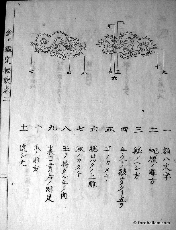

Just for interests sake here are two pages from the Kinko Kantei Hiketsu, 1820, "Secrets in examining metalwork. A guide to the detection of forgeries in the metalwork of the Goto school." (2 volumes)
And this was no private or limited edition printing. Back in the day, books like this, that purported to educate the masses in all aspects of the arts, were hugely popular and common in the major cities of Edo Japan from the start of the 18th century. I imagine they were to be found in most metalwork studios of the period too.
For anyone interested in this publishing phenomenon I'd recommend 'Edo Culture, Daily Life and Diversions in Urban Japan, 1600-1868.' by Nishiyama Matsunosuke.
