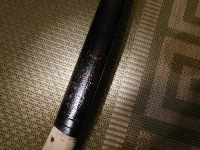

I have had to do some touch up work to the koiguchi area recently and have some rash from the urushi on my left arm; it seems i am very reactive to the stuff. This saya is for a wakizashi project, using black as the base with red accents.

Steve, it looks good, I have a couple of sayas that need some simple touch up work, I wouldnt mind trying to do it myself as it would not be worth the expense to have someone do it for me.
I recommend Namikawa Heibei for their ready made urushi and customer service; I also recommend latex gloves and long sleeves for application. Multiple thin coats rather than thick application will reduce wrinkling, unless that is the look you want. Thanks for the comment and good luck on your project.
