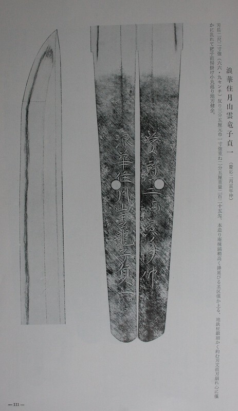

sakura_matsuri_antiques Posted July 20, 2016 Author Report Posted July 20, 2016 The first part of the signature on ura side refers to the person the tanto was forged for (please read extract from Metropolitan Museum volume 5 1972 on Sadakazu value topic). The blade need no polish at all, the photographs have been taken with a mid level camera and show dust on the blade. 4 Quote

Jacques Posted July 20, 2016 Report Posted July 20, 2016 The first part of the signature on ura side refers to the person the tanto was forged for (please read extract from Metropolitan Museum volume 5 1972 on Sadakazu value topic). The blade need no polish at all, the photographs have been taken with a mid level camera and show dust on the blade. That doesn't change the fact that the kao (not the seal) is not the one usually seen on Sadakazu blades. About the seal (stamp) both are used by Sadakazu. Oh, i'm sure at 99% ura bears a nengo.. 1 Quote
sakura_matsuri_antiques Posted July 20, 2016 Author Report Posted July 20, 2016 The seal is absolutely in Sadakazu style, i'd like to remember that this blade has a NBTHK Tokubetsu kicho certificate. On ura side the first kanji indicate the commission, then there's the nengo. Please refer to file attached. Regards, EmilianoExtract from The_Metropolitan_Museum_Journal_v_5_1972.pdf Quote
Jussi Ekholm Posted July 20, 2016 Report Posted July 20, 2016 I know we are not really supposed to comment ongoing sales but I would second Jacques on the date to Keiō on ura side. Also I think it's the same thing on the blade featured in 1972 Metropolitan Museum volume 5 blade that has similar inscription start on ura side. I believe that Keiō is written here is sōsho script similar to this. Here is an actual mei which has Keiō written in similar way: http://iidakoendo.com/1195/ I wish not to hinder the sales in any way. I think it's nice piece signed & dated (at least I think so) and papered. 1 Quote

Jacques Posted July 21, 2016 Report Posted July 21, 2016 On the ura there is a nengo and nothing else... (article is quite erroneous) Quote
