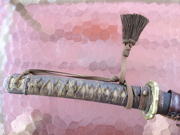

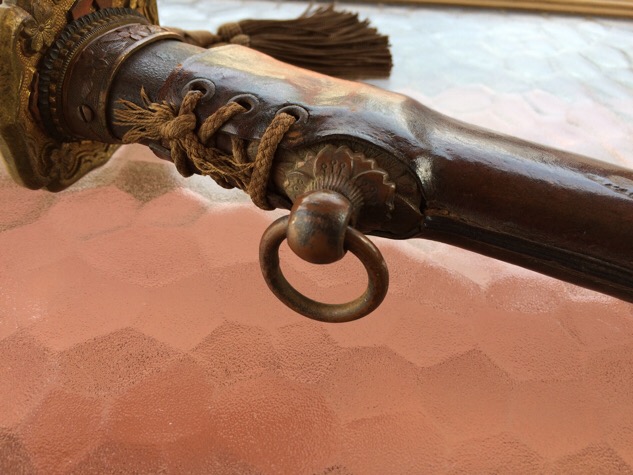

New to collecting ...my first acquisition ...looking for any info ...had the tang fra sales here and was told the sword was made by Hizen Kuni Tadayoshi 9th generation. So is this an old sword that was fitted for military mounts ? Is it an older handmade sword ? Are the tassels correct ? I have no idea what condition the scabbard is in as I'm not sure if I should remove it from the leather cover . Does the length compromise the quality ? It looks well used and the vet who brought it back carved his name in the scabbard (which makes it very personal to me and adds to the story in my opinion )...any info is appreciated !
John C
Welcome!  I'm either missing the picture of the signature or it is not posted so I cannot comment on the translation.  Yes, it does look like an older sword remounted in WW2 Type 98 Shin-Gunto mounts w/ leather combat cover.  Yes, it looks like an older handmade blade to me.  If the tassel came with the sword I would not have any reason to doubt its authenticity, some of the repros seem scary good, I surely can't tell the difference.  It's your sword, if you like the leather combat cover, keep it on, if not, take it off.  You can see the outline of the fittings near the bottom of the scabbard, I would imagine the scabbard is just fine.  Longer swords are generally more desired, but length does not necessarily compromise quality.  Some people like the vet personalized look, others don't.  If you like it, I wouldn't pay any attention to how others feel about it.  Overall, it looks like a nice, clean example.  Far better than my first sword.
John, The tassel looks legit. The all-brown tassel was late-war army officer, generic for all ranks. This does seem to have seen a good amount of use, and if so, it may have been brown and blue, or brown and red; but over time the colors fade. You might try untying that knot to see if there is some unfaded color inside. The pic makes it look like there is just a hint of blue showing in the knot.
Either way, it looks right.

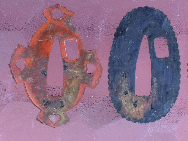

Sorry ...I had posted this pic in the translation section of this site and failed to include it with the other pics ...thoughts ?? Are the marks on the spacers etc proof marks or arsenal marks ...forgive my ignorance of the proper terminology ...still learning the language ...and it IS a whole new language ...been reading a bit and when you say hand forged are you saying in the traditional way or some other way ? Been trying to grasp the "traditional method" vs "semi traditional" vs machine made. Way more involved than what I've collected in the past though WAY more interesting ...thanks again

Can anyone tell me what the markings/numbers on the spacers/hand guards are ? Looks like a small star a number and something that also looks like the number 9...sorry I don't have the nomenclature down yet ...still learning
John C
Hello,
Nice sword and I agree the veterans name carved into the saya adds to the swords appeal...The marks on the washers (seppa) and guard (tsuba) are all arsenal assembly details and when they are all matching it normally means nobody has taken it apart and messed around with the bits.....nice and original as when it was put together in the assembly area but using a traditional old blade.

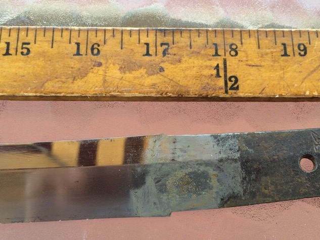

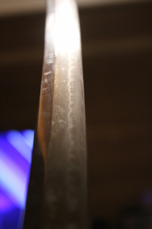

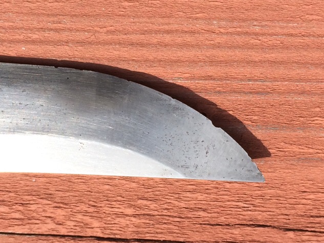

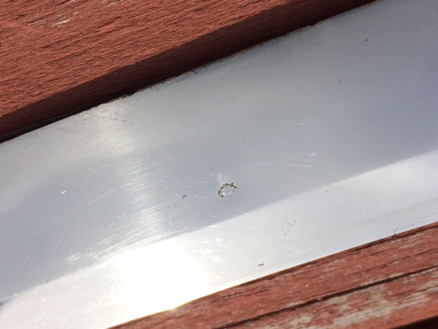

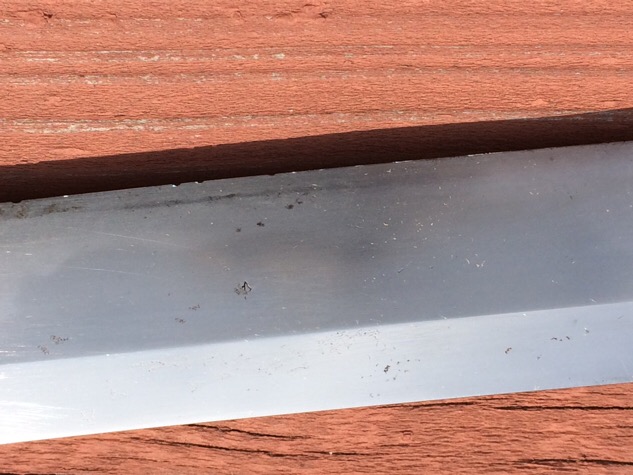

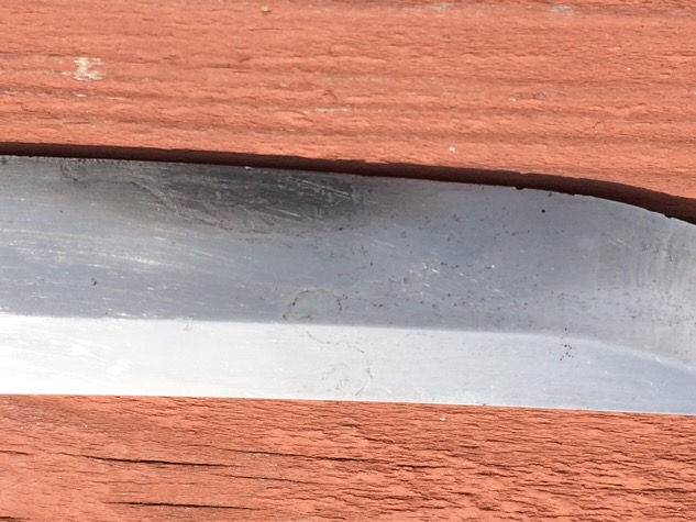

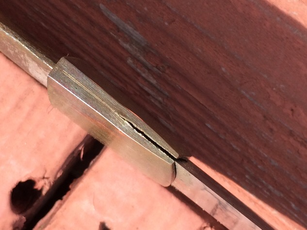

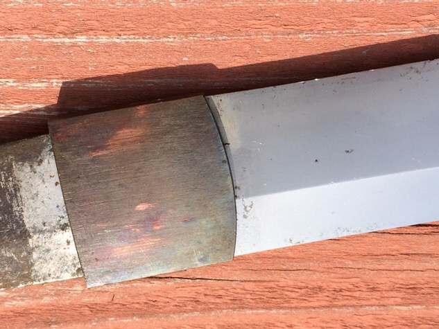

you need to get some really clear close ups of the hole blade, or atleat the best and worst areas.
if you follow the list it may help everyone, just a guide of polishing. normally $1500-2500.
kissaki (tip)
Hamachi and munemachi (were the habaki sits)
the clearest hamon and Ji hada you can photograph
and lastly and cracks, chips, pitted rust and anything odd looking.
this is what you would like your pics to look like (rough guide)
