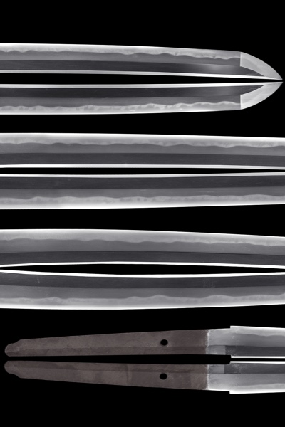

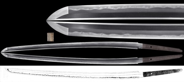

My friend really wants to buy a particular sword from Aoi Art in Japan. He has opted to purchase the following Rai school sword in the links. He would like to know though, if he will be able to mount the sword in koshirae, seppa, habaki, etc.. even though it appears the hamachi has worn away somewhat. He wishes to keep this as an art sword, and also to use it as a swing around sword for his Iaido training, but strictly no cutting.

I assume your friend's main concern is the worn hamachi, and whether this would prevent the fitting of koshirae?
If so, I don't think there is a worry there. There appears enough left to locate the habaki snugly, and a new one would likely be made to fit well anyways. I wouldn't trust it to withstand the rigours of tameshigiri, but as you said, he only wants it for kata etc.
Of course, the best bet is to ask Aoi for their opinion, as they have it in hand and are able to make a better judgement. I don't think the thin edge of the hamachi is nearly as important to habaki fitting as a decent munemachi though, and there is plenty of that left. Just have to make sure to get a good habaki maker if it needs to be replaced.
