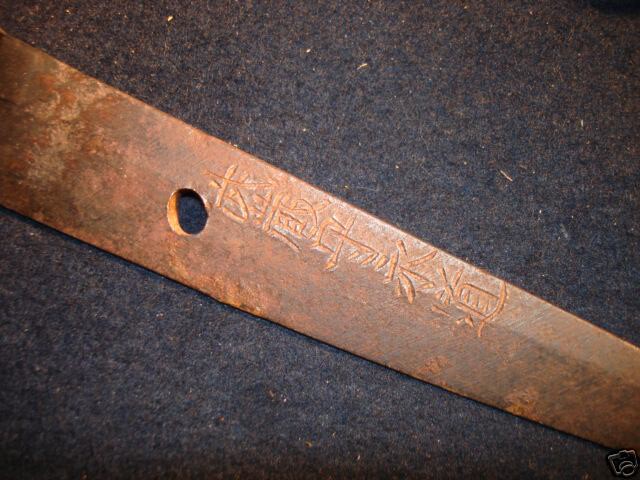

120193468088 Im watching and tempted. But It looks a little too new Any thoughts guys. I picked up a wakizashi the other day and need some advice as to whether it is worth a polish. Its in a good state of preservation. Signed by Nagamichi and has no obvious flaws. The hamon is really hard to see and photo. Im going to have a go with the scanner. Anyway theres no hurry its the Christmas silly season and the visa is going to be streyched to the limit.

I assume this was 2 questions? One about http://cgi.ebay.com/ws/eBayISAPI.dll?Vi ... 0193468088 that you were watching and interested in...and the other about the sword in the pic that you already have?
Hard to say if anything is worthy of restoration based just on the signature.
As you will see on any forum, easy to guess at gimei, but no-one will easily commit to a shoshin for obvious reasons.
I have learned that when looking at signatures, it is much easier to find differences than find similarities with papered ones :)
Brian

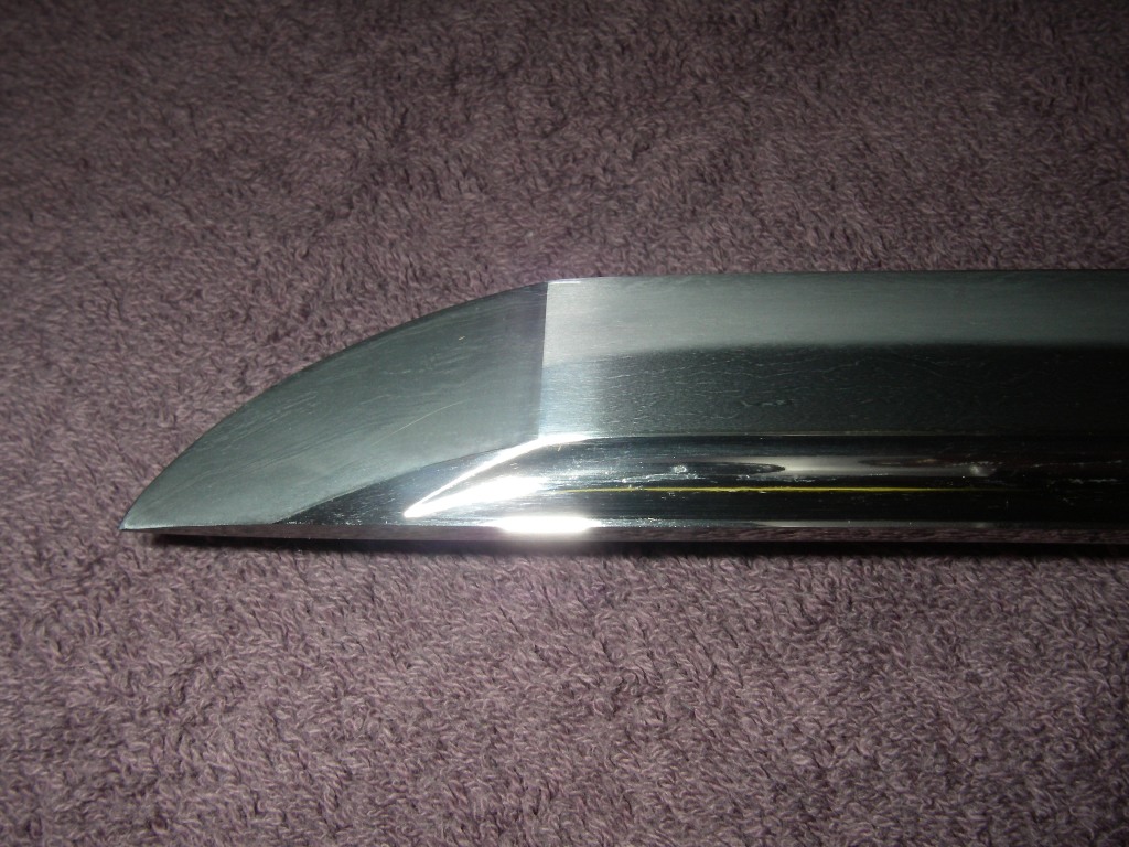

Now, the real tell tale is the hi and where it stops, Here is the Kissaki of my Enju Kamakura katana to compare with
