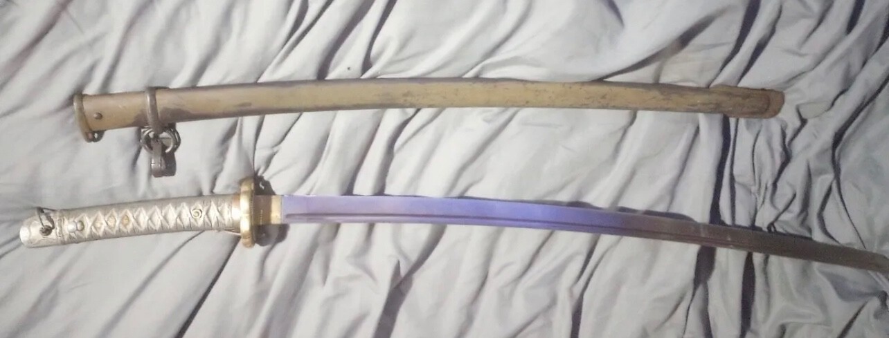

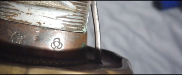

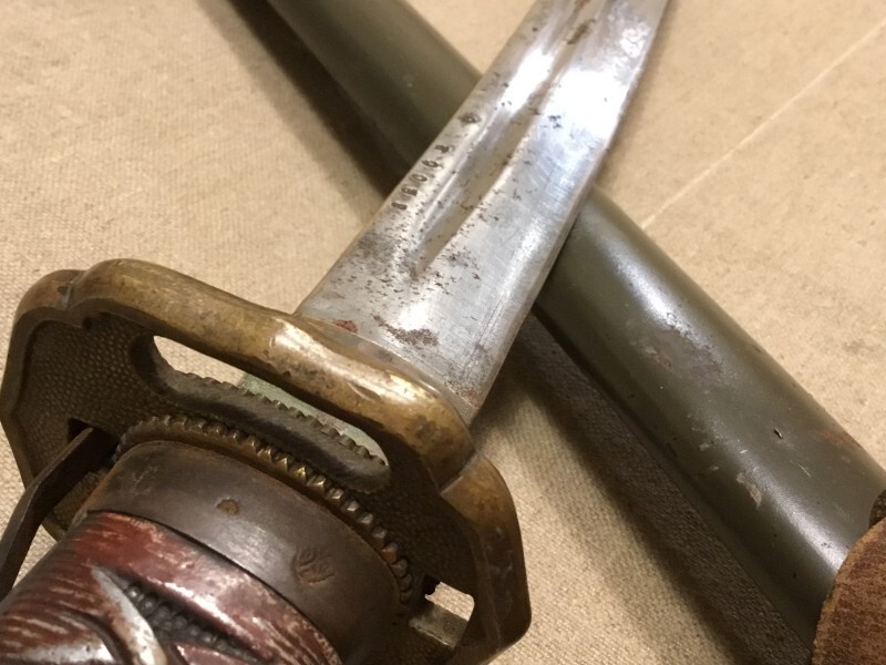

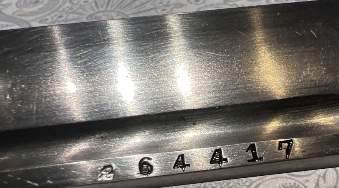

Bruce Pennington Posted November 15, 2022 Report Posted November 15, 2022 Welcome Svein! The Gifu and Kokura stamps looks correct. Haven't seen the fakers imitate the Gifu correctly, yet. The Na on the blade is shaped correctly, but haven't seen one that deep and clear before on a blade. To my eye, the tsuba seems fat. Overall, I'd say legit, but word from @Shamsy and @Stegel would clear up my concerns. 1 1 2 Quote
APINorway Posted November 15, 2022 Report Posted November 15, 2022 2 hours ago, APINorway said: 1 Quote
vajo Posted November 15, 2022 Report Posted November 15, 2022 The nanako of the tsuka looks correct too. It seems to be a nice sword. If you have any doubt i would take it. What you see here. The stamps are perfect The coloring is perfect The niage patination of the fuchi is perfect The nanako is positive not inverse - perfect The etched hamon looks very nice. The numbers are correct. The stamp is correct. Btw you made excellent pictures by light and sharpness. Thanks for asking and showing it. 1 3 Quote
APINorway Posted November 16, 2022 Report Posted November 16, 2022 Vajo and Bruce, thanks alot for information and confirm. I’m looking forward reading and looking at all this great site. all the best Svein K. 1 Quote
Shamsy Posted November 18, 2022 Author Report Posted November 18, 2022 On 11/15/2022 at 11:50 PM, APINorway said: Hi all, i’m a newbi here. And I hope I can get some help on this Type 95 NCO sword. was told is original , but ? Pretty much what the others have already told you. Lovely sword, well worth getting if the serial numbers match. 1 1 Quote

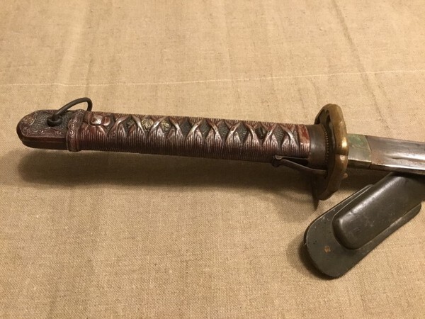

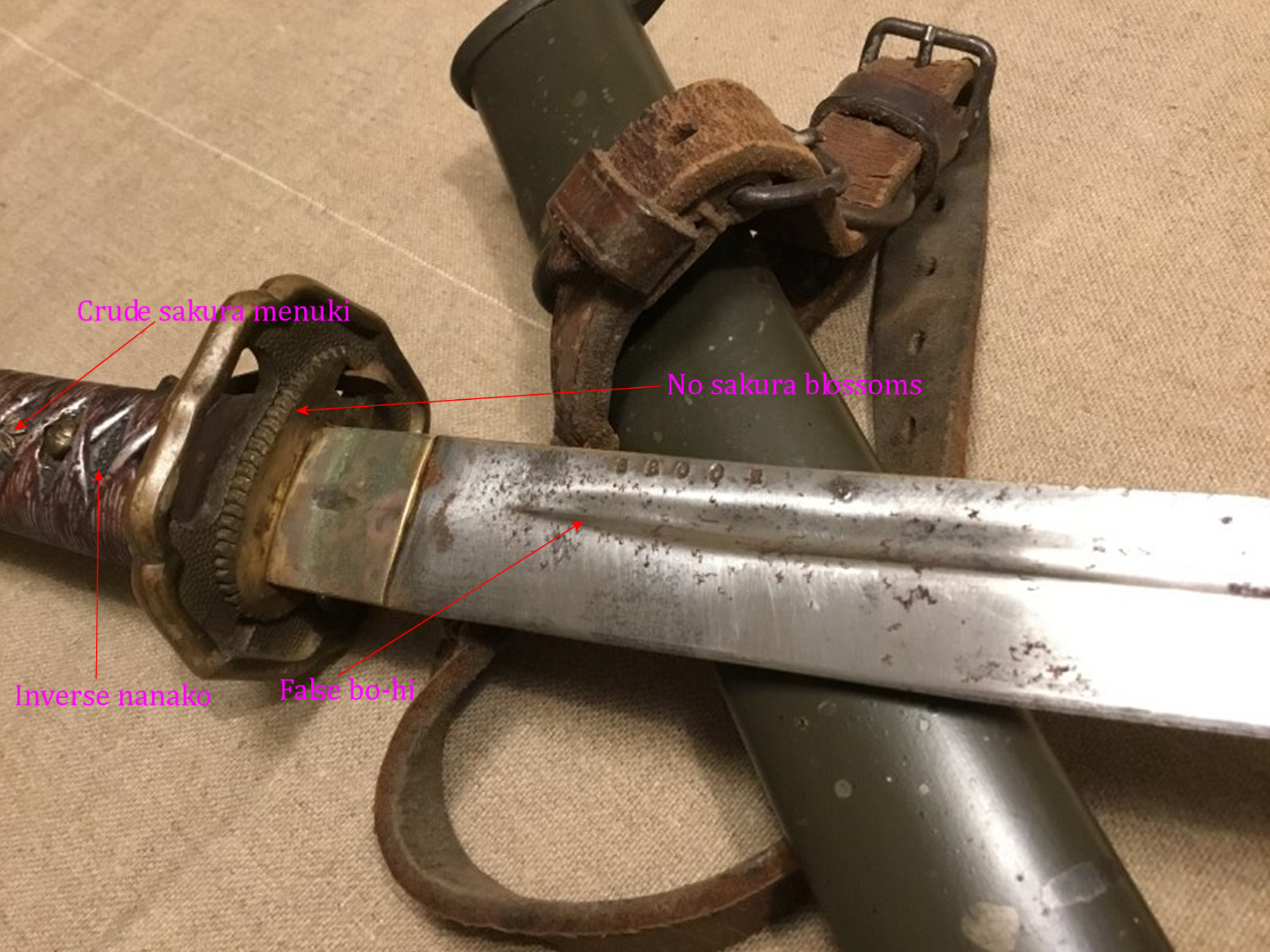

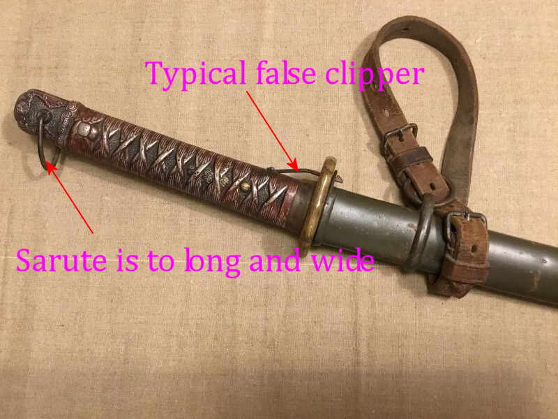

IAMAWIZARD Posted December 1, 2022 Report Posted December 1, 2022 Hi there! I also found one I´d say is fake. What do you think? Quote
vajo Posted December 1, 2022 Report Posted December 1, 2022 Looks like one of those fake swords we see the last time. The most looks new, but this was faked too in a garage or wet cellar or stored in bad conditions. btw the old dog collar is nice Ah i found it. Its egun. Gunto NCO Katana Type 98 - eGun 353 EUR, 28 bids, 3days left. 1 1 Quote
Shamsy Posted December 2, 2022 Author Report Posted December 2, 2022 Just looking at that belt-sander bohi should be enough to make anyone shy away. The tsuba is really thin too. Guess price inflation of brass is hitting the repro market hard. 2 Quote

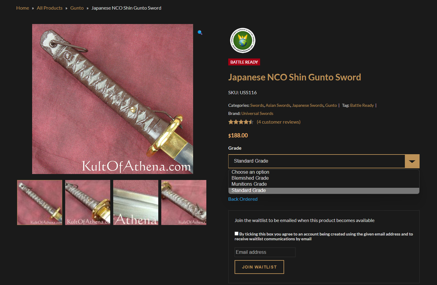

vajo Posted December 3, 2022 Report Posted December 3, 2022 They cost $50 more than bevor the ukraine crisis. Those came from india. Made by universal swords. You can choose the altered grade. 1 Quote
