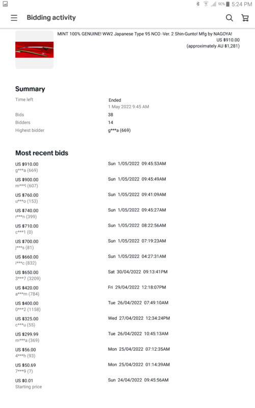

robinalexander Posted May 1, 2022 Report Posted May 1, 2022 Well the results are in ....Whiskey Tango Foxtrot ....38 bids US $910 1 1 1 Quote

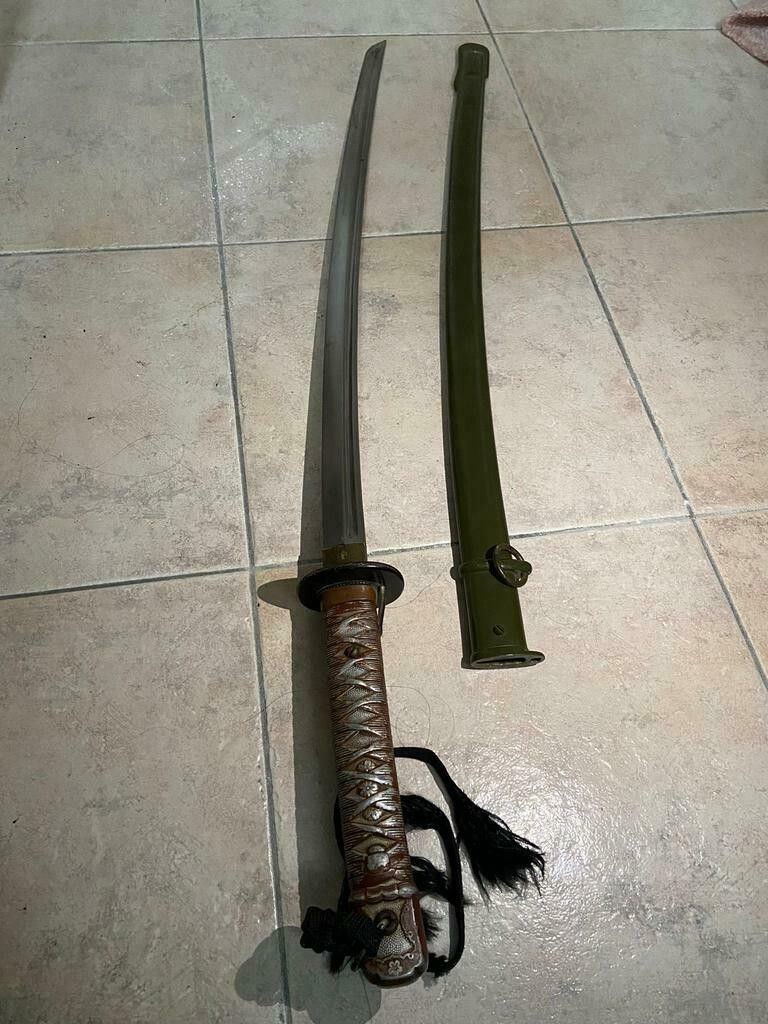

Bruce Pennington Posted May 9, 2022 Report Posted May 9, 2022 @Shamsy @Stegel may correct me, but this one is legit! I would even love to see if the paint is war-era or new. It has both the gold and red colors that seem to have significance. We are starting to believe that some of these painted gunto were done by the soldiers themselves. An interesting piece. 1 Quote
Shamsy Posted May 9, 2022 Author Report Posted May 9, 2022 Completely legitimate. I would look for a nicer example though, unless you want one which was repainted at some time for some reason (we can guess, but have no idea really). A great example is not hard to find, there have been a few listed recently. 1 Quote

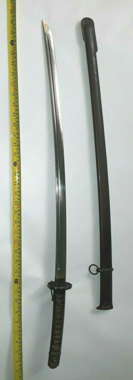

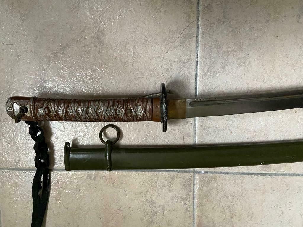

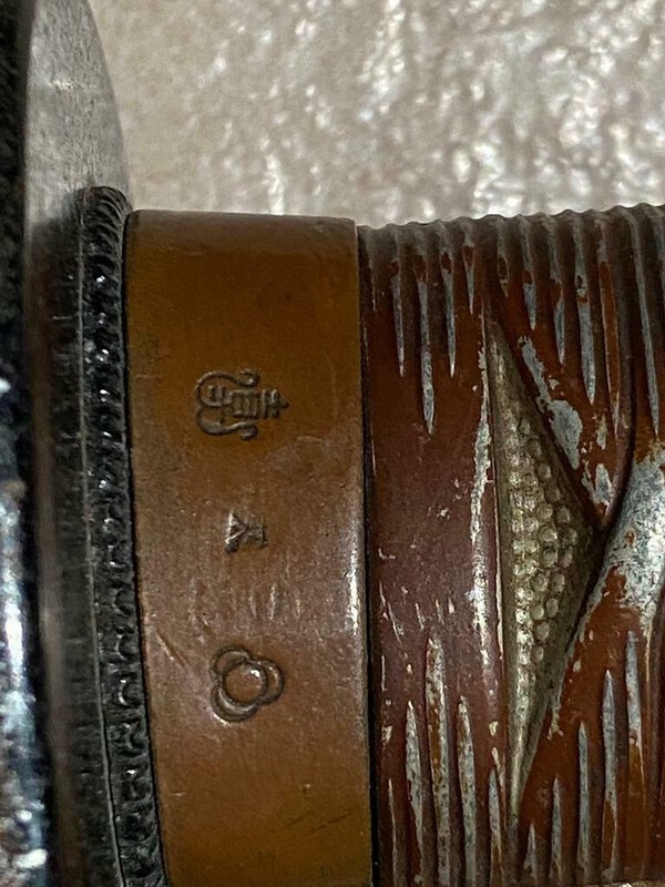

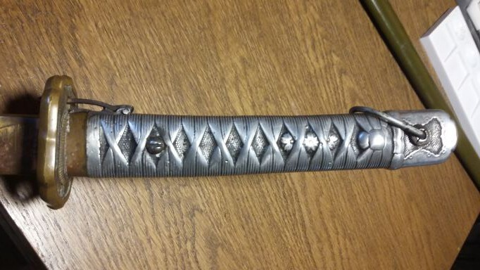

Alienasa Posted May 14, 2022 Report Posted May 14, 2022 Hey guys. I found this one on a local listing in Europe. What do you guys think? Genuine or fake? The seller of course says it's genuine however the numbers on the sword and scabbard aren't matching so maybe real sword, fake scabbard? Images aren't any sharper unfortunately. Quote
Shamsy Posted May 14, 2022 Author Report Posted May 14, 2022 Completely legitimate. Unmatched numbers are a detractor though. On the plus side, you get the extra stamp on the reverse side of the fuchi. Quote
Alienasa Posted May 14, 2022 Report Posted May 14, 2022 4 minutes ago, Shamsy said: Completely legitimate. Unmatched numbers are a detractor though. On the plus side, you get the extra stamp on the reverse side of the fuchi. Nice. Thank you. What would be an acceptable price for the sword in this condition? The seller has posted a minimum of a €1000. I guess we should also keep in mind that in Europe these swords are maybe not as common as in the states or indeed Australia. Also with the mismatched numbers and all. Quote
zook Posted May 14, 2022 Report Posted May 14, 2022 IMO - that’s too much money to pay for a mismatch ( in the states ) , I’m not sure that the European market holds for NCOs, but I acknowledge that militaria prices generally run higher in Europe ., based on other items I track. 1 Quote
Alienasa Posted May 14, 2022 Report Posted May 14, 2022 20 minutes ago, zook said: IMO - that’s too much money to pay for a mismatch ( in the states ) , I’m not sure that the European market holds for NCOs, but I acknowledge that militaria prices generally run higher in Europe ., based on other items I track. What would you pay in the states for something like this. 6 or $700 ish? Quote
Stegel Posted May 14, 2022 Report Posted May 14, 2022 Currently €1000 = US$1041 , which makes me agree with zook, a bit on the high side for mismatched sword. If it was matching, it would be around the average going price at the moment in my opinion. Of course your market in Europe tends to be higher, but you could always make an offer €900 perhaps? 1 Quote
robinalexander Posted May 15, 2022 Report Posted May 15, 2022 B. Its a nice example but agree 1000 euros is too high. The pics are not great, but does anyone else think the saya could be a repaint? If so, the price must come down. Things to think about...... 1. The previous version (brass tsuba) is, imo, a nicer collectors item if your going to get only one 95. 2. Will you be happy with unmatched numbers? The more u get into this, the more choosy you become....so consider saving your money on this sword and wait for a reasonable and matched Type 95 (regardless of version). 3. Again, I agree 1000 euros is just way too much and the saya may be genuine but if its a repaint (????) its worth less. I think your estimate of US 600 to 700 (or equivalent) would be at the top end of market price for this sword in Australia. Rob Quote
Alienasa Posted May 15, 2022 Report Posted May 15, 2022 To reply to some of your points @robinalexander. I'm afraid in the European market I can't be too picky about what I want. Indeed a brass handle, matching numbers and all would be nice however those don't pop up frequently here. Also if they do the price will be significantly higher I'd Imagine. I'm a novice when it comes to swords and I don't own any yet at the moment so I'm not looking to spend 1500-3000 now. I do also suspect the saya to be a repaint. I understand the large majority of them are quite scuffed and scratched up which is part of the patina. Seeing one this nice and green does raise an eyebrow. I think I'll do a bid on this of €750 with the argument of the mismatched numbers and possible saya repaint. Hopefully the seller will take me seriously. Quote

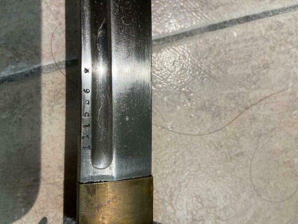

Bruce Pennington Posted June 7, 2022 Report Posted June 7, 2022 Another Iijima fake at a JB Militaria Auction HERE. '51334' so still keeping in the 30xxx - 50xxx numbers series. 1 Quote

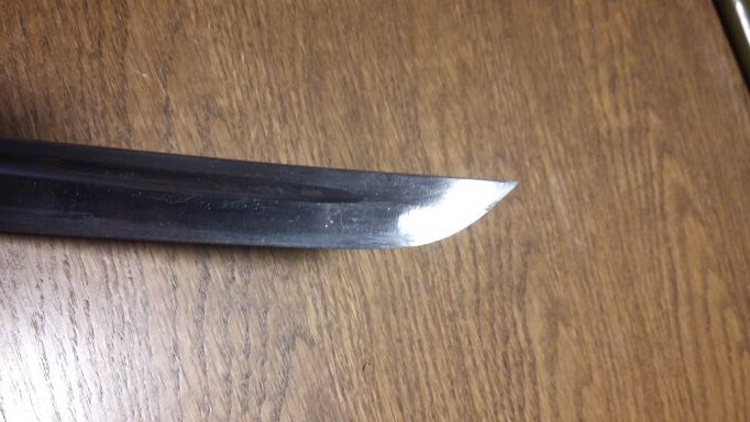

Shamsy Posted June 26, 2022 Author Report Posted June 26, 2022 Not a bad one, but the numbers and bohi are a good give away. 1 Quote

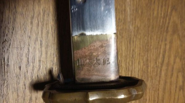

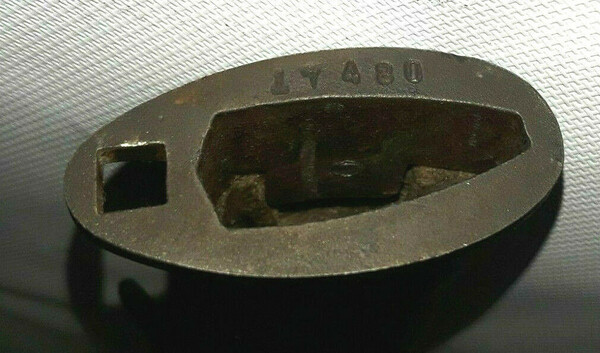

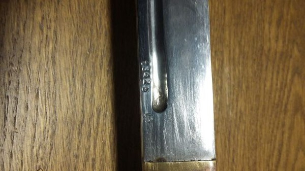

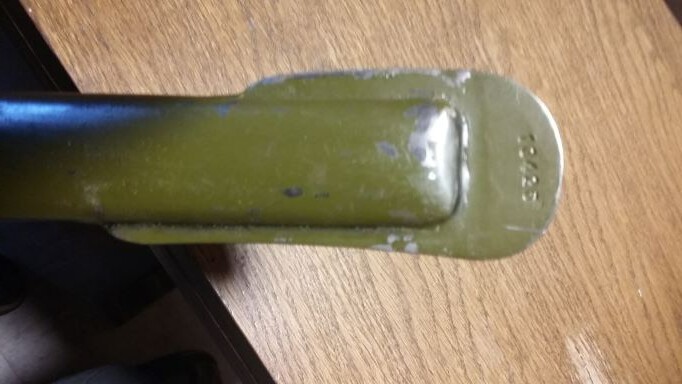

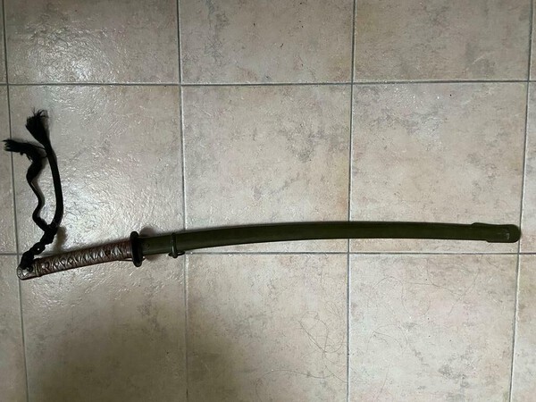

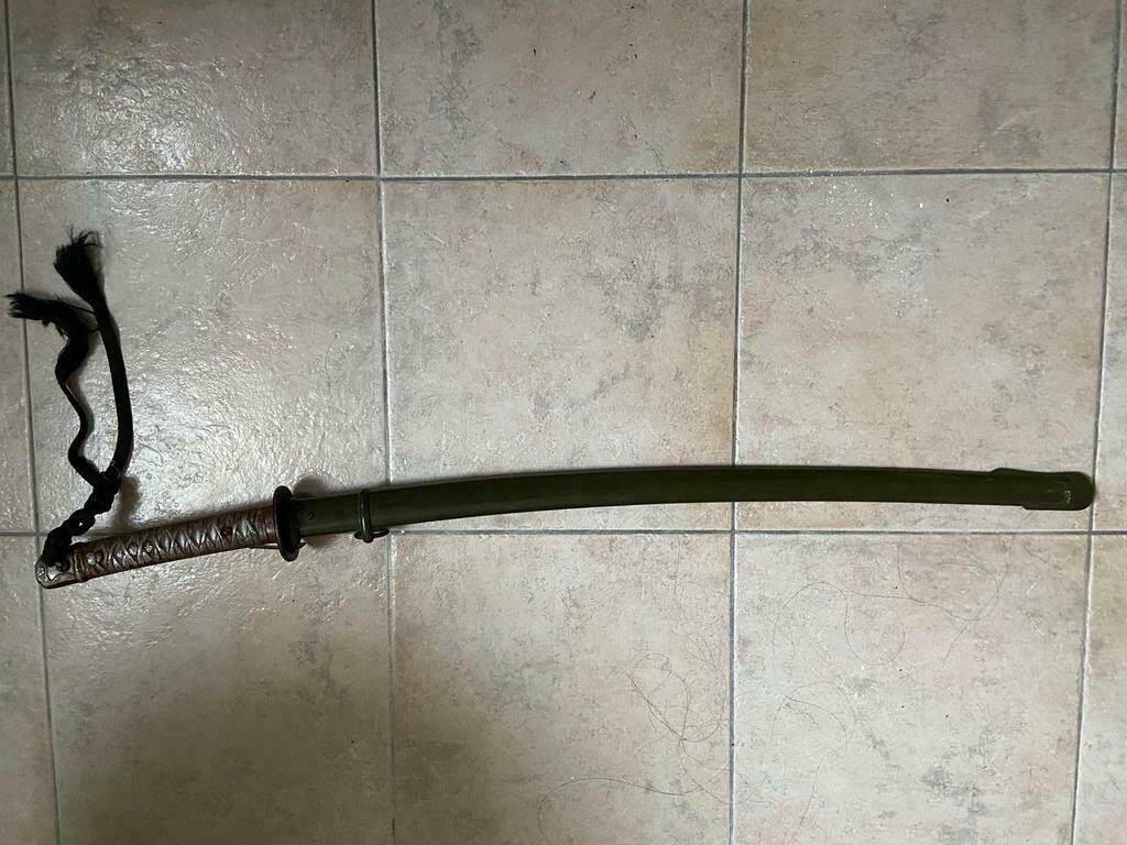

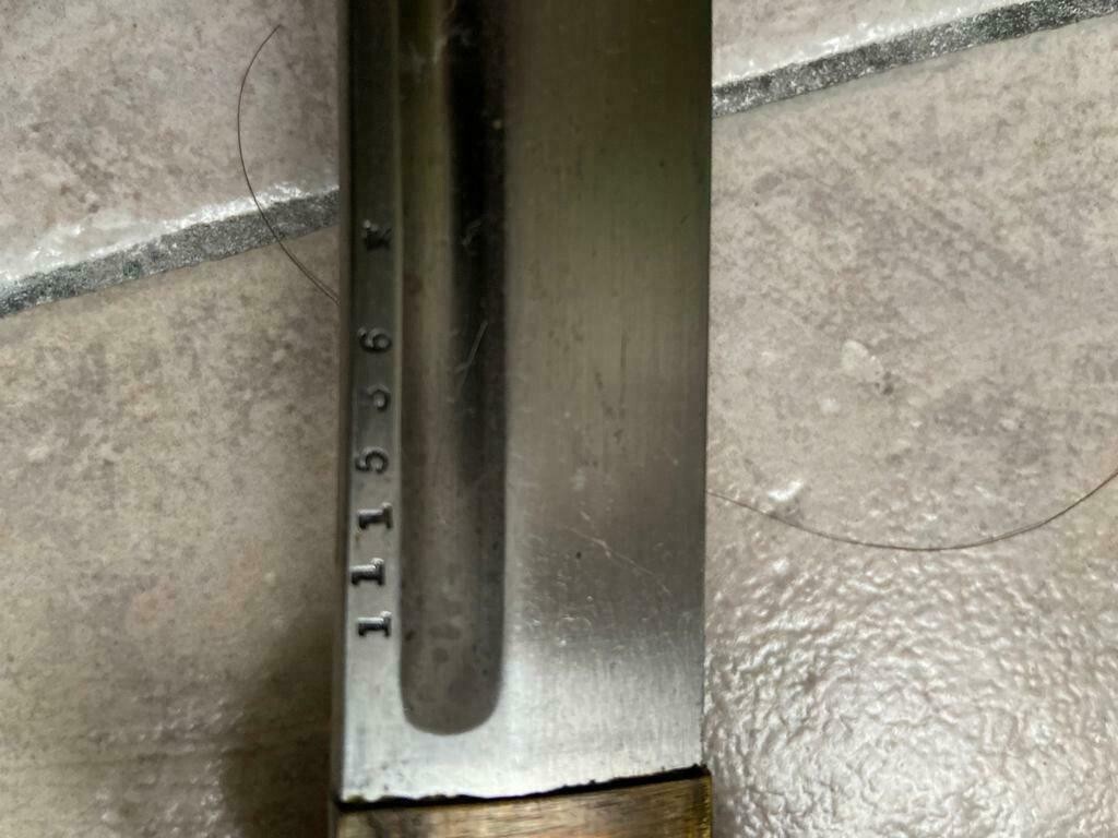

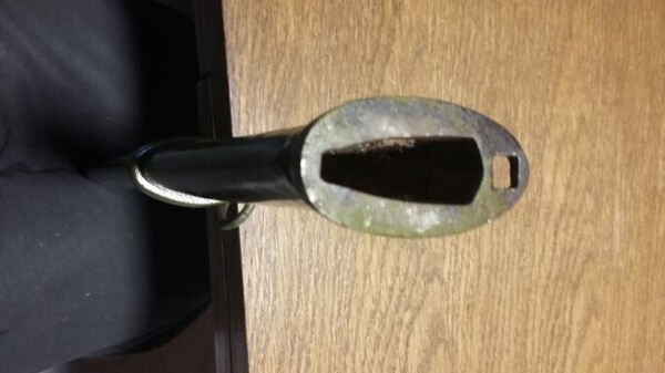

Ironheade71 Posted June 30, 2022 Report Posted June 30, 2022 Hello Found this Site by looking for information about my Type 95. Can somebody tell me if its a Fake? There are some parts that have different serial nummbers. Thanks and Greetings from Switzerland Quote
paul griff Posted June 30, 2022 Report Posted June 30, 2022 Hello Markus, It’s a fake 100%..... Regards, Paul.. 1 1 Quote
