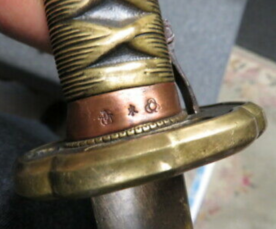

Stegel Posted December 29, 2019 Report Posted December 29, 2019 From what i can see, Scabbard is obviously non genuine. Blade IMO is Authentic, fonts,patina and all. Handle has been repainted, tsuba and fuchi over polished, and good reproduction tassel added. The fuchi has correct stampings for that serial number range, so i would put any reservations of the suya stamp down to over polishing and possible photography being not the best. 3 Quote

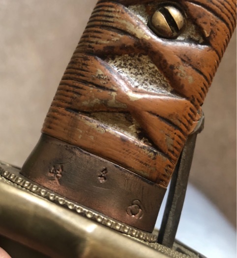

Shamsy Posted January 3, 2020 Author Report Posted January 3, 2020 A Chinese fake of a Gifu marked NCO. The main three tells here are the bohi, the placement of the saya ring and the quality/fonts of the stamps. 1 Quote
Bruce Pennington Posted January 4, 2020 Report Posted January 4, 2020 Boy, they are getting better at the Kokura stamp! Quote
zook Posted January 4, 2020 Report Posted January 4, 2020 That's exactly what jumped out at me Bruce! ... the spacing is still off, but that stamp used to be an easy give-away, but this sample .... whew ! Quote

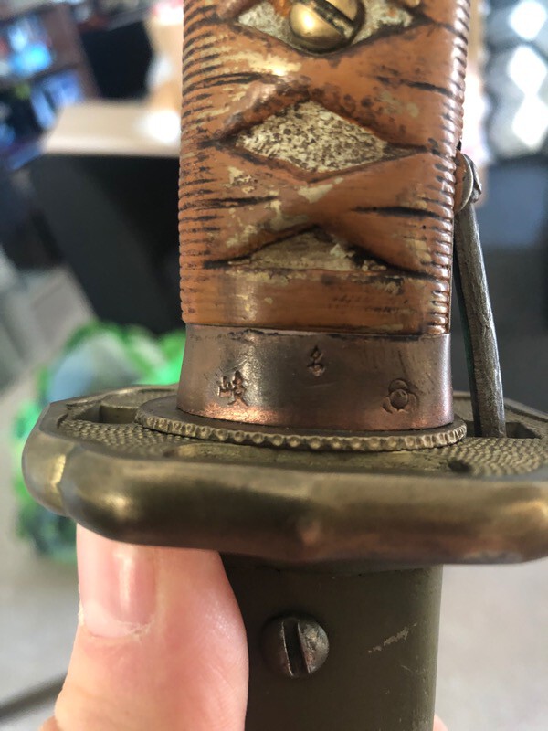

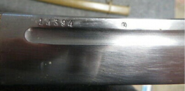

Shamsy Posted April 18, 2020 Author Report Posted April 18, 2020 There's nothing really new about the construction of this sword that makes it any less obvious as a Chinese fake, but the stamps are really halfway decent and worth sharing. 1 Quote
zook Posted April 21, 2020 Report Posted April 21, 2020 Based on Steve's last post, I can only imagine (sarcastically) some guy in a remote shop, somewhere in China saying, " with everyone working from home, I have time on my hands ... I gotta get these stamps looking better!" ... can definitely see steady improvement in the copies, especially if one looks at all the historical posts and just looks at the trend of improvement. 1 Quote

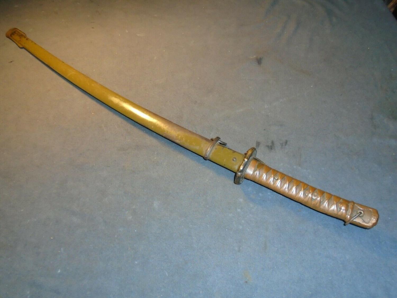

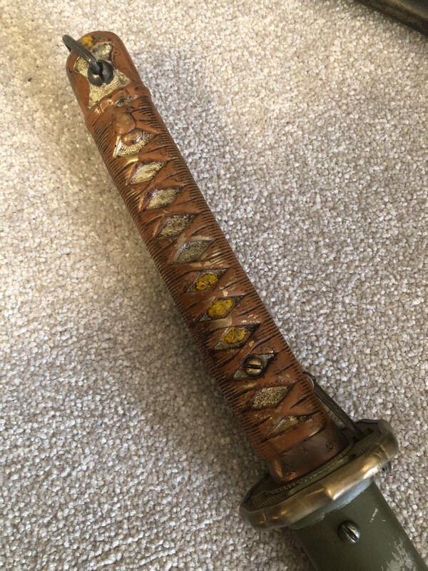

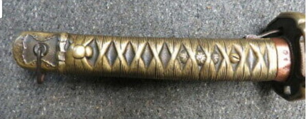

PNSSHOGUN Posted April 26, 2020 Report Posted April 26, 2020 What do we make of this one from our old friend? https://www.ebay.com/itm/Japanese-WWll-Army-officers-NCO-sword-copper-handle-mountings/233570732916?hash=item3661e68b74:g:weMAAOSwsEtepNo2 Quote
Ontario_Archaeology Posted April 26, 2020 Report Posted April 26, 2020 Doesn't look too bad. Also isn't 1766 (blade) an extremely low production number? An argument can be made that the unmatching scabbard is a replacement during war time. Quote
BANGBANGSAN Posted April 26, 2020 Report Posted April 26, 2020 I saw a few of these Copper handle with extra screw on the handle before,maybe wartime replacement? What do we make of this one from our old friend? https://www.ebay.com/itm/Japanese-WWll-Army-officers-NCO-sword-copper-handle-mountings/233570732916?hash=item3661e68b74:g:weMAAOSwsEtepNo2 s-l1600.jpg Quote
Shamsy Posted April 26, 2020 Author Report Posted April 26, 2020 I believe Stegel and i share the same opinion. Some of these have been added post war, but a few are genuine. The sword you've provided as a reference, Trystan, is one of the genuine examples. That is a genuine copper handle and blade but with a replacement tsuba. As the pattern 1 tsuka is thicker than usual, the few replacements of iron I've seen have usually been thicker themselves. They also have the second screw added, which I will speculate occurred when the tsuba was replaced, likely at an arsenal. However, a number of copper tsuka have been sold in the last two or three years. When they turn up on a pattern 2 or 3 sword, I call shenanigans. I know monkey has also swapped parts around, including coppers, which was posted as an example somewhere on this forum. Short version: some genuine, some not. All genuine ones seem to also have iron tsuka replacement, but the rest of the sword is full pattern 1 parts. Anything else, be very suspicious. 3 Quote
BANGBANGSAN Posted April 26, 2020 Report Posted April 26, 2020 Steve I agree with you.Some of these swords are genuine, some not. To me, as long as the numbers on the blade in the right range, changed iron guard, or add a screw on the handel(either wartime repair or later work) is still considering the first pattern but not fully original.Copper Handel with the high numbered blade is not. I believe Stegel and i share the same opinion. Some of these have been added post war, but a few are genuine.The sword you've provided as a reference, Trystan, is one of the genuine examples. That is a genuine copper handle and blade but with a replacement tsuba. As the pattern 1 tsuka is thicker than usual, the few replacements of iron I've seen have usually been thicker themselves. They also have the second screw added, which I will speculate occurred when the tsuba was replaced, likely at an arsenal.However, a number of copper tsuka have been sold in the last two or three years. When they turn up on a pattern 2 or 3 sword, I call shenanigans. I know monkey has also swapped parts around, including coppers, which was posted as an example somewhere on this forum.Short version: some genuine, some not. All genuine ones seem to also have iron tsuka replacement, but the rest of the sword is full pattern 1 parts. Anything else, be very suspicious. 2 Quote

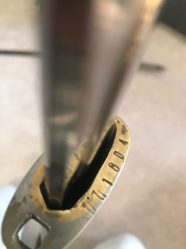

Shamsy Posted June 24, 2020 Author Report Posted June 24, 2020 This deserves a place here as a side note that while uncommon, the restamping of saya to match the blade does happen, when two unmatched pieces are slapped together. It's shoddy work. The parts are original, but the sword has now been doctored to appear as something it isn't to deceive the buyer and attract a higher price. Quote
