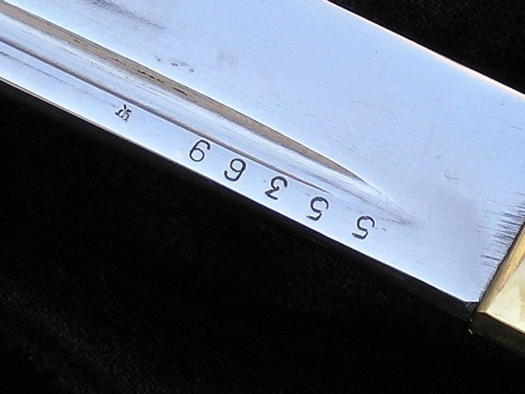

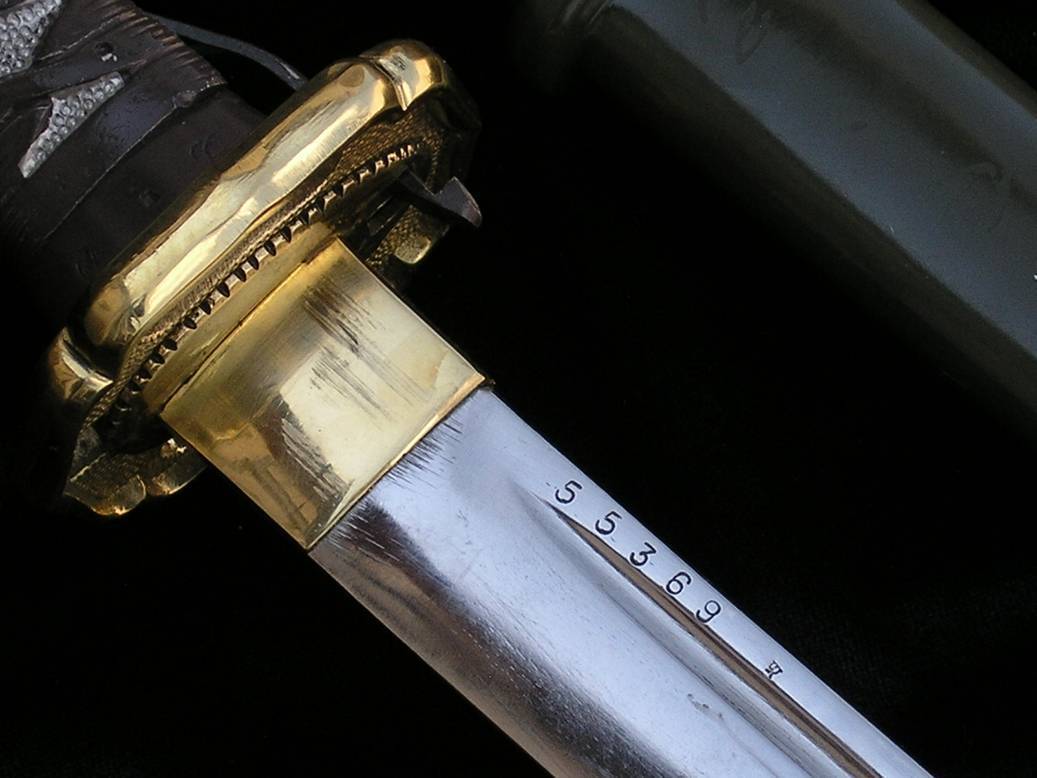

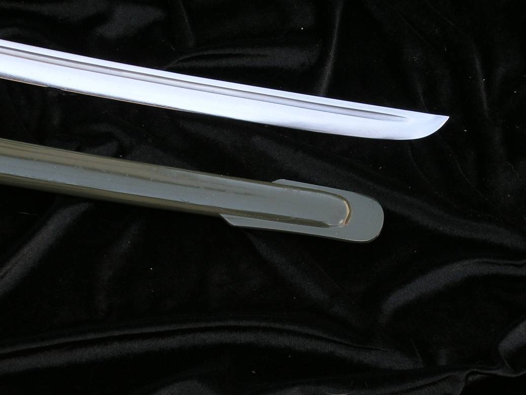

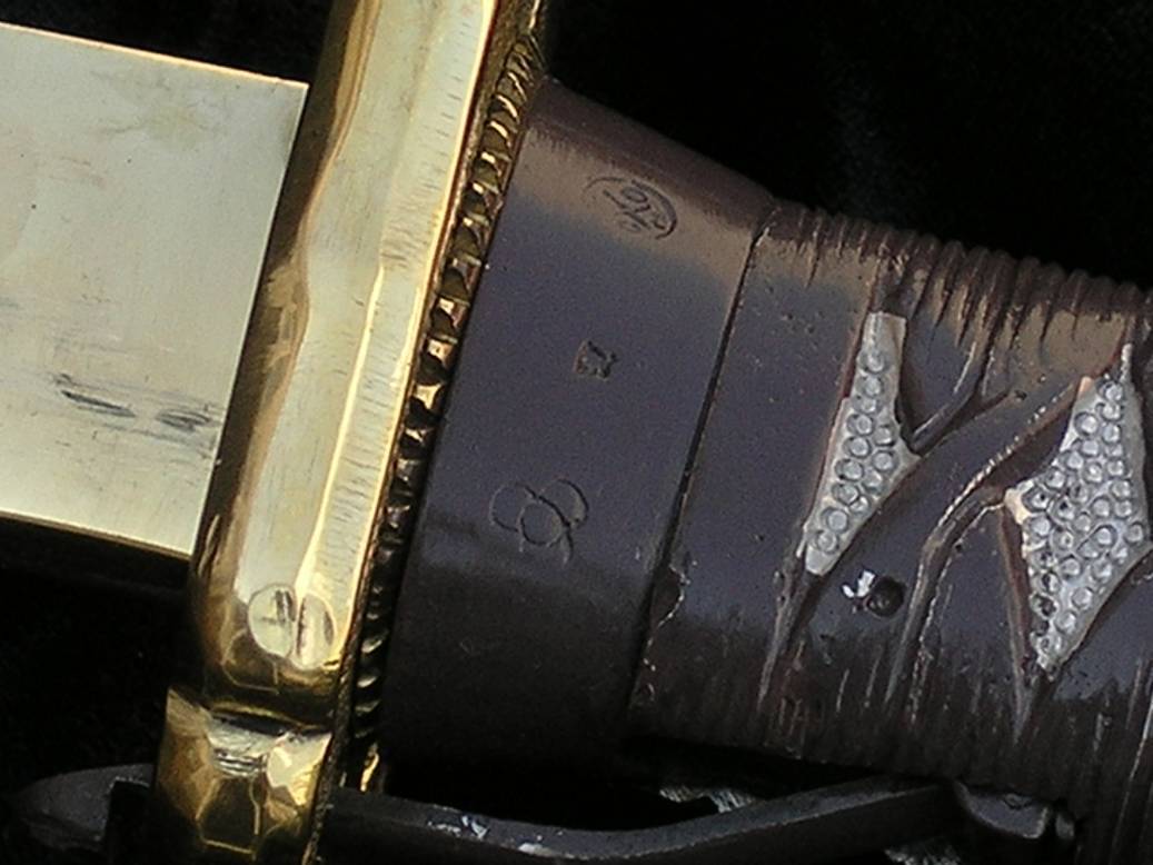

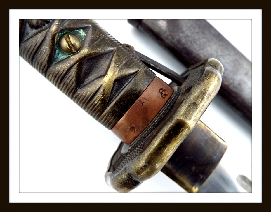

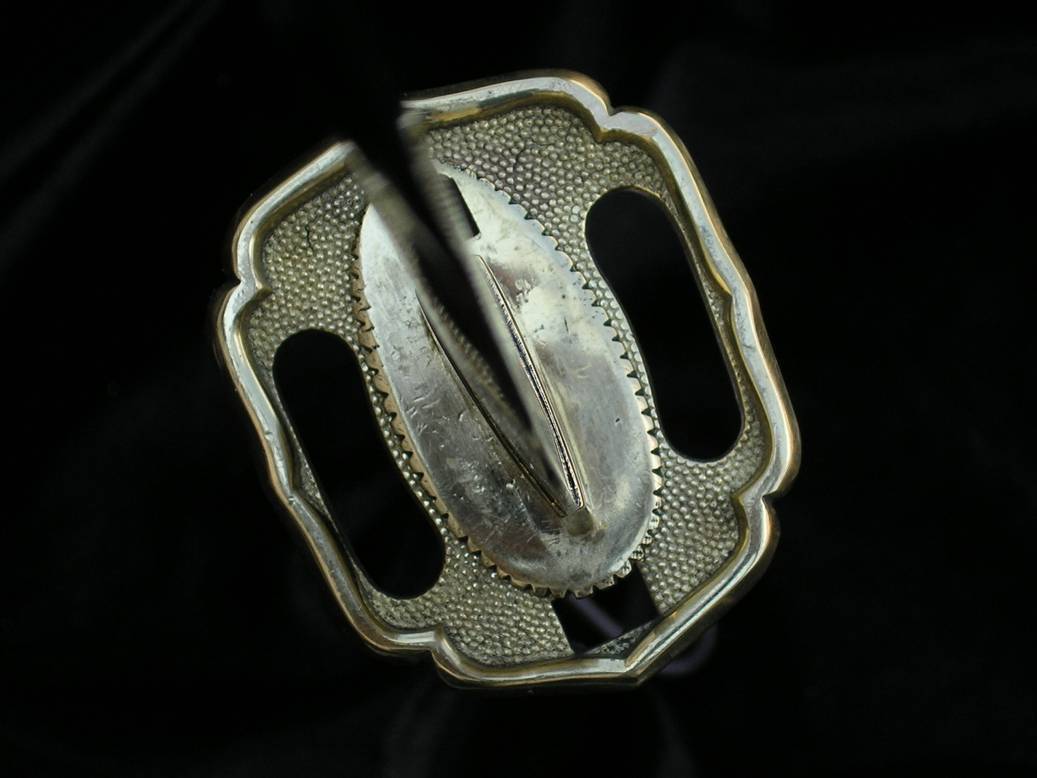

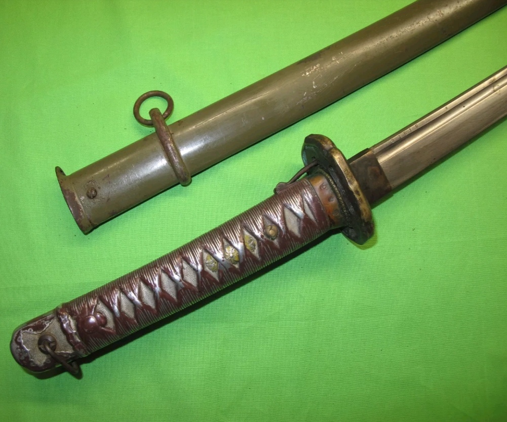

Shamsy Posted October 26, 2018 Author Report Posted October 26, 2018 Good morning everyone, I've seen one of these before, but not so well 'aged'. They're pretty good really, but there's obvious problems. With all the recent revelations about the numerous 95 variants, I thought I'd add better add these here. Obvious tells are the leading 0 in serial number, over extension of bohi and the low quality of the tsuka cast. Other less obvious tells are the tsuba, which is the wrong shape and oddly sharp, stamps are not right (look at the ugly Kokura), serial number font, saya throat shape, the blade itself (incorrectly proportioned between bohi and blade), the fuchi size and material and the overall quality of the sword. 2 Quote
Bruce Pennington Posted October 27, 2018 Report Posted October 27, 2018 Thanks Steve for the great example! The screwdriver slot for the lower tsuka screw looks like it was simply stamped onto the surface of the nut! This one has the best faked Suya stamp I've ever seen, but they definitely blew the Kokura. Quote

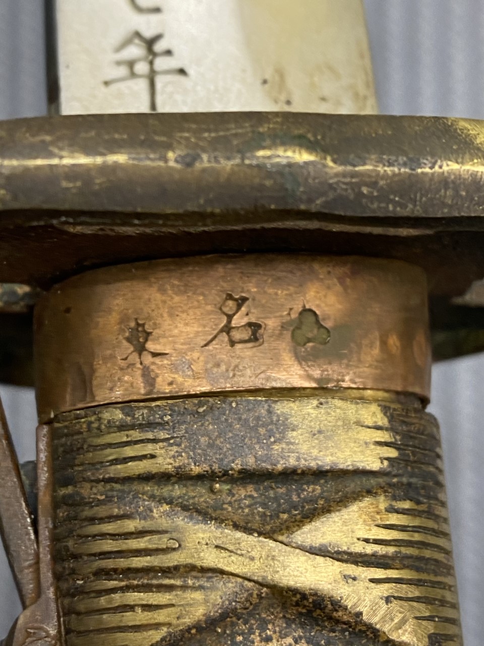

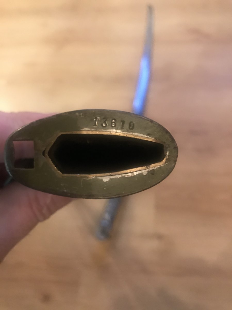

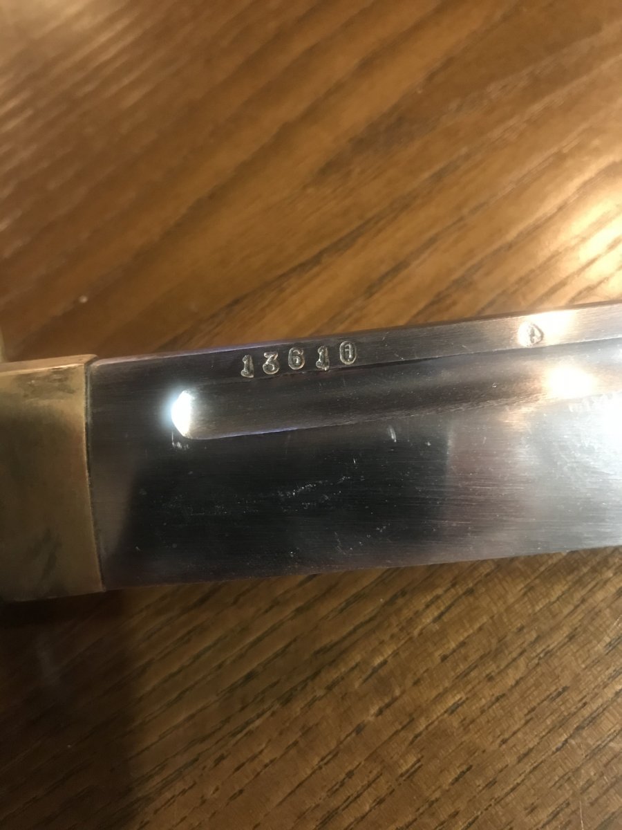

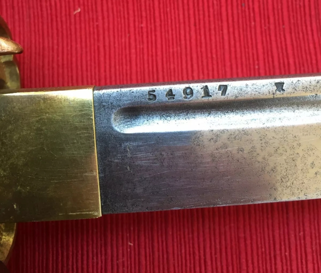

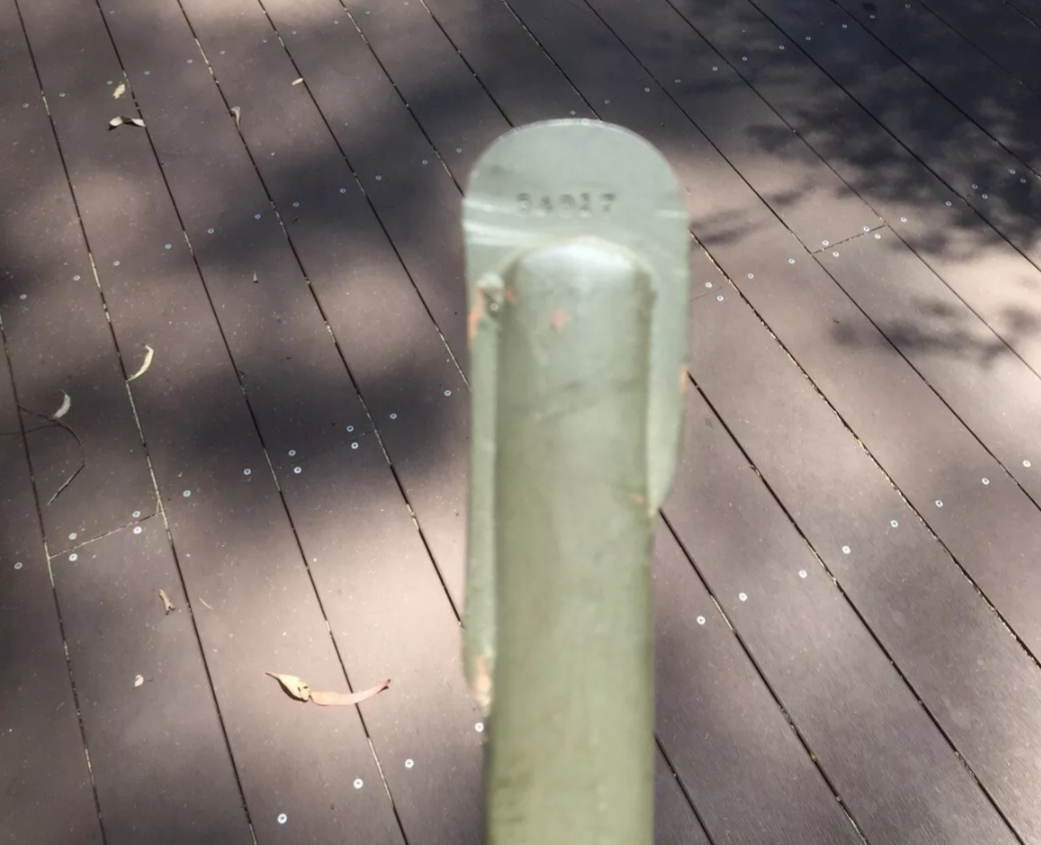

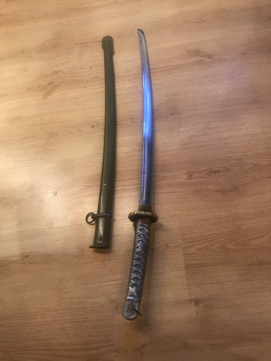

Mike17 Posted November 13, 2018 Report Posted November 13, 2018 Can someone tell me if i got a real ww2 nco sword? I don't see any arsenal markings, the serial numbers are matched. The scabbard is a bit aged up...thanks. Quote
Shamsy Posted November 13, 2018 Author Report Posted November 13, 2018 Genuine sword, just very corroded. Some swords have iron fuchi, which rarely have stamps (or visible ones). 2 Quote
Mike17 Posted November 13, 2018 Report Posted November 13, 2018 Thank you so much. I was skeptical because the fuchi and tsuba is a bit basic compared to the ones i saw with markings etc. Thanks. Quote
Shamsy Posted November 14, 2018 Author Report Posted November 14, 2018 Just a matter of it being a different pattern. The brass tsuba, seppa and fuchi examples are more popular and and start slightly earlier than the iron fitting equivalents. However, I don't personally place any more value on one over the other. It all depends entirely on the subcontractors and variations. Quote

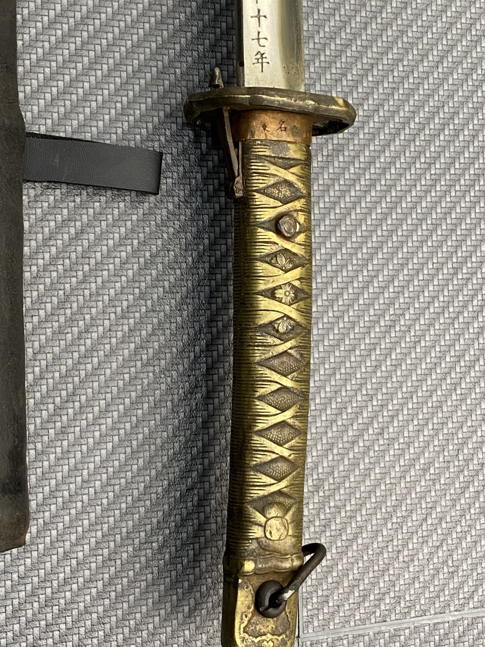

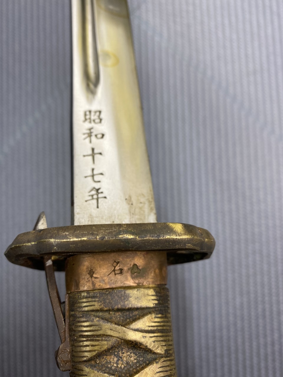

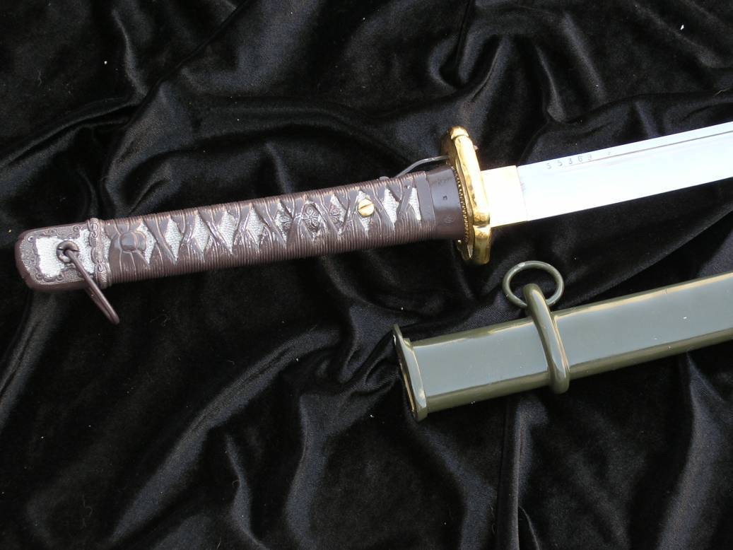

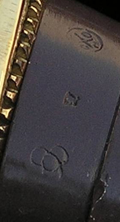

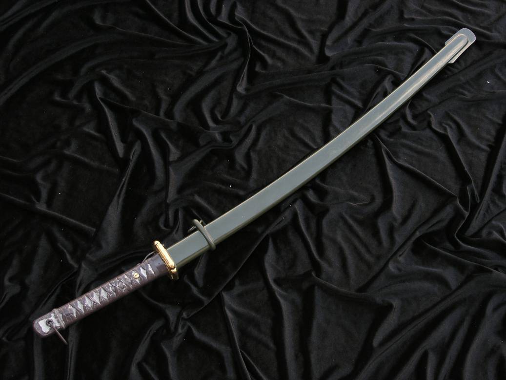

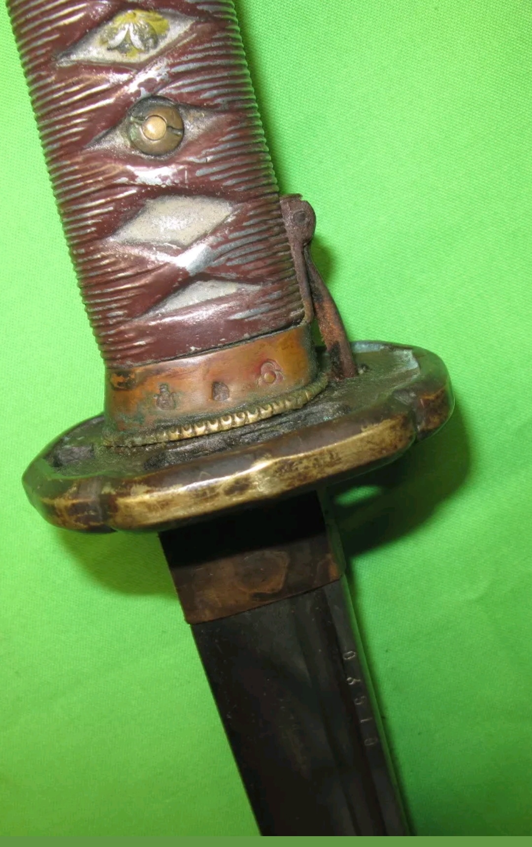

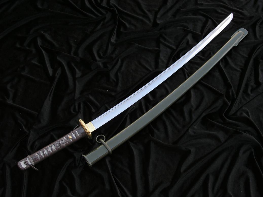

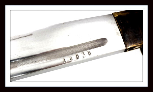

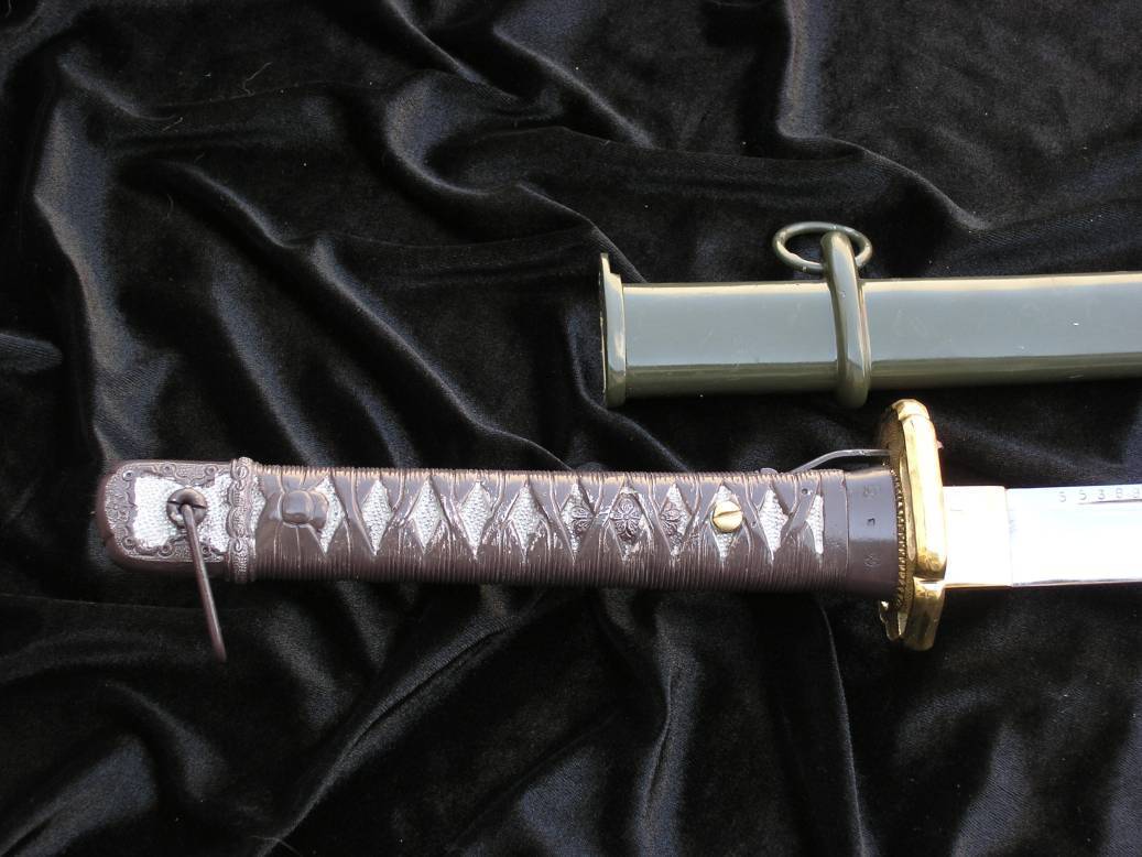

Shamsy Posted December 1, 2018 Author Report Posted December 1, 2018 Righto. So if you've been here a while you might remember me talking about the Polish made 95's being the best examples of reproduction swords I have ever seen. Properly aged into a fake, they can be near impossible to tell from the real thing. So here is an example to post finally. It's not 'fake' and the seller is making no claims that it is anything but a repro. They even correctly state the country of manufacture. What a gentleman/woman. So what do you do if you find an Iijima sword then to know it's the real deal? That's a hard question, because Iijima, IMHO more-so than any other contractor, has varying peaks and troughs in quality. So the best thing to look for is patina, in all those key spots that are so hard to replicate correctly. You will also notice that the edges of the seppa are not nicely crimped, the stamps are not very well struck (though the paint obscures some), the sarute is long and very triangular (though there is some variance in these normally), the fuchi has been painted and the forward tsuka nut is not quite the right shape. Sorry to say these tells are not current across all of the Polish repros and there is a degree of quality variation. Everything else about the sword is pretty spot on (no, the bohi is fine. There are variations in those too). A well aged Polish sword transformed into a fake is tricky to spot and the 95 collectors may not agree or be able to offer definitive answers. If in doubt, walk away. Quote
Brian Posted December 1, 2018 Report Posted December 1, 2018 What do the repros retail for? If a lot, then there wouldn't be much point in ageing and faking them. If cheap, I can hear the sound of digging now as people bury them for for a while to age them.We have arrived at the German militaria stage, where some people refuse to collect certain things as the fakes are just too good. 2 Quote
vajo Posted December 1, 2018 Report Posted December 1, 2018 Look at the stamps an the Fuchi. The canon balls looke like made with a dremel. 3 Quote
Shamsy Posted December 1, 2018 Author Report Posted December 1, 2018 They're about a third of the cost of real deal, Brian. I've only seen Iijima ones, though they do have unique serial numbers. Chris, the stamps aren't perfect, but remember these are under paint. There are also so many different iterations of genuine cannon balls that these are perfectly valid if viewed alone. 3 Quote
vajo Posted December 1, 2018 Report Posted December 1, 2018 Steve you are right and I'm not that much experienced like you in these NCO Swords. But in this case the Stamp didn't look stamped, more like carved. Maybe there exists some genuine swords with that? 1 Quote
Bruce Pennington Posted December 1, 2018 Report Posted December 1, 2018 Steve, Thanks for this continuing education. We really depend on you (and Stegel when he's around) as the residant experts on 95's! This is one of the most accurate reproductions I've seen. For all the reasons you listed, though, I would have rejected it as fake, but can see that a rookie could easily be duped by it. I'm curious about your comment on the bohi. In my limited experience, the Tokyo/Kokura bohi end in a shape that mirrors the kissaki, where the rounded ends seems to come from Nagoya contractors. Have you seen rounded bohi ends on Tokyo blades? 1 Quote
Shamsy Posted December 1, 2018 Author Report Posted December 1, 2018 Steve you are right and I'm not that much experienced like you in these NCO Swords. But in this case the Stamp didn't look stamped, more like carved. Maybe there exists some genuine swords with that? stamp.jpg Now I look closely Chris, it does look carved. I've never had one of these swords in hand (for obvious reasons) but I'm fairly sure that they are stamped and it's the paint making it look flaky. Bruce, I'll have a look and edit this comment when I have an answer. 1 Quote

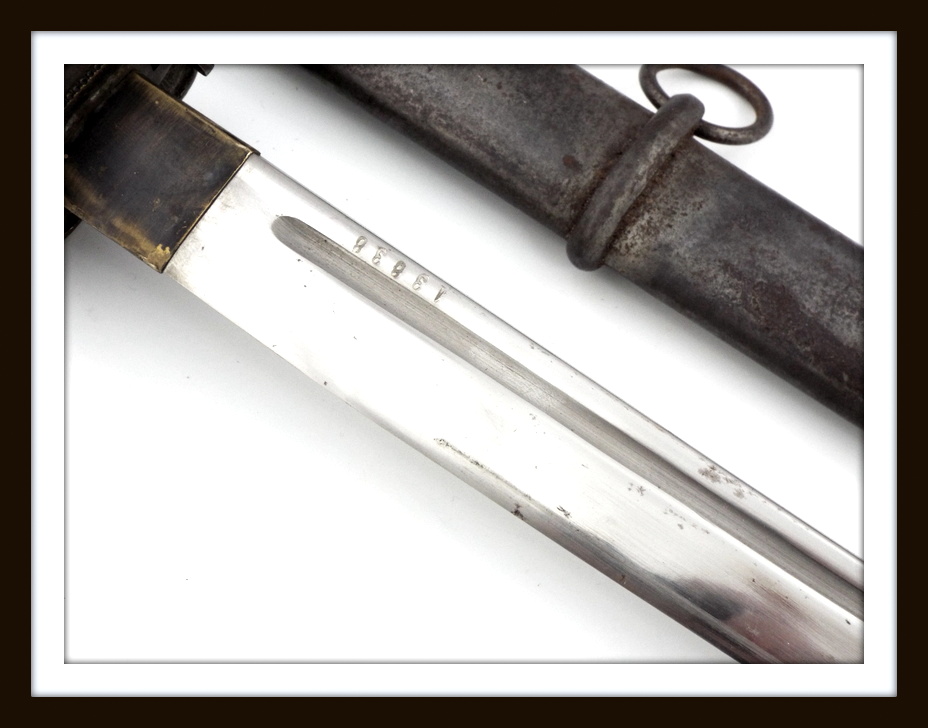

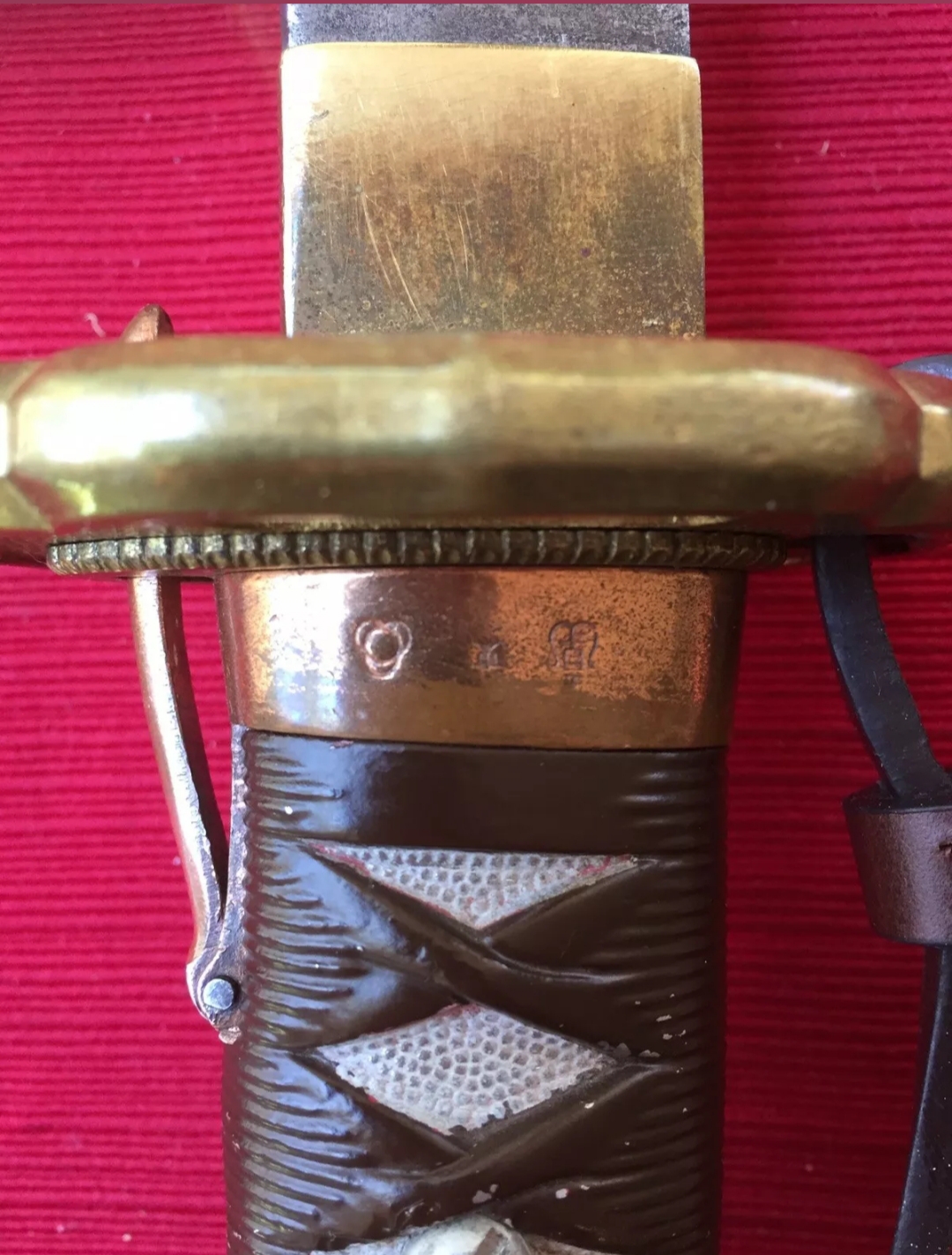

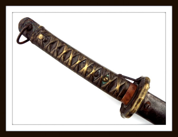

Shamsy Posted January 7, 2019 Author Report Posted January 7, 2019 I let the seller know the sword was a Chinese reproduction, but unfortunately they have decided not to update the listing. There is a standard disclaimer of course, so they aren't strictly guaranteeing it is period. https://www.ebay.com/itm/ANTIQUE-WW-II-Japanese-NCO-OFFICERS-KATANA-BATTLE-SWORD-WITH-MATCHING-NUMBERS/332997092938?hash=item4d882c664a:g:D4YAAOSw-QxcMDQz I thought it worth including here because they're really good photographs. 2 Quote
zook Posted January 7, 2019 Report Posted January 7, 2019 I sent the seller a note saying, "this looks like a rough reproduction, has anyone else contacted you expressing the same concerns?" - Dan 1 Quote
Bruce Pennington Posted January 7, 2019 Report Posted January 7, 2019 I’m surprised they gave us such a clear picture of the fuchi stamps! Quite an artsy-fartsy Kokura stamp! At least they attempted a Nagoya inspection stamp. And gee, I didn’t know the Tokyo inspector was a contractor! Quote
Dave R Posted January 8, 2019 Report Posted January 8, 2019 A brass tsuka!No other evidence needed. 1 Quote
zook Posted January 12, 2019 Report Posted January 12, 2019 Steve - the seller finally responded to my questioning of his sword (https://www.ebay.com...4YAAOSw-QxcMDQz) a few minutes ago ... he said nobody else sent him a note that questions the authenticity of the sword. So, there you have it - interesting. They took 4 days to respond to me ... action ends in 4 hours. Dan Quote
Shamsy Posted January 12, 2019 Author Report Posted January 12, 2019 Thanks Dan. How unfortunate, but it's not unexpected Quote

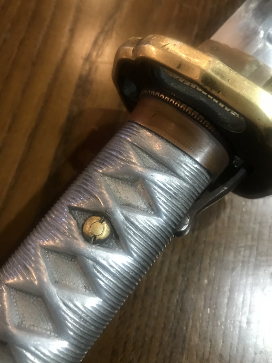

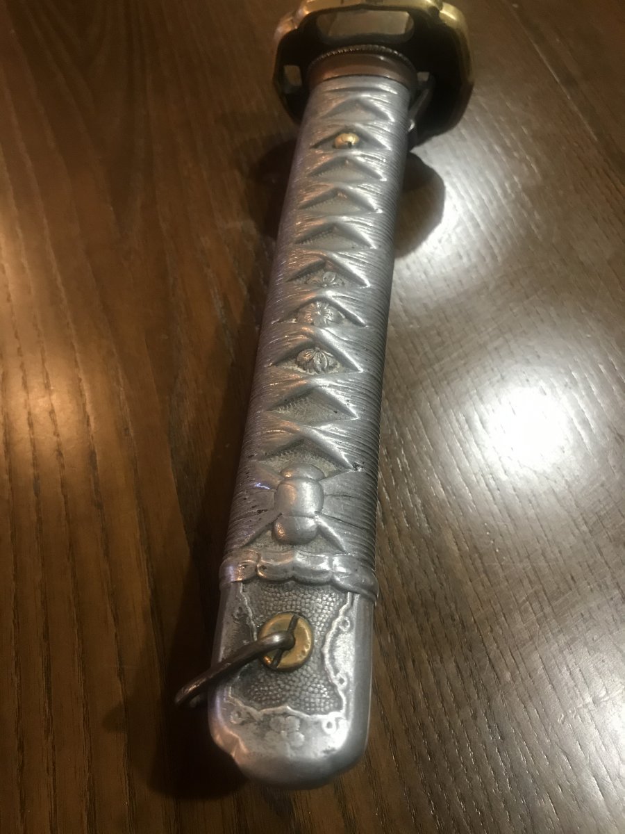

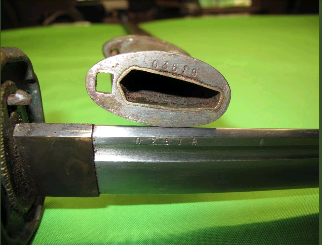

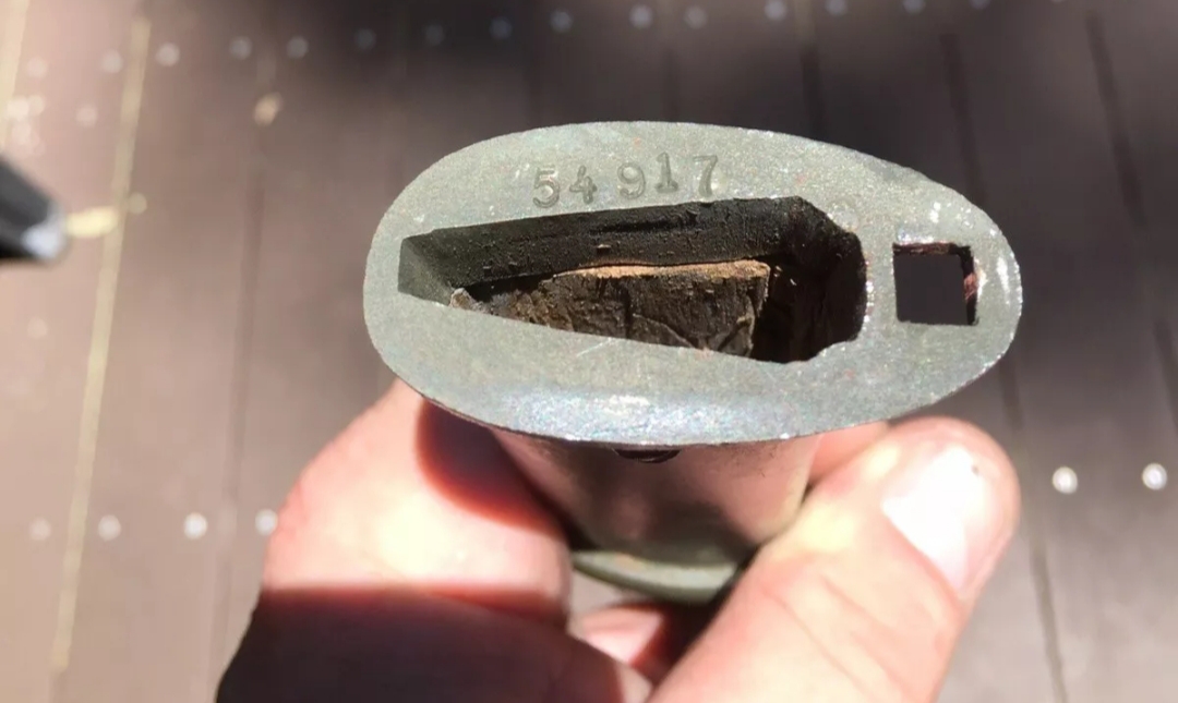

Shamsy Posted November 8, 2019 Author Report Posted November 8, 2019 A good example of a repro sword, certainly one of the better examples seem and worth listening here. Originally brought to the board by Vladimir. The three immediately obvious signs are the sarute screw, the serial number positioning/font and the tsuba patterning, though there are a host more less obvious issues. 3 Quote
Shamsy Posted November 8, 2019 Author Report Posted November 8, 2019 May as well add this too. No point in listening what is wrong, because there's nothing right. These are all over eBay, coming from China. 1 Quote

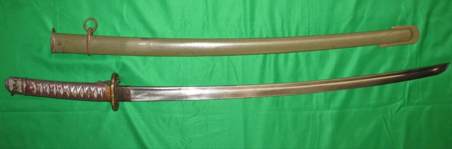

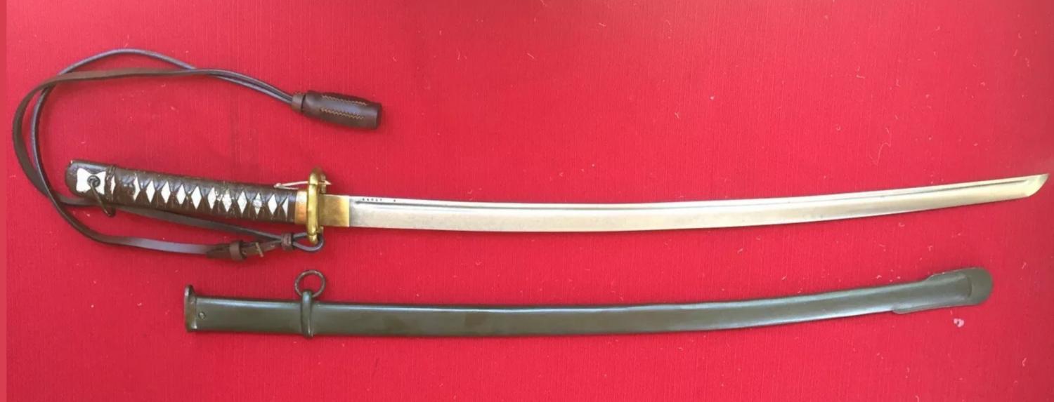

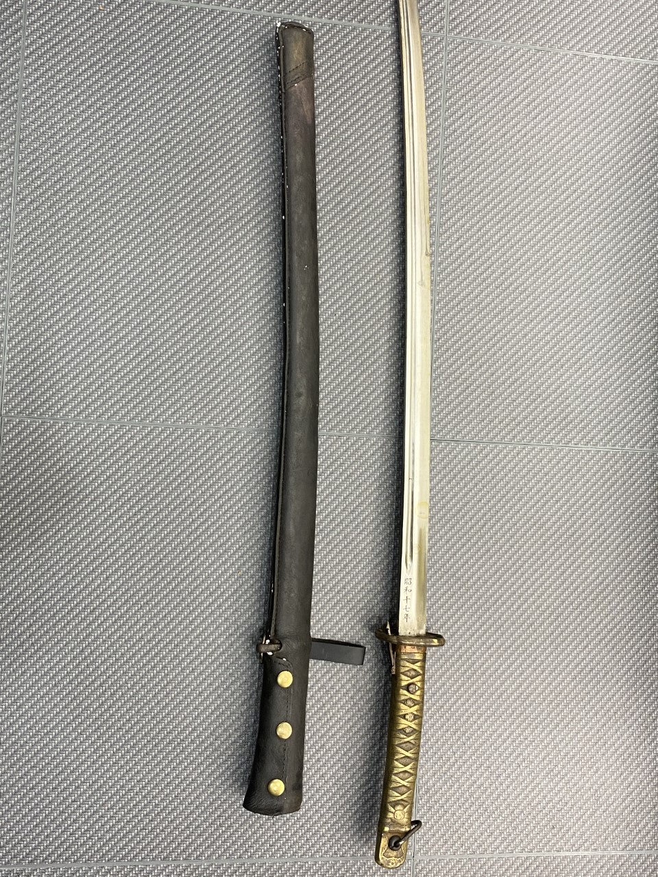

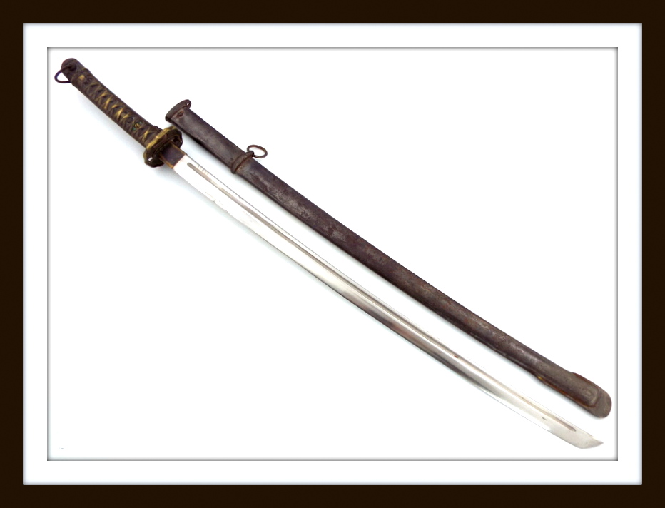

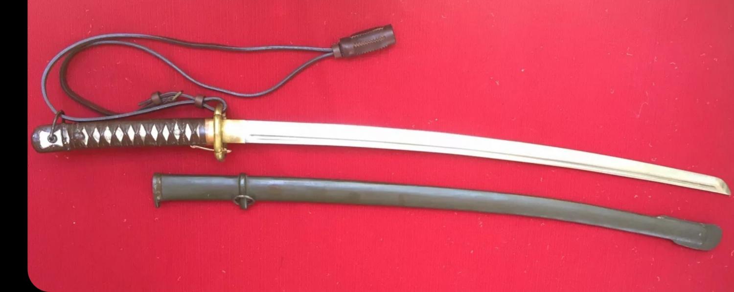

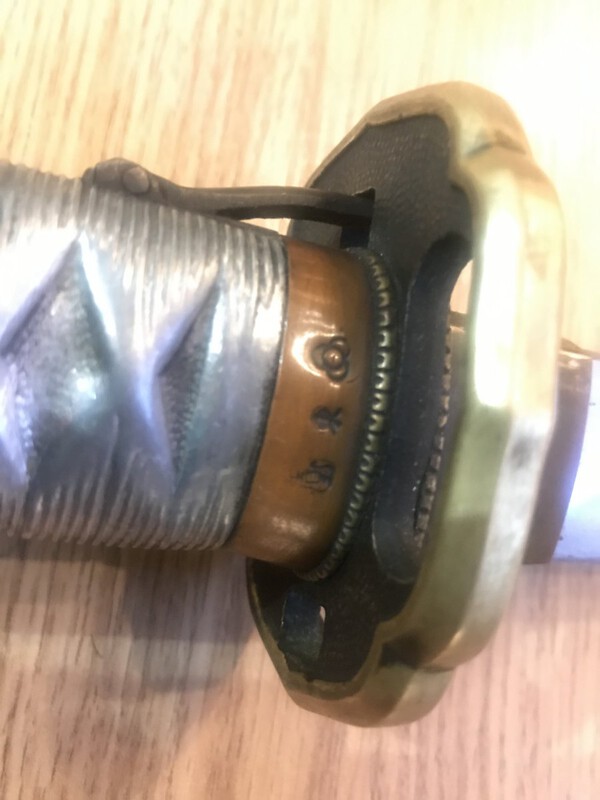

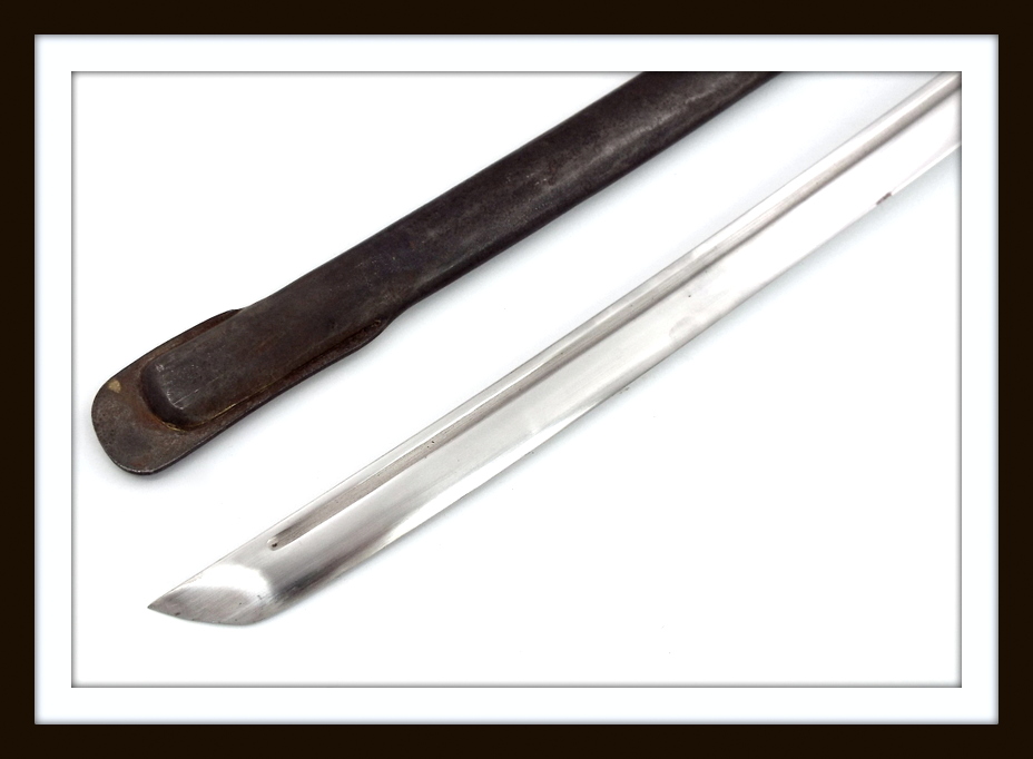

Shamsy Posted December 28, 2019 Author Report Posted December 28, 2019 This example is hard to judge. The knot is obviously a repro, as is the saya, but the sword itself is quite excellent. I think the stamps are a little vague, the serial number of the blade don't look quite right, patina lacking though maybe brass was polished... very hard to say though whether the sword is genuine. Might be a fake saya and knot added to a genuine sword. The photographs are too small and low resolution on my phone for decent examination. It's 3AM so I'll look again later and see if anything else stands out. Quote
PNSSHOGUN Posted December 29, 2019 Report Posted December 29, 2019 From my limited experience the blade always gives these away, the kissaki on this one looks good. Quote
Smee78 Posted December 29, 2019 Report Posted December 29, 2019 That is an interesting example Steve. I would have a hard time on that blade with my limited knowledge. Quote
zook Posted December 29, 2019 Report Posted December 29, 2019 Hard to judge indeed ! - what a scary blade , and I would agree with Ron , I would be fooled Quote
