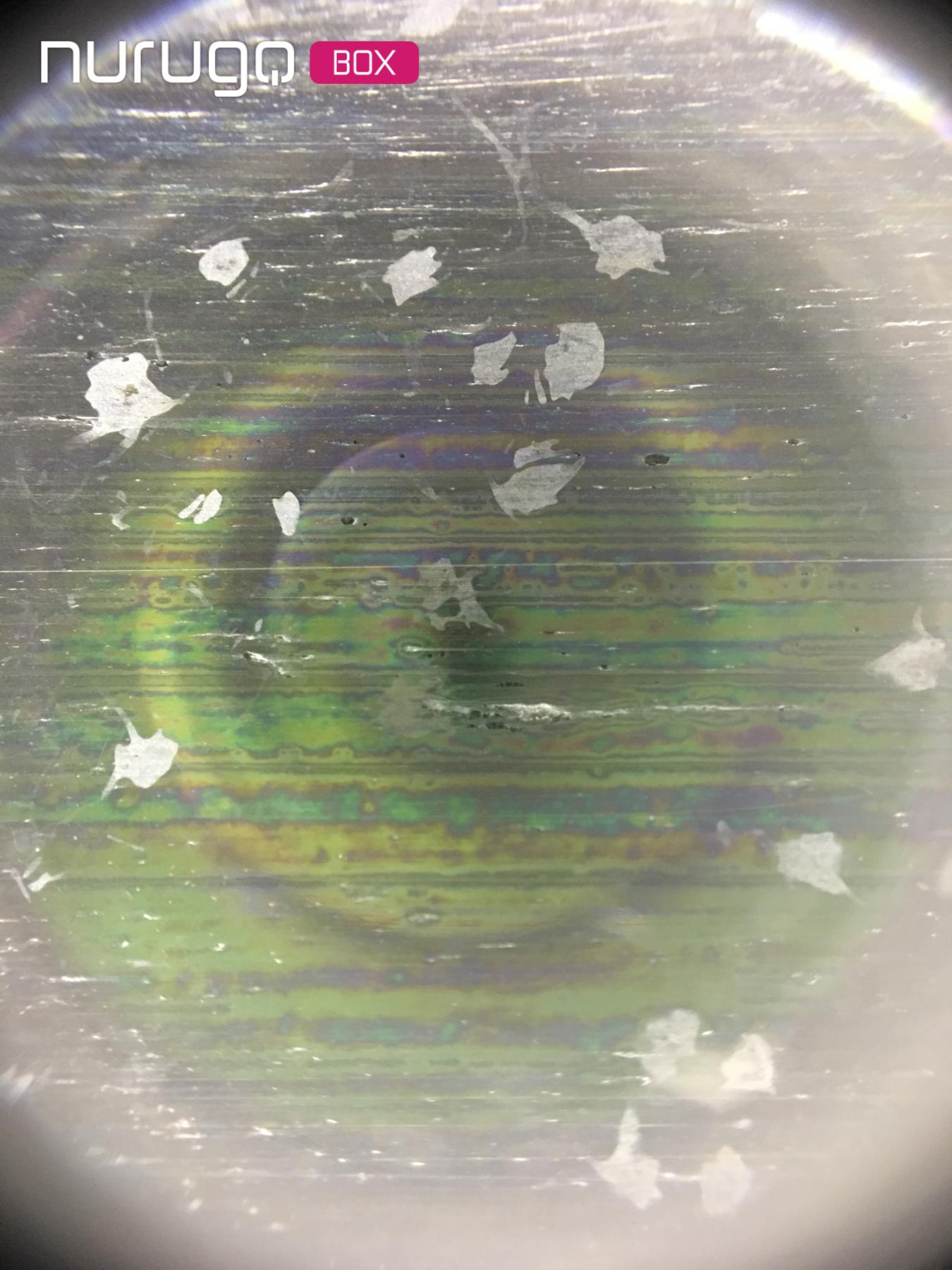

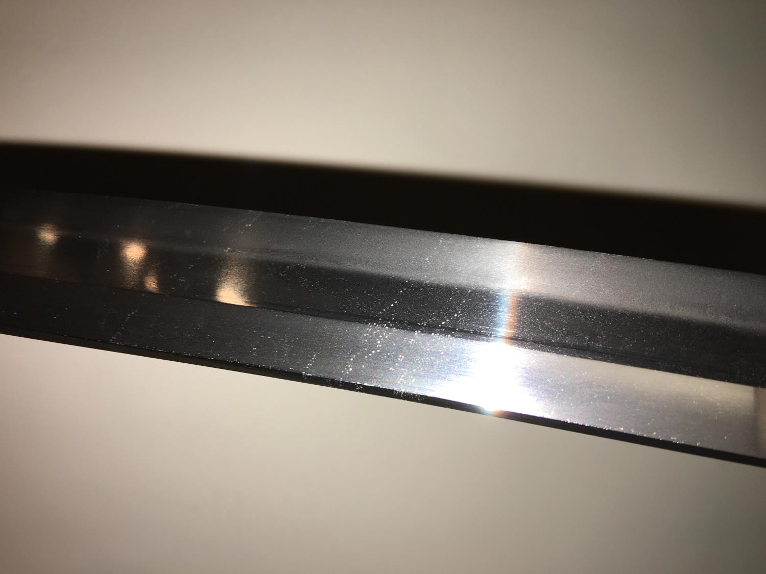

Daso Posted June 22, 2016 Report Posted June 22, 2016 On 6/21/2016 at 10:17 PM, ROKUJURO said: Any organic solvent like alcohol (diethyl alcohol) and related substances like denaturated alcohol, isopropylic alcohol, petrol (not the one used in motors but pure medical petrol!), ether, or acetone would be fine as long as there is no water contained. Some of these mentioned do not mix with water, so they are water-free by nature. All these solvents can be used to remove oil or oil residue, but they are not identical in their respective effects. As an example, glue residue from self-adhesive tape requires something like petrol as alcohol wil not work in a satisfying manner. Some of these substances are dangerous to your health, so working with nitrile gloves and in an open space (if at all) is advisable. The use of these aggressive solvents should only be considered on blades which are heavily soiled with chemical substances like paint, used industrial oil, tar, or resinous plant oil. In all normal cases (= blades in healthy condition or polished) a little bit of CHOJI oil will clean the blade sufficiently. At least, this is my experience. Rokujuro, I had posted this in a separate thread and sorry to hijack this one, but you mention alcohol does not work well on glue residue from tape. I am not sure and no-one is whether these dots which appeared after some work to my blade tip are either tape residue or micro abrasions possible from shipping. You can see blade and close up. I want to really see if this is some kind of abrasion in finish or residue but repeated attempts with alcohol and a microfiber cloth remain unsuccessful. What kind of petrol does on use to try and could this damage a nicely polished blade. Thanks, Darius Quote
Brian Posted June 22, 2016 Report Posted June 22, 2016 If alcohol didn't remove them, then they are not coming off. Some kinda staining on the surface. I really wouldn't worry about it. They are so small, nothing to stress over. Later get a polisher to touch it up...that they can do. Quote
ROKUJURO Posted June 22, 2016 Report Posted June 22, 2016 On 6/22/2016 at 5:20 PM, Daso said: ......What kind of petrol does one use to try, and could this damage a nicely polished blade?..... Darius, as I wrote, it is the type of petrol used in clinics or medical offices to remove the residue of adhesive plaster. You can buy it in pharma stores. Ether will do the same job. Of course, none of these will damage a steel object. Adhesive tape is indeed used by polishers, but not directly on a blade. They wrap a blade in paper first and then fix it with adhesive tape (or, more traditional, with a textile ribbon). It is really difficult to judge, but In this case I assume that the spots are small stains. Imagine someone in the customs sneezing over your blade..... As Brian said: Let a polisher go over it with his HAZUYA, and it will be gone. Quote
Daso Posted June 22, 2016 Report Posted June 22, 2016 On 6/22/2016 at 6:38 PM, ROKUJURO said: Darius, as I wrote, it is the type of petrol used in clinics or medical offices to remove the residue of adhesive plaster. You can buy it in pharma stores. Ether will do the same job. Of course, none of these will damage a steel object. Adhesive tape is indeed used by polishers, but not directly on a blade. They wrap a blade in paper first and then fix it with adhesive tape (or, more traditional, with a textile ribbon). It is really difficult to judge, but In this case I assume that the spots are small stains. Imagine someone in the customs sneezing over your blade..... As Brian said: Let a polisher go over it with his HAZUYA, and it will be gone. Thanks Jean Quote
