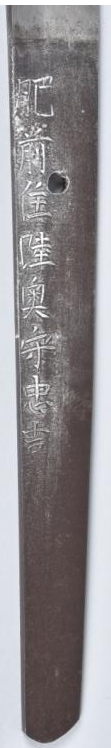

Daso Posted June 14, 2016 Report Posted June 14, 2016 Hello all, I've gone through countless images of Tadayoshi signatures and although I would highly anticipate gimei just based on the name itself, to my very very very untrained eye this looked very close to some papered pieces. The one in question is just a single tang picture, the picture of the papered Tadayoshi is from Nihonto.ca and has multiple shots. Thanks, Darius Quote
CSM101 Posted June 14, 2016 Report Posted June 14, 2016 With my untrained eyes it looks gimei. Uwe G. Quote
Daso Posted June 14, 2016 Author Report Posted June 14, 2016 Thanks, I like Raging, leaves absolutely no doubt in my mind :-) Quote
Prewar70 Posted June 14, 2016 Report Posted June 14, 2016 Not to mention I don't think that signature style/kanji format is correct. Quote

Ed Harbulak Posted June 14, 2016 Report Posted June 14, 2016 Hi Darius, Compare the zen kanji (in Hi-zen) on the blade in question with the same kanji in the Nihonto.ca sword and see if you can see the difference. The signature on the sword in question is definitely gimei based on where one little stroke is placed in the zen kanji. That's the second character from the top and is a characteristic of the entire Tadahiro, Tadayoshi family. Quote
Daso Posted June 14, 2016 Author Report Posted June 14, 2016 On 6/14/2016 at 9:50 PM, Ed Harbulak said: Hi Darius, Compare the zen kanji (in Hi-zen) on the blade in question with the same kanji in the Nihonto.ca sword and see if you can see the difference. The signature on the sword in question is definitely gimei based on where one little stroke is placed in the zen kanji. That's the second character from the top and is a characteristic of the entire Tadahiro, Tadayoshi family. Ed, I will look at this closely, when I looked now I can faintly see what you mention but I'll look it closer at home to compare. Thank you, Darius Quote

Isocyanide Posted June 16, 2016 Report Posted June 16, 2016 The nakago is missing an easy kantei point for the Sandai Tadayoshi, the slightly sloping, deep katte-agari yasurime. From the photo I see no discernible file marks. Quote

Darcy Posted June 18, 2016 Report Posted June 18, 2016 Just to be clear, the one you're comparing it to from my site is the Shodai Tadayoshi, not Sandai. Quote
