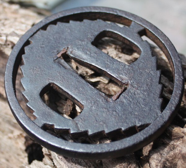

johnnyi Posted June 11, 2016 Report Posted June 11, 2016 Hello Gentleman, This is a tsuba I acquired a couple years ago from AoiJapan which had been tentatively described as Owari. Since then under 60x magnification I've found that it is made in two parts, the center leaf apparently pressed into the outer rim. Tsuba measures: 68mm tall 65mm wide 5.8mm rim 5.2 center leaf The reverse by the small hitsu-ana shows forging of an exposed layer, and the central leaf shows quite a few "iron bones", less so on the rim. The iron seems very hard. The "joinery" of the two elements is tight, only visible as two under magnification as mentioned. I am very inexperienced in tsuba, but was wondering are "two piece" tsuba unusual, and could this one possibly be Ono? Thanks, Sincerely, Johnnyi (John) Quote

christianmalterre Posted June 12, 2016 Report Posted June 12, 2016 -what indicator you do have that your´s Tsuba may ben produced in 2 parts? -is the central ita plate slightly loose and mooving ? -are there any signs of a fixing of the ita ben visible on 12,3,6 and 9 (plugs drilled and fixed visible on outside mimi)? -is there a indication ? -maybe different colouration of the iron/patina on these points, where a fixation may ben have occured? (as the outside mimi wall obviously got overworked by filing/grinding) -is there a difference in the entire colouration between ita and mimi ? (best way would be to compare this under direct sunshine and glasses ) -differences in tagene ? (even slightest ) -differences in the iron itself ? -exact same thickness of Ita and Mimi ? this thematics in a 2 piece/ brick construction seems me least to say- very strange...... Christian Quote

Ford Hallam Posted June 12, 2016 Report Posted June 12, 2016 Hey Brian, in my opinion this is a straightforward one piece tsuba 1 Quote

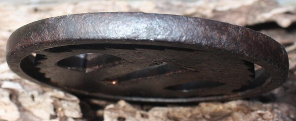

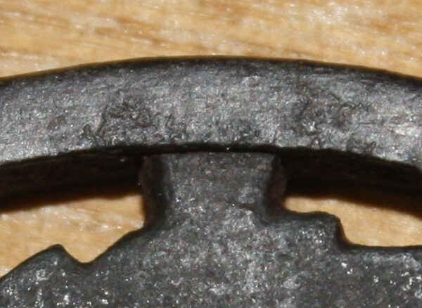

johnnyi Posted June 12, 2016 Author Report Posted June 12, 2016 Thank you all. Ford, in a few hours when I return I will attempt some scans which might blow up better than my limited camera lens. Here are a couple more picture attempts, but not up to speed I'm afraid. You will notice shadow; that is deep recess separating two elements. Notice also in the pictures that the inner oak leaf is not set at a uniform depth within the rim, but is a bit askew (yet askew in a way that the plain of the leaf is flat, not random depth here or there, suggesting (showing) it was fitted in the rim a bit rudely. I will attempt when I return some scans which may blow up better that show two distinct elements tightly fitted, but with visible gaps, . Once more, thank you. John Quote
Ford Hallam Posted June 12, 2016 Report Posted June 12, 2016 John, yes, I had assumed you'd interpreted that recessed line as indicating a joint. I think it's the chased line the maker made when the design was marked out, possibly redefined once the centre area was chiselled down to lower it slightly compared to the rim. It's a pretty standard process and in evidence on many pierced and chiselled steel tsuba. It seems to me also, in the two full images of the tsuba you initially posted, that the grain of the steel follows from the body to the rim indicating a single plate, to my eyes anyway. Making a tsuba like this from two pieces is simply inefficient in both in terms time and materials/fuel. A two piece construction is also weaker. So those two indented lines are not enough to convince me. Perhaps there's more to see....but I don't see a mystery yet. 1 Quote

johnnyi Posted June 12, 2016 Author Report Posted June 12, 2016 Thank you Ford, I've attempted scans, however the depth of the leaf being below the rim makes the image of the joint fuzzy and useless. If you see a continuation of the metal structure then that is pretty good proof as far as I'm concerned, As an aside, for an extremely crude looking tsuba it must have taken a very high degree of skill to manipulate tools around the upper-most meeting of the tip of the leaf and the rim.. As it stands, there is the illusion of a deep connection of two pieces which has been acknowledged by those who've seen it through a microscope. Your explanation however, explains it I think, for extremely deep chasing marks would form what look like cavernous pockets if the lines were roughly burnished over by even dragging a pin along them, which I'm sure must have been done in this tsuba's lifetime. What I don't understand yet is why such an illusion of a gap exists on one of the the inside walls where the post holding the leaf meets the rim but until I can get some useful images of it the issue is dead I think. So is this in fact an early Owari or later? Thanks once gain for the tremendous help! John Quote
