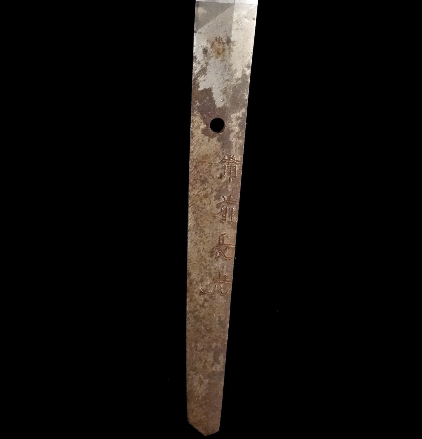

The_ozzy_samurai Posted June 4, 2016 Report Posted June 4, 2016 Hey guys,so i picked up this recently can anyone help with signature? i have had a look online but trying to match up from pics is getting to me,im not the best with these signatures i only know a few symbols by eye,thank you kindly Julian Quote
Jean Posted June 4, 2016 Report Posted June 4, 2016 This one is very easy. The first two kanji may be the name of the province, the last two the name of the smith. The mei is as if it was printed. Try with this: http://www.jssus.org/nkp/index.html Quote

SwordGuyJoe Posted June 4, 2016 Report Posted June 4, 2016 When you're done figuring it out, look for other examples. This mei doesn't smell quite right to me... Almost like it's trying hard to be the smith's stylized mei, but doesn't quite get there. Pics of the blade would be helpful. Quote
The_ozzy_samurai Posted June 5, 2016 Author Report Posted June 5, 2016 On 6/4/2016 at 11:38 PM, SwordGuyJoe said: When you're done figuring it out, look for other examples. This mei doesn't smell quite right to me... Almost like it's trying hard to be the smith's stylized mei, but doesn't quite get there. Pics of the blade would be helpful. I havent taken and good images of it yet,but its in early to mid war Type 98 high grade mounts with metal scabbard,i found a pic like this after alot of stuffing around,looks like im on the right track Quote

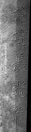

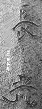

SwordGuyJoe Posted June 5, 2016 Report Posted June 5, 2016 Yes. That is the right smith. It's Ichihara Ichiryushi Nagamitsu. Perhaps it is the picture, but the "swooping" style of his mei seems more forced on yours and less fluid. I could be wrong, but while the quality of these swords vary greatly, typically the stylized mei tends to be quite uniform. Quote

SwordGuyJoe Posted June 5, 2016 Report Posted June 5, 2016 It might be legit. It might not. I've seen a few gimei Nagamitsu's on what was clearly Seki showato. Like I said, it may just be a bad pic that you posted. All of this is likely moot until we see pics of the blade itself. One thing I like to do is print off mei so I can literally look at them side by side, kanji by kanji. See if you can find some more (should be REALLY easy) and look really closely at each character. You will see what I am seeing. One other thing to look for is the kesho yasurime - the filing pattern on the nakago. Yours seems non-committed and a little light. The nakago jiri is a little off too. Again, could be wrong here. http://www.nihontoantiques.com/archive/images/nagamitsu%20gendai.jpg The reason that I'm asking for pics of the sword is that the mei is just one piece of trying to determine the maker of the sword. By just focusing on the mei and nakago, it's like trying to pick a person out of a line up just by their hair color. Quote
tesscoothome123 Posted June 5, 2016 Report Posted June 5, 2016 Hi Julian, This may be a student or apprentice signed blade overseen by Nagamitsu. Regards, John Quote
SwordGuyJoe Posted June 5, 2016 Report Posted June 5, 2016 As I said before, the mei does not vary greatly. This indicates a single person signing the blade, regardless of who made it. Nagamitsu was likely the only one signing these blades. Quote
