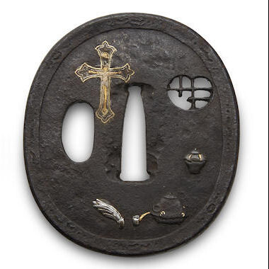

Gents, just for keeping on exercise our critical thinking I wish to propose a tsuba from Bonhams auction (https://www.bonhams.com/auctions/22248/lot/1187/).
It has already been sold, so I'm not interfering with the market. Here we have an overt Christian symbol, but IMHO it's just forgery to sell better the tsuba...
Bye, Mauro

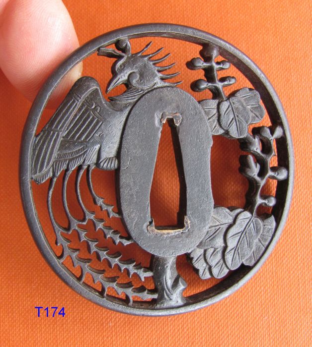

I suppose if we want to look for evidence of anti-Tokugawa sentiment in tsuba we might start by examining the works produced in Choshu and Satsuma, both these domains being veritable hotbeds of dissent.
Here's one example that might count, a Choshu tsuba featuring a Ho-o-bird and the Imperial Paulownia crest, an overt signal of allegiance to the Emperor as opposed to the Shogunate perhaps?
From Grey's site btw.
I imagine it would be a fairly simple project to survey Choshu and Satsuma tsuba to look for similar possible anti-shogunate expressions. We might discover the hidden language of Choshu botanical themed tsuba designs. :laughing:

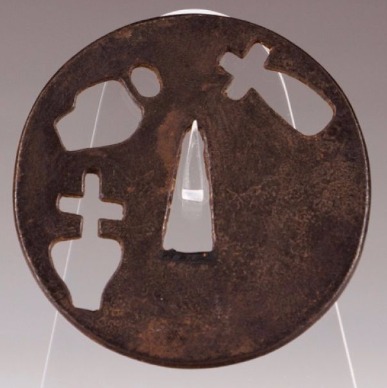

In “A History of the Catholic Church in Japan from its beginnings to the early Meiji era”, Joseph Jennes refers to Christian tsuba (but also to banners, helmets, stirrups and saddles). He shows one he found in one of the books of the art historian Tei Nishimura;  “Namban-bijutsu”  (Tokyo 1958 西村貞、『南蛮美術』、大日本雄弁会講談社、1958).
So it seems that at least Tei Nishimura believed in Christian tsuba.
