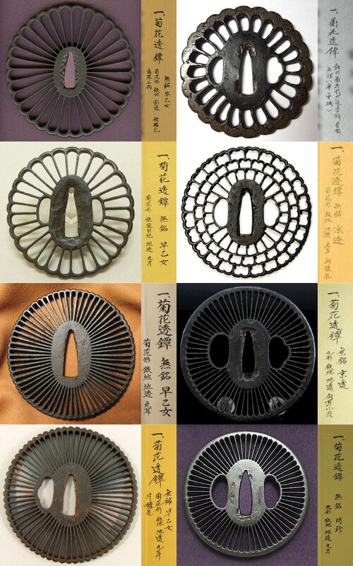

MauroP Posted June 27, 2016 Report Posted June 27, 2016 When it comes to judge art (and tsuba as well) nothing can be taken for granted. Here in the picture below I have collected some examples of plain kikka-gata sukashi tsuba; on the left 4 tsuba papered as Saotome, on the right tsuba attributed to Heianjō, Kyō-sukashi (2) and Myōchin. Bye, Mauro Quote
ROKUJURO Posted June 28, 2016 Report Posted June 28, 2016 Mauro,thank you for that useful comparison! Quote
