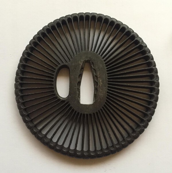

Barrie B Posted June 1, 2016 Report Posted June 1, 2016 Hi all, I have read (and I quote): '...during the flamboyancy of the Genroku era [1688 - 1703] a sumptuary law was passed by the Tokugawa Shogunate in Shotoku 4 [1714] prohibiting the mounting of kogai or kozuka on the katana, and limiting the size of tsuba to 2 sun 3 bu [3.36" /6.97cm]...' The text does go on to say that: '… the exact wording of the Shogunate law regarding tsuba size has yet to be verified...' Saotome Tsuba are known to be large, but I have a very large Saotome Tsuba (probably made from a man-hole cover) measuring 104mm x 102mm x 6.5mm and I am curious to know if these large tsuba were made before this law was passed, or - as I suspect, just in contravention to the law; If this law was in fact passed, or even policed..? Anyone have any true evidence? My Tsuba may pre-date 1714, but I doubt it.. I am curious to know if anyone has a similarly large (or larger) Saotome that they would like to share? Barrie. Quote

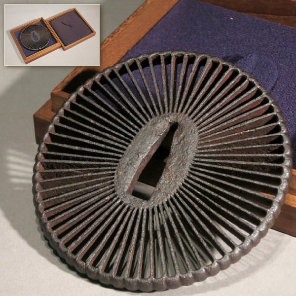

Thierry BERNARD Posted June 1, 2016 Report Posted June 1, 2016 one of mine Dimension horizontal 9.7cm, vertical 10cm, 6mm thick of the ear part, weighs 173g. Quote
Thierry BERNARD Posted June 1, 2016 Report Posted June 1, 2016 On 6/1/2016 at 9:40 AM, Shinto23 said: Hi all, I have read (and I quote): '...during the flamboyancy of the Genroku era [1688 - 1703] a sumptuary law was passed by the Tokugawa Shogunate in Shotoku 4 [1714] prohibiting the mounting of kogai or kozuka on the katana, and limiting the size of tsuba to 2 sun 3 bu [3.36" /6.97cm]...' ..... Barrie. 6.97 cm seems to me very small for a katana tsuba!!! Quote
Thierry BERNARD Posted June 1, 2016 Report Posted June 1, 2016 you are right Stephan!! and 2 sun 3 bu is 6.97cm 1 Quote
Stephen Posted June 1, 2016 Report Posted June 1, 2016 So one is typo must be the inch, and i cant see any self-respecting samurai using that small tsuba on a large daito. Quote
Barrie B Posted June 1, 2016 Author Report Posted June 1, 2016 Thierry, Great looking tsuba.. I love it. Thanks for posting. I wonder how big Saotome like this can get..? Stephen, Just checked my book and it states 3.36 inches.. I should have checked the conversion. Good pick up mate.. sorry I missed it. So did the Tokugawa expect Samurai to use 2 sun 3 bu Tsuba..? It was a relatively peaceful time (was it not?) and I would think that 2 sun 3 bu would be a less likely typo than 3.36"..? I personally like smaller sized tsuba on katana koshirae, and do think that looks more aesthetically pleasing (than large tsuba) on koshirae.. but that may just be me.. Barrie. 1 Quote
Spartancrest Posted June 23, 2016 Report Posted June 23, 2016 This is my first post even though I have dipped into some archived material over the years, so I hope you are not too critical. I have just purchased what I hope is an early Saotome tsuba of very large dimensions 112mm x 5mm. As I have yet to receive it all I can post is a rather grainy photo. It certainly looks - - neglected but I hope that with some care It may improve. The question was asked 'Just how big did Saotome tsuba get?' Well mine is pretty big - - if it is a genuine piece and I can't honestly tell from the photo but I am hopeful. Dale from Tassie Quote

b.hennick Posted June 23, 2016 Report Posted June 23, 2016 I think that it needs more than a little TLC. 1 Quote
ROKUJURO Posted June 23, 2016 Report Posted June 23, 2016 On 6/23/2016 at 11:42 AM, Spartancrest said: .....I have just purchased what I hope is an early Saotome tsuba of very large dimensions..... It certainly looks - - neglected but I hope that with some care It may improve....... Tassie, that is an interesting TSUBA, but in fact a ruin I am afraid. It might be difficult to restore the original surface when so much steel has turned into oxide! What a pity! You should ask for Ford Hallam's advice! Quote
Alan Morton Posted June 24, 2016 Report Posted June 24, 2016 A linisher would help a lot Alan 1 Quote
Spartancrest Posted June 26, 2016 Report Posted June 26, 2016 I realize a lot of the members of this site are lovers of the pristine, the never used, over decorated- - dare I say decadent types of Tsuba. I have gone the other way and much prefer those Tsuba that were used by the guys who did the fighting not those who stood to gain from it. Even though I am a new member, some comments I have seen made on this site are downright snobbish. Is this a site for enthusiasts or is it for those who want to show off? I noted some time back a discussion on soft metal Tsuba not being 'real battle' guards as they would not deflect a blade from the hand or else be ruined in the process. Can I put my two cents worth in and say that you guys need to look outside the box a bit! There are a great deal of sword types throughout the world that have no guards at all. one instance being the traditional Cossack sabre - do you seriously believe it could never have been used in combat? The existence of Tsuba is NOT solely for defence if it were, an awful lot of weapons would need to be thrown out- tanto for instance, what protection does a tanto tsuba of any material offer other than to stop the grip going up the blade? Dale from Tassie Quote
