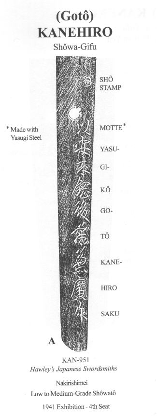

Hi guys , I'm a little stumped with this one.
Possibly etchizen?
Also if anybody knows where I might find this smith, I would appreciate it .
I have tried , oshigata, tokotaikan, gendai Meikan.
Thanks , P
Hi,
from Markus book:
KANEHIRO (兼広), Shōwa (昭和, 1926-1989), Gifu – “Kanehiro” (兼広), real name Gotō Hiroyoshi (後藤広吉), born October 1st 1907, student of Katsumasa (勝正), he worked as a guntō smith and died in January 26th 1960, ryōkō no jōi (Akihide), Fourth Seat at the 6th Shinsaku Nihontō Denrankai (新作日本刀展覧会, 1941).
I thought I would post these two side-by-side. Is this a good example of how different two mei can be of the same Smith or is it more likely that it was cut by someone else?
Once again thanks,
PeterD
Same smith, different mei carver. Seki pumped out thousands of swords for the war effort and to support the demand they had at least one individual whose primary job was to sign swords on behalf of the smith. There are examples in Slough's but I don't have it handy. Search google for him "Goto Kanehiro sword" and then "刀 後藤兼廣" including the quotes. He made a bunch of swords and you're likely to find a few examples.
