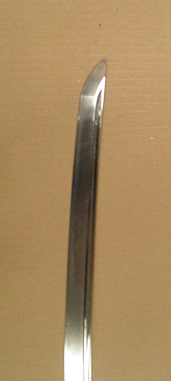

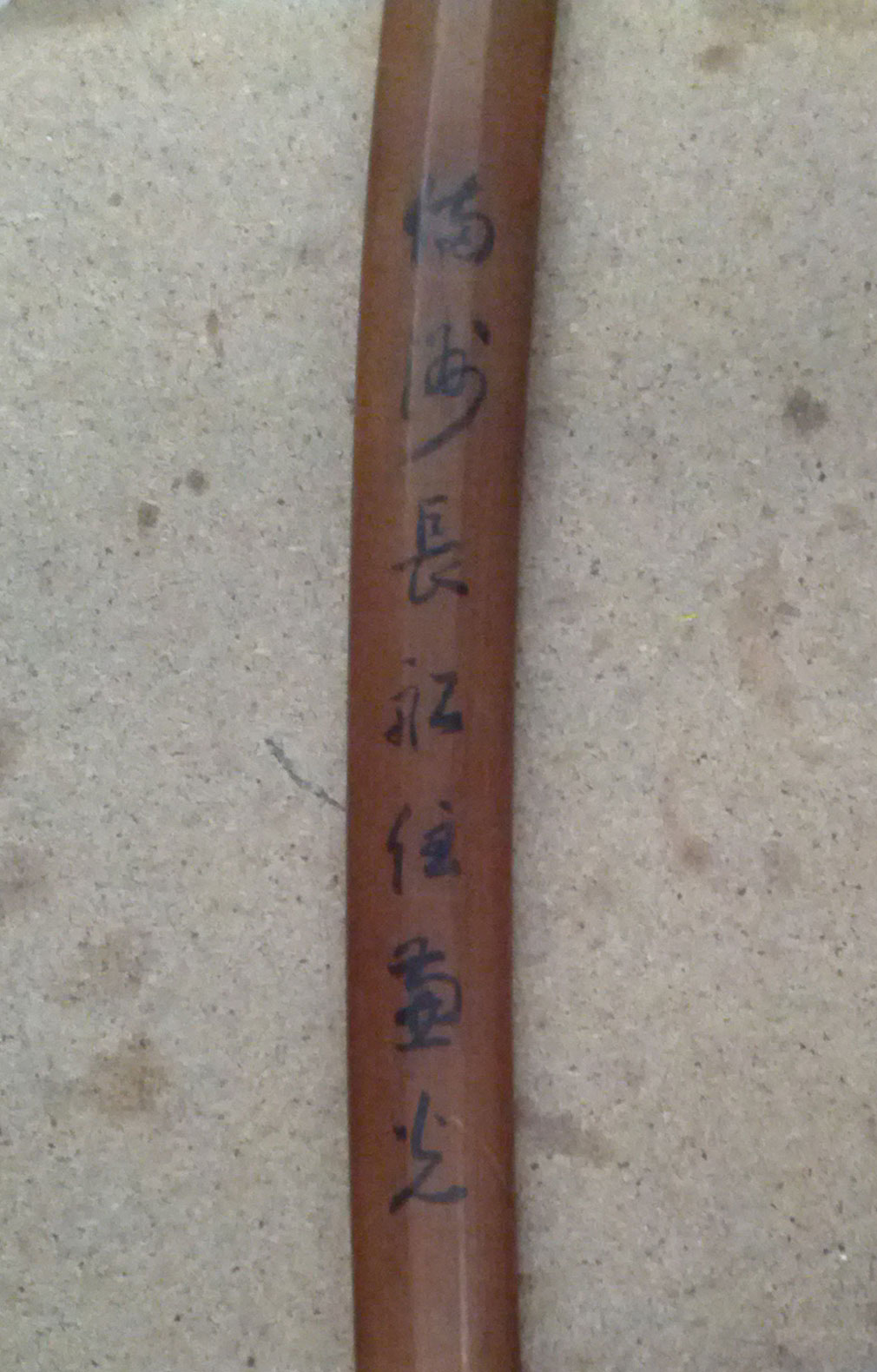

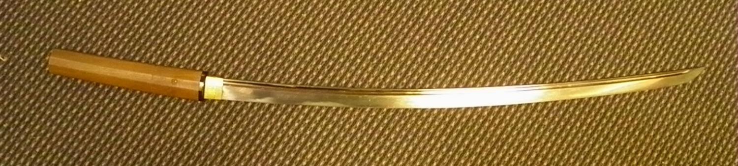

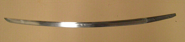

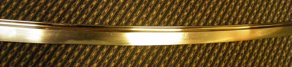

Hi Guys, This sword is out of polish and O-suriage but you can see bits of gonome-midare and choji-midare in the hamon the sayagaki says  Bishu Osafune ju Kanemitsu so if its a bizen Kanemitsu, which one ? thoughts ? also remember reading that if the gonome-midare hamon straitens out in the top part of the blade its a later smith ?
Jim,

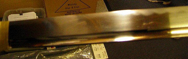

with such poor photos, how could even the most educated person comment. Help us to help yourself, take some time. It may take 40 mins but you could capture some important activity in the Jigane, Hamon or kissaki  that might help put the sword into the correct school and period.
regards H
Who wrote the sayagaki? Is it reliable? Yes, the hamon, in some place, seems to be a bit like O Kanemitsu's ones but that's all. Fuzzy pictures of an out of polish blade.
Concerning sayagaki, they are only an opinion written on a shirasaya which can be overcome by Shinsa, several Kanzan Sato's sayagaki have already been challenged by Shinsa, so be wary...
Hi Hamfish, The sword is out of polish that's why the pics are not good even if he takes some more time (40m) it would not help much its not my sword but was asked to look at it so trying to work out if the sword is worth a window being done. Now *how could even the most educated person comment.) Well I think we can comment on shape, period, does it look like a bizen blade ? hamon, well what we see of it.
Hi Jean, I am not saying that's its by Kanemitsu, I don't know who the smith is, that's why I said If ? and as for sayagaki I also don't know if its reliable ? but it has a good chance that its bizen and that is a good starting point. My thoughts so far are its a mid 1500s sword but it could be a bit older ? But I will try to get some better pics of what I can  :)

All I can say is that it is Bizen style. Now, I have seen shin shinto blades made at "la manière de" in Bizen and Soshu style quite convincing but not the same quality.
Hi Paul, At least you had an idea that it was probably Shin-Shinto. I would be surprised if this one ended up Shin-Shinto but as you know I am not great at kantei . :)
Hi Jean, Thanks for your thoughts, I decided to have a second look as I saw that someone thought enough of the blade to put a gold habaki on it.
also in its past someone also thought enough of it to get a bohi cut after it was shortened :-?
Maybe a bit too curved, a bit too tapering, a bit too small a kissaki to feel confident in it going to Kanemitsu. But it's hard to argue with someone who saw the blade in polish and not blurry and wrote a sayagaki.
It looks like a promising blade and should be sent to someone who knows what they're doing to have a close look.
