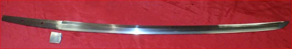

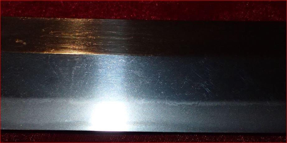

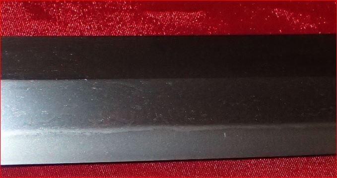

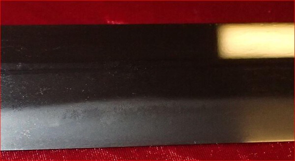

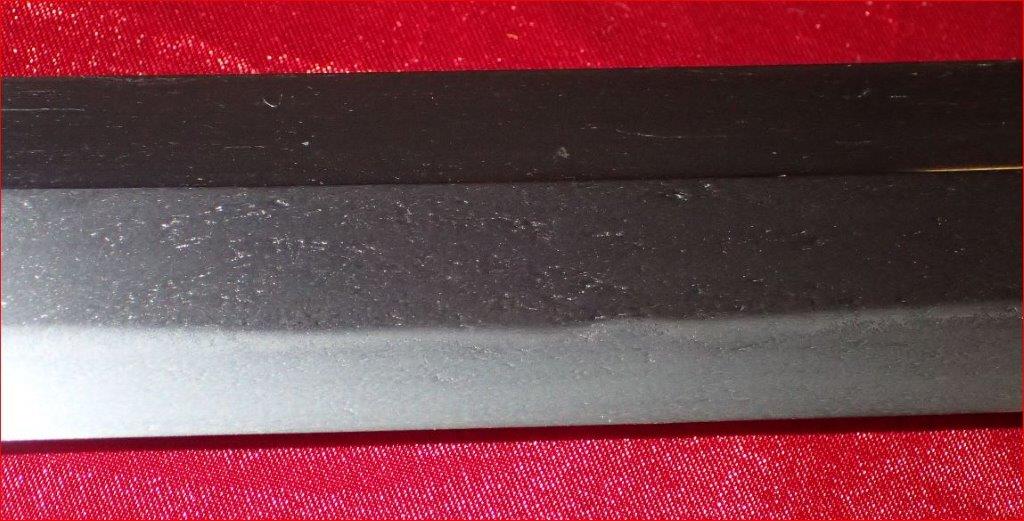

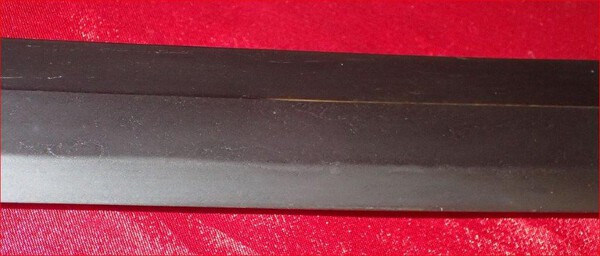

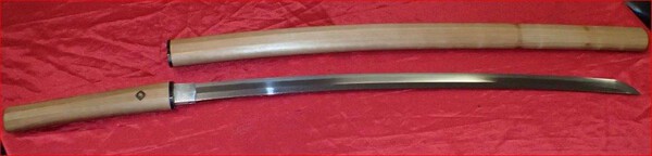

Daso Posted May 14, 2016 Author Report Posted May 14, 2016 I've had some great advice from you all and a couple of experts I can't believe we're willing to assist me in considering and decided to g with the Kiyomitsu although the papers don't pin exactly which one it is. I've attached photos for your consideration as well. Would love feed back on it. The Hamon is not as exciting as others but I like its basic solid good condition. 1 Quote
paulb Posted May 15, 2016 Report Posted May 15, 2016 Hi Darius congratulations! as a first sword I think you have done very well and far better than many of us did in the past. For what it is worth given the choice you had between this and a showa wakazashi and the information you were ble to share, I think you made the right decision, but then again I am a koto enthusiast so cant claim not to be biased. enjoy studying your new blade, from the images I think there is a lot to see. regards Paul 1 Quote
Daso Posted May 15, 2016 Author Report Posted May 15, 2016 On 5/15/2016 at 6:50 AM, paulb said: Hi Darius congratulations! as a first sword I think you have done very well and far bettjer than many of us did in the past. For what it is worth given the choice you had between this and a showa wakazashi and the information you were ble to share, I think you made the right decision, but then again I am a koto enthusiast so cant claim not to be biased. enjoy studying your new blade, from the images I think there is a lot to see. regards Paul Paul, thank you. even after looking at other swords as well it really became a confusing choice. With everyone's guidance I'm happy and feel confident that this was a good solid choice I won't have regrets about. Haha. When my budget allows I'll need some fittings for it. On 5/15/2016 at 9:25 AM, Alex A said: Well done, you can find Markus,s Nihon-Shinto-shi write up online with the geneology of the Kiyomitsu school. Plus index of Japanese swords. Other stuff to find too. Alex, appreciate it. I was attracted to some fancier Hamons but this sword just seemed well balanced (in my limited experience). I actually had a mind boggling time looking through the amount of Kiyomitsus in Markus' index which I got last week. Wow, that is three large tomes of info. Will definitely read the genealogy you mentioned online as well. I hope to contribute more to the board as I learn. Darius Quote
Daso Posted May 15, 2016 Author Report Posted May 15, 2016 On 5/14/2016 at 2:26 PM, Surfson said: Hi Darius. You have started an interesting thread. You haven't told us if the Kiyomitsu is osuriage or not, how many holes in the tang etc. If it is cut down from a tachi, then that is a big plus in my book. Is the Kiyomitsu in suguha and is it pleasing to study? Is there lots of subtle activity that you haven't discovered yet such as ashi or kogunome? Can you see any core steel on the Bizen blade indicating that it is tired? To me, you are also considering the difference between a true samurai sword and a modern military blade. At 24", the Masakazu is really meant to be a katana, and probably was made for a short officer. From what you have said so far, for me, there is no question that I would go for the koto katana as opposed to a gendaito. Having said that, there are plenty of gendaito collectors on this board that would disagree, and good gendaito can hold value well and can appreciate. Cheers, Surf Surfson, So, the Katana I chose to go with is Osuriage with two holes in the tang. That doesn't imply necessarily that it was cut down from a Tachi right? It might just have been shortened for some reason. As I am trying to learn from all, how could I know if it was a cut down Tachi or do the pictures I posted tell the story and if it was, why does that make it better in your book. Thanks Another question for all, since i can't read Japanese, how do I decipher and understand what the Hozon paper actually says? Does the Hozon paper say Eiroku period? I have a fair amount of books but any good source to understand what my hozon says exactly? Laughably, I sent a photo to my friend in Tokyo and he wrote back that he couldn't read it. Not sure why/ Quote

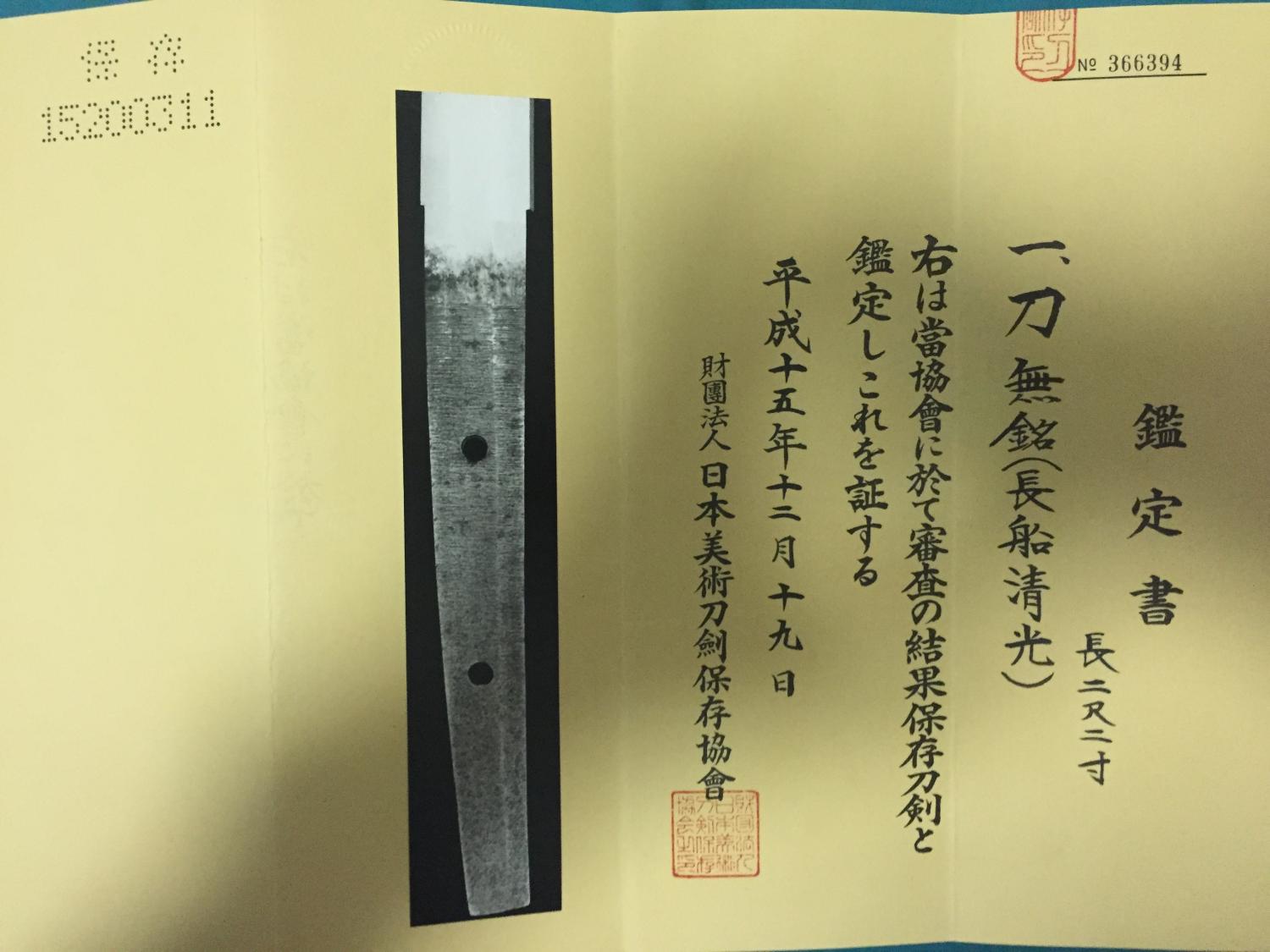

Jussi Ekholm Posted May 15, 2016 Report Posted May 15, 2016 Hozon paper says 無銘 (長船清光) Unsigned (Osafune Kiyomitsu), length 2 shaku 2 sun - c. 66,66 cm Quote
Jussi Ekholm Posted May 15, 2016 Report Posted May 15, 2016 Do you have more pictures of the tang? My guess might be that the sword is shortened by the distance of holes (maybe 6-7 cm?).That would put the original length around 73 cm. Majority of Kiyomitsu smiths from Osafune were active From Tenbun to Tenshō 1532 - 1592. Blade length of 73 cm would be well fitting for that era. 1 Quote
Darcy Posted May 15, 2016 Report Posted May 15, 2016 Good discussion. I think the Showa wakizashi was probably intended as a small katana rather than a long wakizashi. Just guessing. At this point it's clarified as Osafune Kiyomitsu rather than Kaga. Osafune Kiyomitsu is between a school attribution and an individual attribution, isolating it to work of the line. So it's saying that the most reasonable conclusion is that one of the Kiyomitsu smiths made this but there is no significant work shown that would allow someone to say more than this (similar to the Umetada assessment in one of the other threads). For study, probably you will find more in studying Kiyomitsu than in a Showa work unless the Showa work was fine work by one of the top smiths of the period and in which case it would be also highly collectible. O-suriage mumei Muromachi works are not considered in the same category as older works where mumei is almost a standard situation. In the case of consideration for top level papers, Muromachi mumei works will not be accepted higher than Tokubetsu Hozon (or is it now Hozon? Someone will clarify). In looking at Juyo to Tokubetsu Juyo, an unsigned but otherwise mint condition blade may have better chances to pass Tokubetsu Juyo than a signed but less healthy blade for works older than Muromachi. But the price relationship does not necessarily follow the papers as there may be a relative abundance of healthy Tokuju blades compared to signed ones. Anyway this is not so relevant to the case in point. I'm just mainly wanting to make a distinction there there is not so much a clear dividing line gendai / shinshinto / shinto / koto when considering works like this, but it is more like gendai / shinshinto / shinto / momoyama / muromachi / nanbokucho-kamakura / heian Each one of these groupings will have different levels of condition that are considered poor, adequate, or exceptional. An exceptional condition Shinshinto blade is maybe on its first polish, flawless, showing ububa and no alterations of any sort and a beautifully finished nakago with nothing impaired. An exceptional condition Heian blade is just going to be ubu and signed and you have a unicorn right there. Adequate condition in regards to mumei is at the line between the Kamakura-Nanbokucho group and Muromachi. This blade being suriage and in the Muromachi group means it is below adequate condition. As such then as a buying target it is purely based on bang for the buck in what you can see and where you are in the scope of beginner to advanced student and the acceptance that reselling in this condition is difficult as you have bought from the bottommost part of the category (ideally then you saved a bunch of money in recognition of the condition). Anywhere above Muromachi you need to accept that mumei and/or suriage are major detractors from value. Below they are standard and the signature being there is a big bonus. Ultimately if your goal is to keep your spending down and get a blade that will let you learn what a sword is, and what koto Bizen looks like and to start internalizing it, it's OK. If it is the best sword you can comfortably get with the budget you've set, this is OK too, as long as again you're not worried about getting rid of it. But it's not the kind of thing to go horizontally and extend into a collection because you will end up with a large quantity of problems rather than a small quantity of excellence. Also some people who start with swords at the top level but are not serious about them end up ruining the blade. If you are unsure of your level of commitment to caring for such a thing, a blade like this can be advisably better to start with. But if you're committed usually the best thing you can do for yourself is to buy the best and most complete package that you can, and this will retain desirability down the line more than a problematic piece. This is the reason why you don't want to go wide and long horizontally with similar types of pieces. The same expenditure will get you a better experience as a collector to get a better blade, no matter what level you're collecting at. Illustrating the point: 200 rust buckets out of polish could cost you $20,000. You would be better off spending the $20k in a good sword that is in polish by a talented smith from any period. This is the exaggerated description of wide and horizontal vs. narrow and vertical. Every collection though falls into the same parameters, even if you say bought 200 Juyo blades by middling schools that barely passed Juyo you would have an expense say of around 9 million dollars. If you were to approach collecting with a budget of 9 million dollars you could get some of the true masterpieces of all time by the top smiths. And somewhere in the region of 15 of the best swords in existence. An ideal collection is going to find some kind of balance between quantity and quality. As soon as you start going too far horizontal, trimming the fat and edging the quality up will make your collection better for study, more interesting for others to experience, and better for retaining value. 7 Quote
Alex A Posted May 15, 2016 Report Posted May 15, 2016 Whopps, Bizen, not Kaga, was on autopilot, sorry Darius, ignore that....... Quote
Daso Posted May 15, 2016 Author Report Posted May 15, 2016 On 5/15/2016 at 1:45 PM, Darcy said: Good discussion. I think the Showa wakizashi was probably intended as a small katana rather than a long wakizashi. Just guessing. At this point it's clarified as Osafune Kiyomitsu rather than Kaga. Osafune Kiyomitsu is between a school attribution and an individual attribution, isolating it to work of the line. So it's saying that the most reasonable conclusion is that one of the Kiyomitsu smiths made this but there is no significant work shown that would allow someone to say more than this (similar to the Umetada assessment in one of the other threads). For study, probably you will find more in studying Kiyomitsu than in a Showa work unless the Showa work was fine work by one of the top smiths of the period and in which case it would be also highly collectible. O-suriage mumei Muromachi works are not considered in the same category as older works where mumei is almost a standard situation. In the case of consideration for top level papers, Muromachi mumei works will not be accepted higher than Tokubetsu Hozon (or is it now Hozon? Someone will clarify). In looking at Juyo to Tokubetsu Juyo, an unsigned but otherwise mint condition blade may have better chances to pass Tokubetsu Juyo than a signed but less healthy blade for works older than Muromachi. But the price relationship does not necessarily follow the papers as there may be a relative abundance of healthy Tokuju blades compared to signed ones. Anyway this is not so relevant to the case in point. I'm just mainly wanting to make a distinction there there is not so much a clear dividing line gendai / shinshinto / shinto / koto when considering works like this, but it is more like gendai / shinshinto / shinto / momoyama / muromachi / nanbokucho-kamakura / heian Each one of these groupings will have different levels of condition that are considered poor, adequate, or exceptional. An exceptional condition Shinshinto blade is maybe on its first polish, flawless, showing ububa and no alterations of any sort and a beautifully finished nakago with nothing impaired. An exceptional condition Heian blade is just going to be ubu and signed and you have a unicorn right there. Adequate condition in regards to mumei is at the line between the Kamakura-Nanbokucho group and Muromachi. This blade being suriage and in the Muromachi group means it is below adequate condition. As such then as a buying target it is purely based on bang for the buck in what you can see and where you are in the scope of beginner to advanced student and the acceptance that reselling in this condition is difficult as you have bought from the bottommost part of the category (ideally then you saved a bunch of money in recognition of the condition). Anywhere above Muromachi you need to accept that mumei and/or suriage are major detractors from value. Below they are standard and the signature being there is a big bonus. Ultimately if your goal is to keep your spending down and get a blade that will let you learn what a sword is, and what koto Bizen looks like and to start internalizing it, it's OK. If it is the best sword you can comfortably get with the budget you've set, this is OK too, as long as again you're not worried about getting rid of it. But it's not the kind of thing to go horizontally and extend into a collection because you will end up with a large quantity of problems rather than a small quantity of excellence. Also some people who start with swords at the top level but are not serious about them end up ruining the blade. If you are unsure of your level of commitment to caring for such a thing, a blade like this can be advisably better to start with. But if you're committed usually the best thing you can do for yourself is to buy the best and most complete package that you can, and this will retain desirability down the line more than a problematic piece. This is the reason why you don't want to go wide and long horizontally with similar types of pieces. The same expenditure will get you a better experience as a collector to get a better blade, no matter what level you're collecting at. Illustrating the point: 200 rust buckets out of polish could cost you $20,000. You would be better off spending the $20k in a good sword that is in polish by a talented smith from any period. This is the exaggerated description of wide and horizontal vs. narrow and vertical. Every collection though falls into the same parameters, even if you say bought 200 Juyo blades by middling schools that barely passed Juyo you would have an expense say of around 9 million dollars. If you were to approach collecting with a budget of 9 million dollars you could get some of the true masterpieces of all time by the top smiths. And somewhere in the region of 15 of the best swords in existence. An ideal collection is going to find some kind of balance between quantity and quality. As soon as you start going too far horizontal, trimming the fat and edging the quality up will make your collection better for study, more interesting for others to experience, and better for retaining value. Darcy, Thank you for the thorough response. I guess this all plays into where the price of these items fall. Based on your very helpful description I'm not sure whether I should be less excited about the choice i made or happy with it based on the value to quality ratio even if it is not a standout piece, but rather a solid example of a good koto blade (not fantastic, but without flaws, with papers and in full polish). I could have spent anywhere from $800 on ebay to $10,000 (way way out of budget) and ended up in the lower range (i don't want to break any rules discussing price if not allowed). My main goal is to 1) enjoy the blade, stare at it, learn from it, show it and see where it goes from there, my second goal was to not get ripped off. Hopefully I have come close to these two goals and based on the price I purchased it, hopefully it is within the range I can recoup a reasonable amount of it when the time comes for me to upgrade to a greater blade or greater significance. Maybe I'll just love this one and keep it. Great explanation from you and I appreciate the time you took to explain. Quote
Surfson Posted June 6, 2016 Report Posted June 6, 2016 Daso, I think you did very, very well with this as your first sword! When I think about all the junk swords that I bought and sold (often at a loss), I am very envious that you had the discipline and self control to study the matter and come up with an excellent choice. We all tell newbies that the best thing to do is buy books and get smart before buying swords. That is easy to say, but I would hazard to guess that most of us didn't do it this way. You bought a true samurai sword with a 500 year history. How I wish my swords would each have a thumb drive with a virtual reality tour of the events that they witnessed! As far as I can see, the sword is healthy, has a solid habuchi, plenty of activity to enjoy in the hamon, and a nice jihada. It's not super long, but is a decent length, and probably a decent heft in the hand. I can't see any core steel in the photos you sent, so it doesn't seem tired. Assuming that you paid a reasonable price for it, you will not have a problem finding an eager next owner when and if you decide to sell it. 2 Quote
