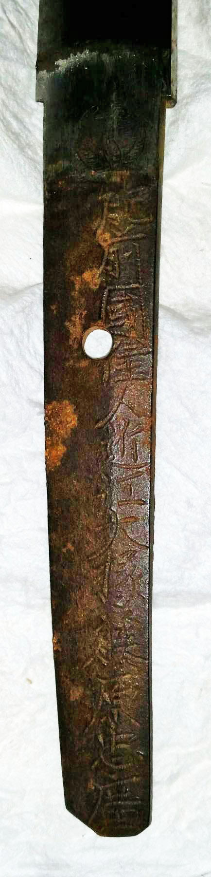

hello all
came accross this nice and beefy waki.
it had a crane mon (or maybe smith logo?) under the habaki.
signature seem like a 17th century smith (likely a good one given the quality of the blade).
did you already come accross such a mon on a blade?
thx
Fred
Interesting mark, interesting inscription. I've never seen the crane emblem on a sword before. It is a kamon, but I don't know if it has some other significance here on the sword. Here are some families that use the "crane-in-circle" kamon.
http://www.ippongi.com/2009/01/15/tsuru/

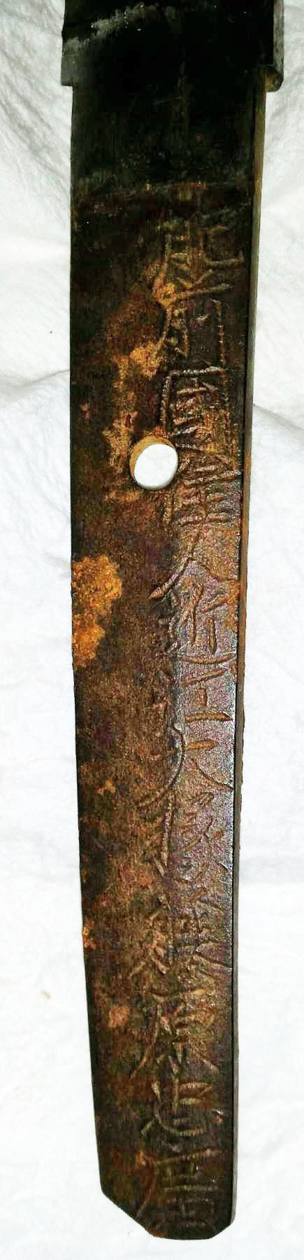

The inscription on the reverse side to the Tadahiro inscription is also interesting. Looks like it says
宝來山作 (something Horai-san saku)
I can't make out the first kanji - it reminds me of 挫, but the kanji on the sword is different. Horai-san is the name of a shrine, and so my guess would be that this sword was made near, or somehow connected with Horai-san shrine. Maybe the crane motif is also connected to the shrine.
http://houraisan.com/
