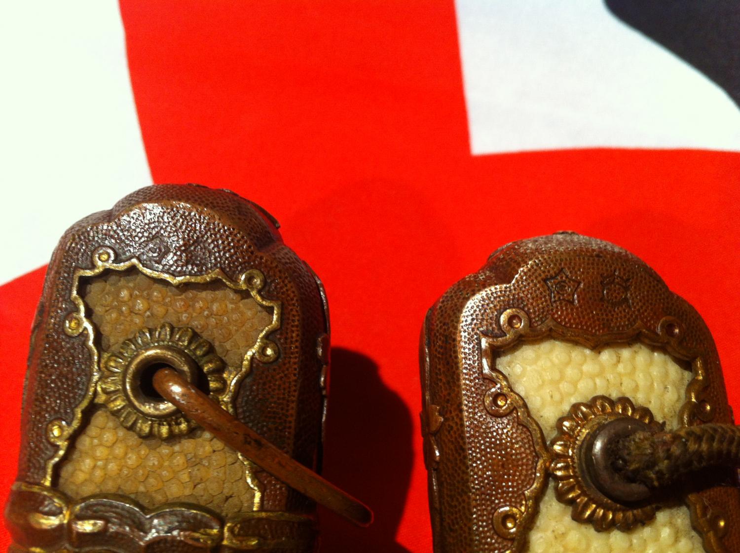

The_ozzy_samurai Posted April 29, 2016 Report Posted April 29, 2016 Hey guy's I purchased a couple tsuka's that have markings i have not seen or in positions not seen before? well by me anyways?,i have a few gunto's with arsenal markings on kabo,but normally with a star and circle with spikes on one side and tokoyo stamp on other, i had 3 of them from memory all the same,well these 2 handles i purchased seem a bit odd to me? one only has the 1 star stamp in the middle? and the other handle has what looks to me like E or some kind of symbol? as i said i had a couple of these i know these stamps are not that common but these 2 tsuka's are just strange to what i have had or seen,i only purchased them purely for the markings,can anyone help or explain what that back to front E symbol is?thanks guys' Julian Quote
The_ozzy_samurai Posted April 29, 2016 Author Report Posted April 29, 2016 http://ohmura-study.net/794.html Thanks for the link i had alrady checked that site,and the books i have on my PC and i cant find that random marking anywhere same goes for the spiked circle on the others Quote

The_ozzy_samurai Posted April 30, 2016 Author Report Posted April 30, 2016 Sorry, had some trouble (old and stupid)... The mark is that of Nakano Shoten, a sword shop of Tokyo. Here is a (cropped) advert from 1942, from p.204 of Dai Nihon Token Shoko Meikan 1942. The shop was in Kanda Ku, Higashi Fukuta cho and they had branches elsewhere. Hope this helps. Hello George, Thanks heaps for the great information, i knew someone out there would be able to help its the first time i have ever that symbol stamped on these type of fittings or anywhere really so i was a little curious of its origin or meaning, i got told by another collector that most of those stamped Kabu's where only for high ranked officers like an officers club type of thing? i seem to only find them on high grade mounts which i can assume is very early war, i have only ever seen a handful of swords with these stamps each one i saw i purchased so i know its kind of rare or should i say not so common maybe? Thanks, Julian Quote
