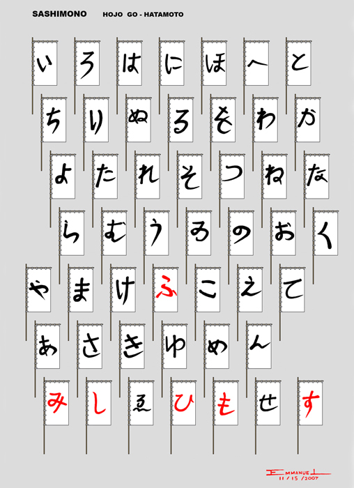

Hi Ian, While a leftward drape of the sashimono may be an artists way of showing speed of movement sashimono were centered unless multiple types. The lifeguards and messenger corps attended the commanders as well some personal attendants, young samurai- pages. Here are some quotes from Turnbull.
The elite tsukai-ban (messenger corps), who acted as aides de camp on a battlefield, were drawn from the same elite stock as the scouts, but had the more restricted task of communicating between friendly troops rather than intelligence gathering. They had to be very easily recognisable in the heat of battle, so were usually distinguished by a spectacular heraldic display. This often took the form of an extra-large sashimono (back flag). For example, Takeda Shingen's messengers wore a sashimono bearing the appropriate device of a busy centipede. Tokugawa Ieyasu's tsukai wore a sashimono with the character go (the figure 5) on it, but the reasons for this choice of symbol are not known.
An alternative cognisance for messengers was the horo, a curious form of cloak stretched over a basketwork frame. The horo would often bear the daimyô's mon (badge) on a brightly coloured background, or would be strikingly particoloured. The horo filled up with air when the horseman rode so his master's colours were recognisable from a considerable distance. There is a reference in the Hosokawa Yusai Oboegaki (The Diary of Hosokawa Yusai) to the elite status of a horo wearer in its recommendation, 'When taking the head of a horo warrior wrap it in the silk of the horo. In the case of an ordinary warrior, wrap it in the silk of the sashimono.' This passage confirms the impression that a man who wore a horo was something special.
The association of the horo with elite status also made it a popular choice for identifying a daimyô’s personal mounted samurai bodyguard. Oda Nobunaga had two horo units, the red horo squad and the black horo squad, while Toyotomi Hideyoshi's bodyguard wore gold horo.
This was the sashimono, the most important heraldic innovation introduced during the Sengoku Jidai. Most sashimono consisted of a small flag similar to a nobori which was made rigid with two poles threaded through the cloth. The flag was flown from a lacquered wooden shaft securely fastened to the back of the armour, and held in place by a cord that passed under the armpits and was tied onto metal rings on the samurai's breastplate. Sashimono could be a hindrance during close combat fighting, and the painted screen of the Summer Campaign of Osaka in Hikone castle shows a samurai's attendant holding his master's sashimono while he engages in personal combat.
The sashimono would often bear the daimyô's mon, giving uniformity to the whole army with different units distinguished by the background colour or field of the flag. The five 'lucky colours' of red, blue, yellow, black and white were the usual choices, and the dragon-scale mon appeared thus on the sashimono of the 'five colour regiments' of the Hojo. In the case of the Ii family of Hikone, however, the red field was a more important distinguishing feature than the Ii mon, so certain Ii samurai were allowed to display their own mon or to have their names written in long flowing golden characters on the red field. The Hojo used the characters of the Japanese alphabet to distinguish sections of their army.
On some occasions sashimono were three-dimensional objects rather than flags. Plumes of feathers and golden fans are depicted on painted screens. Other families used golden discs or gohei (the Shinto prayer wand) suspended from the same poles as used for sashimono flags.

Hi Ian, I can imagine the conversation. I still believe this is a stylisation. When focused on the armour and accoutrement are crudely rendered and the sashimono portrayed this way to disencumber the drawing of the samurai. John

Hi Ian, In furtherance to the question abount diagonally mounted sashimono, there was a concurrence that they were not mounted in this fashion. Between the three of us though, there were three reasons why they were portrayed this way, but all revolving around the artists portrayal. John
