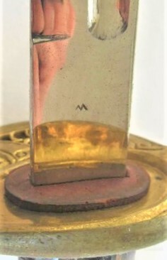

Bridges Posted January 8, 2023 Report Posted January 8, 2023 @Bruce Penningtonhere is a W on a stunning Japanese type 19 of mine. What you may be interested in are the 2 additional deep proof marks on the saya 1 Quote

Bridges Posted January 8, 2023 Report Posted January 8, 2023 I have no idea Bruce, can’t find any info in the 2 books I have and I can’t find the Edward Tinker forum where he had a similar type 19 with a W from where you have your photo. But maybe it was a secret group of individuals who were in a cult and as a sign of devotion marked their blades….just kidding! Y’all are way in over my head, I’ll watch from the sidelines fellas. 1 Quote

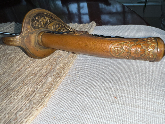

Conway S Posted April 22, 2023 Report Posted April 22, 2023 Recently picked up this Type 19. Thought I would post because it has the "W" in a place I have not seen yet (and bordered too). Conway 2 1 Quote
Kiipu Posted April 22, 2023 Report Posted April 22, 2023 A nice Wakase Military Sword Workshop 若瀬軍刀製作所 logo. I wouldn't mind seeing a picture of the hilt top if your willing. 1 Quote
Conway S Posted April 22, 2023 Report Posted April 22, 2023 Thomas, Ah! So there's a difference between "W" and stamps that resemble "w." I was going to ask if this other stamp was the maker mark, but I guess you answered my question. Aside from some of the braided wire missing, the sword is in overall nice shape. Here are some more pictures of the hilt. Conway 1 Quote

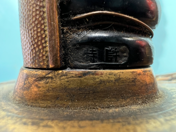

Conway S Posted April 22, 2023 Report Posted April 22, 2023 Does anyone know what this mark says? Hard for me to make out the characters. As a student of Chinese, I usually take the characters I can read and paste them in a Japanese translator. Conway Quote
Kiipu Posted April 22, 2023 Report Posted April 22, 2023 30 minutes ago, Conway S said: So there's a difference between "W" and stamps that resemble "w." Many thanks for the hilt picture Conway. The Wakase company logo can be seen in this picture posted by @k morita. Sign on Sword, Post #2 27 minutes ago, Conway S said: Does anyone know what this mark says? 特許 = Patent. Quote
Conway S Posted April 22, 2023 Report Posted April 22, 2023 I could see "patent" clearly too once I looked at the picture referenced in the link. Thanks! The reverse side of the lower hilt area has the patent numbers. Conway Quote
Kiipu Posted April 22, 2023 Report Posted April 22, 2023 Conway, your sword is only the second one known. It was made during or after 1942 as that is when the patent was issued. Below is a link to the other known sword. Police Sword? 1 Quote
Conway S Posted April 22, 2023 Report Posted April 22, 2023 Very interesting! I see from other posts on the forum they made fittings (ex. scabbard drags). Any thoughts on what specifically they were patenting here? Conway Quote
Kiipu Posted April 22, 2023 Report Posted April 22, 2023 The sword would have been assembled by Wakase. Not everything is made in-house, even back then. The patent did not belong to Wakase. It had something to do with the production process of the grip. I was slightly off in my dates above. The patent was issued in December 1942 so your sword dates from 1943 to 1944. Quote

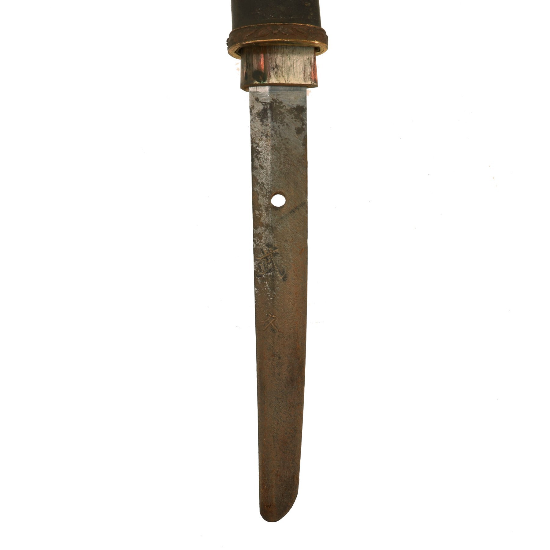

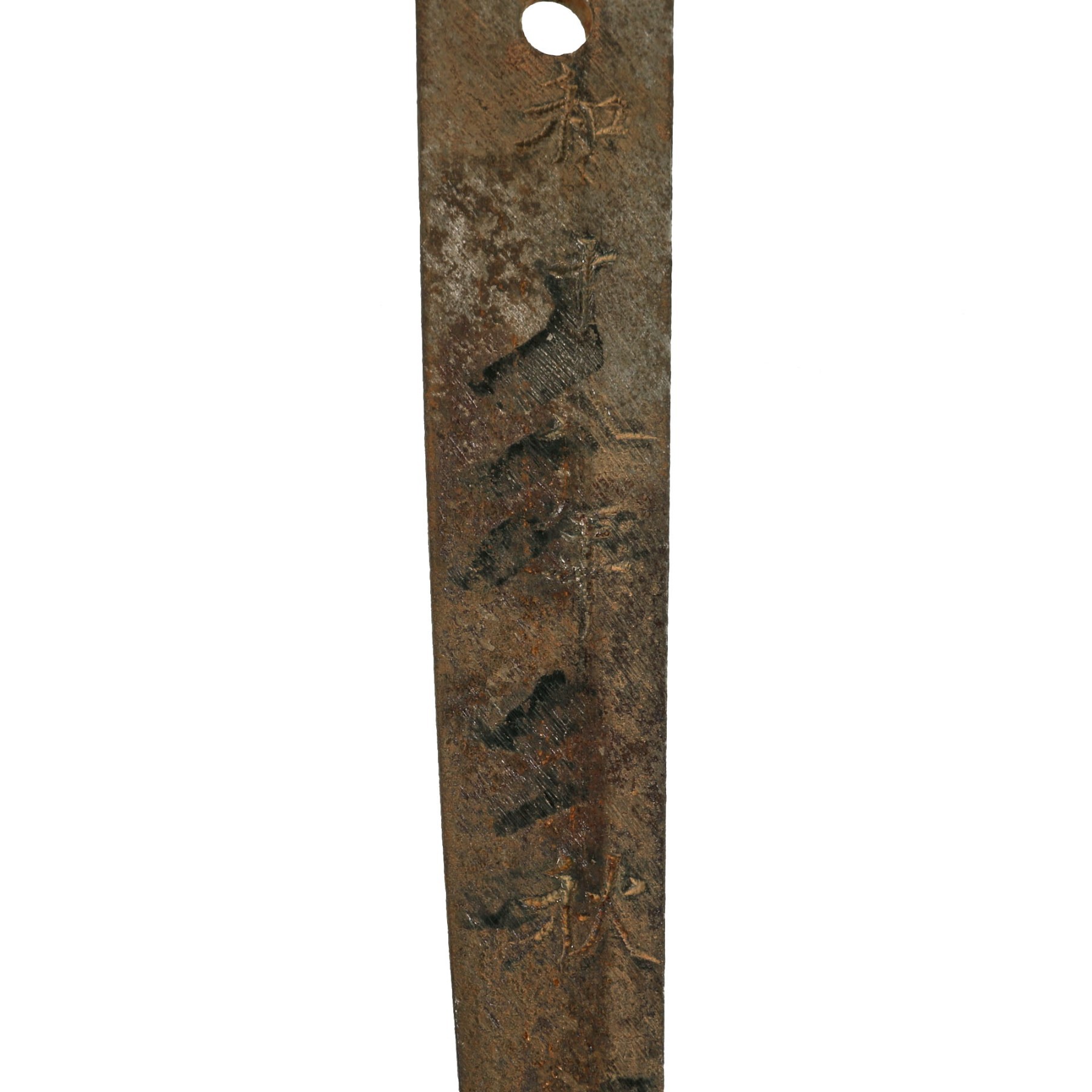

tbonesullivan Posted March 15 Report Posted March 15 Another TAKEHISA! Dated 昭 和 十 八 年 秋 - 1943 AKI Tang has some rust areas but there is definitely one clear "W" at the bottom on the side with the Mei. The fittings are matched as well, and the Tsuba and Seppa are marked with "& 3 3 1", while the tsuka, fuchi, and scabbard lock are marked "& 三 三 一". Never seen an ampersand used as a matching number, but I guess it works! Quote
