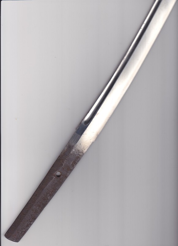

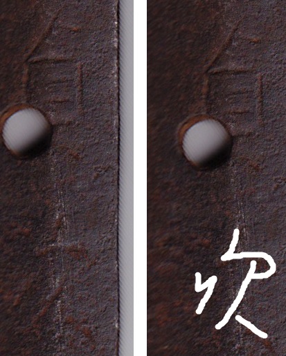

FletchSan Posted April 22, 2016 Report Posted April 22, 2016 Hi All, I have a wakizashi that doesn't seem to have any significant flaws and is in need of a polish. It came poking out of an old saya from a shirasaya with no other fittings other than a two part habaki. There is very faint writing on the saya which I cannot make out. From the shape - it appears to be a Koto blade. It is also signed though hard to make out - using Yumoto's Kanji mei reference it looks like Sadahisa to me? Nagasa: 53cm Sori: 2.2cm Interested in your opinions as always! thanks, Ben 1 Quote
Stephen Posted April 22, 2016 Report Posted April 22, 2016 (edited) Id look at the Sadamotos see when they worked Edit to add, no need to polish, just uchiko it. Edited April 22, 2016 by Stephen Quote
FletchSan Posted April 22, 2016 Author Report Posted April 22, 2016 Thanks Stephen - I had missed moto and that does look like a possibility. I can't find much on either Sadahisa or Sadamoto as Smiths and no examples Mei either. Sadahisa http://nihontoclub.com/smiths/SAD36 Sadamoto http://nihontoclub.com/smiths/SAD532 Actually there is a sticker on the Saya that has Sadatsugu written on it though looks nothing like Tsugu to me? Quote
Stephen Posted April 22, 2016 Report Posted April 22, 2016 wrong moto, ill try to find SADAMOTO (貞元), Kakitsu (嘉吉, 1441-1444), Bizen – “Bizen no Kuni Osafune Sadamoto” (備前国長船貞元) SADAMOTO (貞元), Bunki (文亀, 1501-1504), Iwami – “Sekishū Nagahama-jū Sadamoto” (石州長浜住貞元) So looks koto, if you have Yumoto book yull see the stylized moto. Quote
FletchSan Posted April 22, 2016 Author Report Posted April 22, 2016 Thanks Stephen. Very helpful - I'll see if I can find examples of both Sadamoto and compare. The very last Tsugu example in Yumoto's book does also look close the longer I stare at it Quote
FletchSan Posted April 22, 2016 Author Report Posted April 22, 2016 What do you think? Am I seeing things - could it be Sadatsugu after all? Quote
Stephen Posted April 22, 2016 Report Posted April 22, 2016 Ben I think your onto something there, boy their is a ton of them, be hard to pin down which one, shinsa foder for sure. nice find Quote
Ray Singer Posted April 22, 2016 Report Posted April 22, 2016 Appears to be Sadatsugu. Best regards, Ray Quote

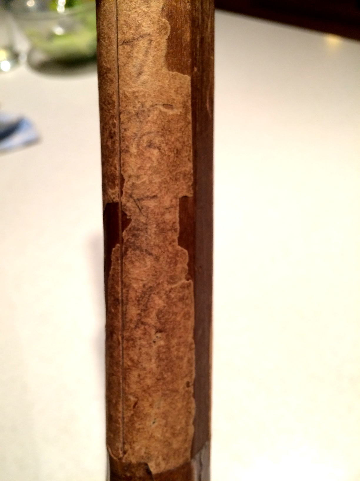

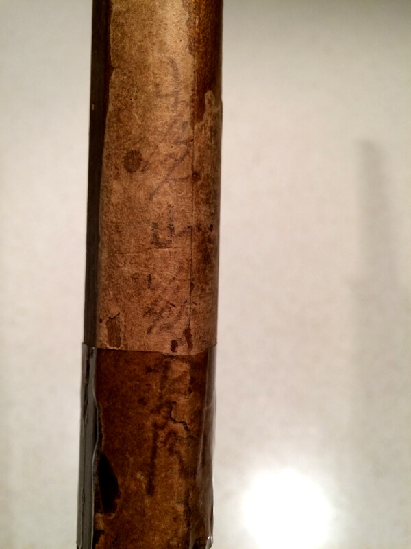

FletchSan Posted April 22, 2016 Author Report Posted April 22, 2016 Thanks guys. Out of interest, attached are pics of the writing on the saya which is pretty much illegible. 1 Quote
Alex A Posted April 22, 2016 Report Posted April 22, 2016 Looks like late Muromachi Uchigatana, as used by the Ashigaru (foot soldiers). Plenty of Sadatsugu,s, as mentioned. Had a quick look for any using Suguha hamon (looks Suguha), one crops up, Tenbun 1530-1550, Satsuma, Suguha or Suguha mixed with Ko-notare Now, I'm not saying this is who made the sword (just an example), just having a quick look. Ben, that's what you need to do, look at all the kantei points, and see what comes up. All fun 1 Quote

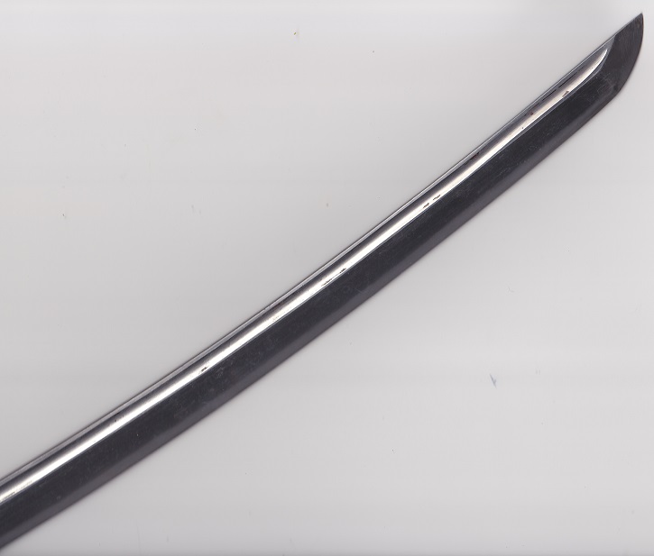

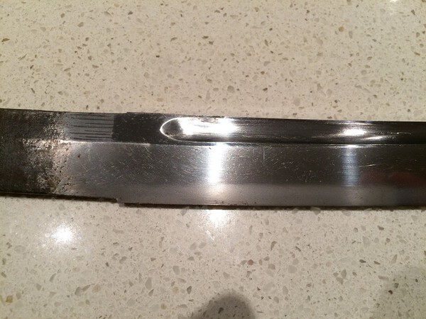

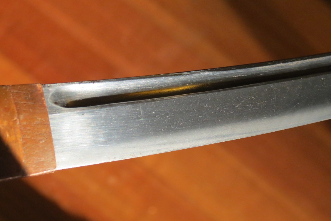

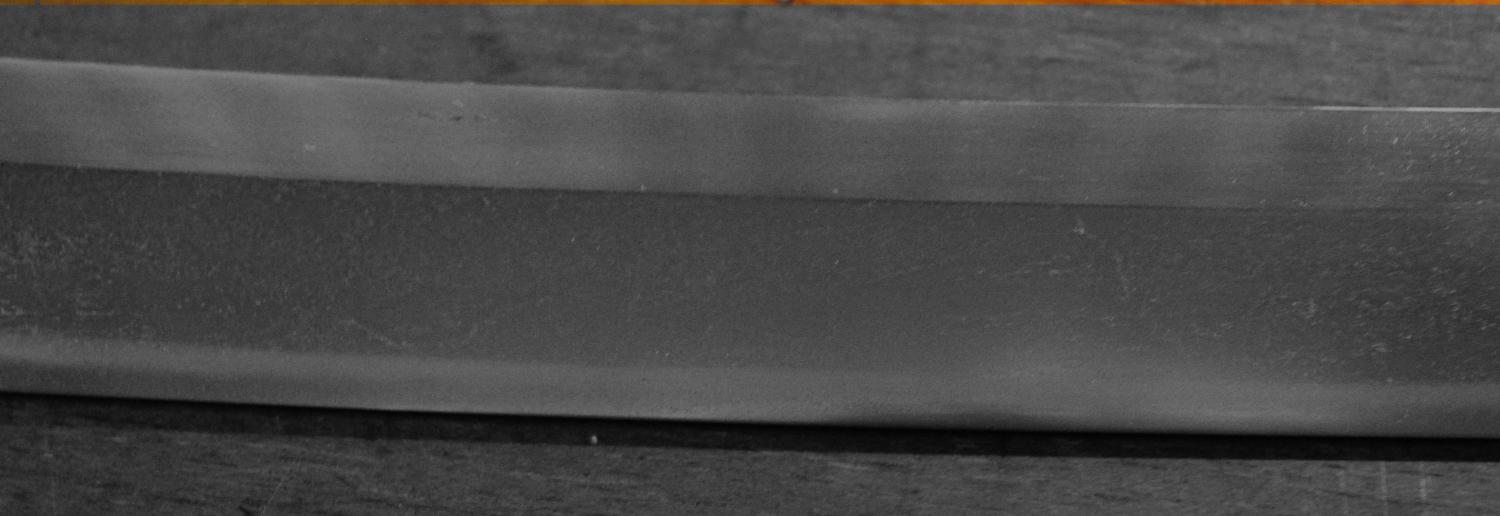

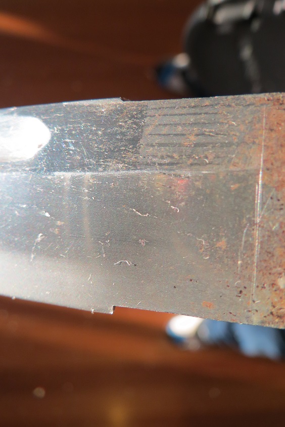

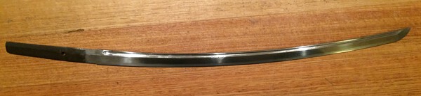

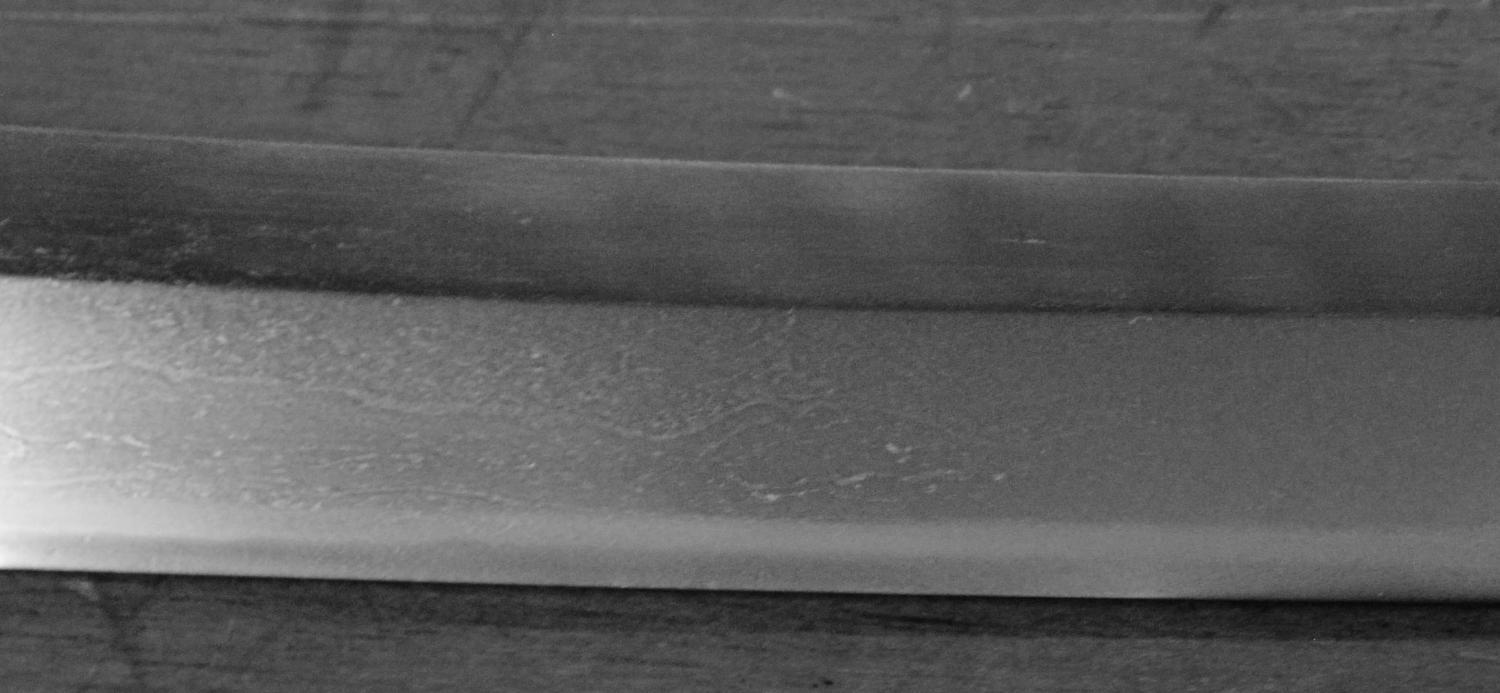

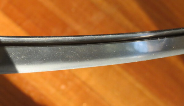

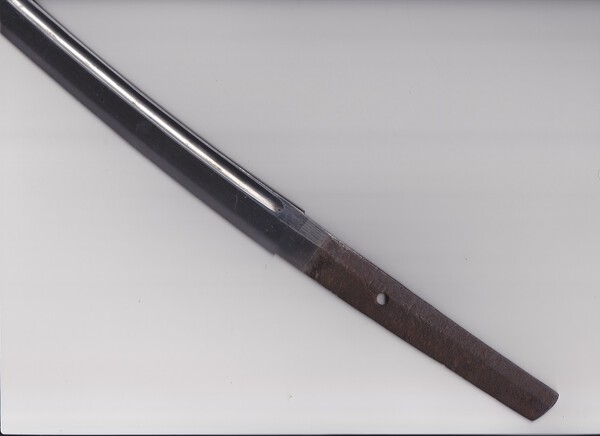

FletchSan Posted April 24, 2016 Author Report Posted April 24, 2016 Thanks Alex. I've been reading up on Kantei and have also ordered Markus Sesko's Kantei books so will have plenty of study and reading to do! I've taken a few more photos that show the hamon and hada a little more clearly. Do you think the blade is suriage or is it just a normal rounded Kurijiri end? The nagako is too rusted for me to make out the yasurime. cheers, Ben Quote
Alex A Posted April 24, 2016 Report Posted April 24, 2016 Hi Ben, looking at your latest pics, with the one mekugi-ana, looks Ubu to me, a lot of these type of swords are Machi-okuri, with two mekugi-ana. I see your mekugi-ana goes through part of the mei, someone was none to fussy in the fittings/mei department, see that from time to time. In this case, I guess less care was taken with the non-custom made swords during those times. (sengoku) Its not an arty-farty sword, but a sword made for battle, reminds me of an Uda tachi I own. The Bo-hi is a nice bonus, someone at some time felt the blade was worth it. Looks a decent sword, not Kazu-uchimono, as a lot get labelled, in some of the cases I think unfairly. Quote

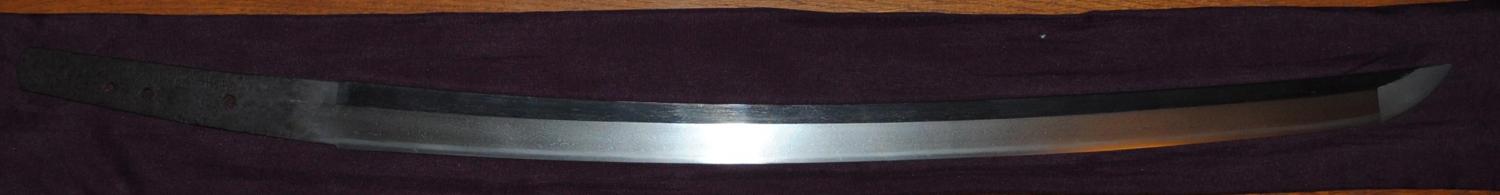

paulb Posted April 24, 2016 Report Posted April 24, 2016 Hi Ben I am not sure if this will help or not but your sword reminds on one I currently have here. It is also a powerful wakazashi I have copieds my description below: Mei: Bitchu no Kuni ju nin Sadatsugu (signed tachi-mei) Hada combination of Itame and nagare, some darker patches (Jifu?) Hamon Suguha in nioi. Comment: This is a powerful wakazashi typical of the late koto period and exhibiting all the characteristics you would expect to see in a Sue Aoe blade. Hamon is almost exclusively nioi, the hada has a whiteness and combines a running itame with smaller rounded itame patches The workmanship looks to be sue Aoe which is in line with the mei and the shape. As Alex says these are powerful fighting swords, no great elegance but certainly imposing. Quote
FletchSan Posted April 25, 2016 Author Report Posted April 25, 2016 Thanks Paul & Alex. I'm pretty happy with it and surprised at how nice it is (only paid $660). I just need to find decent fittings for it or get shirasaya made I guess as it only has a saya in very poor condition. Is it fairly common for late koto swords to have a bohi given they were mostly mass produced at that time, or could it have been added later? cheers, Ben Quote

Alex A Posted April 25, 2016 Report Posted April 25, 2016 Is it fairly common for late koto swords to have a bohi given they were mostly mass produced at that time, or could it have been added later? cheers, Ben Hi Ben, according to JW Bott (the sword of Japan book), a groove cut by the swordsmith who made the sword, will usually run the full length of the sword, including the nakago. (maybe others have a different point of view?) A groove cut at a later time, known as "atori-bori hi", will normally stop in in the vicinity of the habaki to preserve the signature. Yours was cut later, how much later I dont know, a few months?, fifty years?, who knows, sometimes ware gives you an inkling. Look into your sword, look to see if Horimono was common to the school. How common horimono were on mass produced swords is a good question, I can only assume not to common, taking into account the 1000s up on 1000s made which were considered disposable. It was expensive for the Ashigaru and possibly low rank Samurai. Saying that though, there was money to be made on and off the battlefield, so who knows maybe the odd horimono was paid for with loot or by the reward from a severed head of an opposing big wig I'm not too clued up, be good to hear other views. Ps, I would save money on the koshirae idea, and stick with the shirasaya idea Quote
