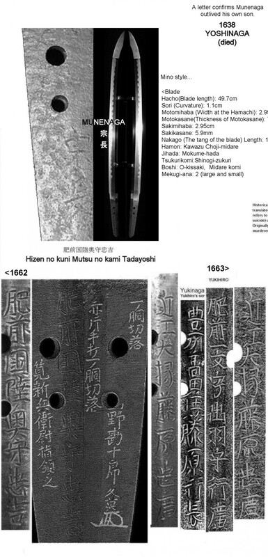

Bold statement: Here it comes> This MUNENAGA is more famous for his HORIMONO carving on 1st Gen Tadayoshi blades.
This surely would be one of his latest blades(if not his LAST)...as you know he was famous for HORIMONO carving on 1st gen Tadayoshi's blades... and as you can see in the evidence provided (a detail from the Tadayoshi School timeline) he returned to do some mekugi-ana hole drilling (appearing on 3rd Gen Mutsu Tadayoshi and his father 2nd Gen Omi Tadhiro blades) specific for only a 2 year period...maybe not even that long. Venerable... old... pro... a genius.
Munenaga outlived his son Yoshinaga who died in 1638 (ref Marcus Sesko...letter by Munenaga)
At this period Yukihiro was teaching 2nd Gen Masahiro (a blade shows this - one that Sotheby's said was 1st Gen Mas and 1st Gen Yuki - but it aint brothers it's an Uncle and Nephew sword)
...and 1st Gen Tadakuni was helping the 2nd Gen Masahiro make blades for the Omi with the Mutsu.
That's the period.
1661 is only 1-2 years out so it was labelled correctly on Ebay.
I'd just added your blade to the timeline (an overview of the whole century in the Tadayoshi School) and was surprised to see it as a current thread on here. "Yes the signature looks slightly different as it looks like the MUTSU wrote it for him.
*MUNENAGA writes down the middle of the blade (so Mekugi-ana would be within the characters)
