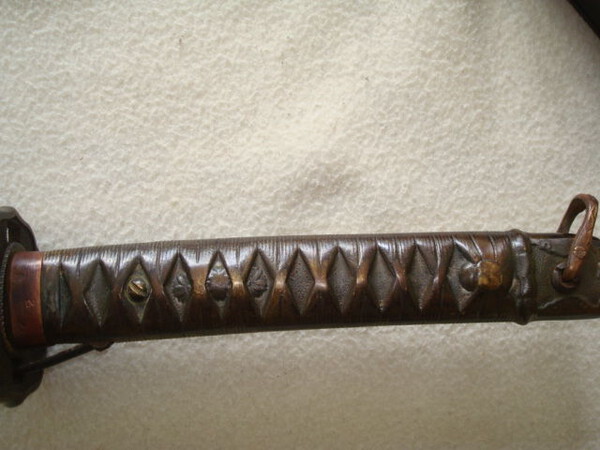

Julian Posted April 16, 2016 Report Posted April 16, 2016 Hello everyone i just want your opinion about this sword ...when i refer to http://www.japaneseswordindex.com/military.htm..the nco model im looking for have a the same copper hilt like the one show in the link but no screw .. i just want to make sure before buying because i know there is a lot of FAKE thks for your help regards Julien Quote
Stephen Posted April 16, 2016 Report Posted April 16, 2016 it has screw, it has high numbers, i call knock off, not true Copper NCO 1 Quote
charlie1 Posted April 16, 2016 Report Posted April 16, 2016 Also copper handles have no drag on the scabbard and the sarute is also wrong. Charlie S. 2 Quote

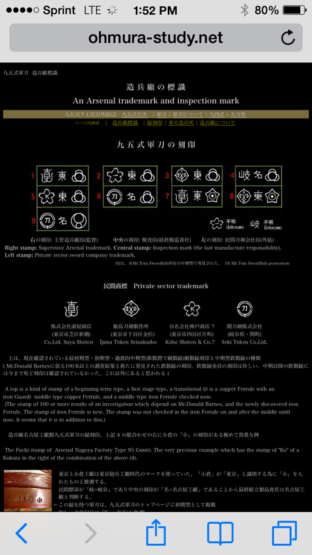

Stephen Posted April 16, 2016 Report Posted April 16, 2016 study this site http://ohmura-study.net/957.html 1 Quote
Julian Posted April 17, 2016 Author Report Posted April 17, 2016 thks you Stephen very nice website 1 Quote

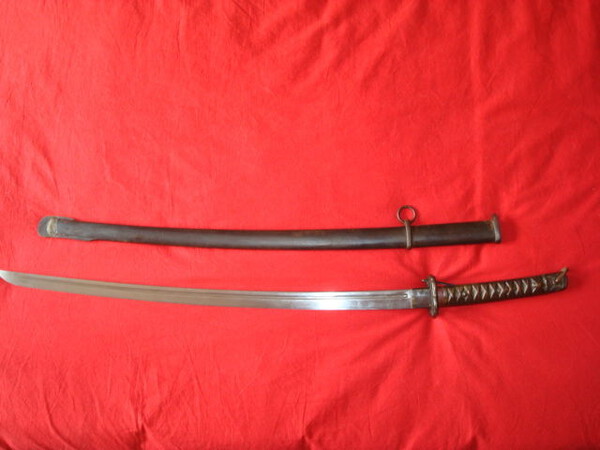

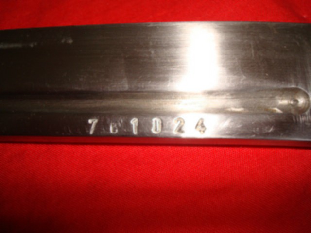

Julian Posted April 27, 2016 Author Report Posted April 27, 2016 This one i think is a true firts model and the scabbard fit as descrive on the website you link Stephen but i think this one as be repaint ? i dont know what the final price gonna be but im guessing near 2k http://www.ebay.com/itm/162049285590?_trksid=p2060353.m1438.l2649&ssPageName=STRK%3AMEBIDX%3AIT Quote
Stephen Posted April 27, 2016 Report Posted April 27, 2016 Its a good one, my guess well over 3K, matching low number, really nice! 1 Quote
Julian Posted April 27, 2016 Author Report Posted April 27, 2016 oh yaaa you think over 3k wow that a high price for a machine made blade but yes it look very good and it rare so we gonna see soon how much a collectionner want to pay for this one thks Stephen have a great day Quote

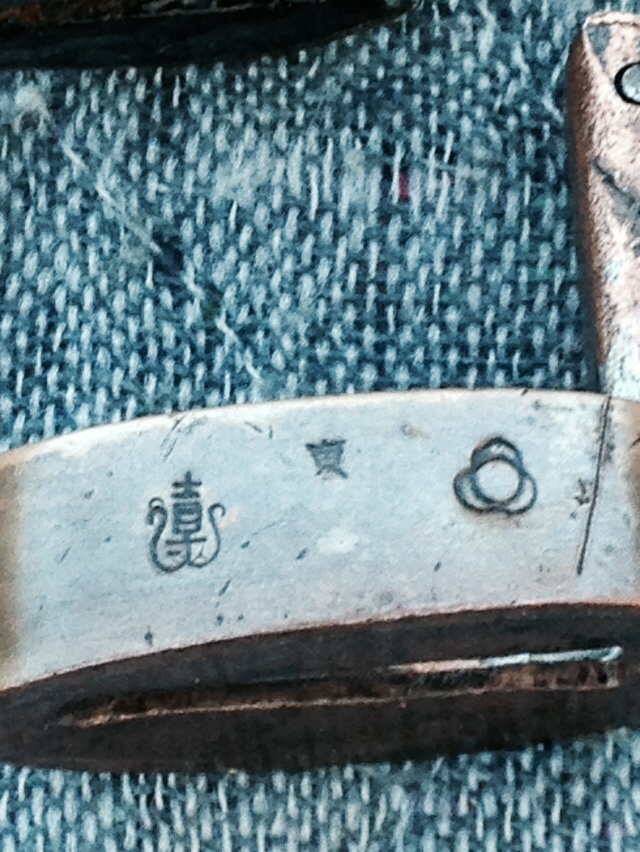

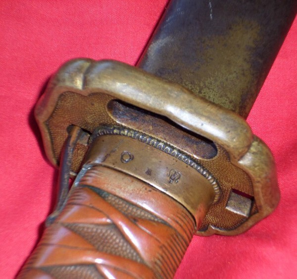

Bruce Pennington Posted April 28, 2016 Report Posted April 28, 2016 Wow, I realize, like Fuller of F&G said, there are exceptions to every rule. This is one of them. I've never seen one with the arsenal and manufacturer stamps in that order. They are normally the other way (pics below). Also, the Kokura stamp on the blade is on the wrong side. The blade and saya look correct and the tsuba is fatter than normal, but F&G has one like that too. Overall, I'd say this is legit and just stamped by an inspector with dislexia! I paid $2,400 for mine! 1 Quote
vajo Posted April 28, 2016 Report Posted April 28, 2016 http://www.ebay.com/itm/162049285590?_trksid=p2060353.m1438.l2649&ssPageName=STRK%3AMEBIDX%3AIT Looks amazing. Such nice condition. That will be very expensive. Bruce you have also a very nice one. Congrats. 2 Quote
Stegel Posted April 28, 2016 Report Posted April 28, 2016 I also have one of my Type 95's with the logos in reverse order. Bruce, your fuchi appears to be made of brass?? can you confirm pls? Quote

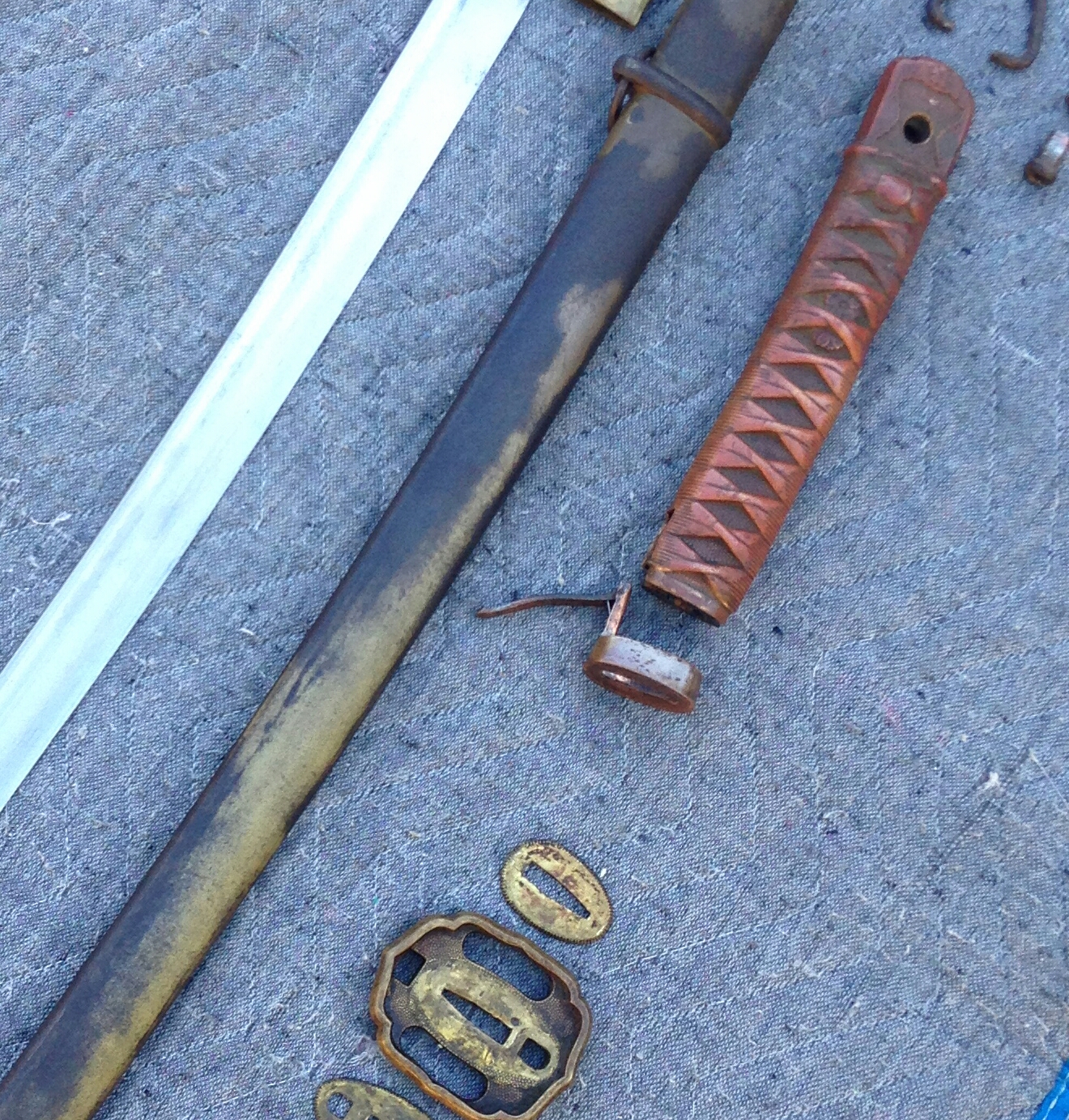

Bruce Pennington Posted April 29, 2016 Report Posted April 29, 2016 On 4/28/2016 at 10:56 PM, Stegel said: I also have one of my Type 95's with the logos in reverse order. Bruce, your fuchi appears to be made of brass?? can you confirm pls? Stegel, I'm on the road, hoping to be home late tonight, and I'll take a closer look at it. Here's a couple more pics I have on my tablet. One looks like copper but in the other shot, it looks brass, maybe with copper coating? Quote
Stephen Posted May 1, 2016 Report Posted May 1, 2016 http://www.ebay.com/itm/Japanese-SWORD-RARE-JUST-FOUND-AT-SHOW-COPPER-NCO-EARLY-SN-MATCHING/162049285590?_trksid=p2045573.c100033.m2042&_trkparms=aid%3D111001%26algo%3DREC.SEED%26ao%3D1%26asc%3D20131017132637%26meid%3Dc2b2be9bb7ee413ab2c28005cc51947d%26pid%3D100033%26rk%3D1%26rkt%3D4%26mehot%3Des%26sd%3D162049285590&autorefresh=true Quote
Stephen Posted May 1, 2016 Report Posted May 1, 2016 1K OVER my guess, is this a record?? 4009$!!!! 1 Quote
charlie1 Posted May 1, 2016 Report Posted May 1, 2016 I was looking at the auction too.. Crazy prices on ebay sometimes. Especially with the repainted scabbard. I like military swords, but I can't justify 4K on a NCO sword. charlie Quote
Fred Geyer Posted May 1, 2016 Report Posted May 1, 2016 It is still a very rare sword that is matching , when was the last time you saw one for sale and the old paint is easly taken off to the original finish, I say a good buy!! my be the last one you see sold for many... many, years!! Quote

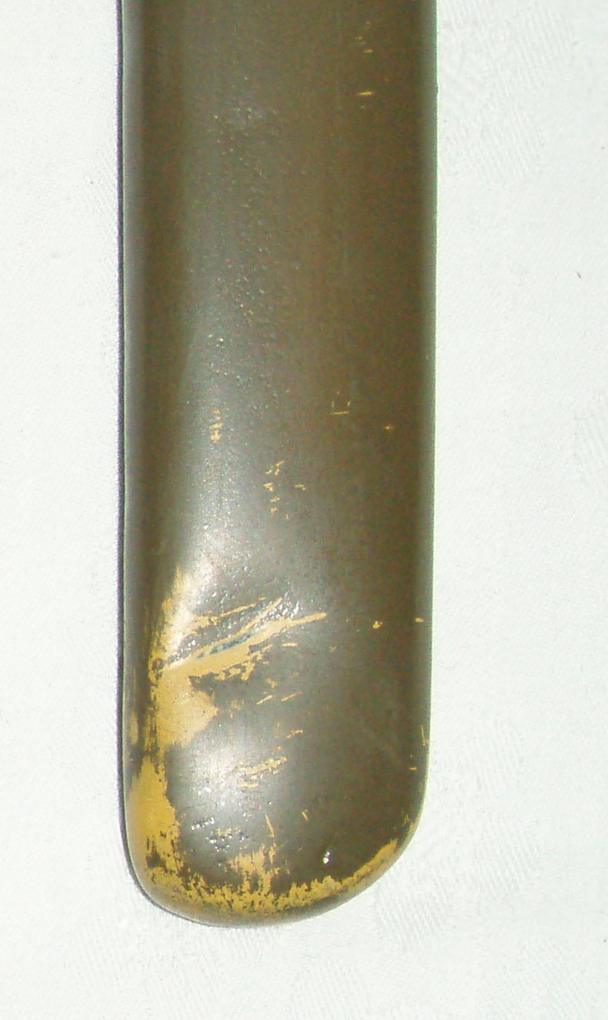

charlie1 Posted May 1, 2016 Report Posted May 1, 2016 The examples I've seen in person and in the Dawson and Fuller books the brass plug on end is not painted over. The NCO one on ebay was painted over, so when it was painted over is up for debate. Quote
Stegel Posted May 1, 2016 Report Posted May 1, 2016 On 5/1/2016 at 11:25 PM, charlie1 said: The examples I've seen in person and in the Dawson and Fuller books the brass plug on end is not painted over. The NCO one on ebay was painted over, so when it was painted over is up for debate. I agree, this one has been painted over, however, originally these had a primer applied to the base metal before the OD was applied. The brass plugs were also painted over. I have one with almost mint paint on the scabbard, here's the picture for your interest. Quote
Stegel Posted May 2, 2016 Report Posted May 2, 2016 On 5/1/2016 at 10:59 PM, Stephen said: 1K OVER my guess, is this a record?? 4009$!!!! I thought you're guess was pretty accurate, but.... well, every now and then a surprise pops up. I don't think it is a record though, about 2 yrs back a couple of Copper NCO's went for 3500 and 4200. A fellow i know sold one for US $6,433.70.....but it was a 2 digit and numbers matching! I suppose it's a combination of 1- Availability 2- Desirability, and enough of #2 on the day!! Found the add: Quote Item number: 330601997595 Japanese SWORD NCO COPPER HANDLED EXCEPTIONALLY RARE LOW NUMBER Item condition: Used Ended: Aug 16, 2011 05:41:27 PDT Sold For: AU $6,500.00 1 bid Approximately US $6,433.70 Shipping: AU $50.00(approx. US $49.49) - Standard Shipping | See all shipping details Item location: pinjarra, Australia 1 Quote

Bruce Pennington Posted May 2, 2016 Report Posted May 2, 2016 On 4/28/2016 at 10:56 PM, Stegel said: I also have one of my Type 95's with the logos in reverse order. Bruce, your fuchi appears to be made of brass?? can you confirm pls? I've gotten a close look at that fuchi. Comparing it to the clearly brass habaki and the copper handle, I'd say it looks more like copper than brass. Quote
Stegel Posted May 2, 2016 Report Posted May 2, 2016 Thanks for the reply Bruce, it looked interesting enough to ask about. Cheers 1 Quote
