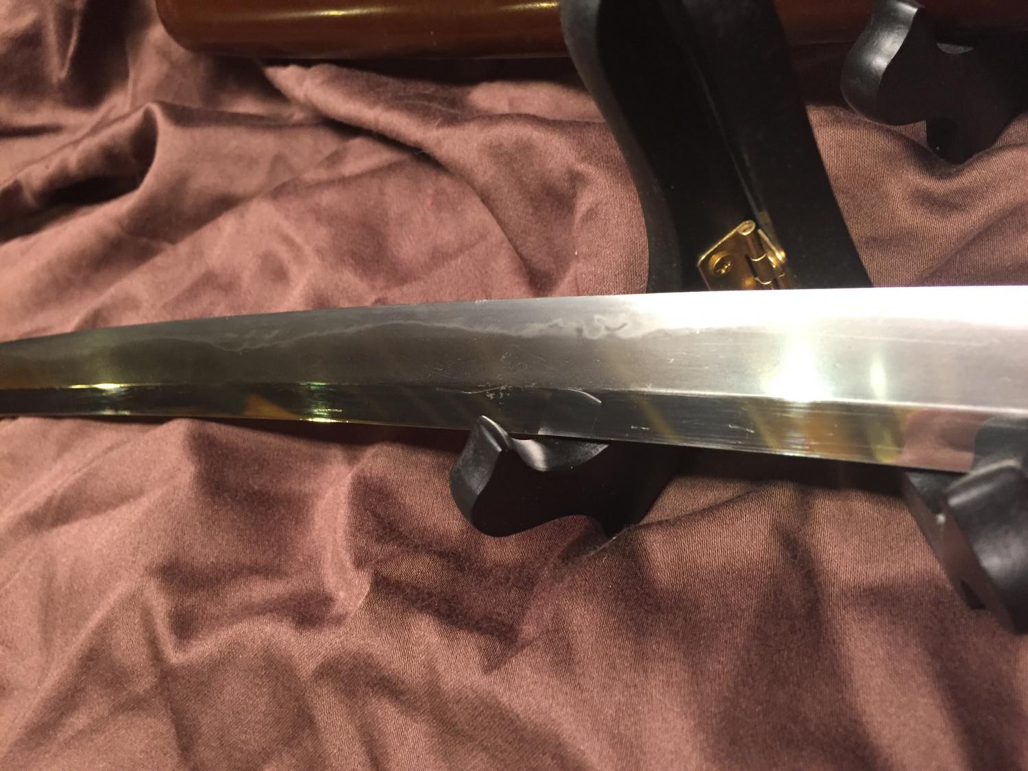

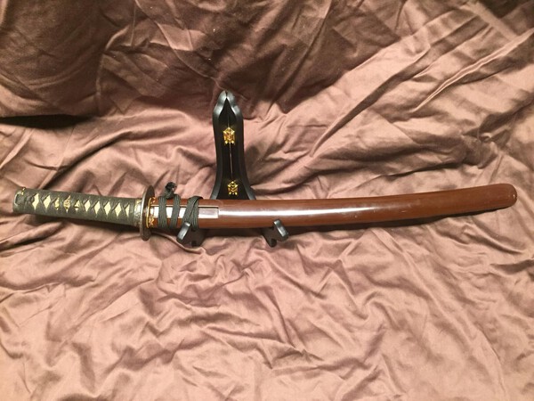

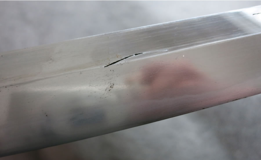

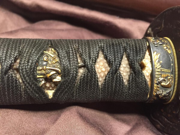

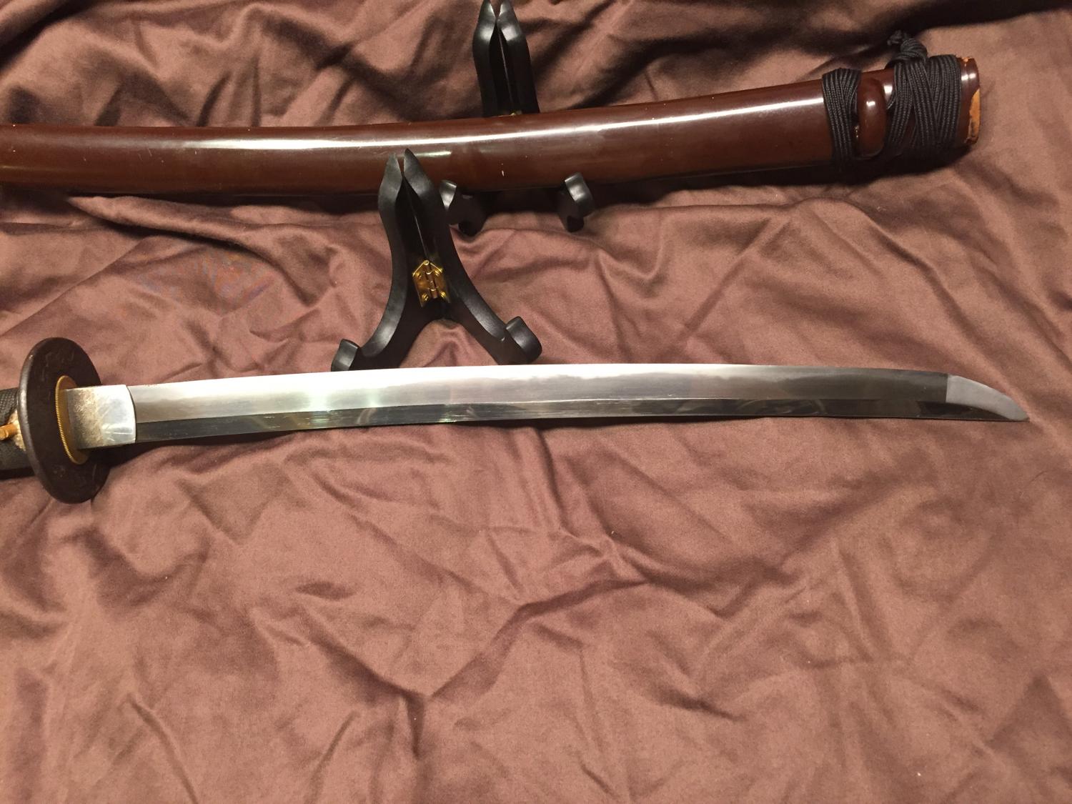

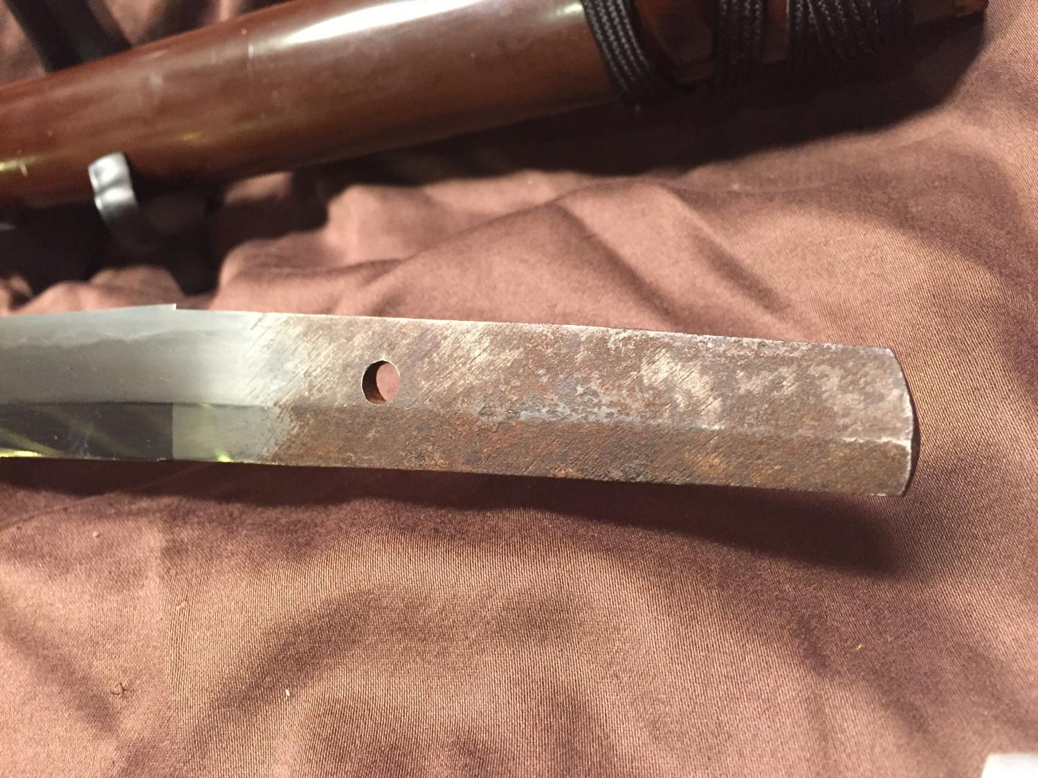

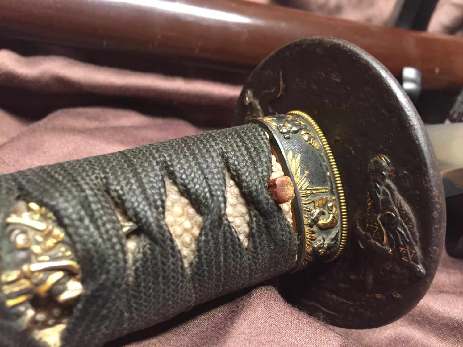

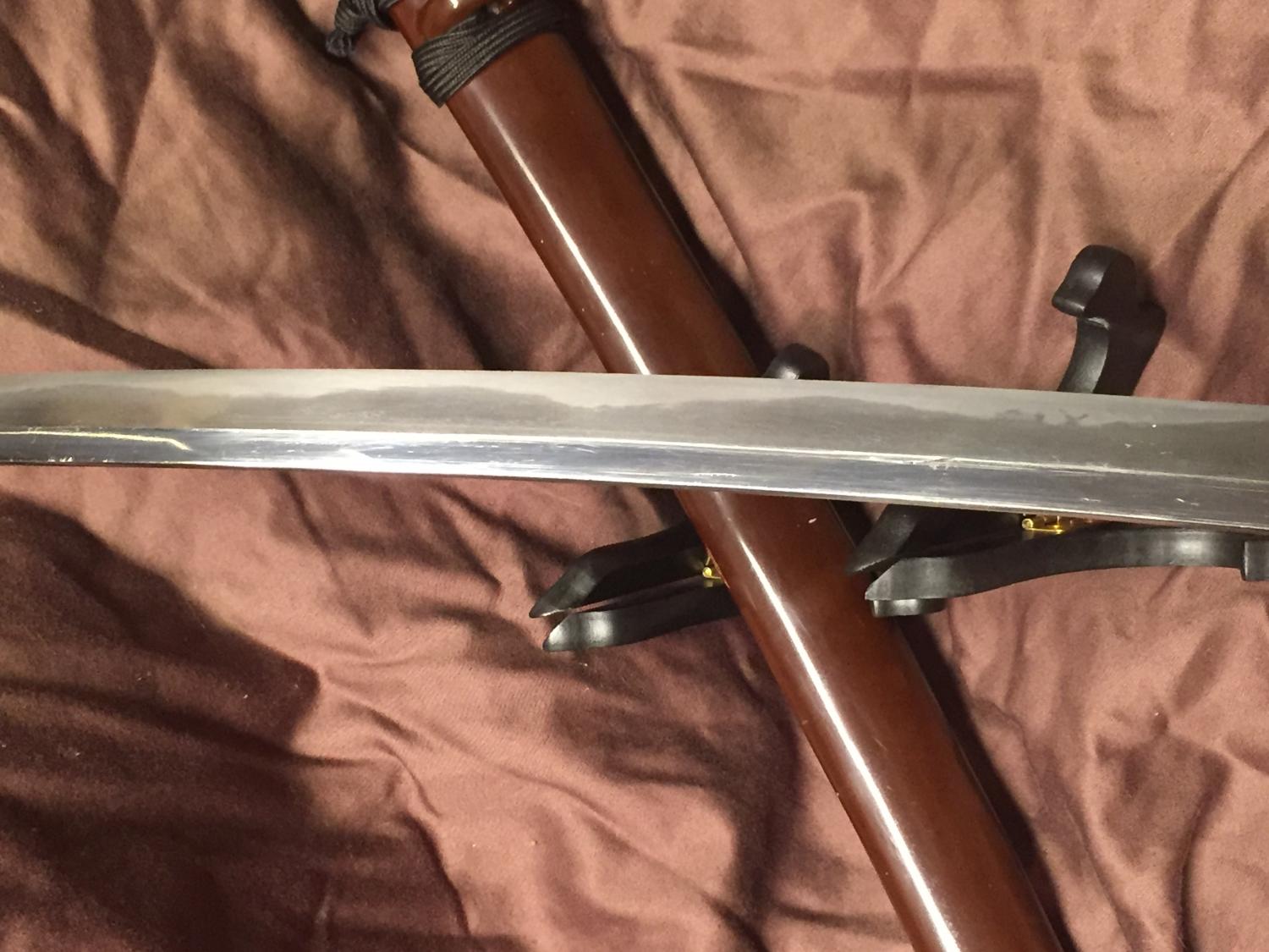

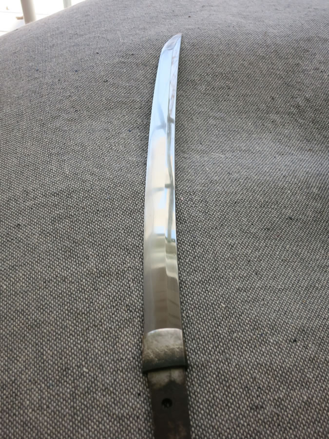

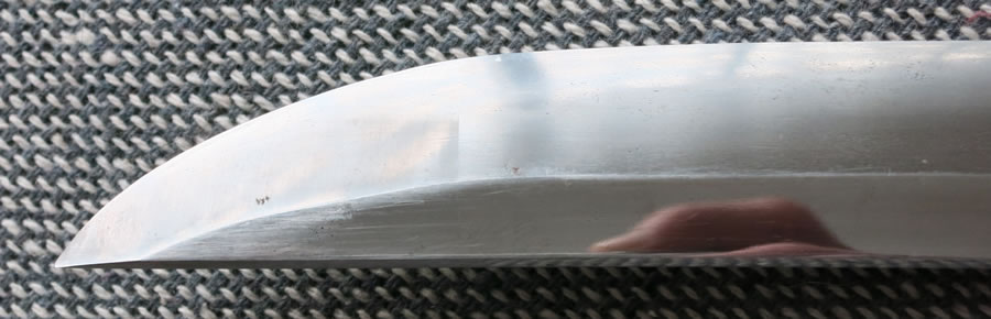

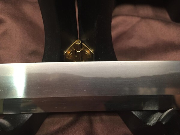

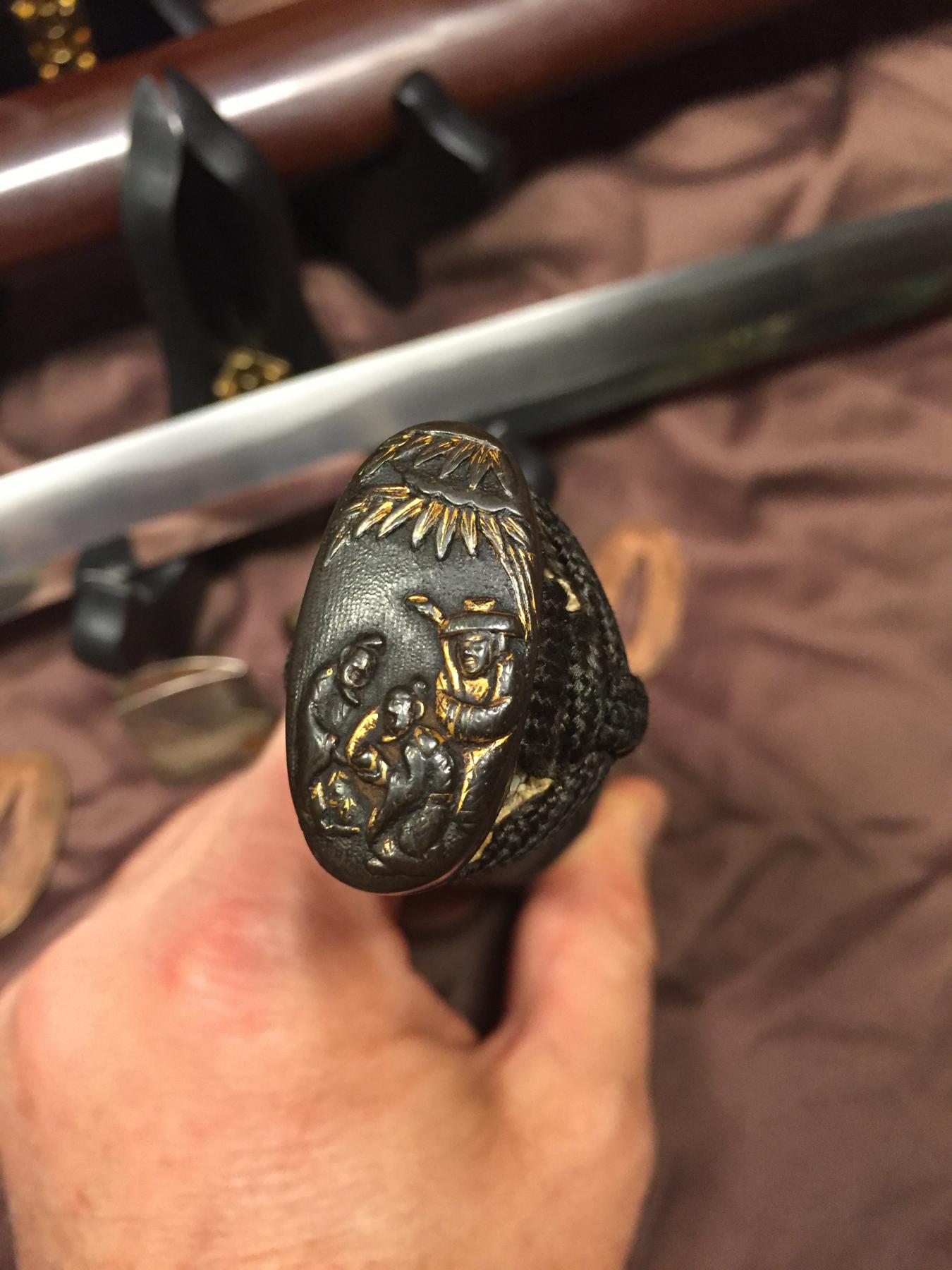

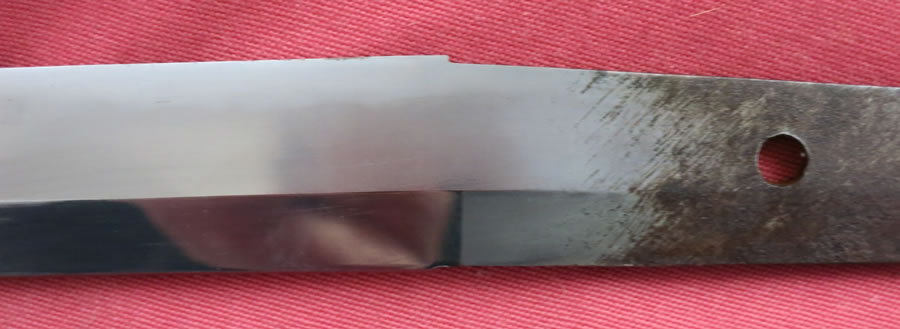

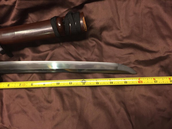

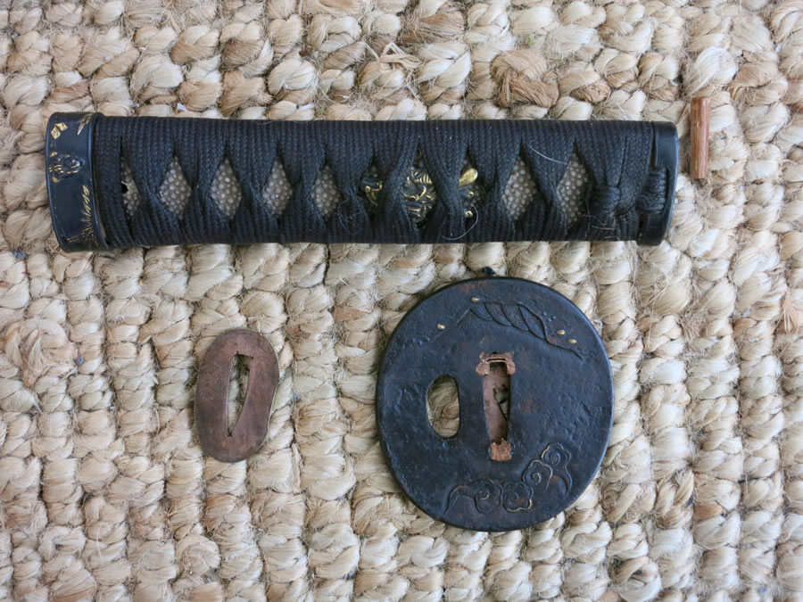

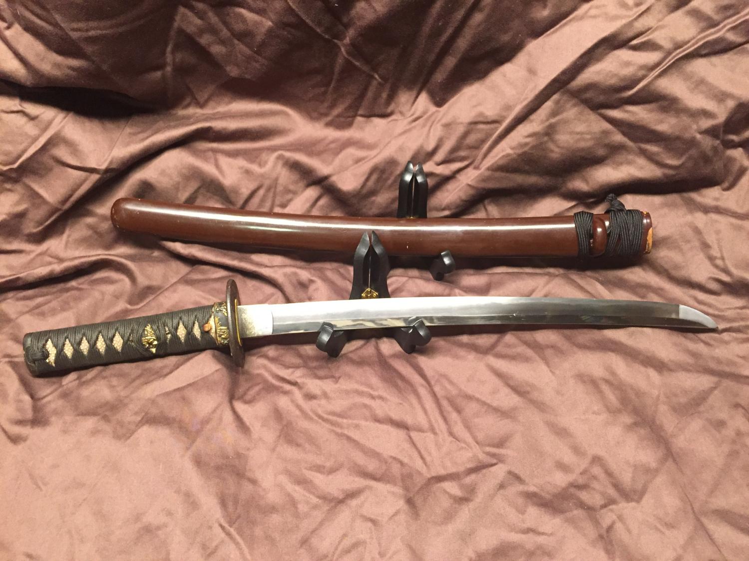

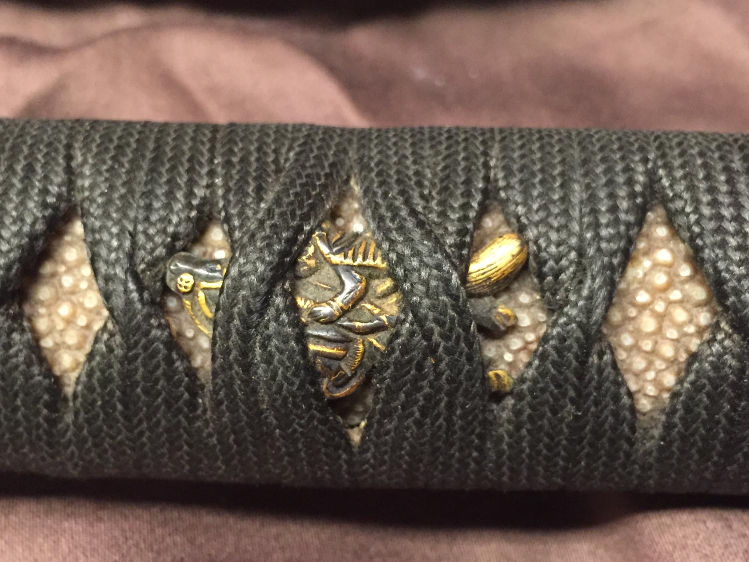

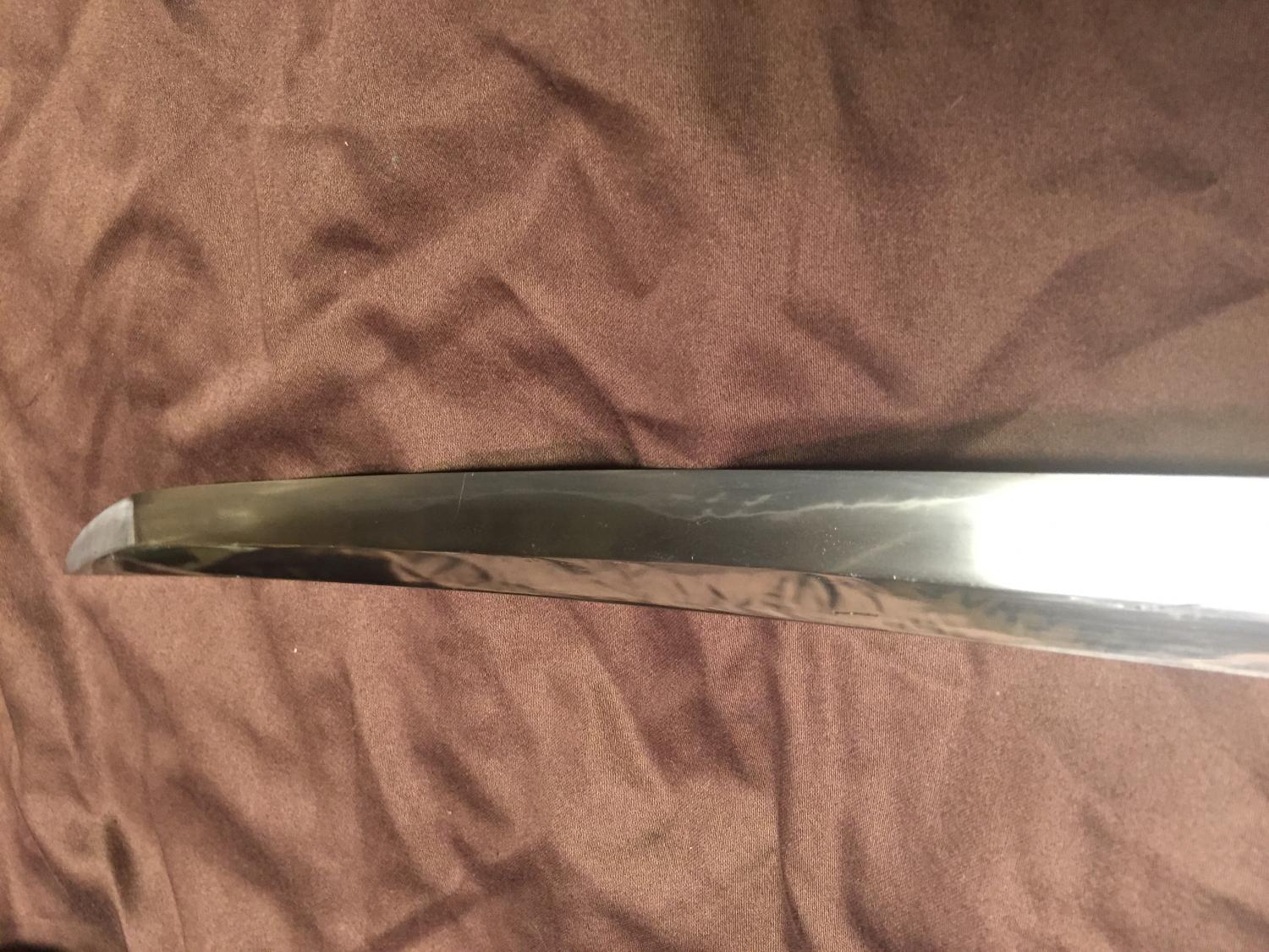

I'm going to see this Wakizashi Friday afternoon.  It's the start of my turkey season here in MN so hopefully I will have a nice gobbler on ice in the morning and a fun sword to consider in the afternoon!  Here's what I have for pics so far.  Saya is in good condition.  Blade has a few openings as you can see and is unsigned.  Provenance, same old story, sword has been in the family a long time, brought back by a world traveler.  One thing that did jump out at me is the tsuka.  The ray skin, if that's what it is, looked a little off to me, in color and the nodules all seem very uniform.  Everything else seemed honest.  What do you think? Thank you.
post-2064-0-23213700-1460592669_thumb.jpgpost-2064-0-96734200-1460592685_thumb.jpgpost-2064-0-78299000-1460592702_thumb.jpgpost-2064-0-77497500-1460592717_thumb.jpgpost-2064-0-16362300-1460592731_thumb.jpgpost-2064-0-31124600-1460592741_thumb.jpgpost-2064-0-21215300-1460592753_thumb.jpgpost-2064-0-04025400-1460592768_thumb.jpgpost-2064-0-23276100-1460592778_thumb.jpgpost-2064-0-86643000-1460592791_thumb.jpg

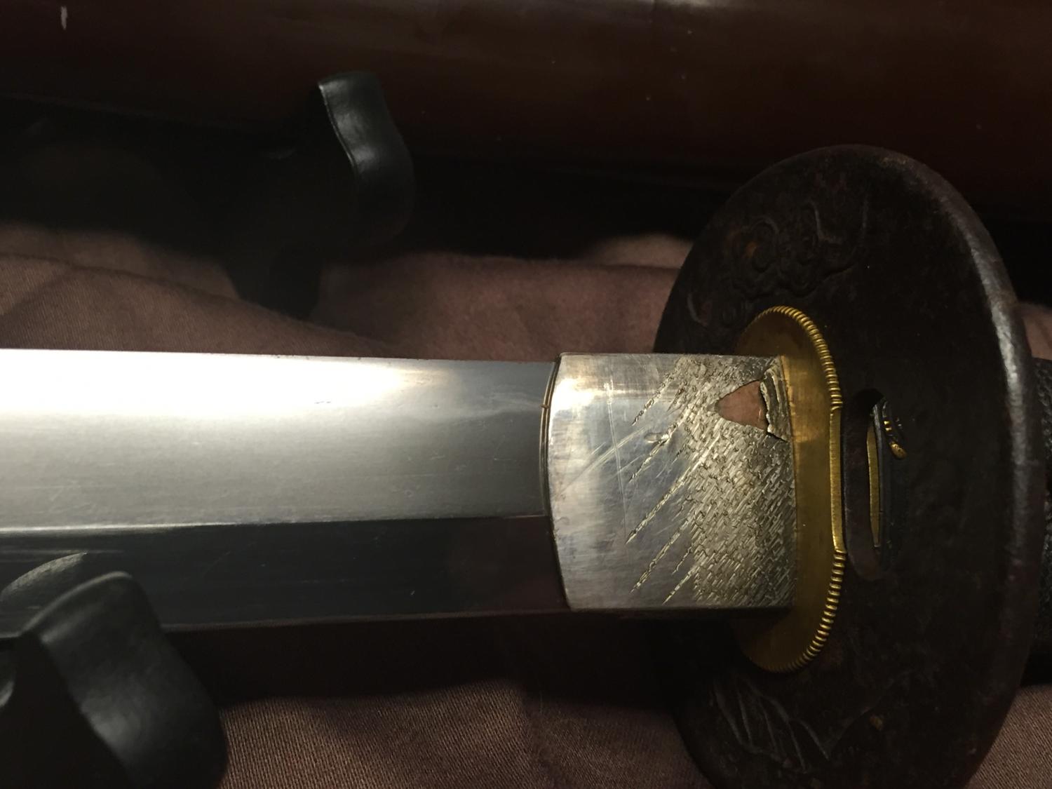

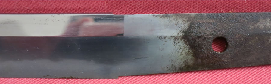

Thanks Jason, 1800s vintage maybe? The nakago has uneven aging/patina, doesn't looked cleaned just not very old yet. Does that sound right?
Price seems fair to me, even with the flaws, though better condition swords can sometimes be found in that range. Polish seems fairly recent and not top shelf.
The price isn't bad but it's a mu mei shinto/ more probably shin-shinto wakizashi with a big hole in it...for me there would have to be something I got from owning it that makes it better than having $600 in the bank...

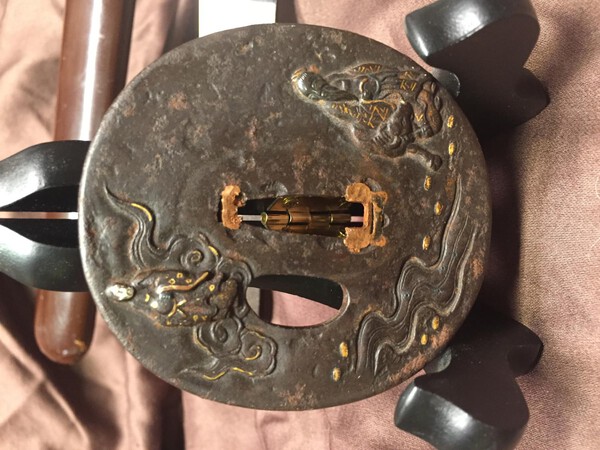

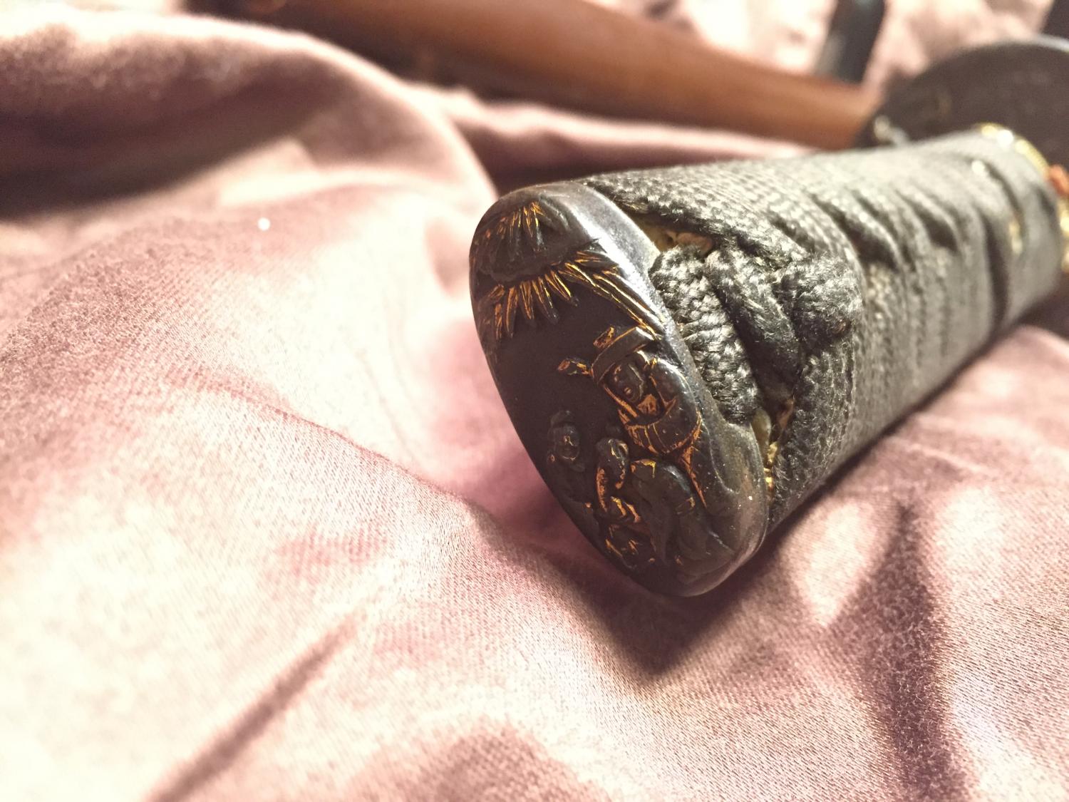

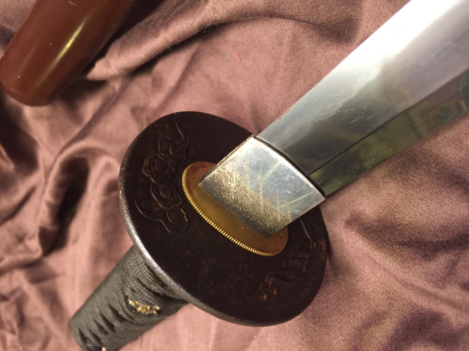

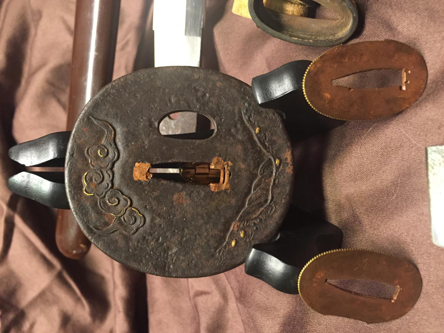

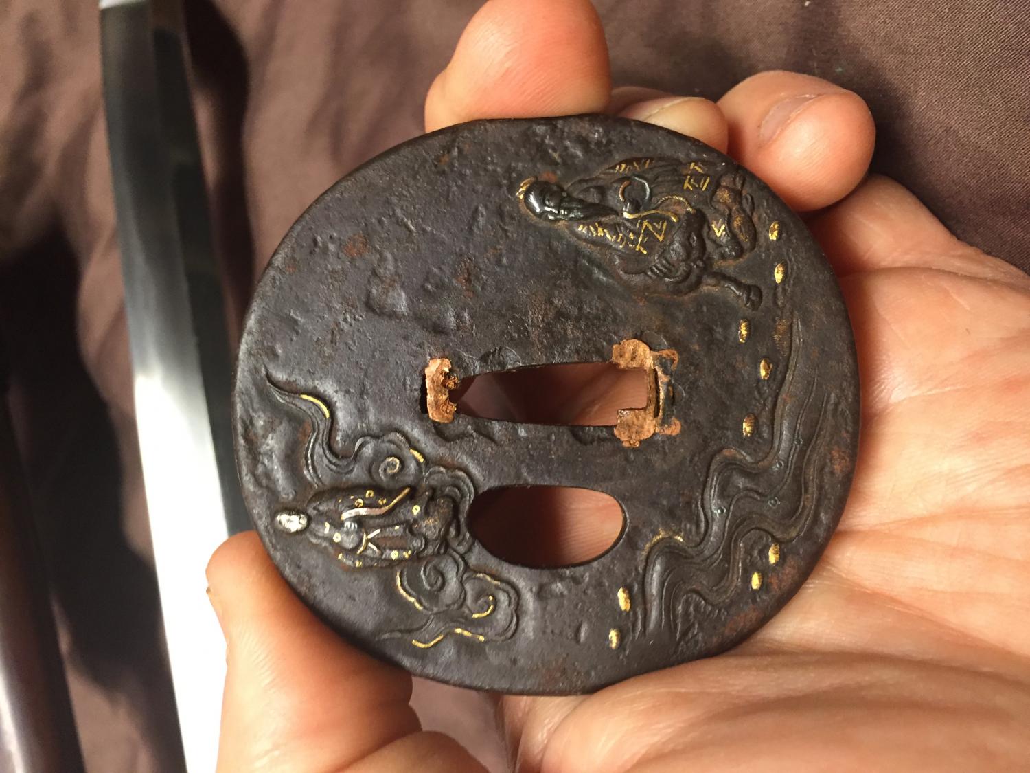

Looks to me like an authentic wakizashi, it's all there and in decent condition, including the polish.  I would have bet that the mounts look better in person, and it's ok at the asking price and if you got it at some discount from $600 you did very well.   Probably best to resist the temptation to strip the mounts from it for other purposes, since I agree with Grey that the value is mostly in the mounts.  Looking forward to seeing some better photos of the tsuba, menuki and F/K.
post-2064-0-53149500-1460910702_thumb.jpgpost-2064-0-65942500-1460910721_thumb.jpgpost-2064-0-80244700-1460910735_thumb.jpgpost-2064-0-12965700-1460910748_thumb.jpgpost-2064-0-19722800-1460910763_thumb.jpg

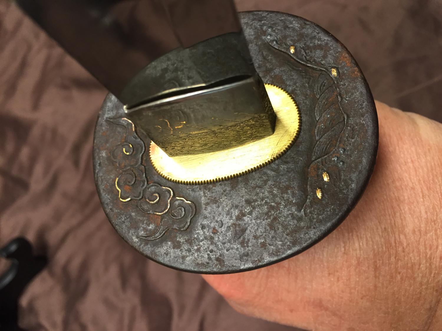

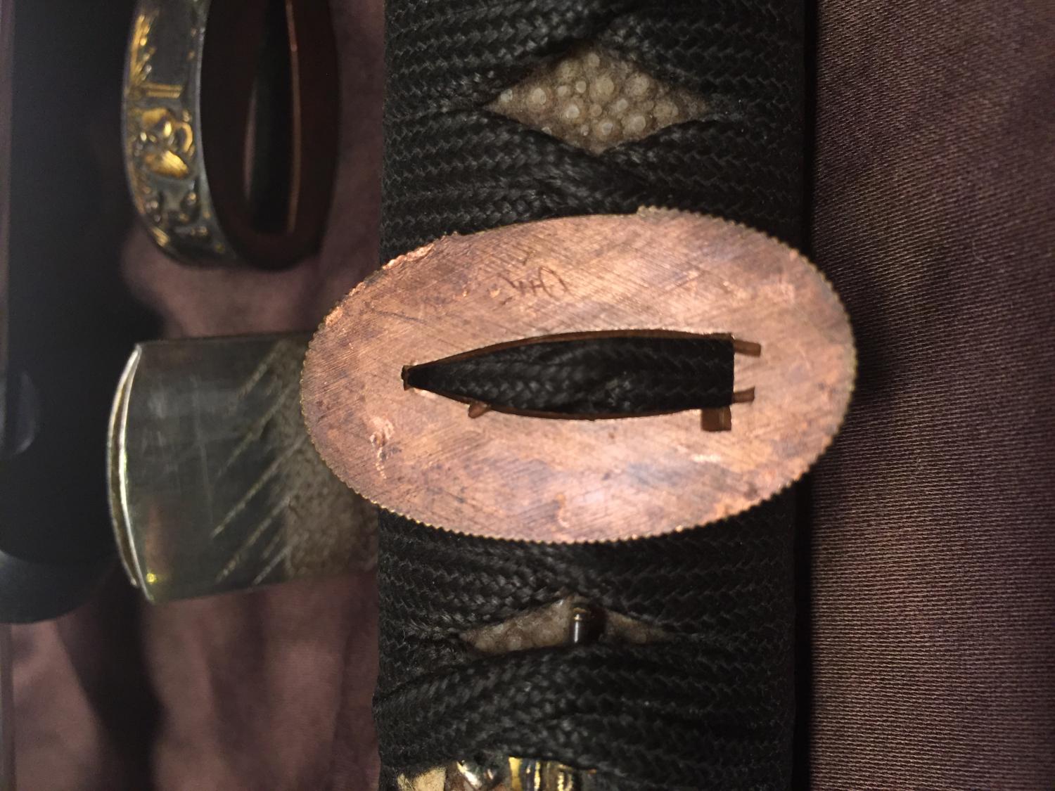

The sepas are inscribed with the same kanji, if someone can tell me what that means.

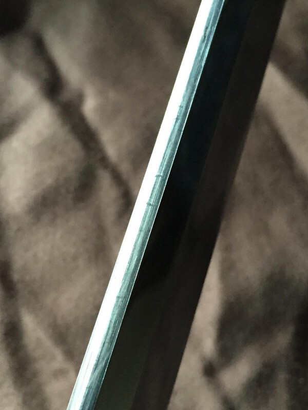

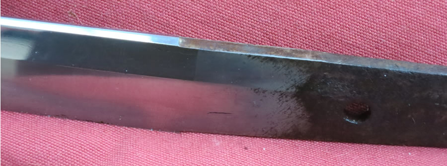

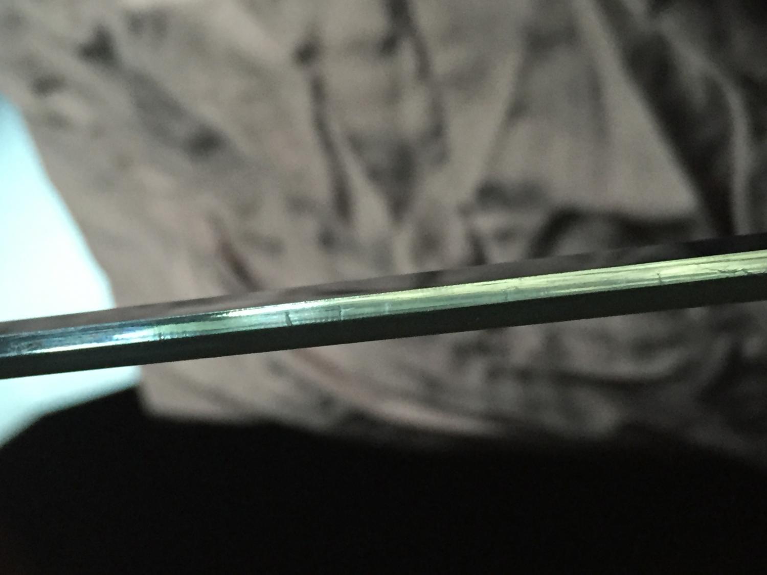

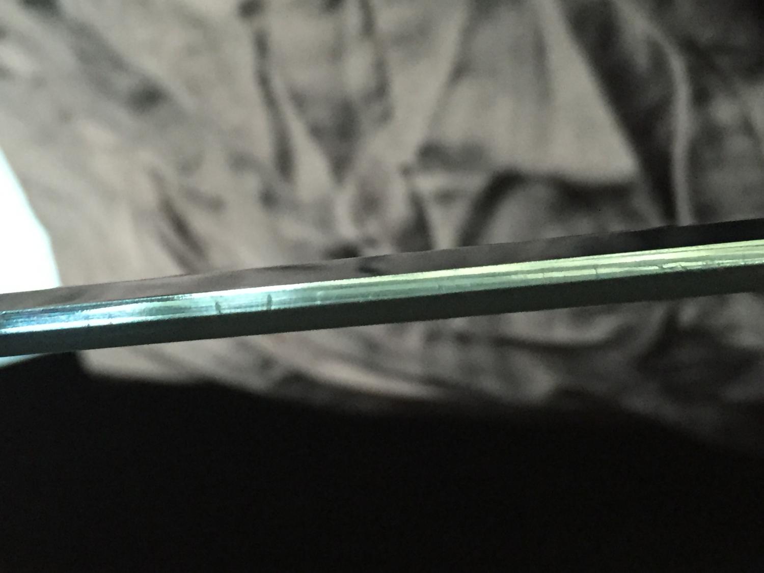

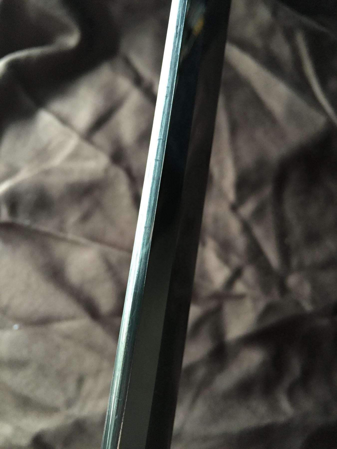

I might be going out a limb, but there are a number of very faint, but sharp lines on the spine of the sword.  Could these be kirikomi or battle scars from coming into contact with other blades during battle?  Difficult to photo but hopefully you can see them.  They seem to be clustered, I can make out 4 or so, 2 together.
post-2064-0-16218500-1460932804_thumb.jpgpost-2064-0-54492600-1460932820_thumb.jpgpost-2064-0-86801000-1460932935_thumb.jpgpost-2064-0-50770900-1460932975_thumb.jpg
Ah, good one. I like my hypothesis better. I will say that the lines are not squiggly, but all straight and defined. I'm going with battle scars!
Any ideas/help on the seppa kanji?

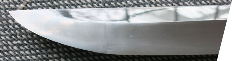

Sorry but it makes no sense to send this to a polisher.  James would be out the cost of post both ways, the polisher certainly has better use of his time, and all that would be learned is what's been said here already: this is a ho-hum unsigned wakizashi with serious defects that isn't worth a polish.
Swords like this get polished because beginners won't give up hope; old timers know better.
Grey
Why would anyone want this sword? If i ask that question I can't come up with an answer. James, You have gained some insights and information by considering this sword, But its is not worthy. Keep looking.
And Ray is right,Those things are shinae
Peter
I don't know if anyone listening is a hunter, but reading your post Peter got me to thinking.  If you've ever been to Africa, or here in North America, or anywhere in the world chasing game, you can usually put hunters in one of two camps.  Some are there because they want the biggest and the best, nothing else will do.  And others are there more for the experience and memories, and a good representative animal is enough.  It might not make B&C, but it might have been the oldest, with the most character, or whatever other attribute blows your skirt up.  I'm a neophyte nihonto admirer/collector.  I can go to AOI Japan and buy a very nice papered sword and I probably will, as can anybody.  But what I am finding is there is a thrill to the chase that can be just as rewarding, if not more in some cases.  I've experienced that in other areas of collecting as well.  I have no false hopes about this sword, no plans to polish, and no desire to try and make it something that it isn't.  But I can still appreciate it!  I don't mind character, a few flaws here and there, but what I really like is originality and honesty.  This piece is honest, it's not pretending to be anything that it isn't.  I'm asking a lot of questions and taking a bunch of photos (more than fellow members Muramasa haha) to learn and soak up what I can from this very knowledgeable community.  So I believe this sword to be worthy of owning, and I've looked at it every night before going to bed and after watching the new season of Outlander :)   That old dagga boy with his horns worn to a nub is every bit the trophy compared to that soft 40 incher!  So I appreciate all the commentary and information, it all helps.
