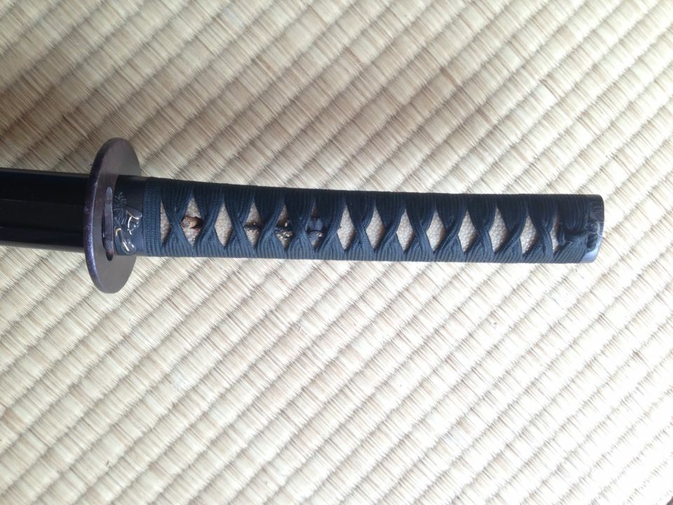

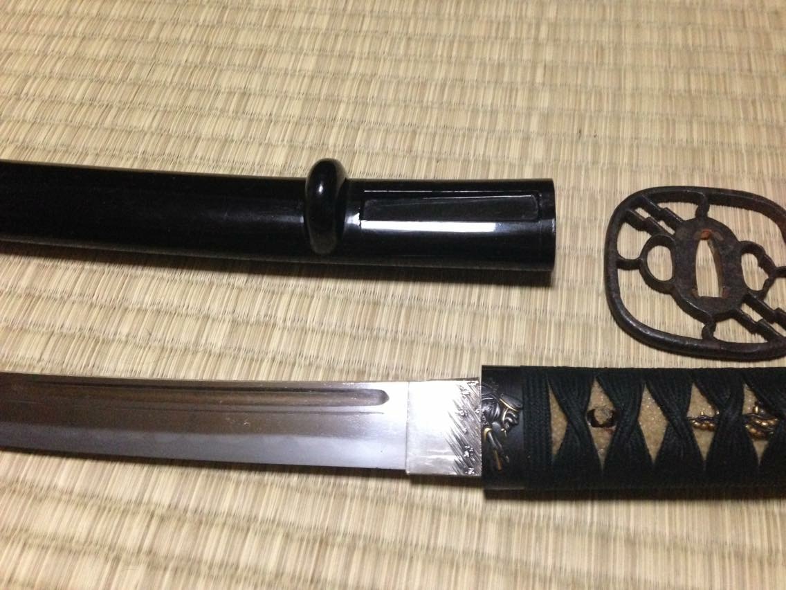

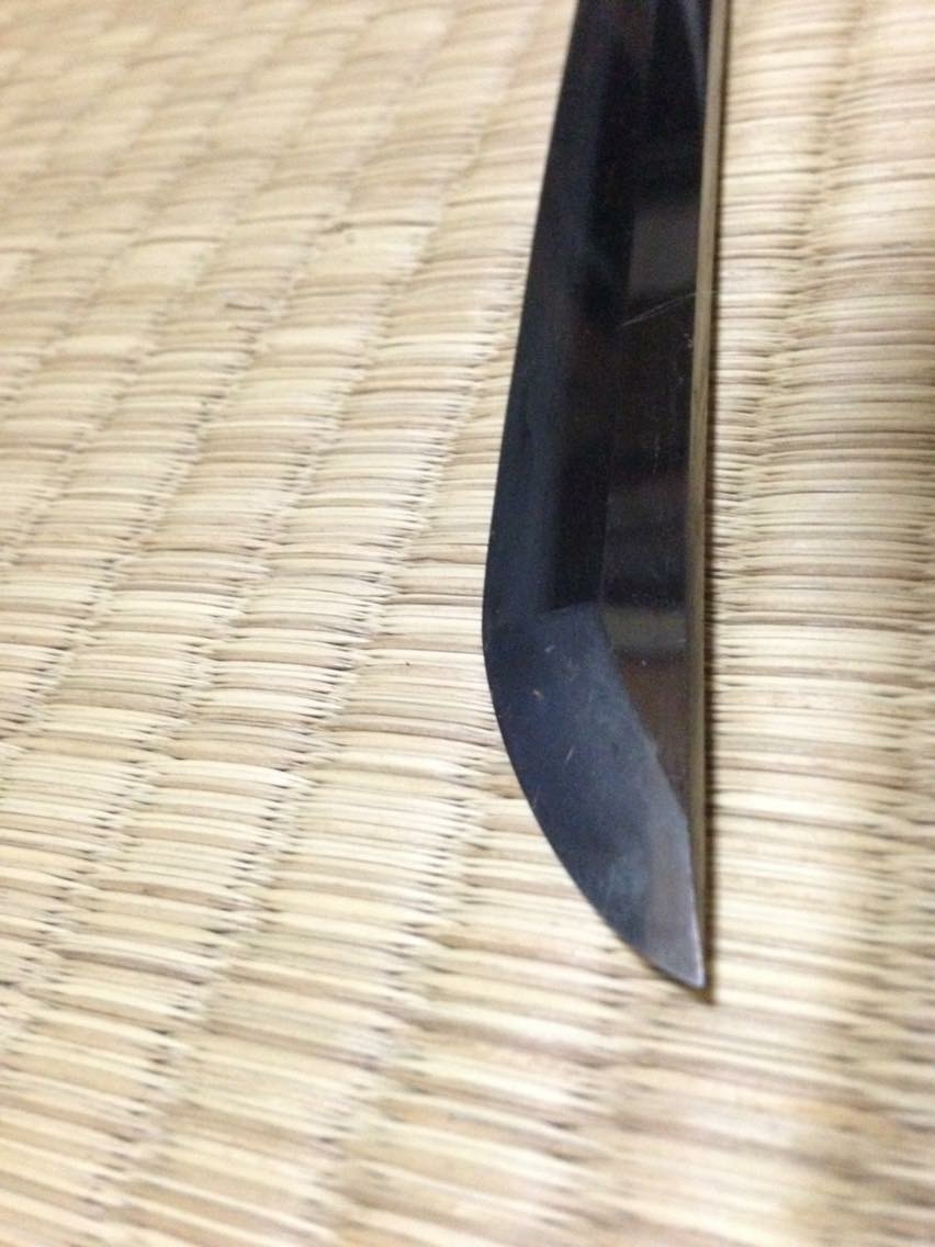

Some pics.. On the paper to the left of shigetaka is the "kodai" kanji I was referring to. Also someone added "Ryu" in higana in pen.
Thanks again for the input!
Geraint, I missed the "harima daijo" part, I thought the sandai used that as well...? I am a newbie though.
The nagasa is 60cm
Thanks again!
Dear Matt.
Thanks for the pictures, just as a matter of interest is the koshirae all complete?  I can't make out in one photo if the tsuka is fitted and there is  a spare tsuba or if they all belong together.  I think this is a nice find!  As regards the generations, well Darcy has quoted from Fujishiro that the third generation cannot be found, I have conflicting information from a variety of sources and have not yet found a definitive.  Hawley suggest first two use Harima Daijo, third nothing and fourth Used Hyuga.  Some sources state that a Kanbun shinto sugata must make it a third generation because the second only worked in an earlier period.
I suppose we are doing well to have the sort of detail that we do from this period but sometimes a definite answer would be nice.  I  keep an eye out for papers that specify the generations and always have a look when I come across a blade by this lot but so far haven't been able to satisfy myself on this one.  Let me know what you find out and enjoy the sword.
