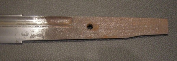

lonely panet Posted March 25, 2016 Report Posted March 25, 2016 Hi guys, well we all know of the Murata-to, with in the IJA area. but not having seen any in hand, how would one recognize ? would it be completely rust free, or resistant to corrosion at slower rate I ask this because I have a neat type 19 Kyu gunto with a Mukade-giri-maru style blade, small amounts of rust on the blade. does any one have an example to post Quote

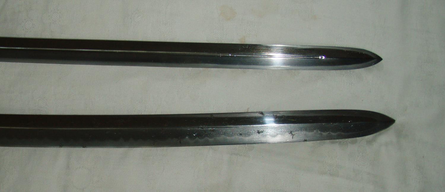

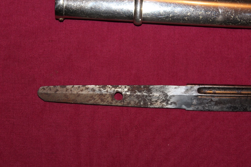

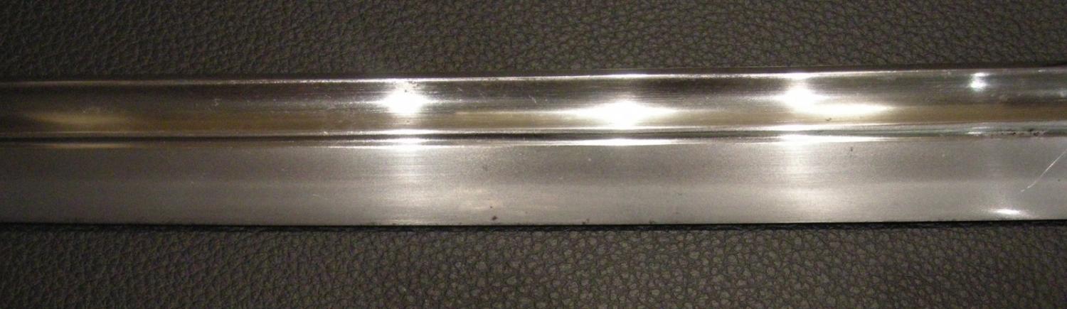

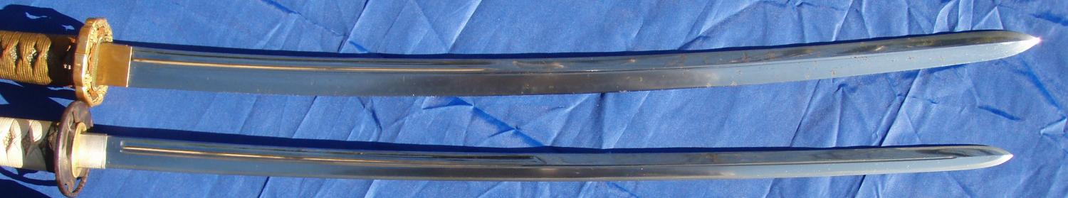

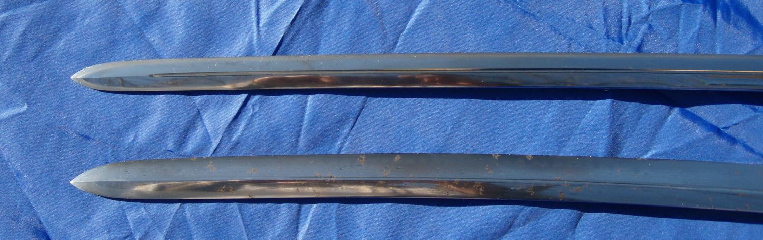

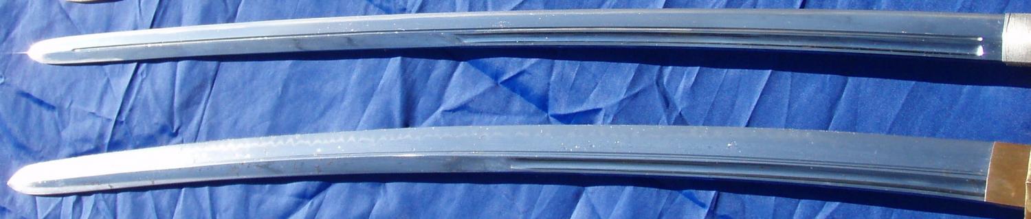

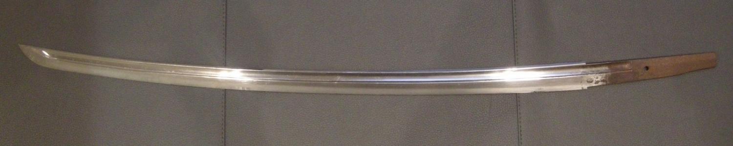

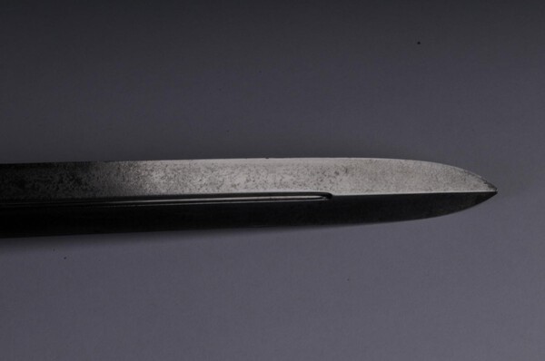

Stegel Posted March 30, 2016 Report Posted March 30, 2016 HiI have what may be a murata blade, (i don't know for sure)It is of the Kogarusa maru style, the hamon is a straight type.Here are some pics of the blade with another gunto by Kanenori, also the same style of blade. (not straight hamon)I couldn't find any of the tang, so i'll try to take some over the weekend when i get time, but it has from memory the screw type mount at the end.Are these generally oil-quenched?? 1 Quote
lonely panet Posted March 30, 2016 Author Report Posted March 30, 2016 from what I can read, most were oil quenched and acid applied hamon. but with a mei, how do we know Quote

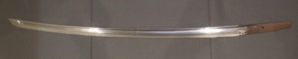

Stegel Posted March 30, 2016 Report Posted March 30, 2016 I didn't realise that you were asking for answers Hamish!! i thought you were going to explain more on these, sorry about that. We're both looking for info i suppose. I was looking about on the web and found this one, it has the same style tang as mine, but mine is mumei from memory. http://www.japanesesword.com/Images/Swords/06/1106/1106gunto7/1106gunto7.html 1 Quote

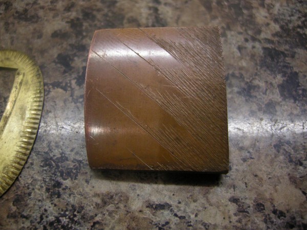

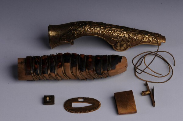

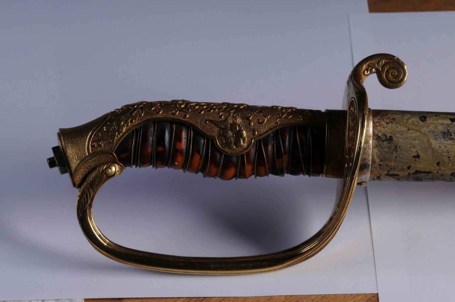

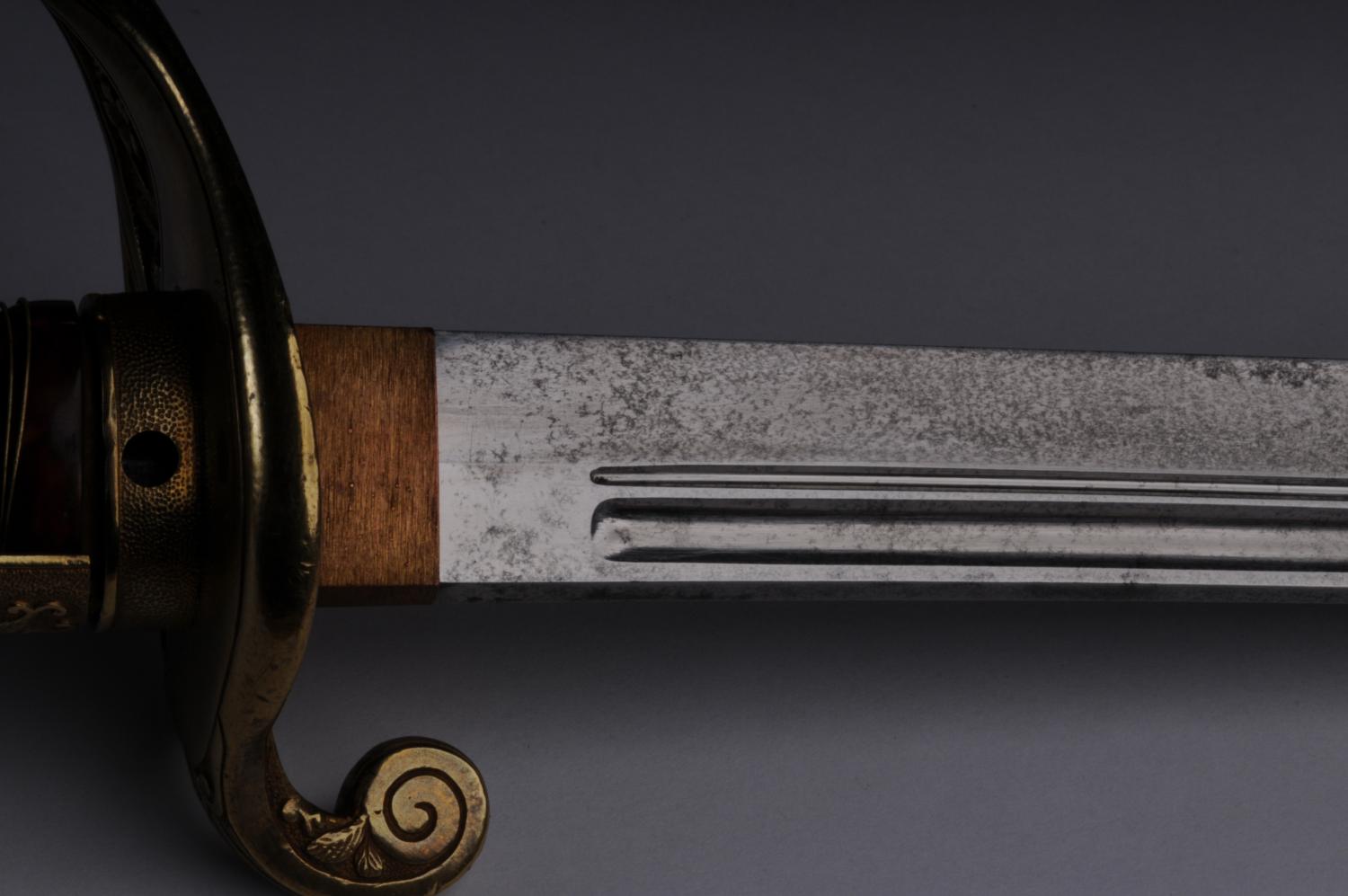

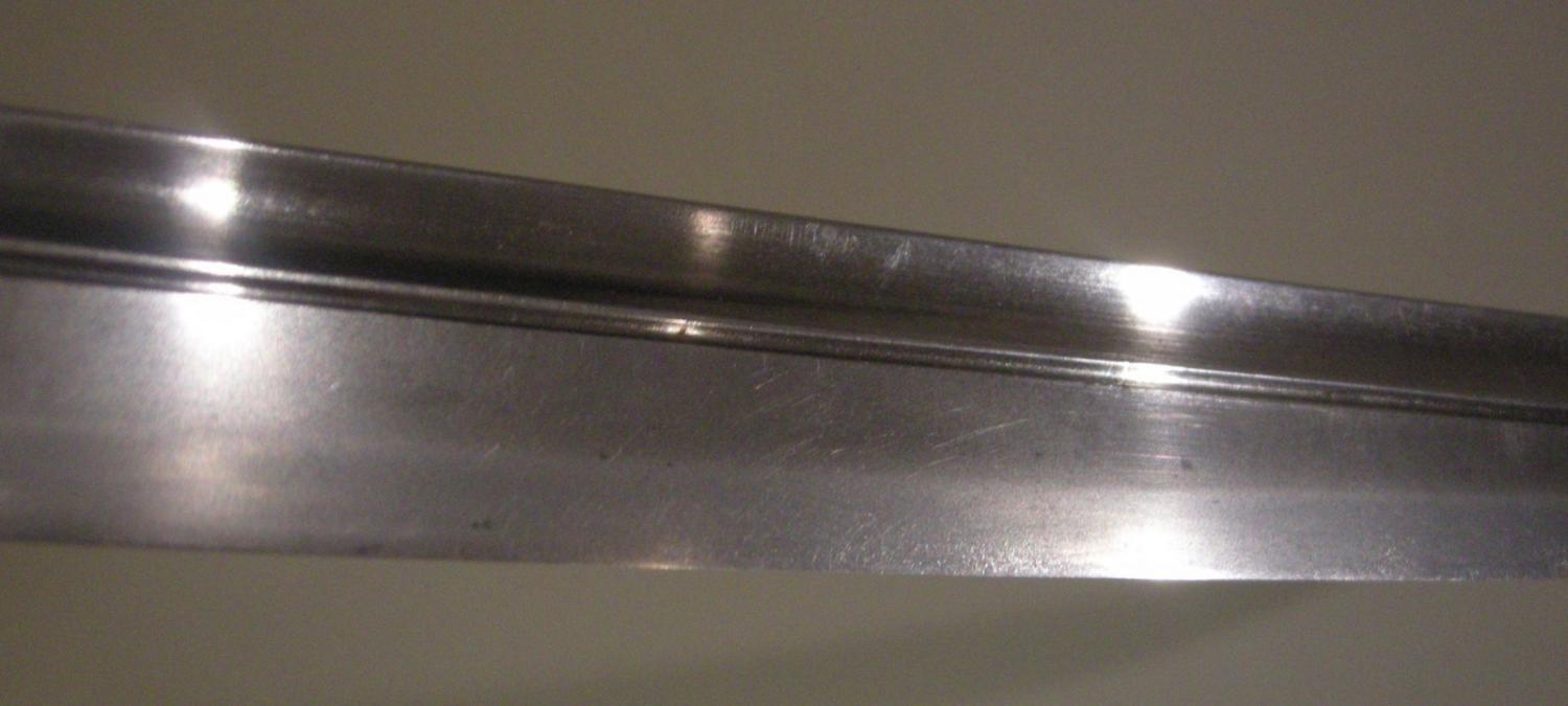

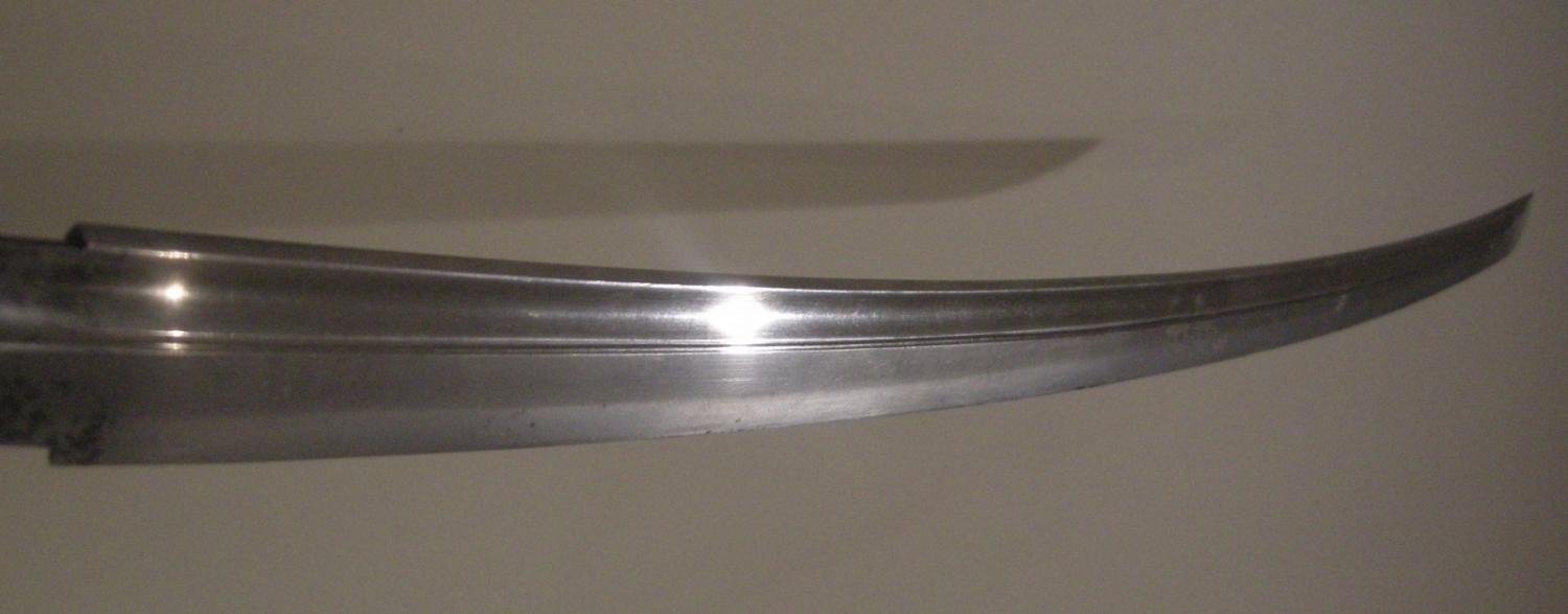

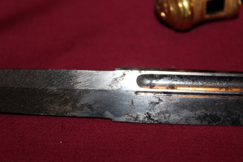

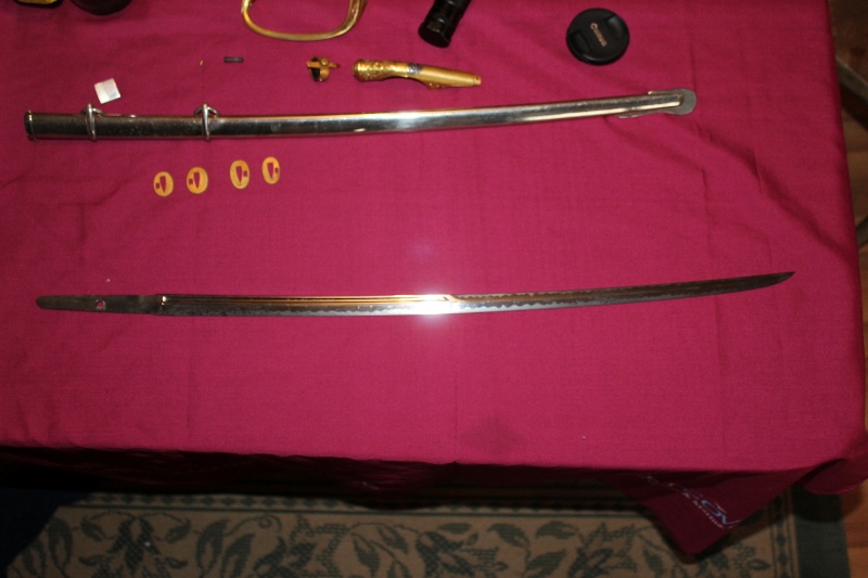

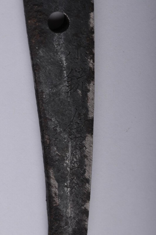

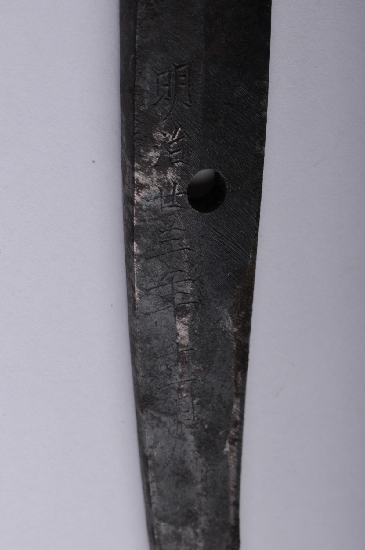

jct3602 Posted May 9, 2016 Report Posted May 9, 2016 Hi - Have an example, was in general's mounts with tortoiseshell, D-guard, gold-washed wire, etc. However, it seems to have no hamon, or possibly an ito-suguha that just is not coming out very well. enclosing pictures. Has both signature and date mei, but not one of the standard mei for Murata-to. No armory stamp or production number, and date is very early for the Kogerasu-Maru style blades. Hope this is the type of stuff what you were looking for, Yours, john twineham Quote

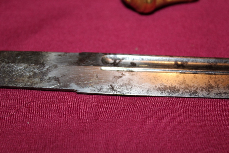

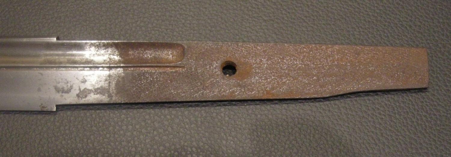

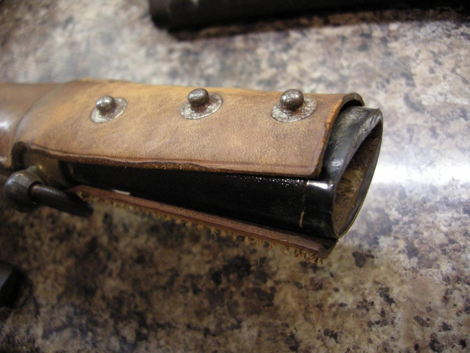

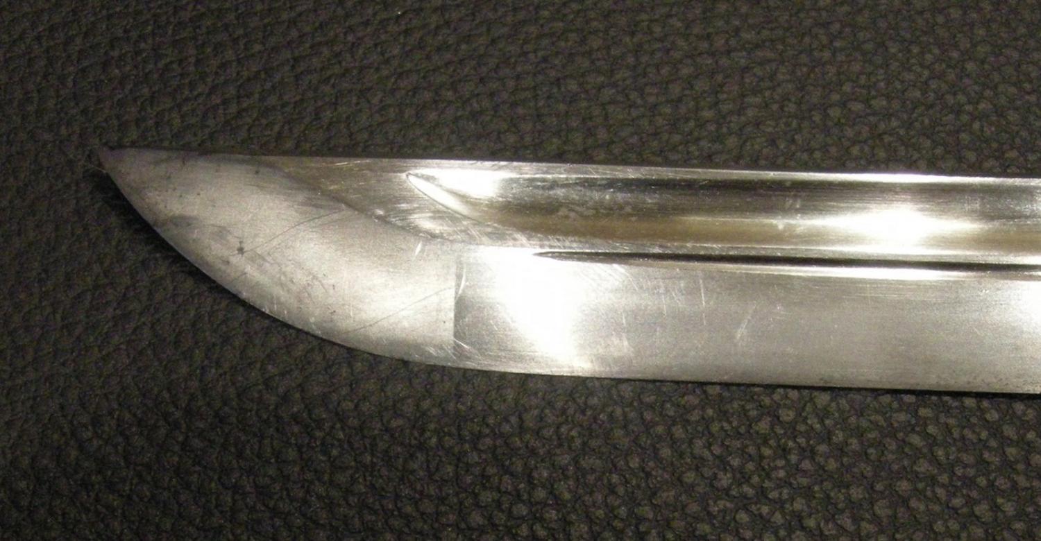

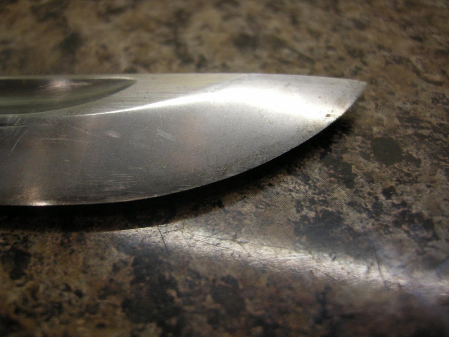

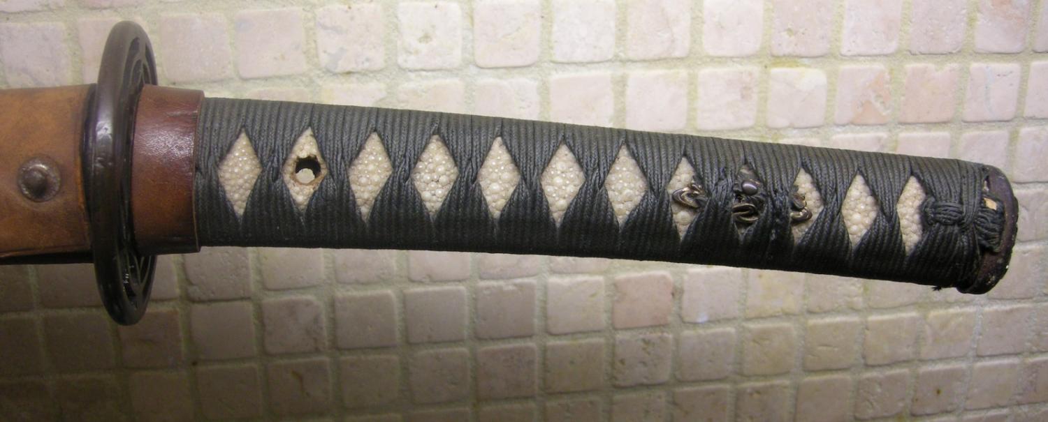

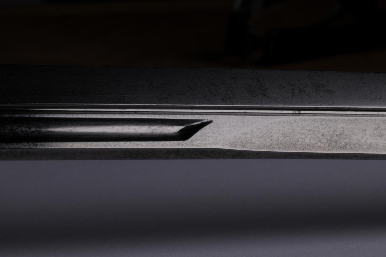

BenVK Posted December 22, 2016 Report Posted December 22, 2016 I picked this one up recently which I believe to be a modified Murata-to Seems the threaded end of the nakago has been cut off to fit these mounts which are a curious mix of styles. No markings that I can see. I think it's quite an interesting sword. Quote
Stephen Posted December 22, 2016 Report Posted December 22, 2016 I see it a better blade, cut down shinshinto maybe, once signed be my guess. Deserves its own thread anyway. Quote
BenVK Posted December 22, 2016 Report Posted December 22, 2016 Hmm, I dunno, it looks like a mono steel blade with either an oil quenched or etched on hamon... Quote
