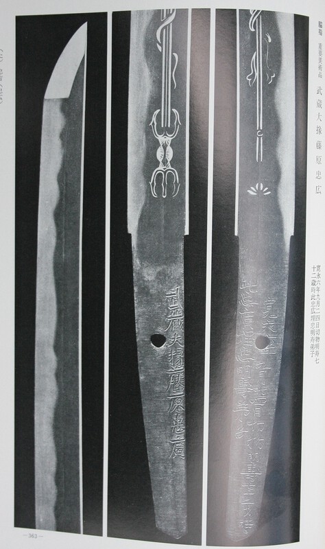

Jacques Posted May 15, 2016 Report Posted May 15, 2016 Below a sword by Shodai Tadahiro and bearing an horimono engraved by Umetada Myoju. Please, pay attention at the ken handle, quite different with those on this tanto... Quote
Darcy Posted May 15, 2016 Report Posted May 15, 2016 The ken handle is called a "Vajra" (maybe only by itself, as a tsuka, maybe sankozuka) ... the identical horimono (to Jacques' post) is found on one of his own blades that is Juyo. This style though is not common at all in Myoju's horimono. He did a lot of free standing dragons and then traditional horimono like you would see on works of Rai Kunitoshi. There are no horimono set in panels among any of the Juyo work, though there is one Juyo Bunkazai. Set inside panels in relief is much more frequently found in Echizen (Yasutsugu, Kotetsu) smiths. But Myoju did at least one and I can't find the other Juyo Bunkazai to check others. Not much to go on in the Juyo stuff. I think if the NTHK felt it was Myoju they would have said Myoju. Quote
