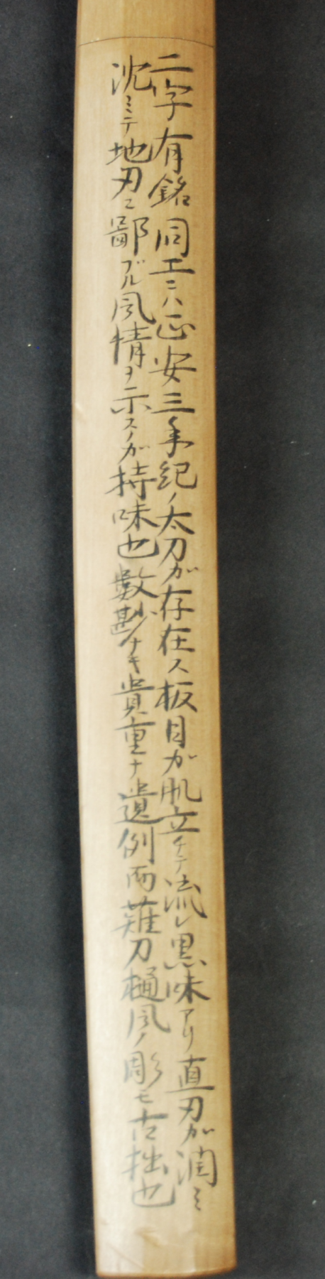

3. I think the interpretation of Sayagaki is extremely interesting but wonder if we do not risk misleading ourselves by trying to second guess what is behind the statement.

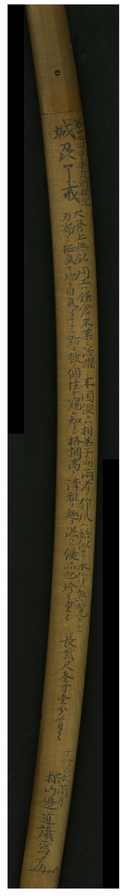

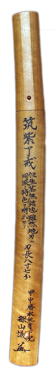

Probably one of my last blades. I thought that after the Topic about achieving my Gokaden collection, I was through collecting Nihonto, then I found a blade I could not resist, it was exceptional, first time I saw a signed tanto of this school and this smith. I submitted it to Tanobe sensei for a sayagaki and he was happy to do it.
Hi Guido,
Quite sure, as it took our buddy Bob more than a couple of hours to bring it to Tanobe san and get it back and this despite the fact that he is moving within a week for his sabatic year and that he lost precious minutes to picture it and e-mailed them to me.
Translation? :-)
