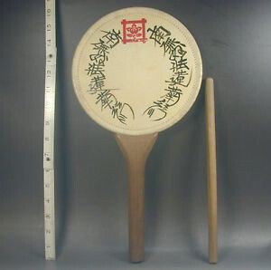

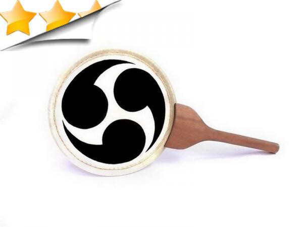

The "tomoe mon" is on the drum (a uchiwa daiko - see below).  In this case, it is not a family mon and instead refers to Kaminari - the thunder god (often used on drum heads).  On the tsuba, you can see the "drumstick" next to the drum (which looks like a Western hand mirror).
