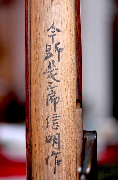

Viper6924 Posted January 28, 2016 Report Posted January 28, 2016 Hi guys! Reading these handwritten signatures is even harder than the chiseled one´s. Even if this one is a bit better than most. Would be very happy if someone could help me. It´s so frustrating not knowing Thanks!!! Jan Quote
ROKUJURO Posted January 28, 2016 Report Posted January 28, 2016 Jan,I can read NOBUAKI SAKU.Hope that helps! Quote
Bugyotsuji Posted January 29, 2016 Report Posted January 29, 2016 Is this Sendai, Jan?Konno (Imano?) Chosaburo Nobuaki Saku *Edit, Imano seems to be the correct way to read these kanji for this smith. Quote
Viper6924 Posted January 29, 2016 Author Report Posted January 29, 2016 Thank You so much for the translation!!! Yes, Piers. It's the Sendai-matchlock Hmm, interesting. Does this mean that the barrel maker and the stock maker could be one and the same person? It's a very well made gun in all aspects. Jan Quote
Bugyotsuji Posted January 29, 2016 Report Posted January 29, 2016 Lovely gun, Jan. Congratulations. Well, it is possible that there was a tradition of the Mei being recorded inside the stock in Sendai guns. (?) A good question for further study. There is a 3-Monme gun in Yasukuni Jinja in Tokyo, with a note saying 'superior forging'. It is signed with a longer Mei, "Sendai Ju, Imano (rather than Konno) Chosaburo Fujiwara Nobuaki". He is number 7 in a line of Sendai Imano smiths, and numbers 3 and 4 are listed as signing in Tempo 9 and Tempo 3. Quote
Viper6924 Posted January 29, 2016 Author Report Posted January 29, 2016 On 1/29/2016 at 8:03 AM, Bugyotsuji said: Lovely gun, Jan. Congratulations. Well, it is possible that there was a tradition of the Mei being recorded inside the stock in Sendai guns. (?) A good question for further study. There is a 3-Monme gun in Yasukuni Jinja in Tokyo, with a note saying 'superior forging'. It is signed with a longer Mei, "Sendai Ju, Imano (rather than Konno) Chosaburo Fujiwara Nobuaki". He is number 7 in a line of Sendai Imano smiths, and numbers 3 and 4 are listed as signing in Tempo 9 and Tempo 3. This might def be the same guy. To my knowledge the name Fujiwara was sometimes bestowed upon someone as a sign of recognition for superior skill or long service. The Tempo-period seems spot on. When you get a chance to inspect a Sendai-tsutsu in hand, it does not take long to appreciate the quality and workmanship. Jan 1 Quote
Bugyotsuji Posted January 29, 2016 Report Posted January 29, 2016 Quote: "the name Fujiwara was sometimes bestowed upon someone as a sign of recognition for superior skill or long service." Agreed. (Although there was a time in early to mid Edo when everyone, well swordsmiths anyway, bestowed fancy titles upon themselves.) Quote
ROKUJURO Posted January 29, 2016 Report Posted January 29, 2016 Jan,the stock material looks like AKAGASHI (red oak), but to my non-expert eyes it doesn't seem to have almost 200 years of age. Of course it is only one photo which does not show everything!Could that perhaps be a replica or do other firearms of that period (1830 - 1844) have that same perfect state of preservation? 1 Quote
Bugyotsuji Posted January 29, 2016 Report Posted January 29, 2016 Jean, agreed, it is in pristine condition, good point, but so is the whole gun. I have seen stocks (almost) as clean as this, with little doubt as to the age. There are many corroded and battered guns, but quite a few of the end-of-Edo guns look almost new. Quote
Viper6924 Posted January 29, 2016 Author Report Posted January 29, 2016 Thanks Piers for confirming my thoughts about the Fujiwara affair Its red oak alright. And it's the original to the barrel. I have a matchlock pushing 400 years. When I opened up the gun woodshavings was still lodge inside and the wood is in fantastic condition. It probably depends how the gun been stored over the years. This gun is in overall very good condition, so someone cared for it. I can post some pictures on the matchlock section later if you want. Jan 1 Quote
