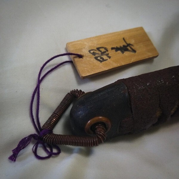

Ray Singer Posted May 25, 2019 Report Posted May 25, 2019 Beautiful sword, thanks for sharing that one Daniel. Likewise, ours are the only two Akitaka I have seen. A very talented smith. The sarute in mine is very unusual. It is triangular in shape, with wire coiled around the outside. It appears to be original, but I've never seen one like this before. 2 Quote
IJASWORDS Posted May 25, 2019 Report Posted May 25, 2019 Ray, there are original triangular sarutes. Few and far between, but out there. 2 Quote
Shamsy Posted May 26, 2019 Report Posted May 26, 2019 I have a triangular wire sarute I bought from a gentleman selling lots of spare 98 and 95 parts. He thought it was a 95 but it's not the right size or shape, so I assumed a 98. Glad that's confirmed. Quote
Ray Singer Posted May 26, 2019 Report Posted May 26, 2019 Gentlemen, thank you both for the confirmation. Kind regards, Ray Quote
PNSSHOGUN Posted May 26, 2019 Report Posted May 26, 2019 Don't believe I've ever seen that Sarute before, very unusual. Quote

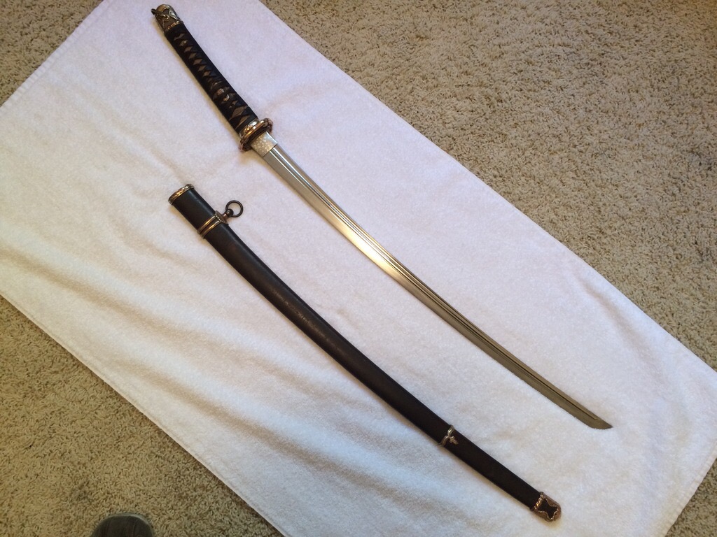

IJASWORDS Posted May 31, 2019 Report Posted May 31, 2019 An Ichimonji Minamoto Amahide Kitau Kore, no stamps, no date. 4 Quote
Bruce Pennington Posted May 31, 2019 Report Posted May 31, 2019 I've always loved those fat, seppa. Any idea what metal it is made of Neil? Brass seems to get dull over time, this must be something else. Quote
PNSSHOGUN Posted May 31, 2019 Report Posted May 31, 2019 I think they are gold plated brass or copper. They are heavy in the hand. Quote
IJASWORDS Posted May 31, 2019 Report Posted May 31, 2019 These are gilded brass on these, like the gilding on other brass/copper gunto fittings. The "fat seppa" always add a touch of class to a sword especially on those with blackened silver mounts. Quote
PNSSHOGUN Posted May 31, 2019 Report Posted May 31, 2019 They mostly seem to be on 6/8 seppa swords of generally higher quality. 1 Quote

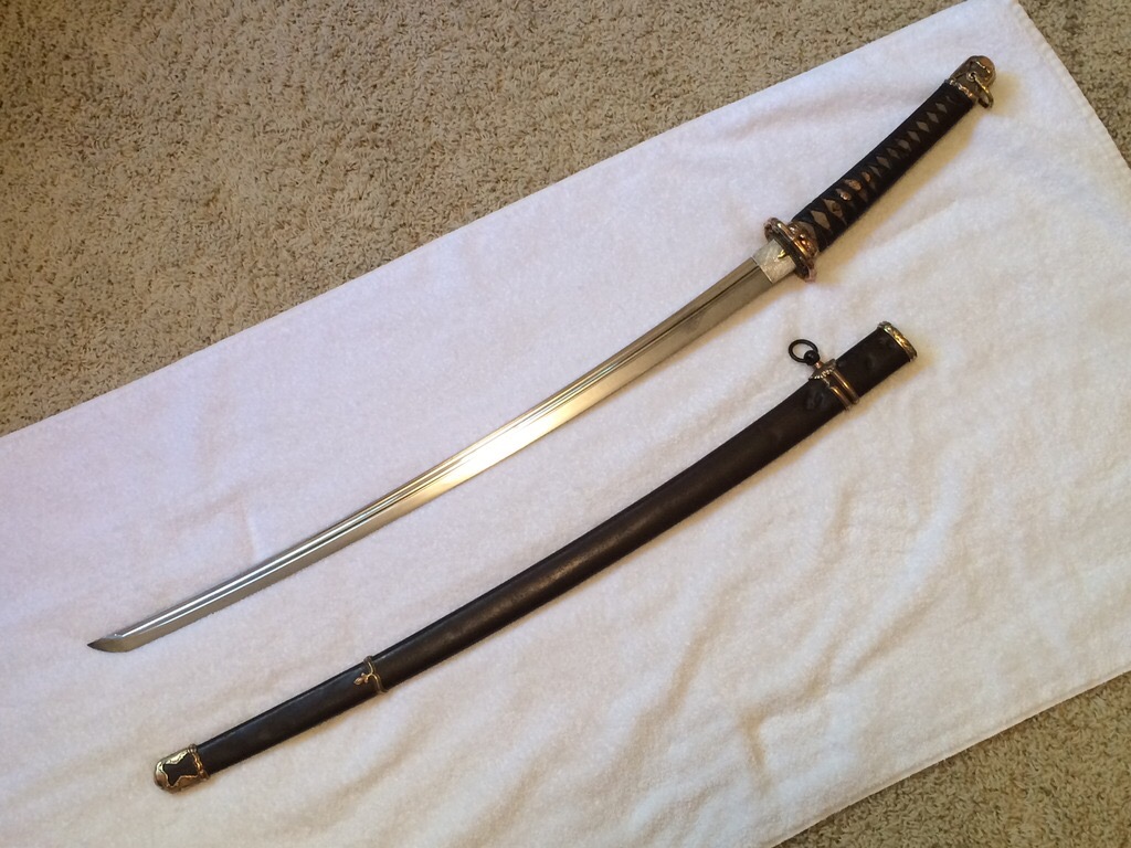

IJASWORDS Posted May 31, 2019 Report Posted May 31, 2019 Bruce, seeing that you love the "fat ones", here is the seppa set on a 1941, Noshu Seki Ju Kanemichi Kin Saku. It is also an aluminium saya. 1 Quote
Bruce Pennington Posted May 31, 2019 Report Posted May 31, 2019 Dang, that's gorgeous Neil! Wondering now if they are made by a single manufacturer or shop, implying that gunto fitted with them came through the same shop? Or, if it's simply easily made by multiple koshirae manufacturers. Probably the latter. Quote
Bryce Posted June 1, 2019 Report Posted June 1, 2019 Very nice Neil, Any chance of some further pics of the blade and nakago? Cheers, Bryce Quote
IJASWORDS Posted June 1, 2019 Report Posted June 1, 2019 The type 94 double hanger always a favorite. Old blades with their details to follow later when I get a camera that can do them justice. 6 Quote

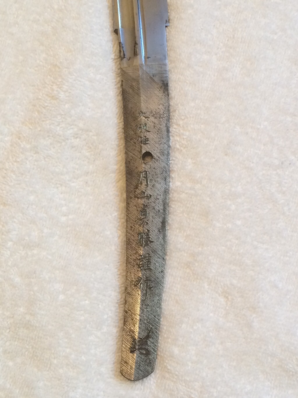

reeder Posted August 17, 2019 Report Posted August 17, 2019 Here’s one I posted before but did not originally include a shot of the nakago. 6 Quote

Bruce Pennington Posted August 30, 2019 Report Posted August 30, 2019 On 8/17/2019 at 6:02 PM, reeder said: Here’s one I posted before but did not originally include a shot of the nakago. Brandon, That looks like a kakihan at the end of the nakago. Who was the smith on this? I'd like to add it to the Stamps Document. Quote
Ed Posted August 31, 2019 Report Posted August 31, 2019 Bruce, That is Gassan Sadakatsu and his Kao. Signed: Gassan Sadakatsu Kin Saku 4 Quote

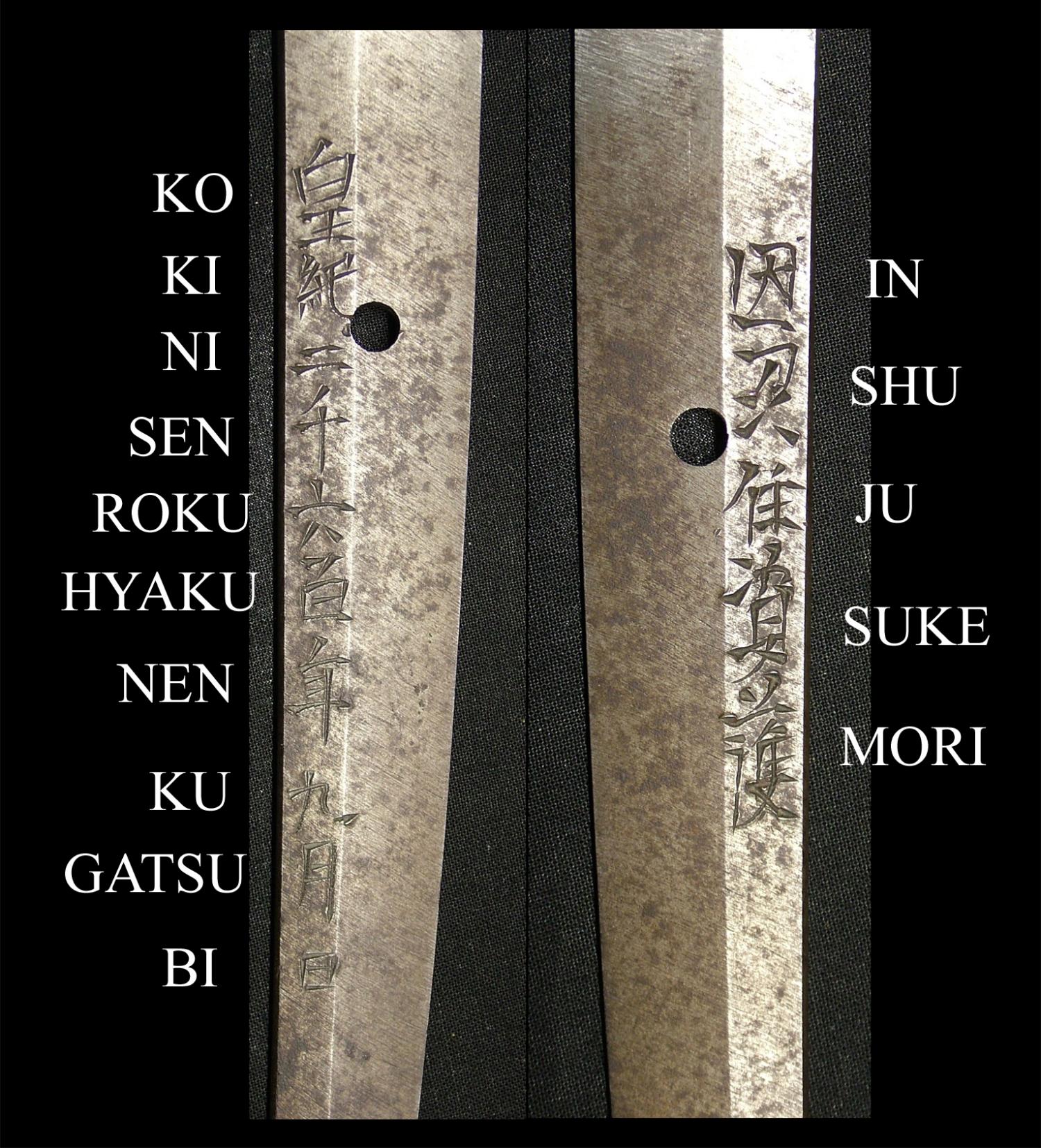

Ed Posted August 31, 2019 Report Posted August 31, 2019 Hirai Sukemori. This Gendaito was published on pg. 164 of Slough's. Additional photos here as well: http://yakiba.com/Kat_Sukemori.htm 3 Quote

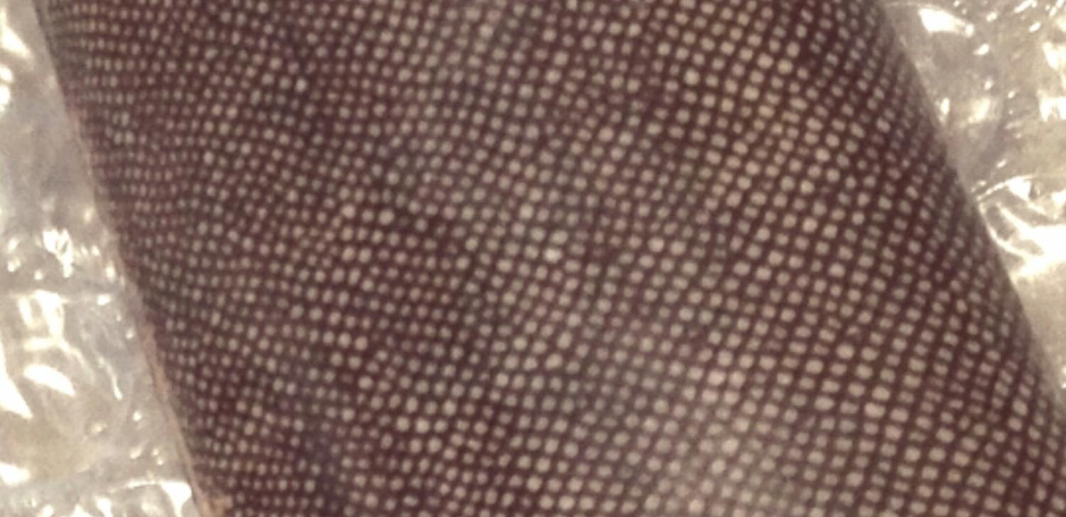

IJASWORDS Posted October 4, 2019 Report Posted October 4, 2019 Looking closely at some Kai Gunto, and noticed that on the shark skin saya type, often a feature is made of a large nodule. And usually in the same place on the saya. A couple of examples attached. 3 Quote
PNSSHOGUN Posted October 4, 2019 Report Posted October 4, 2019 Is it just me or do Kai Gunto tend to have rather poor quality samegawa on the tsuka no matter the quality of the blade? I wonder because it is almost exclusively dyed black they tended to use lower quality samegawa, rather than wasting the good stuff, in comparison to an equally quality Shin Gunto using traditional polished and stained same. It would be interesting to see how the Samegawa changes on higher quality swords throughout the war Quote
Bruce Pennington Posted October 4, 2019 Report Posted October 4, 2019 Wow Neil. Do you think it's man-made? Seems too geometrical to be natural, yet, the dots seem the same as those around them and the dots around them seem to be undisturbed. In both, the dots spiral in toward the center dot. On another note, I always thought this large dotted skin was eel. I have one that I was told was shark, and the way to tell, they said, was shark has diamond-like shape to the dots. But this is something I know nothing about. (hope I don't side-track your point!). 1 Quote
Brian Posted October 4, 2019 Report Posted October 4, 2019 That one of yours is shargeen/shark. Quote
IJASWORDS Posted October 4, 2019 Report Posted October 4, 2019 John, pictured are the tsukas of two Minatogawa swords. I guess the Minatogawas were pretty high class at the time. The one on the left with large nodules was an early war example, the one on the right later in the war. There is certainly a difference in quality. 3 Quote
Stephen Posted October 4, 2019 Report Posted October 4, 2019 Neil I get a feeling the one on the right is something other than same*. Quote
IJASWORDS Posted October 5, 2019 Report Posted October 5, 2019 Stephen you are correct. That's why I posted it . It looks like a man made imitation same. Many late war Kais have this material. Quote
