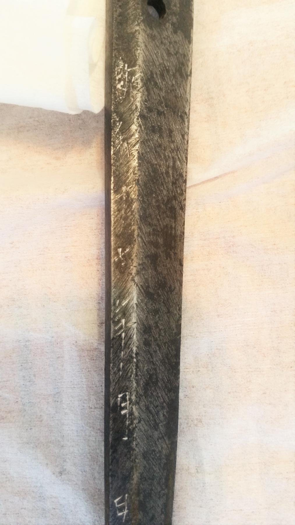

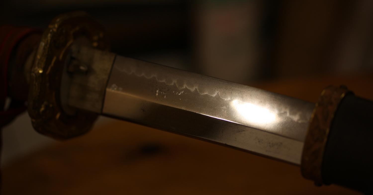

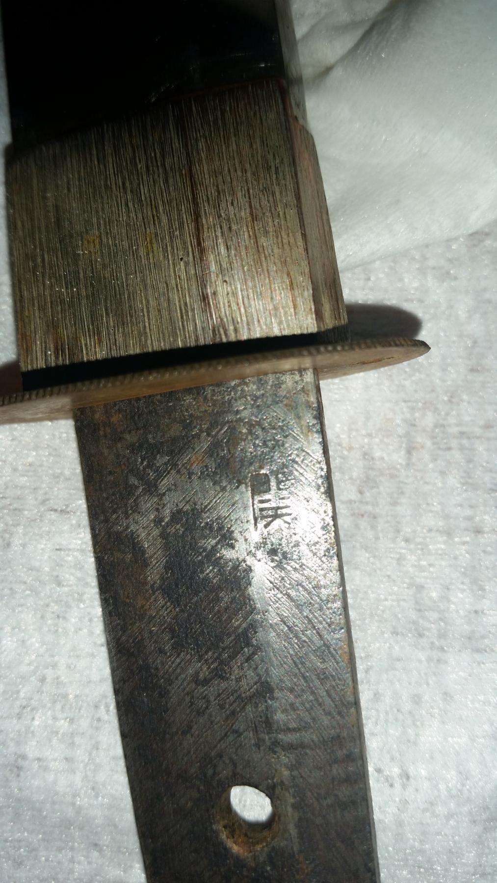

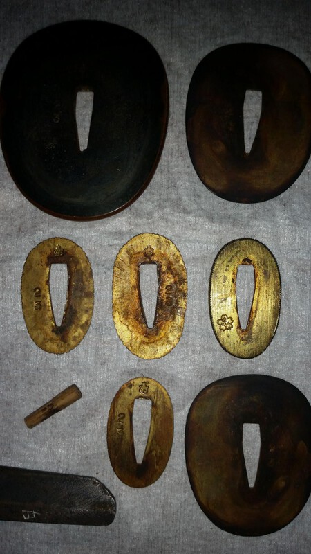

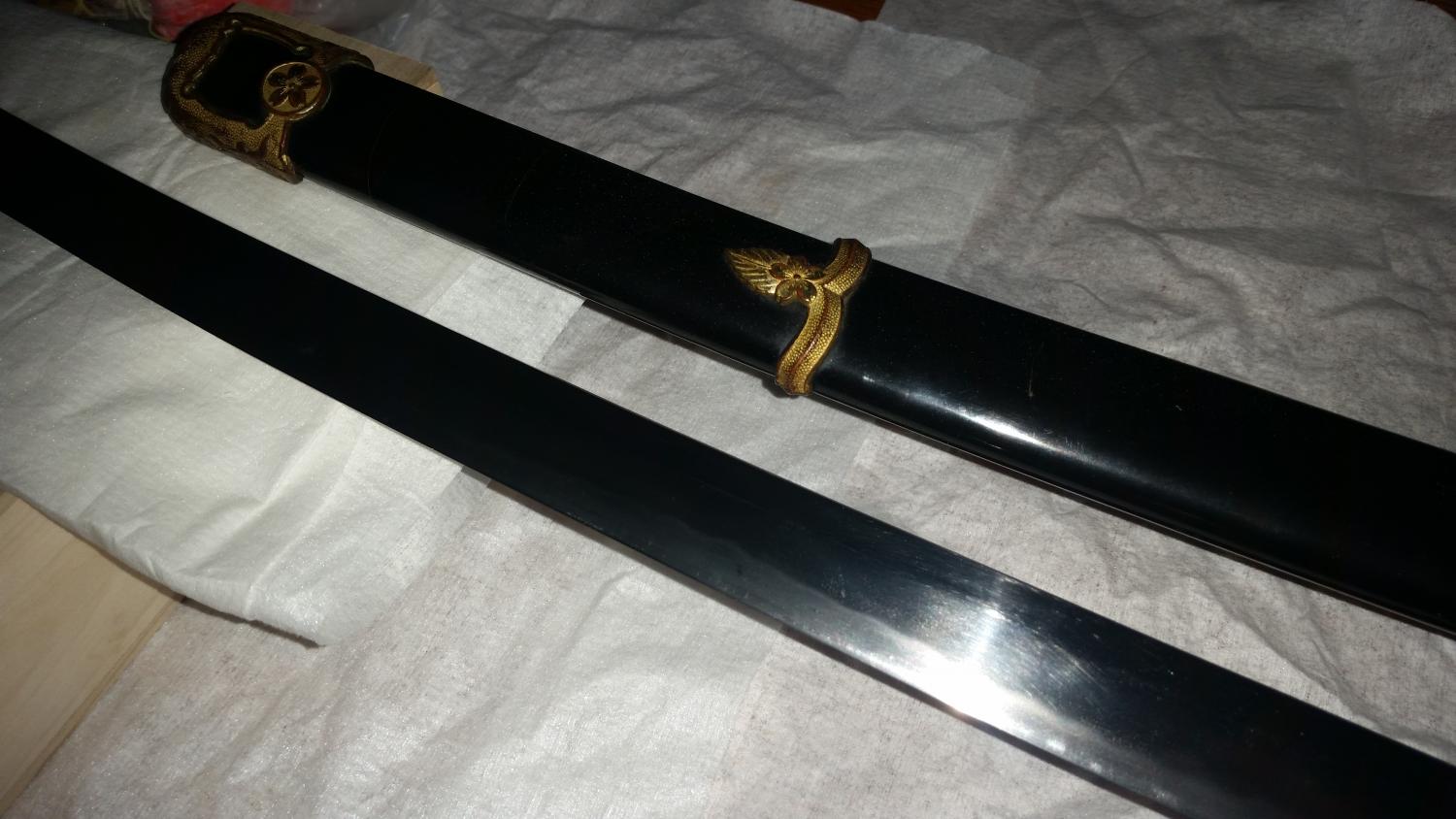

Julian Posted March 4, 2016 Report Posted March 4, 2016 Wowwww you all have really beautiful gunto ,really impressive .... i know my blade its not a high class but i want to share it to you ..sign Munenaga stamp #23 same date as my birthday with SEKI stamp ... if someone are able to give me the date that it right on the tang it will be very appreciated thks Have a great day all...sorry for the pictures ..i think i need a traning for that hihihi 2 1 Quote
Bruce Pennington Posted March 4, 2016 Report Posted March 4, 2016 Julien, very gorgeous Kai-gunto! The picture of the date is a little too dark to make it all out, but what I can see says 1942 (Showa 10 7). Can't quite see the month fully, and don't see a day at all. I can't decipher swordsmith names, but there are other guys here who can very well! The stamps on your seppa are the Toyokawa Naval Arsenal (http://ohmura-study.net/212.html) and the private contractor stamp of Suya Shoten Co, Ltd (http://ohmura-study.net/794.html). Quite unusual to see both of those on the seppa! The number is simply an assembly number stamped on parts to keep them together, since each sword is usually slightly different than the next in size, shape and thickness. 1 1 Quote
Julian Posted March 4, 2016 Report Posted March 4, 2016 Thks BRUCE big thks for that info wow.. i love those links you add to your explanation ... im gonna take more pics toninght when im back home (im working right now ) hihihihhihi..with more light this time ...sorry for the bad pics all the best my friend I try to play with the light in (paint) not sure if its good but that the final result THKS Quote

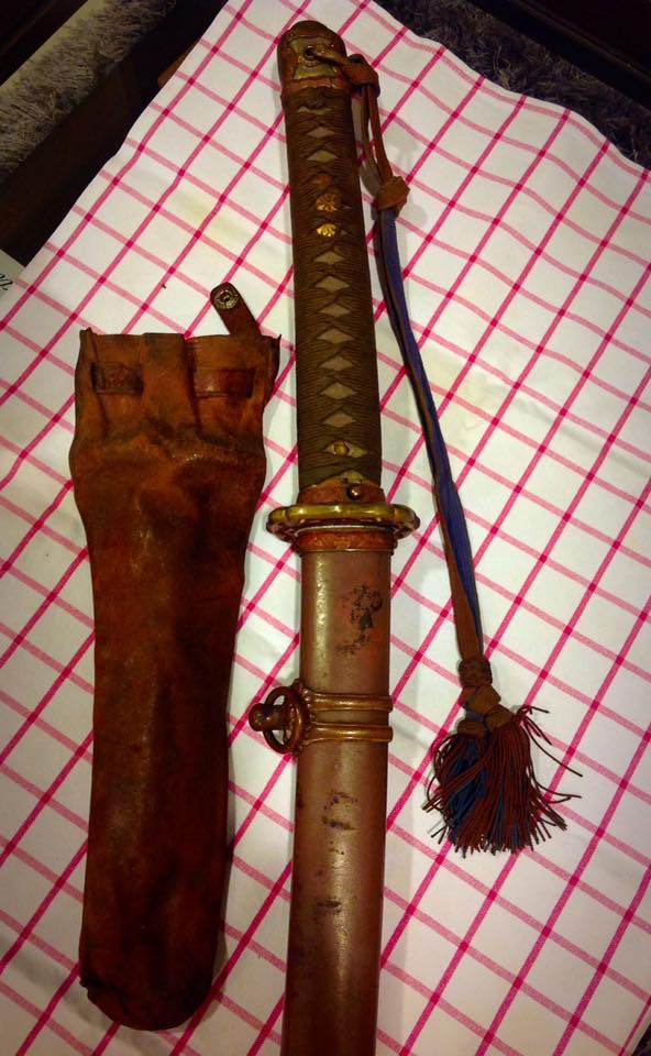

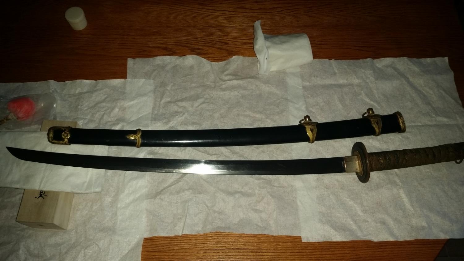

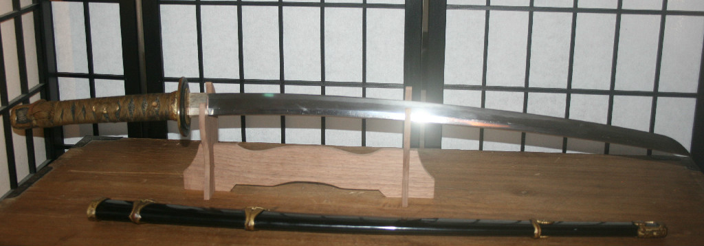

reeder Posted March 19, 2016 Report Posted March 19, 2016 Guess I'll try to keep it going. ive seen better and I've seen worse, but I like it. Blade is older mumei, Nagasa about 24". Has remnants of a surrender tag taped to the spine of the tsuka. 2 1 Quote

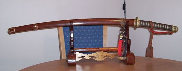

raaay Posted June 21, 2016 Report Posted June 21, 2016 This has been posted before , but worth another go. 6 1 Quote
lonely panet Posted June 21, 2016 Author Report Posted June 21, 2016 that's a very fine looking gunto, the mounts look very simular to the type 94. who made the blade, is a very pleasing piece to look at. can you post some more? Thibault, im also waiting for your Kyu. 1 1 Quote
Johnny Barracuda Posted June 22, 2016 Report Posted June 22, 2016 Due to the colour and finish of the saya, I think might be indeed a Type 94, with the second removable ashi removed. Or at least an early Type 98. A nice shin-gunto from what is to my opinion the best period, i.e. pre-WWII. Later mountings, due to circumstances, could not retain such refinement and quality. Nearly as good as Meiji era kyu-gunto! Being completely ignorant at kanji, I would also be interested if one of our learned colleagues could take the time to translate the mei. Quote
vajo Posted June 22, 2016 Report Posted June 22, 2016 Ray thats a beautifull piece! It looks like it comes directly out of the Ohmura Study website. Quote

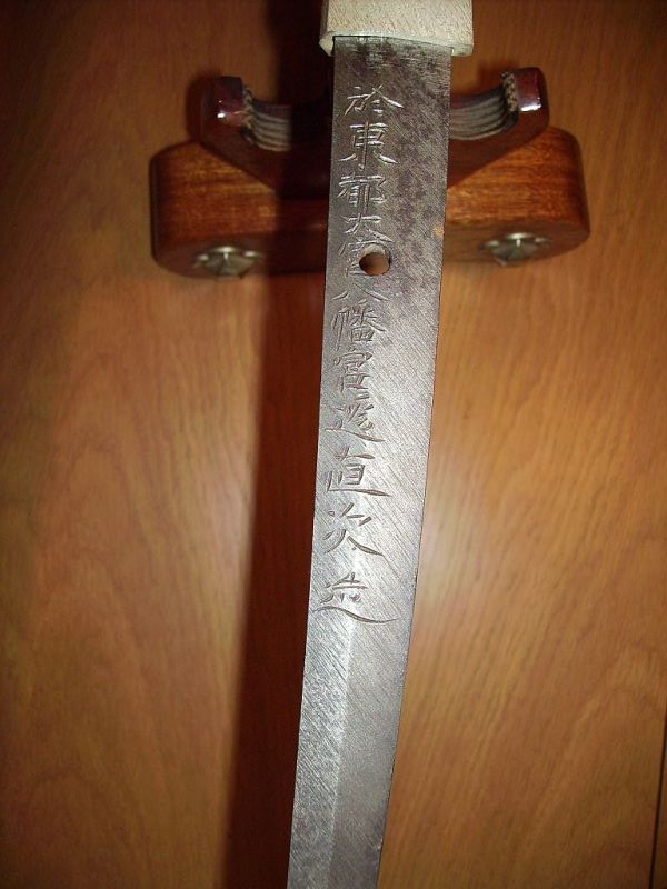

raaay Posted June 22, 2016 Report Posted June 22, 2016 Hi as requested a little more info on my sword, This Shin-Gunto was taken from a w w 2 sword surrender in Singapore by a British Army Officer , who related the storey to the chap I acquired it from, and said he looked through a whole load of swords on the day and picked up what he thought was the best he could find . I cant remember the whole signature from memory but it is something like made in Tokyo at the Hachi-Man Shrine by Naostugu ( Gendai-to smith ) I have seen this smith mentioned a couple times in the past, but there is very little info that I have found out about him ! The mounts are IMHO high grade, maybe special order shin-gunto mounts with silver mon with a same covered lacquered saya and comes with its original sword bag and original sword belt hanger and colonel's or high ranking field officers tassel . and if I remember correctly purchased from the Officer in a about 1970. for £11.00 - not by me unfortunately . 1 1 Quote
Johnny Barracuda Posted June 23, 2016 Report Posted June 23, 2016 @Ray: great piece, I concur on the fact that the mounting was a special high-end order (same-covered saya is a good clue). As previously said, almost certainly pre-war. Upon examining the saya, do you notice faint traces of a second ashi, that would make it a Type 94? @Reeder: nice kyu-gunto, quite similar to mine, but with a better blade. @Hamish: I will receive the cavalry sword in a few days, as it was sent today from Japan. When I receive it, I will make and post pictures of my three Meiji era officer swords: Type 19 Army kyu-gunto, Type 1883 Navy kyu-gunto, Type 19 Cavalry officer sword. The main three variants of the "kyu-gunto family". 1 Quote

raaay Posted June 24, 2016 Report Posted June 24, 2016 Hi Thibault just to confirm this Shin-Gunto has always had a single Ashi only. regards , Quote
Johnny Barracuda Posted June 24, 2016 Report Posted June 24, 2016 So a Type 98, and a very nice one! Quote

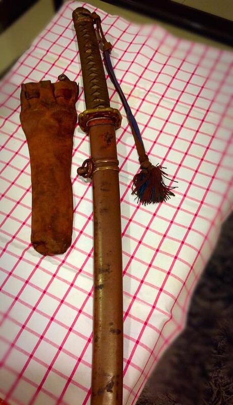

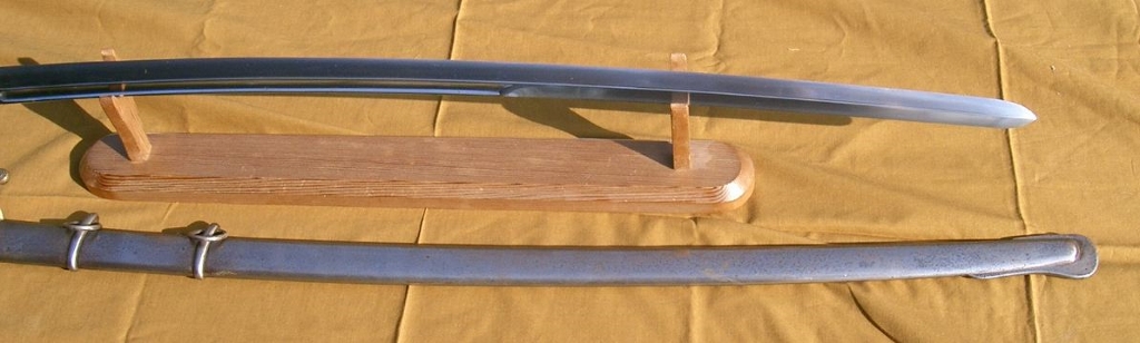

Geraint Posted June 24, 2016 Report Posted June 24, 2016 Dear All. Just one to share, mumei blade, Meiji I think but Kogarasumaru sugata, rather slim and elegant. Enjoy! 1 1 Quote
lonely panet Posted June 25, 2016 Author Report Posted June 25, 2016 very nice, whats the hada and hamon like Quote
Johnny Barracuda Posted June 26, 2016 Report Posted June 26, 2016 Geraint, very nice and elegant blade, and I think that a Kogarasumaru blade mounted as a one-handed kyu-gunto is rather unusual. I like it. Quote

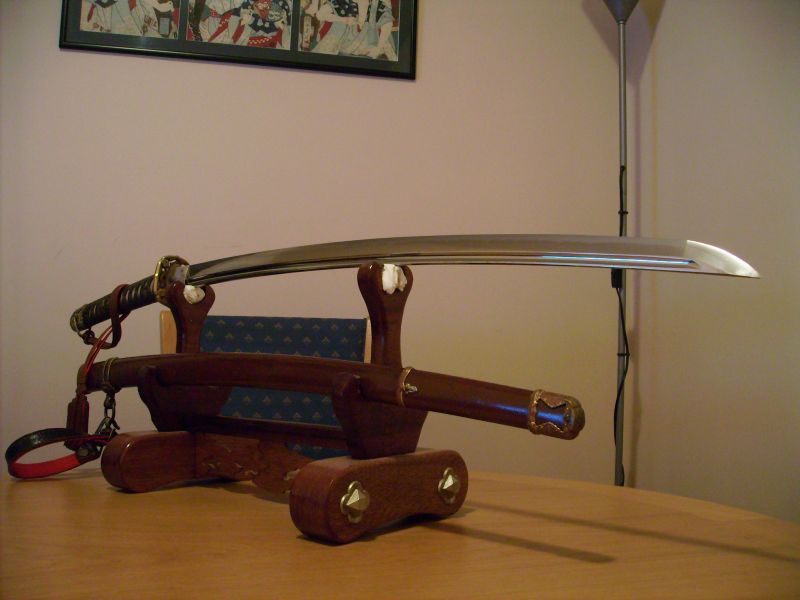

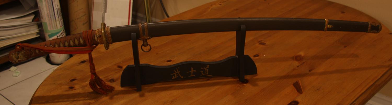

hxv Posted December 22, 2016 Report Posted December 22, 2016 Greetings, I would like to share with you my humble gunto (not high-class, but very presentable) by Akihisa. Warmest Regards, Hoanh 2 1 Quote

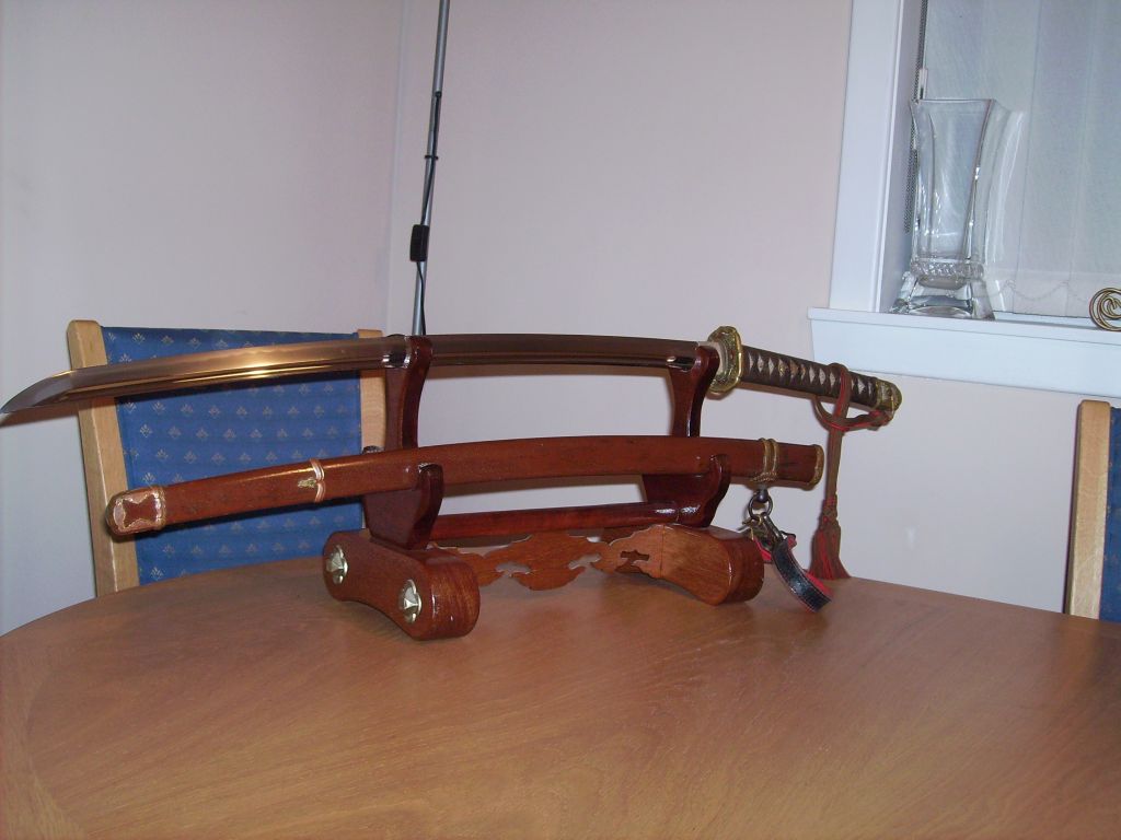

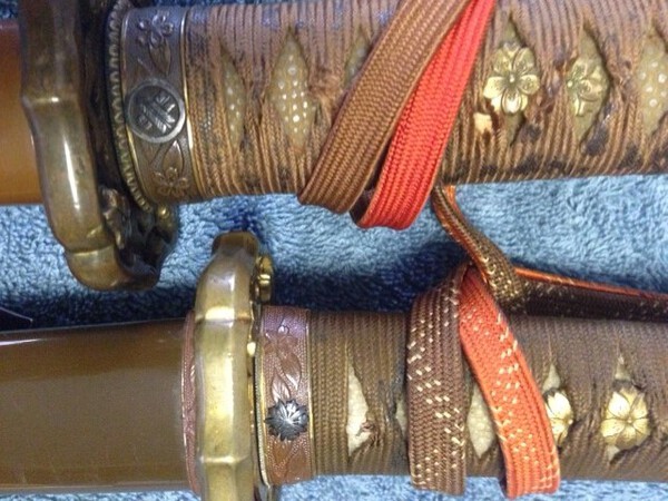

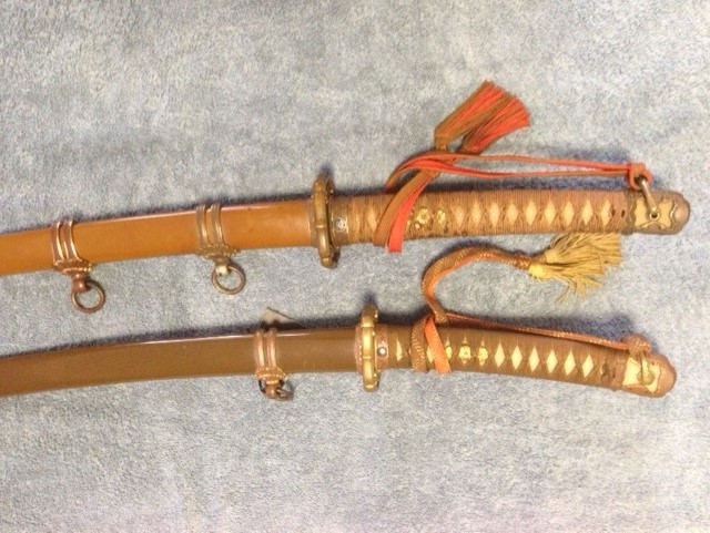

IJASWORDS Posted December 22, 2016 Report Posted December 22, 2016 Hi Hamfish, thanks for the opportunity to see some NICE Gunto. Thought I would pick a couple of mine to post. Old family blades, silver mons and original tassels. Hope you like these as much as I have liked all the ones that have been posted. Neil. 1 1 Quote
Shamsy Posted December 22, 2016 Report Posted December 22, 2016 The 94 is a lovely example! I've seen very few for sale and I remember that the last one posted on NMB and ebay sold before I could blink. To China, hopefully a collector. Love the curvature of the tsuka on the second sword! Would be good to get it in hand and see how it feels. It doesn't look very comfortable, but I guess you might be able to comment on that Neil? Quote
IJASWORDS Posted December 22, 2016 Report Posted December 22, 2016 Hi Shamsy, the general sword is a SEKI/MINO UJIFUSA OWARI blade, and is one of the loveliest balanced blades I have. Neil. Quote
