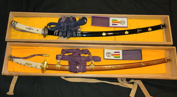

PNSSHOGUN Posted April 14, 2022 Report Posted April 14, 2022 Hi Oli, this is a different sword from the Coronation Tachi. Those were all dated 1928 and had a particularly elegant Tachi Sugata and Bo-Hi, also they had two types of traditional Efu Tachi mount. Michael's sword is something very unique as it has normal Type 94 fittings that have been silver plated but special Ashi that are half regular army Ashi with modified Tachi style tops. So perhaps this was a special presentation Tachi made during the mid to late 30's for a specific occasion. Here is a Coronation Tachi, and the two types of Koshirae for reference: 2 1 1 Quote

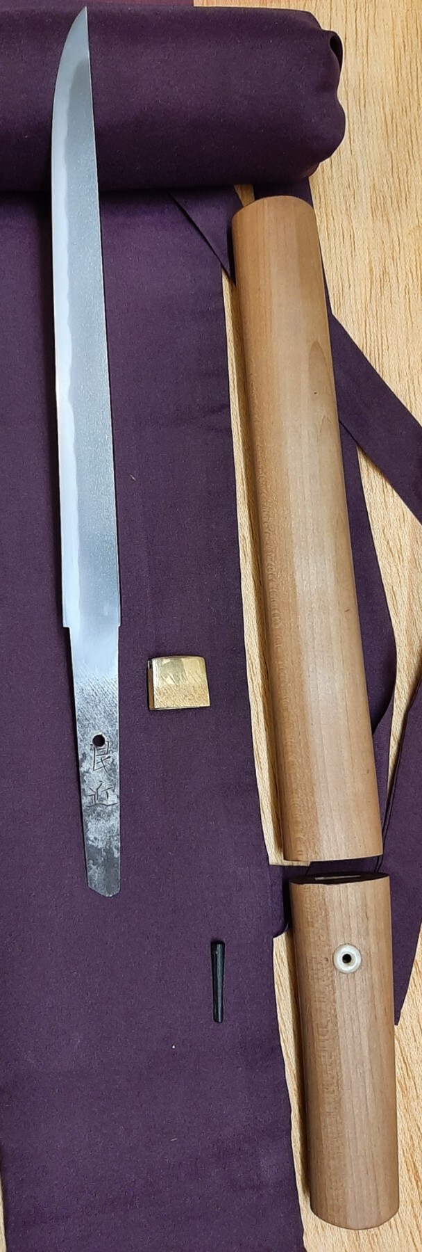

Itomagoi Posted April 14, 2022 Report Posted April 14, 2022 Hello, because it just fits to this topic. A very rare tanto of Yoshichika in Shirasaya. 1 1 Quote

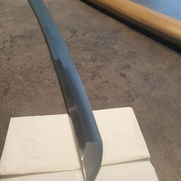

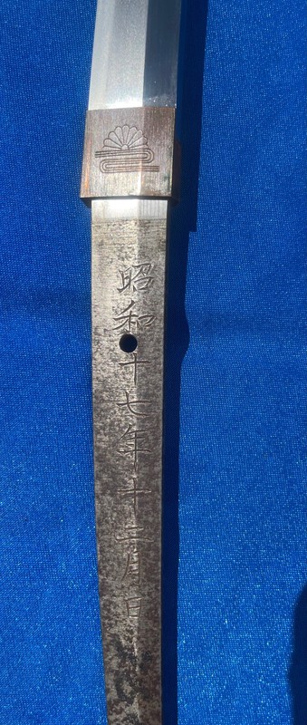

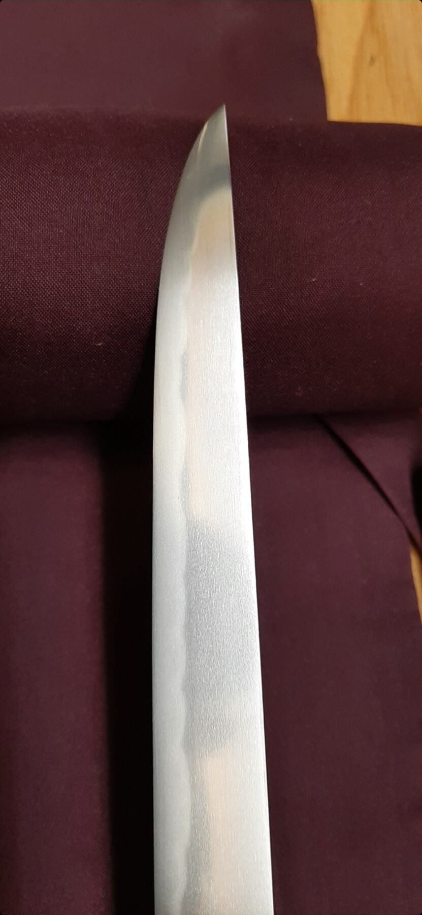

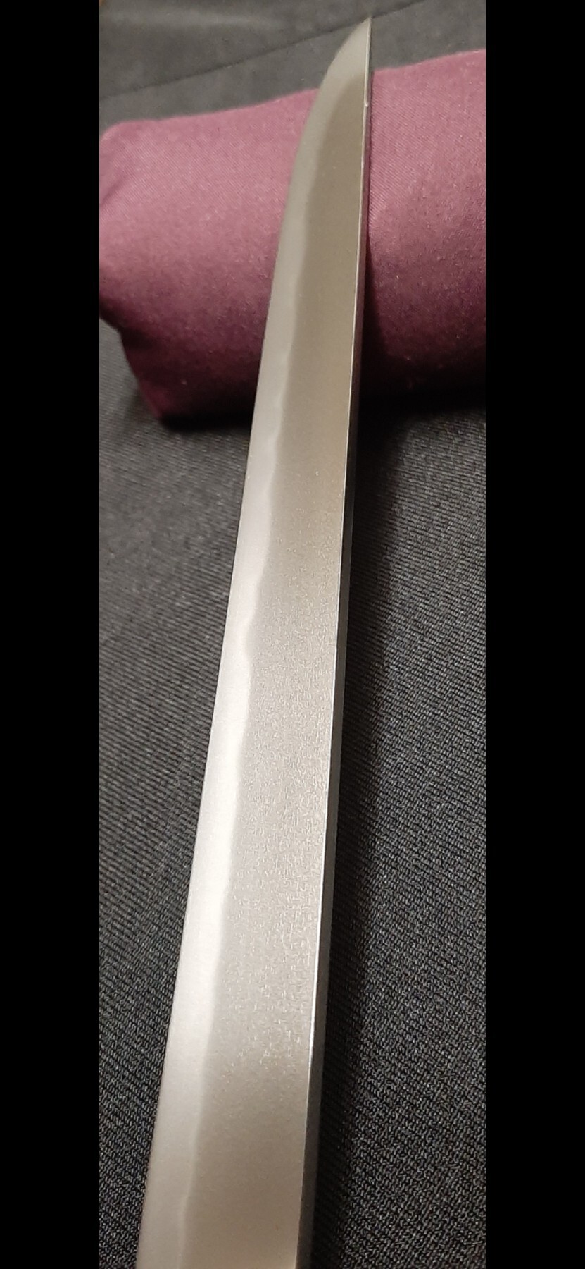

Michael 67 Posted April 16, 2022 Report Posted April 16, 2022 Hi friends I would like to show my Moriwaka Masataka to the members. Nagasa is 70.2 cm. It has a 2 colored wood saya. 4 5 Quote

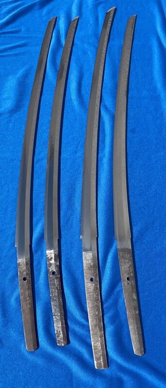

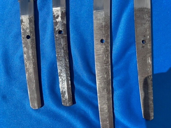

Michael 67 Posted April 17, 2022 Report Posted April 17, 2022 At the moment I have a lot of time because of Corona. Since I have no symptoms and I am fine. I would like to introduce to the members today more swords from my modest collection, left side Miyaguchi Yasuhiro (68,cm) in 94 Shin Gunto with pinned kabutogane. Next to it Kajiyama Yasunori in 94 Shin Gunto pinned kabutogane, Kotani Yasunori (69.9cm) in 98 Shin Gunto, Abe Yasushige in 98 Shin Gunto with aluminum saya. Sorry for the bad pictures. 5 4 Quote
PNSSHOGUN Posted April 17, 2022 Report Posted April 17, 2022 Very nice collection Michael, it is interesting to note the pins have come out on one sword. The early swords came with different pinned Kabutogane styles I believe, one with holes drilled and no pins, ones with pins with no head, and pins with head to retain them. Can you let me know the dates on the pinned swords? Quote
Michael 67 Posted April 17, 2022 Report Posted April 17, 2022 Jo John, Yasuhiro is Showa 9, June Yasunori is Showa 9 March 1 Quote

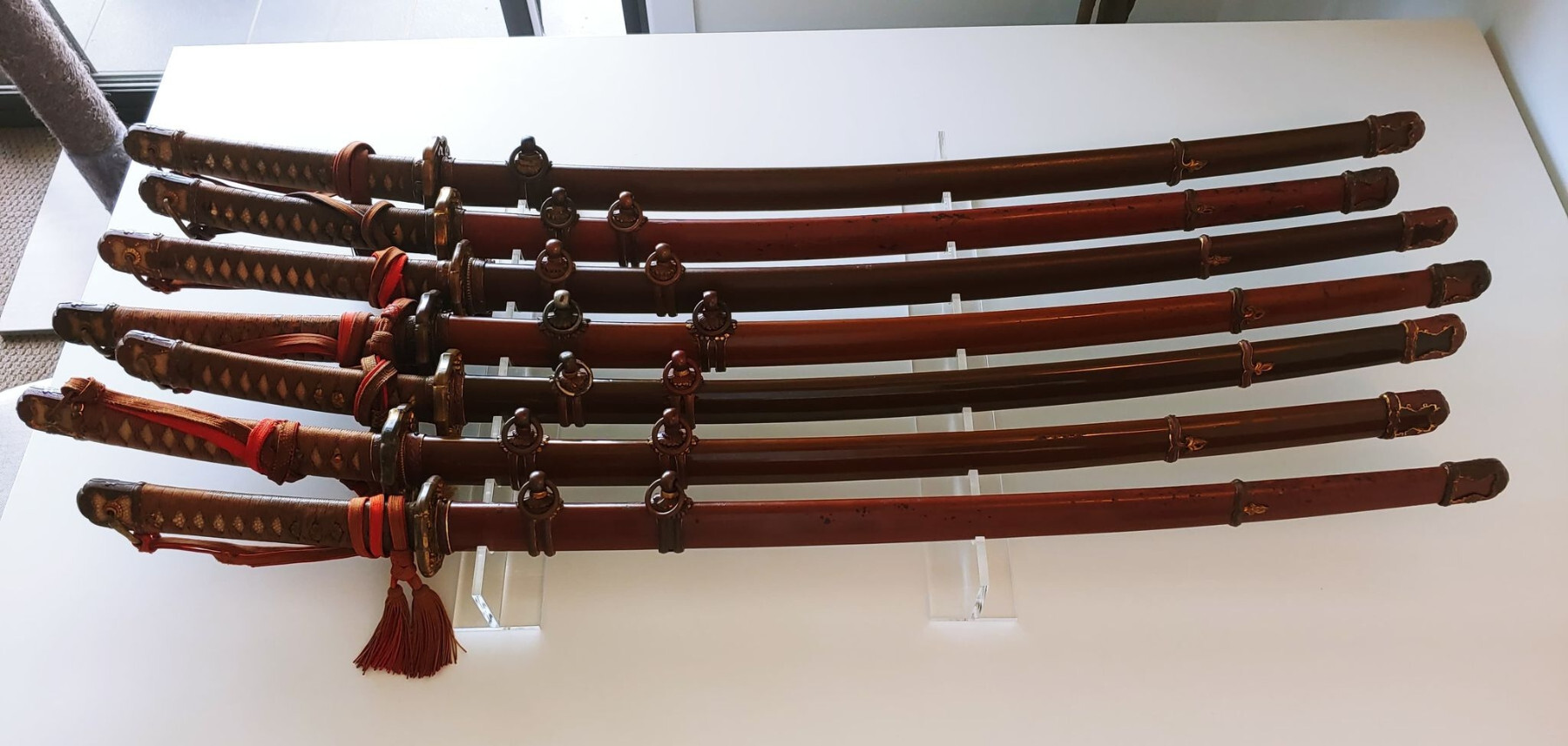

IJASWORDS Posted April 19, 2022 Report Posted April 19, 2022 While we are in a YASUKUNI mood, a couple of mine. An early 1938 (Kajiyama) YASUTOKU in leather combat cover, and a 1942 (Kotani) YASUNORI in an aluminium saya. Both in Suya fittings, with pierced tsuba. 8 2 Quote

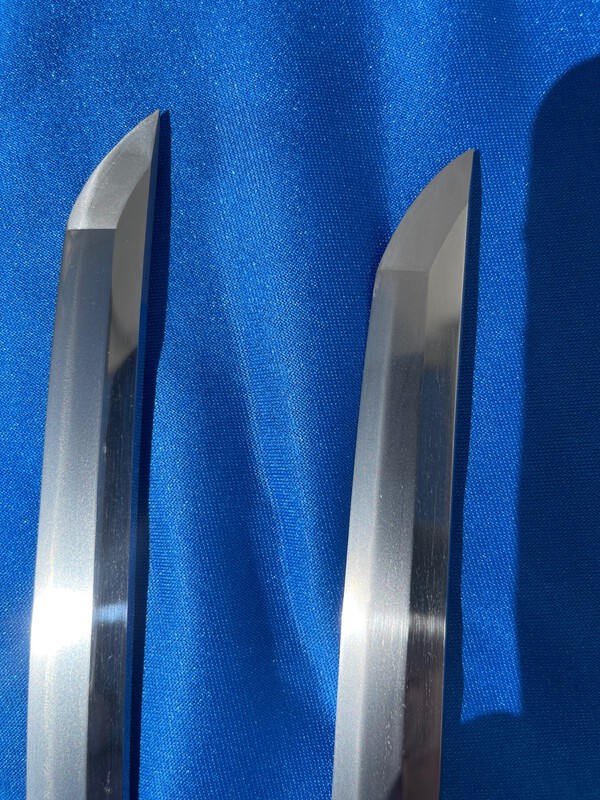

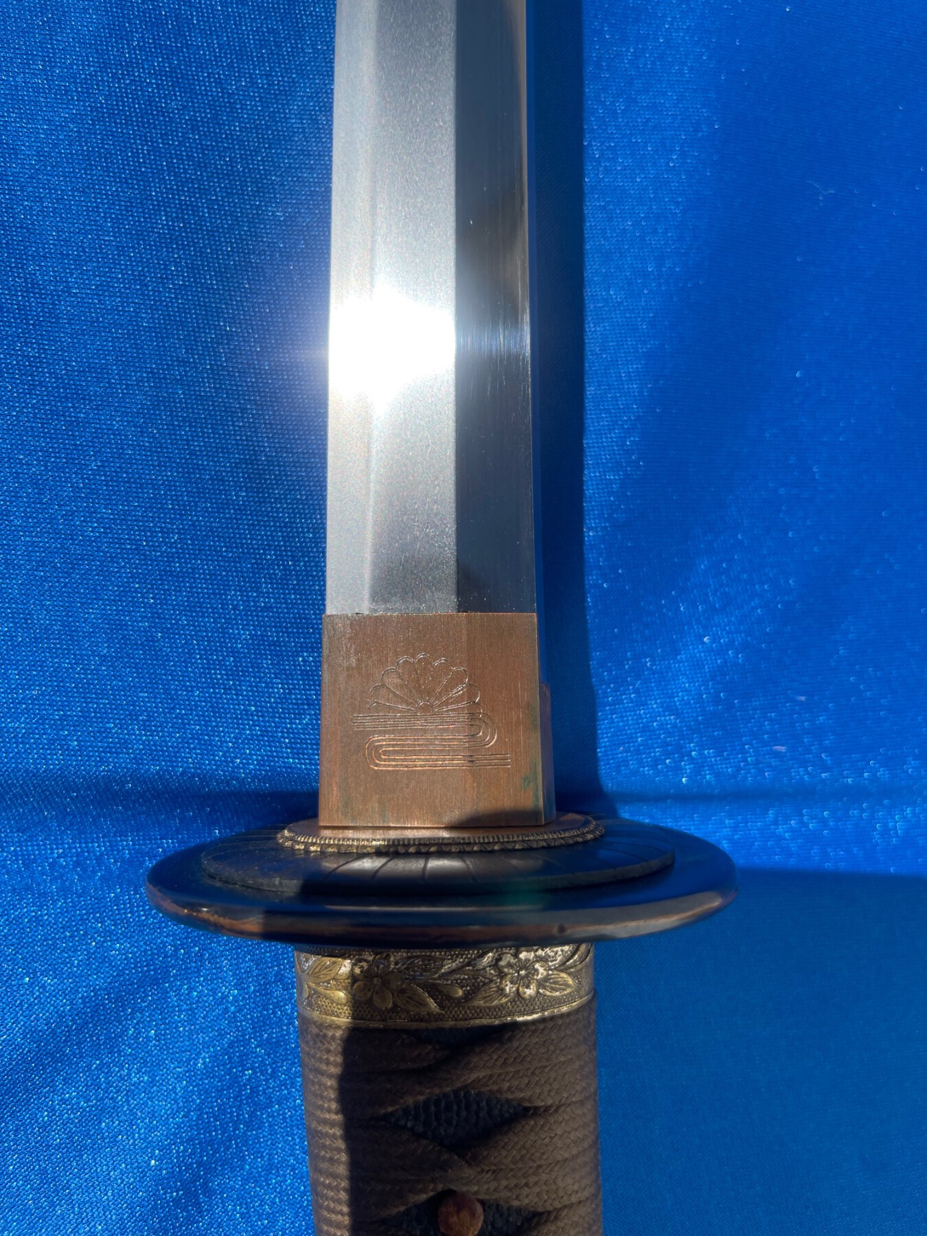

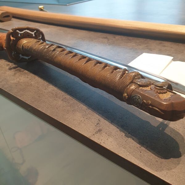

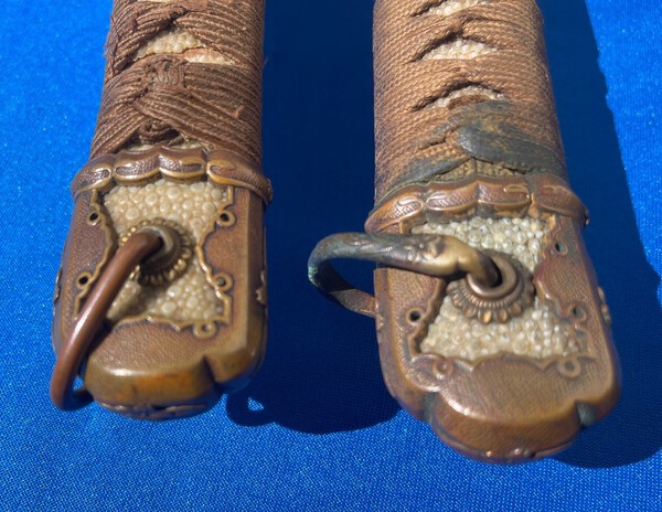

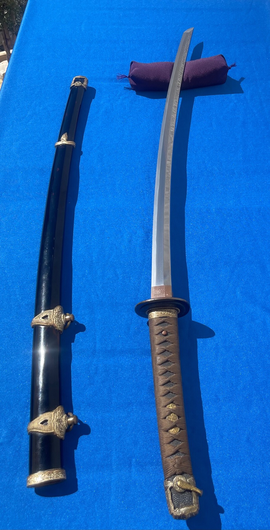

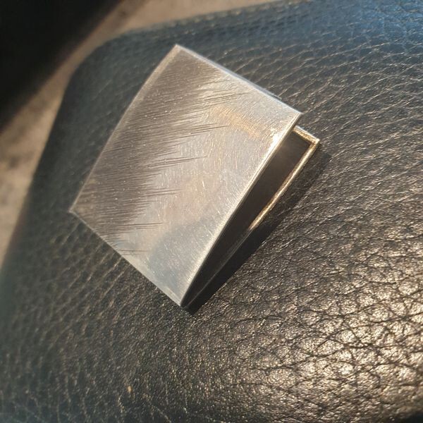

Volker62 Posted April 19, 2022 Report Posted April 19, 2022 Then I want to participate too with this... Very rare NBTHK papered Kayijama Yasutoshi 69,9 cm Nagasa long in Mint condition, deep sori flawless original polish with utsuri with Hozon Silver foil Habaki and Silver Mon on the Kabuto Gane Koshirae is '98 pattern with unsual Haikan , not suya made I suspect because of the blades lenght... It must be a order made one of this lenght 3 Quote

george trotter Posted April 19, 2022 Report Posted April 19, 2022 Hi Volker, Interesting. I have a sword with the same haikan (sword by unknown WWII smith Shigekuni). Just for Bruce, are there ay stamps or marks on the tsuba/seppa that might identify the mounting shop? Would be nice to know who made this haikan/fittings. Mine only has the number 199 stamped on metal parts....how about yours? Regards, PS. mine also has 8 seppa and silver habaki and silver mon (torn off). Quote
PNSSHOGUN Posted April 19, 2022 Report Posted April 19, 2022 What is the date on your nice Yasutoshi? That hanger type can be found on Type 94 and early Type 98. Quote

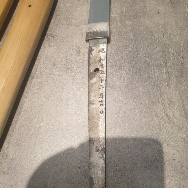

Volker62 Posted April 19, 2022 Report Posted April 19, 2022 Hello Friends I own two swords with this Haikan, other is a long 68,9 cm sword made by my long time friend Kotani Kenzo san, Yasunori. Sorry no marks, or stamps on the Haikan, I know that Bruce is looking for it, so he gets information from me about it all fittings are matching numbered 5 what can happen, if you'r not careful when handling the Japanese sword...! Always be careful Gentleman John as you can see the sword is dated march, showa 15.year... thank you! 1 2 Quote
Volker62 Posted April 19, 2022 Report Posted April 19, 2022 sorry forget to mention the blade from Kotani Yasunori is dated showa 13. year. 12. month Quote

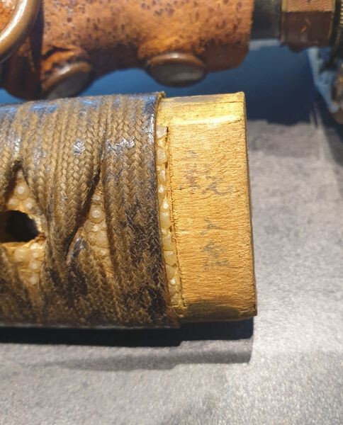

Volker62 Posted April 19, 2022 Report Posted April 19, 2022 found this on Yasutoshi's handle. perhps a note of the Koshirae maker? Quote
george trotter Posted April 19, 2022 Report Posted April 19, 2022 Thanks for those dates gentlemen 1940 and Dec 1938...helps me date my undated Shigekuni to say 1940-ish. Volker san, yes, that writing might be the mounter shop...pity it is unclear...my Shigekuni is numbered in ink (in kanji) 199 and has the shop guy? name written as Oshima (I think I have already told Bruce). Thanks again.. Quote

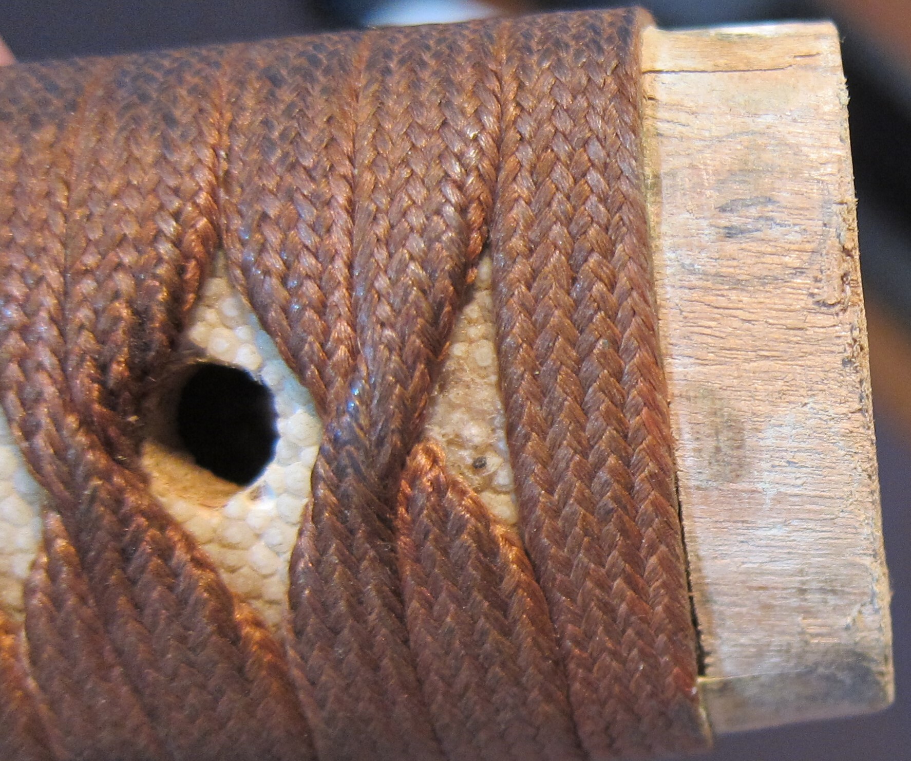

PNSSHOGUN Posted April 19, 2022 Report Posted April 19, 2022 Thanks Volker, very special swords and memories. Writing on the Tsuka can often relate to the style of Mon. Quote
Volker62 Posted April 20, 2022 Report Posted April 20, 2022 Thank you John Wow impressive collection!!!! Do you also own a Yasutoshi?? I've seen very very few of them... Quote
george trotter Posted April 20, 2022 Report Posted April 20, 2022 On 4/19/2022 at 11:56 PM, PNSSHOGUN said: Thanks Volker, very special swords and memories. Writing on the Tsuka can often relate to the style of Mon. Expand Might have mentioned this before John?....but in the case of this name OSHIMA being written on the tsuka, the missing mon was unlikely to have been an Oshima mon as the information on the sword says the owner was 2nd Lt KUME (unless he was a linked branch family to Oshima?). Regards, 2 Quote
