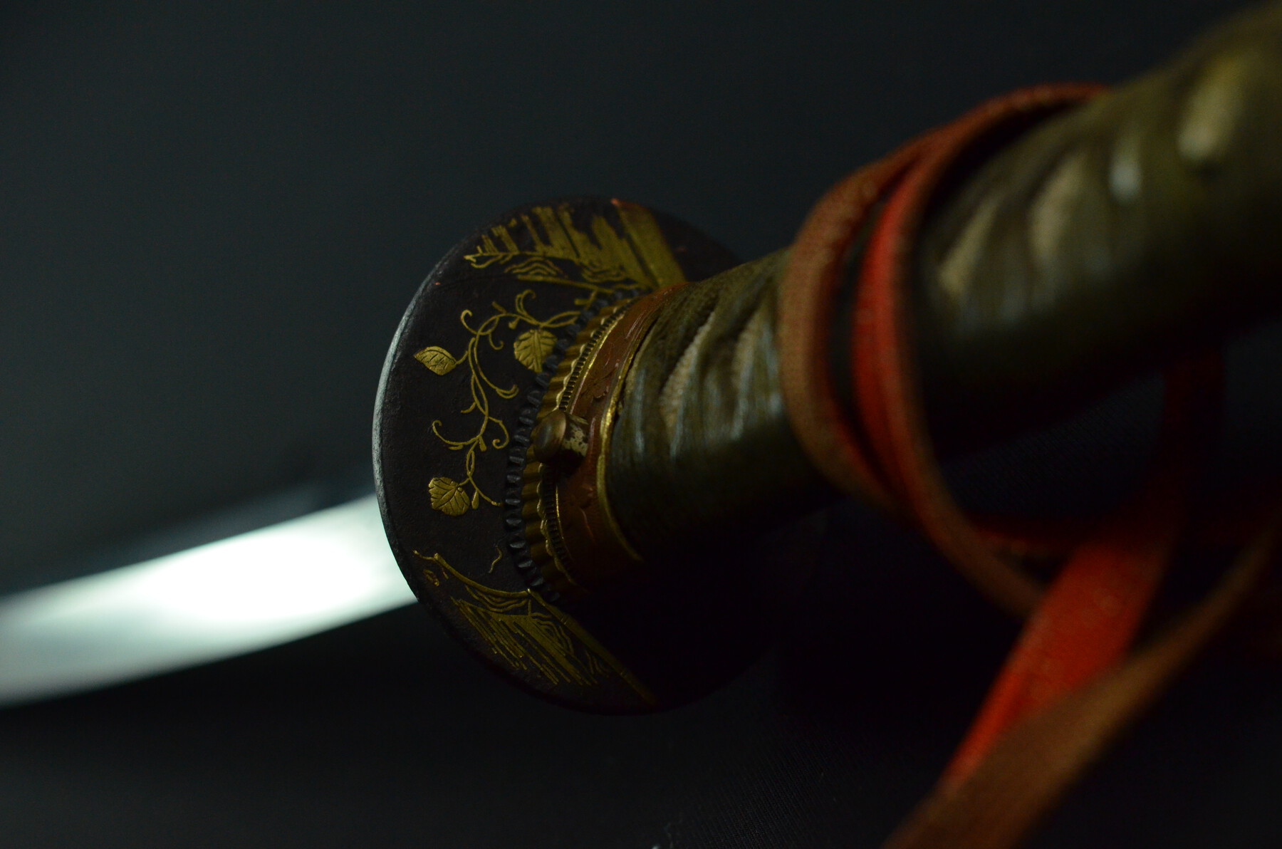

ChrisW Posted June 7, 2021 Report Posted June 7, 2021 John, that is a spectacular blade with some awesome mounts! That is something I've never seen before. 2 Quote
PNSSHOGUN Posted June 7, 2021 Report Posted June 7, 2021 Nagasa is just over 28 Inches, large Sori with Fumbari. Overall length of mounts is 41.5 Inches. 2 Quote
ChrisW Posted June 7, 2021 Report Posted June 7, 2021 If you ever have the idea to let it go, let me know! I'd part with a number of things for something as gorgeous as this. 1 Quote

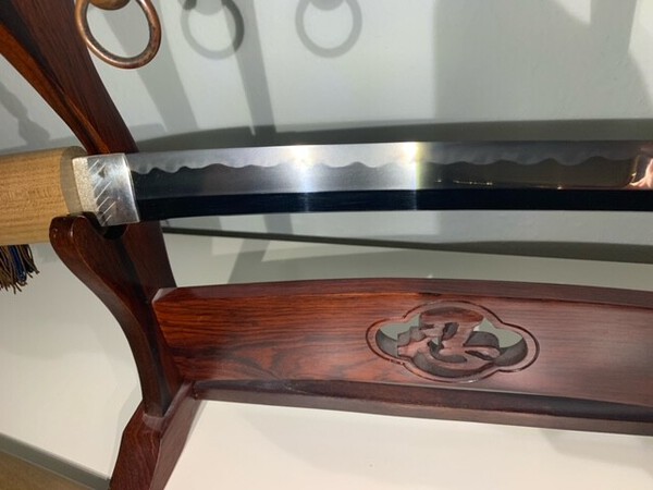

Michael 67 Posted July 19, 2021 Report Posted July 19, 2021 one of my favorites in my humble collection Tsukamoto Kazuyuki Oshû Iwashiro-jûnin Tsukamoto Kazuyuki Tôyama Mitsuru'ô no teinai ni oite Showa 13, August 5 1 Quote
Volker62 Posted July 19, 2021 Report Posted July 19, 2021 many thanks to a "high valued" "collector friend" and gentleman in the USA 1 Quote
Michael 67 Posted July 19, 2021 Report Posted July 19, 2021 that's right. otherwise such a rare sword would never have come to Germany. Quote
Michael 67 Posted July 19, 2021 Report Posted July 19, 2021 by the way. Mr. Bowen has the matching tanto, same date , signature kazuyuki. Quote
francois2605 Posted July 19, 2021 Report Posted July 19, 2021 Very nice, I like it a lot ! Thanks for sharing. It's funny, when I saw the signature, some kanji immediately jumped out and Tsukamoto Okimasa sprung to mind: I had never heard about "Tsukamoto Kazuyuki" before and learning now that this is another name Okimasa used. This is the mei from my Tsukamoto Okimasa (which isn't papered but I believe it's genuine). Edit: Found this old NMB thread on the sword Quote
David Flynn Posted July 20, 2021 Report Posted July 20, 2021 The only record of this being an early signature of Okimasa is that of Chris Bowen stating such. There is no other record, unless Chris has some direct reference material. Quote
