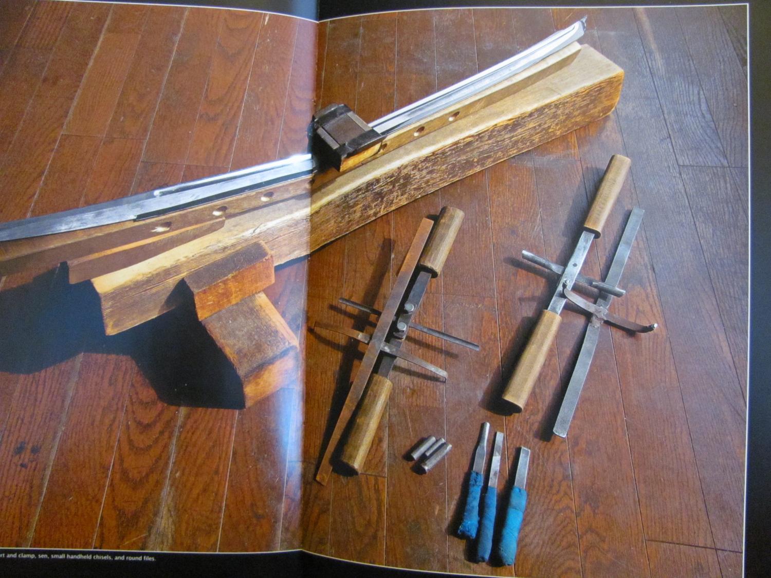

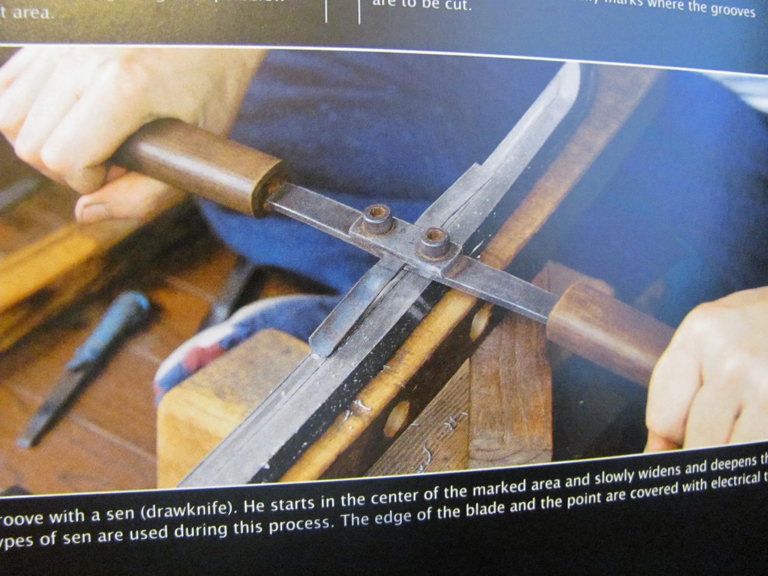

2 pictures from The Art of the Japanese Sword: The Craft of Swordmaking and Its Appreciation by Kapp and Yoshihara (excellent book, highly recommended) below.  The tool in the 1st picture is called sen; the other picture shows a variety of tools used to cut hi.
