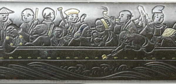

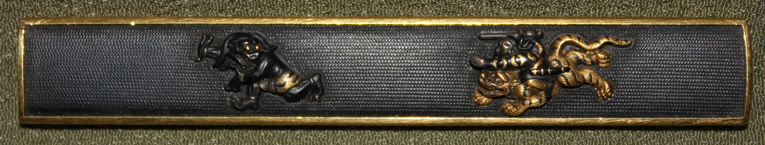

Darcy Posted January 25, 2016 Report Posted January 25, 2016 This is Sano Naonubu who was very rare but pretty skilled. Not a grand master. This is telling the story of the mother scaring the shishi cubs off of the cliff and making them fall. The menuki are the falling shishi. You can see who the mother is because the cub is terrified of her. Only the strong survive. 3 Quote

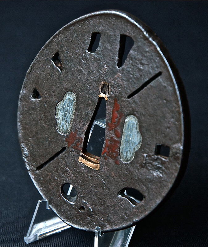

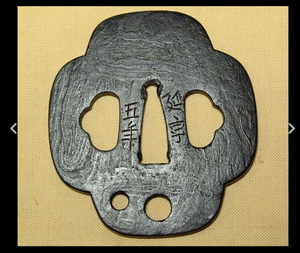

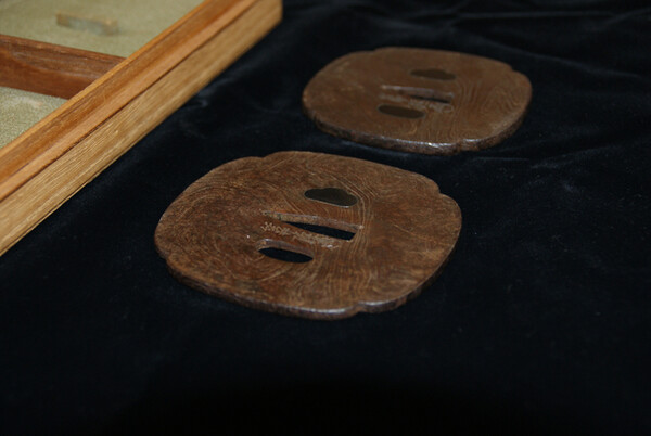

Steve Waszak Posted January 25, 2016 Report Posted January 25, 2016 Steel tsuba. 8.9cm. Uchikaeshi mimi. Otafuku-mokkogata. Owari Province. Momoyama Period. Interesting tsuba: though it has both NTHK papers and a shumei to Sadahiro (referring, I believe, to Owari Sadahiro, Keicho era, Momoyama Period), there is, on the left side of the seppa-dai on the omote, the remnant mei of the nidai Nobuiye. It has been abraded significantly, to the point that, in most light and in most angles of light, it is gone. But in the right light, at the right angle, the characteristics strokes forming the "Futoji-mei" Nobuiye (nidai) signature can be seen. It is, unfortunately, extremely difficult to capture this "ghost mei" in photos. 3 Quote

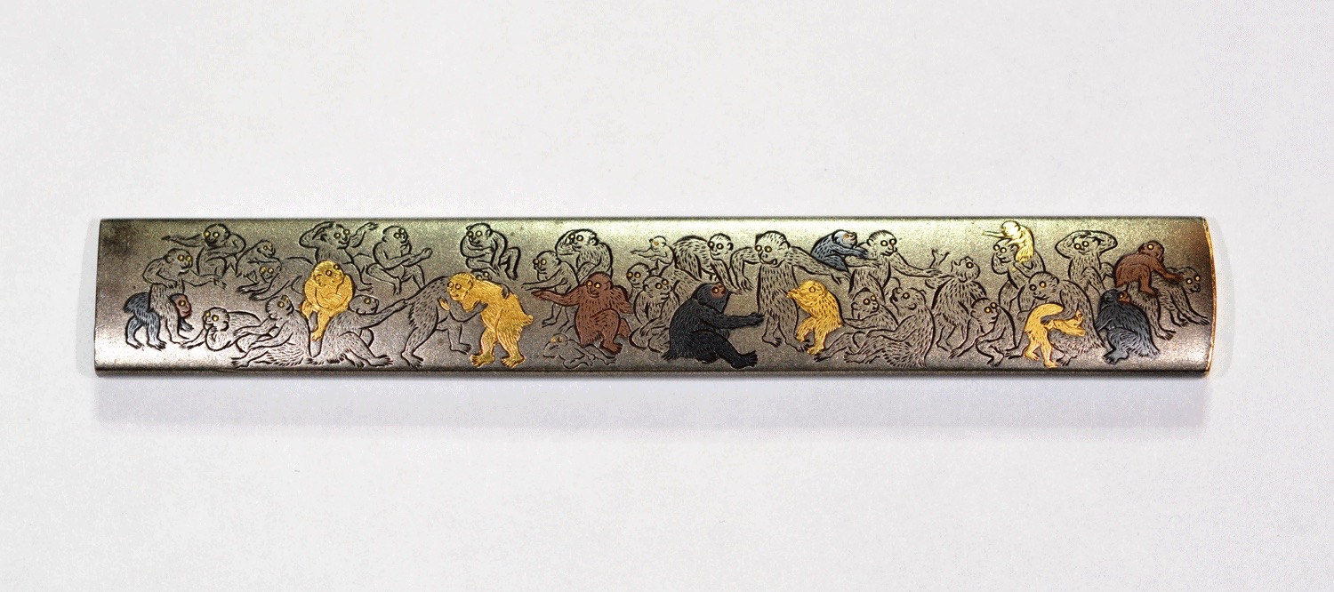

Jean Posted January 25, 2016 Report Posted January 25, 2016 Ex Haynes' collection. Hosono Masamori, shakudo. 4 Quote
Gordon Sanders Posted January 25, 2016 Report Posted January 25, 2016 Quite interesting. I have something similar that I will post later. Not as beautiful as yours Quote

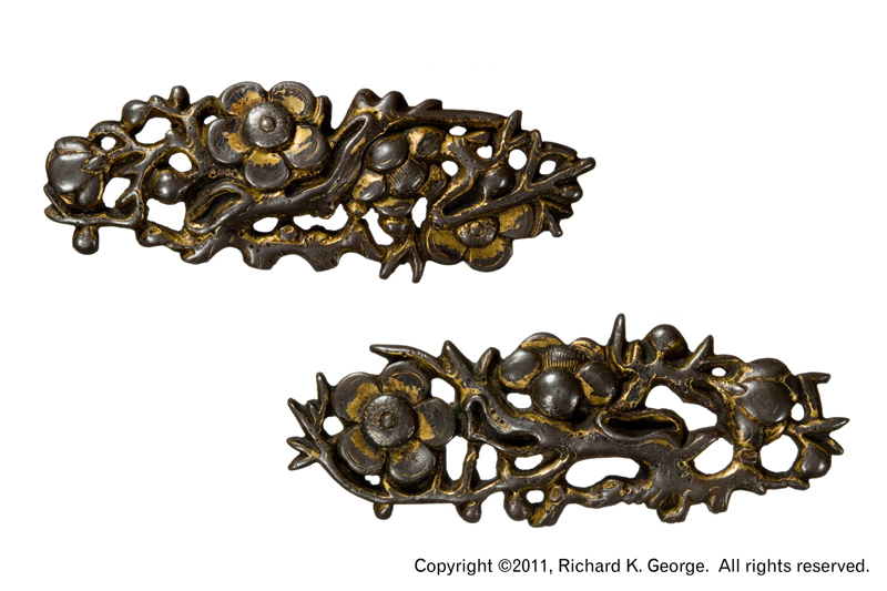

rkg Posted January 26, 2016 Report Posted January 26, 2016 I don't really have any pieces that compare to these/are at this level, but how 'bout this - ezo kanagu (they're huge so I doubt they were menuki) not early-early, but not edo period umetada utushi either: Best, rkg (Richard George) 3 Quote
Brian Posted January 26, 2016 Report Posted January 26, 2016 Nice! What do you consider huge Rich? Quote
rkg Posted January 26, 2016 Report Posted January 26, 2016 Brian, Oops, size would help, huh? :-) They're 56mm long X 14.5mm high Best, rkg (Richard George) 1 Quote
Darcy Posted January 26, 2016 Report Posted January 26, 2016 They look very old to me Richard. I know next to nothing but Ezo is very cool. Used and loved obviously and one of the things that looks better for being used and loved. Quote
Pete Klein Posted January 26, 2016 Report Posted January 26, 2016 Richard - If you have a picture of the ura would you be so kind as to post it? It say a lot about the piece (as you already know). Pete Quote

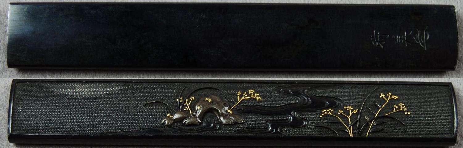

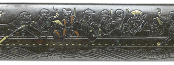

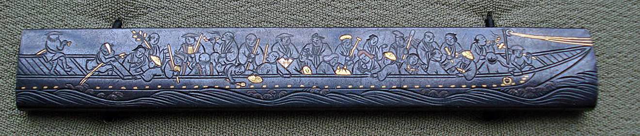

Gordon Sanders Posted January 27, 2016 Report Posted January 27, 2016 Here is my boat kozuka. That I think is quite fun Papers arrive this week 3 Quote

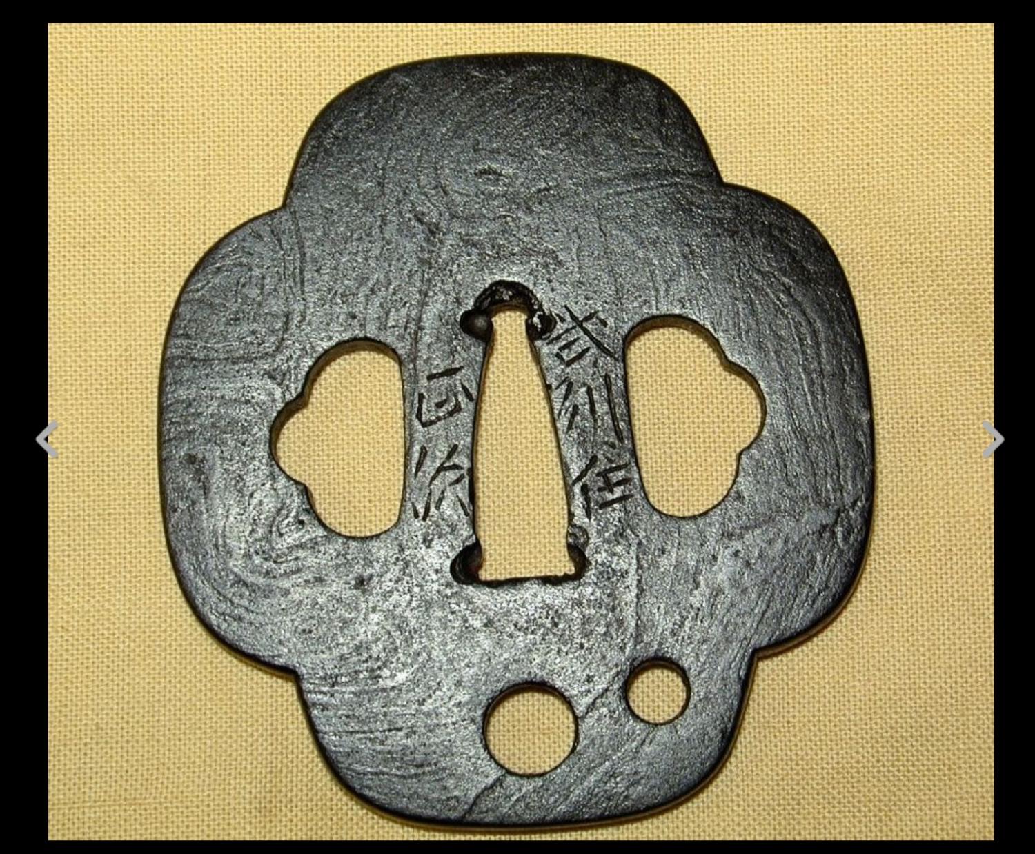

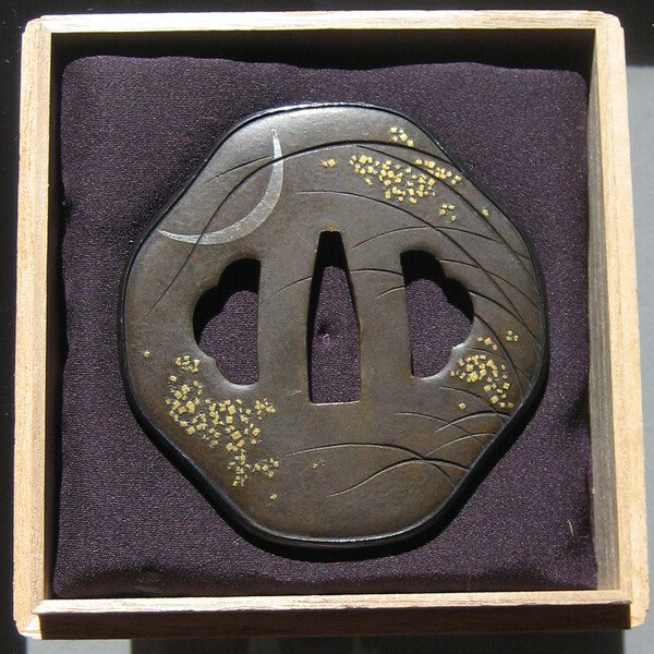

Curran Posted January 28, 2016 Report Posted January 28, 2016 Agree with that Darcy's 'Momoyama' one is better condition than the Juyo one. I tend to avoid mythological themes and creatures, but that is a Dhamn fine one. To keep this thread going: Higo tsuba by Kohrin. According to one Japanese source, there are only 25 to 30 supposedly in existence. I've seen 2 at the DTI, this dealer has 2 out of somewhere: http://www.t-touken.com/archives/4856, and another list member owns one. Plus those in Ito-san's book or possession and the Higo Kinko Taikan, I have record of about 17 of the supposed 25 to 30. He was known for inlay work. All that gold is not applied, but inlaid. The one belonging to another NMB member has multiple silver moons inlaid and shakudo trees along the ridges of a mountainside. ----> Often they are unsigned, but have a distinctive rope mimi- usually done in shakudo. ----> Design elements used by the artist: silver moons, grasses that travel across the seppa dai of the tsuba, distinct shape, lack of humans in what is usually a contemplative scene. 2 Quote

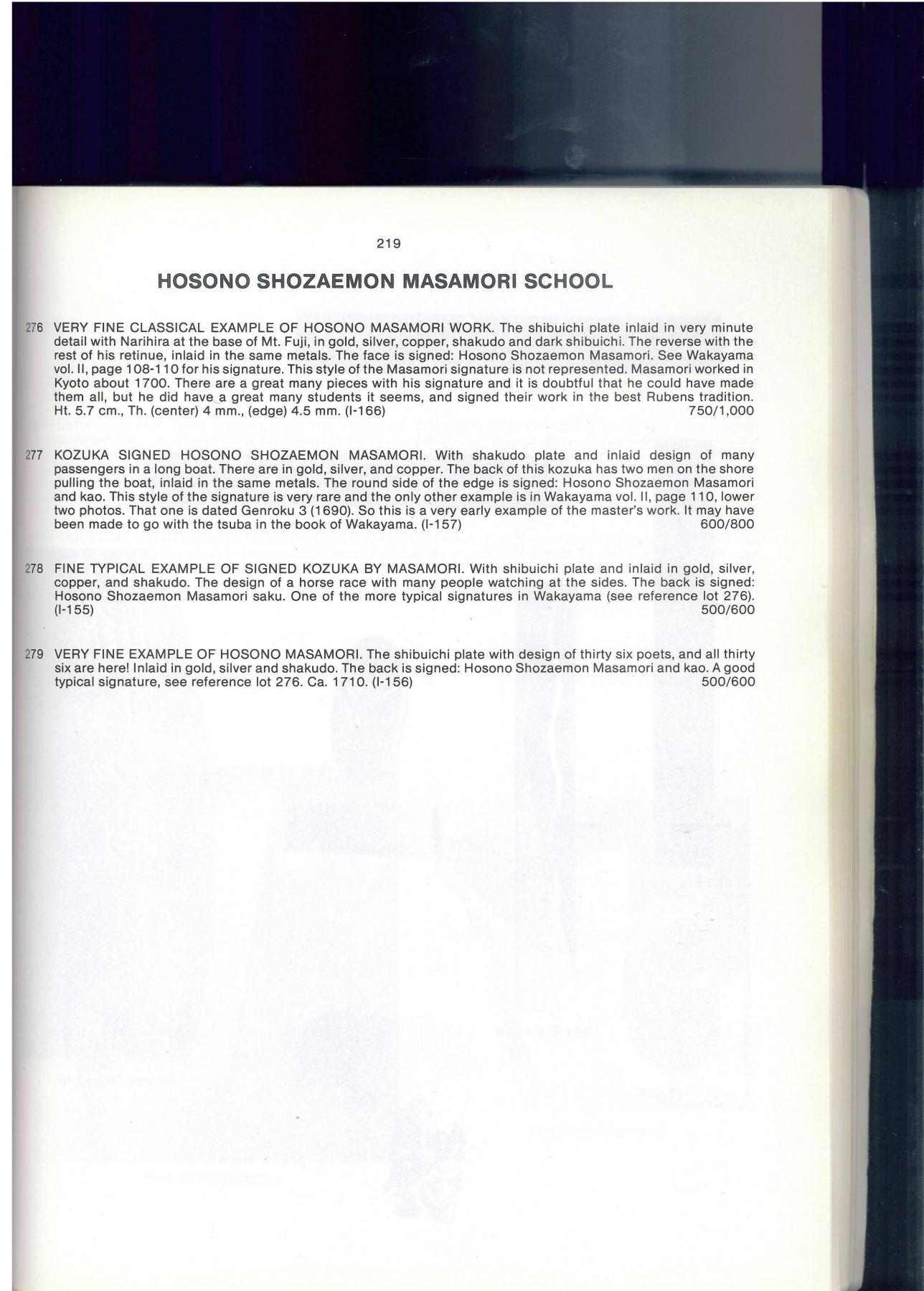

Henry Wilson Posted January 28, 2016 Report Posted January 28, 2016 The kozuka belonging to Gordon above appears to be ex Wilson collection that was published in one of the KTK catalogues. Glad to see it surface again. If you have time Gordon, I would love to see the papers. Lacquer seems to be poorly misrepresented in this thread so to rectify that here is something else from the Wilson collection: 2 Quote

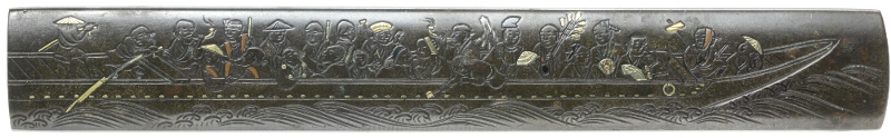

Bazza Posted January 29, 2016 Report Posted January 29, 2016 Lovely TSU JIMPO kozuka from a friend's collection. Bestests, BaZZa. 1 Quote
Gordon Sanders Posted January 29, 2016 Report Posted January 29, 2016 As soon as they are translated. I have been told they would be ready today :-) Do you have a scan of the catalogue you mention? The kozuka belonging to Gordon above appears to be ex Wilson collection that was published in one of the KTK catalogues. Glad to see it surface again. If you have time Gordon, I would love to see the papers. Lacquer seems to be poorly misrepresented in this thread so to rectify that here is something else from the Wilson collection: Koshirae.jpg Quote
Henry Wilson Posted January 29, 2016 Report Posted January 29, 2016 As soon as they are translated. I have been told they would be ready today :-) Do you have a scan of the catalogue you mention? Hi Gordon Not at hand but I can do you a scan this weekend. I can post it here or message it to you if you like. Quote

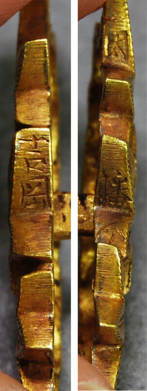

Heringsdorf Posted January 29, 2016 Report Posted January 29, 2016 My best set of menuki. Gold, signed Yoshioka inaba no suke. Probably 6th or 7th generation. NBTHK Tokubetsu hozon papers. 3 Quote

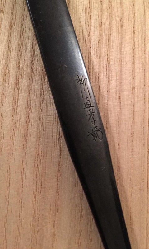

Heringsdorf Posted January 29, 2016 Report Posted January 29, 2016 Kogai signed Yanagawa Naotaka and kao. With NBTHK hozon papers. 1 Quote

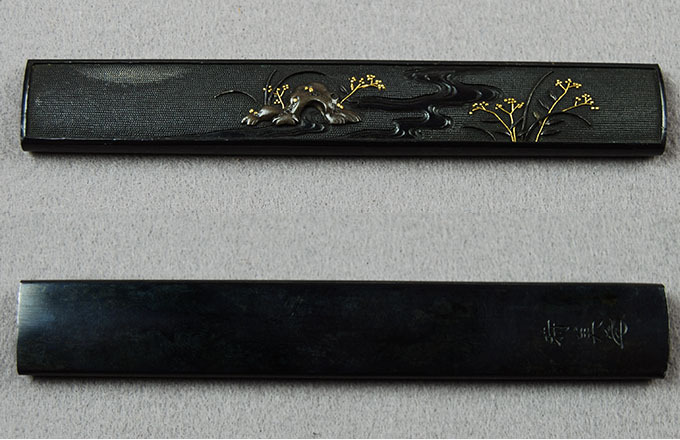

Heringsdorf Posted January 29, 2016 Report Posted January 29, 2016 Kozuka signed Tokiyoshi and kao. I like the calm atmosphere on this piece. I especially like the moon in the upper left corner inlaid in silver. This kozuka has NBTHK hozon and NTHK kanteisho papers, but it's currently going through NBTHK shinsa for Tokubetsu hozon. 3 Quote
