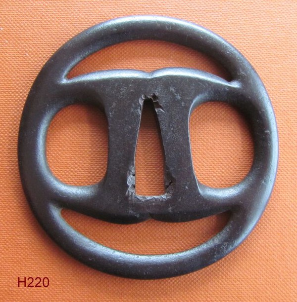

menpo Posted January 10, 2016 Report Posted January 10, 2016 Hi gents! I recently picked up this tsuba and have been identify what school it belongs to. The theme I think would be termed as bracken? The iron appears to be extremely good after I cleaned it up a bit and almost has a wet look! I found a very similar example in one of my old books but I can't translate the description. I was wondering what all your thoughts on it are and any help would be most appreciated! Gethin Quote
Pete Klein Posted January 10, 2016 Report Posted January 10, 2016 Hi -- I would think it to be a Sado piece due to the heavy rounded form on the metal. Here is an example and explanation of Sado and although a different motif you can see some of the similarities: http://www.shibuiswords.com/haynesTsu15.htm 1 Quote
Curran Posted January 10, 2016 Report Posted January 10, 2016 I too thought Sado, at first glance. 1 Quote
menpo Posted January 10, 2016 Author Report Posted January 10, 2016 Thanks both! I havent seen many examples of sado island work but i quite like this one! does anyone else own any sado work? Gethin Quote
Curran Posted January 10, 2016 Report Posted January 10, 2016 Well, remember that we could be wrong. Sado Island has a very interesting history. I don't know how the tsuba evolved, but they have a very distinct feel to them. Masculine, often a bit 'heavy' or thick of appearance. Usually a refined iron with dark patina. Simpler yet strong designs. Easy to imagine the needs of the island's maritime and mining influence on those who made them. I haven't handled many. Yet the NBTHK is very consistent in labeling certain tsuba as 'Sado'. My personal opinion is strongly that it is Sado. Quote
John A Stuart Posted January 10, 2016 Report Posted January 10, 2016 The one pictured in the book is 山銅 FYI. John Quote
Pete Klein Posted January 10, 2016 Report Posted January 10, 2016 Just in case you missed it you were just given a 'Pop Quiz'! LOL Quote

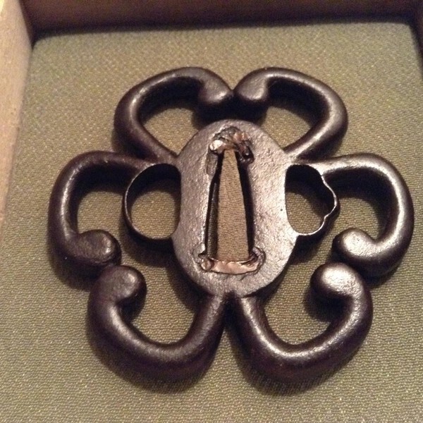

MauroP Posted January 11, 2016 Report Posted January 11, 2016 Some characters of Sado (佐渡) schoool can be found also in some Satsuma tsuba (see http://jameelcentre.ashmolean.org/collection/7/10237/10363).Images of Sado tsuba are difficult to find. Here a papered one from a Japanese auction some time ago:Bye, Mauro Quote
MauroP Posted January 11, 2016 Report Posted January 11, 2016 .... and Ōno (大野) could well be another candidate: (from http://www.shoubudou.co.jp/tuba-777.html) Mauro Quote
Michael 101 Posted January 13, 2016 Report Posted January 13, 2016 I tend to agree with the Sado island call for this one. They are usually very beefy examples with beautiful iron quality. Quite often mistaken for Akasaka due to the thickness. Looks a very nice example. Kindest regards Michael 1 Quote
